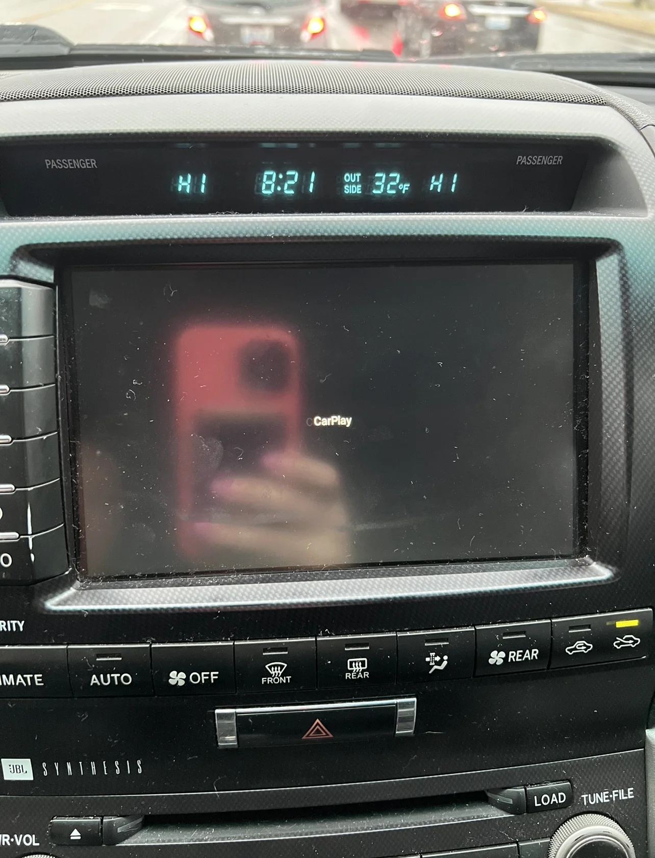

The wife has been experiencing a CarPlay lockup usually once a day where the screen goes to black with "CarPlay" in the center and is unresponsive. It typically takes turning the car off for a few minutes and restarting it to get it to function again. I've sent a support email to Grom but has anyone else encountered this issue? (2009 LC with the VLine2)
I’ve been getting that but seems like when I have a good connection and then I make a quick stop and I turn the car off. Drop kids off and back in the car in a few minutes. Then when I turn car on the iPhone has trouble reconnecting. Happens like once a week ish.
Quicker solution is shut the wifi off on your iPhone. It will say car play will disconnect and you say okay and then grom will reconnect CarPlay automatically and usually problem fixed. No need to turn off car.
