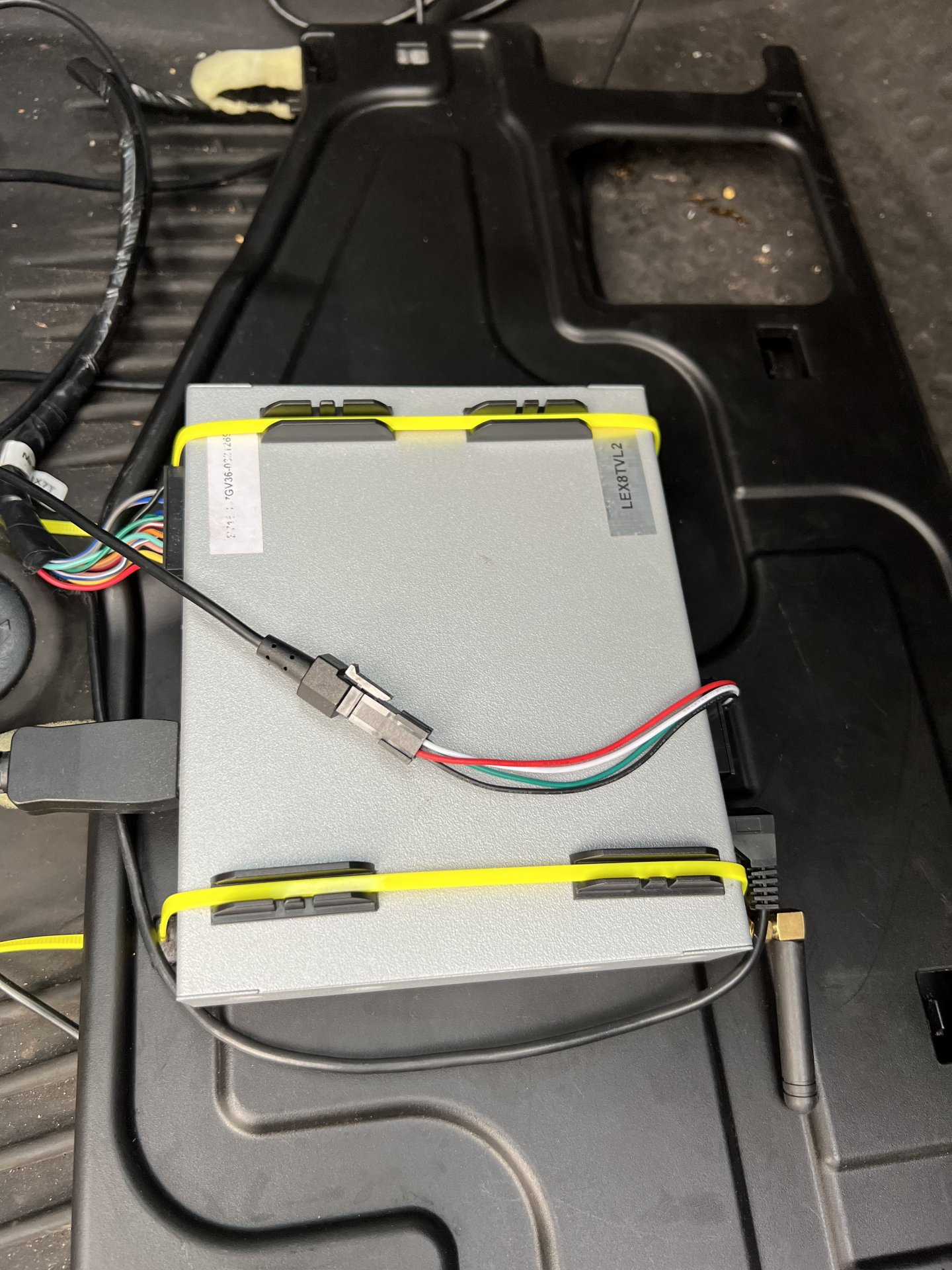

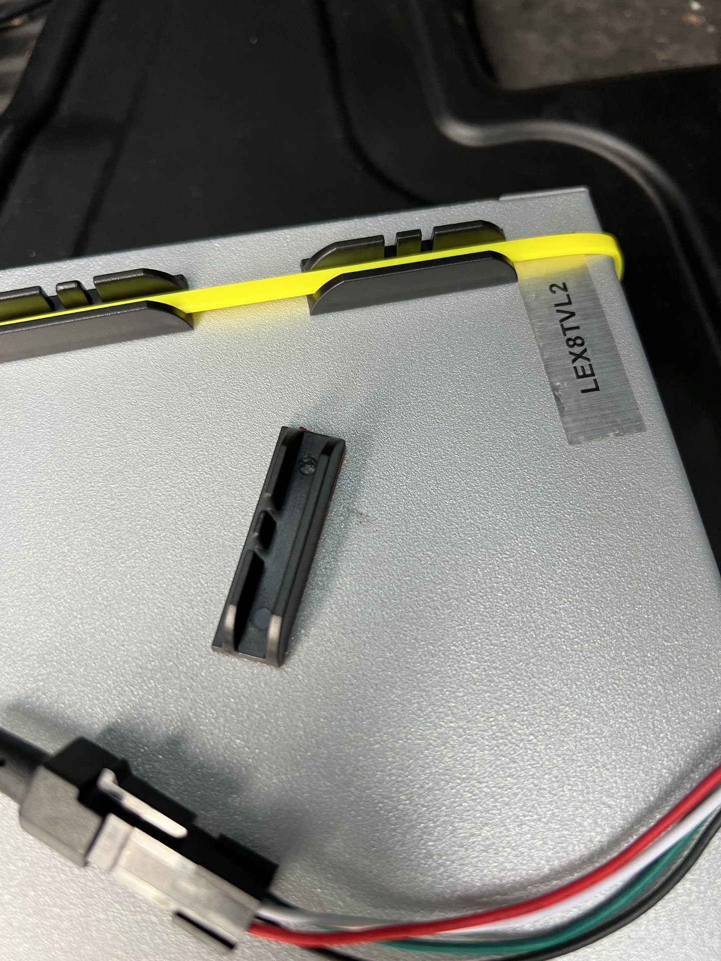

My mounting system. Four long zip ties. There are perfect holes that fit the Vline. Also I got these 3M stickered wires clips with one of my many car chargers I think. Helps keep the zip ties positioned.
I gathered the cords and tucked them
Under the removable panel.

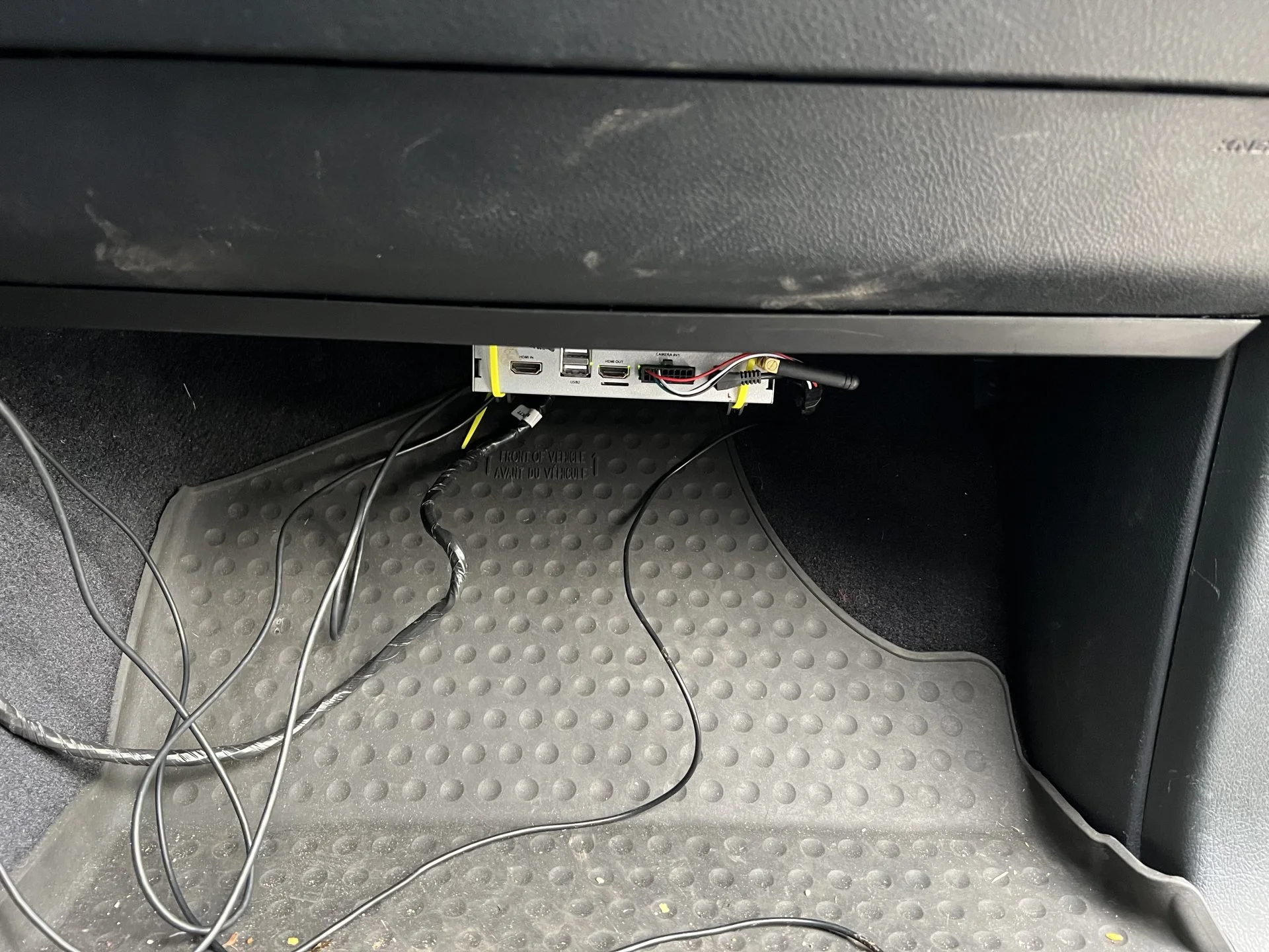

I finally got my grom vline2 installed and fully concealed on my 2011 lx 570. The microphone and gps antenna are routed all the way to the top of windshield where the rear view mirror is. The microphone points nicely inside the car away from windshield.
The GPS antenna is glued to the windshield right beside the rainsensor. If anyone is interested I can post pictures.
I have routed the USB cable to the factory USB cable plug, pulled the existing factory usb connection and replaced it with grom's usb female which sits right into the factory USB slot.
The grom vline2 console is mounted under the glove box but you cannot see it unless you are all the way ducked down. It have zip tied it to the panel. Will post pics soon.
