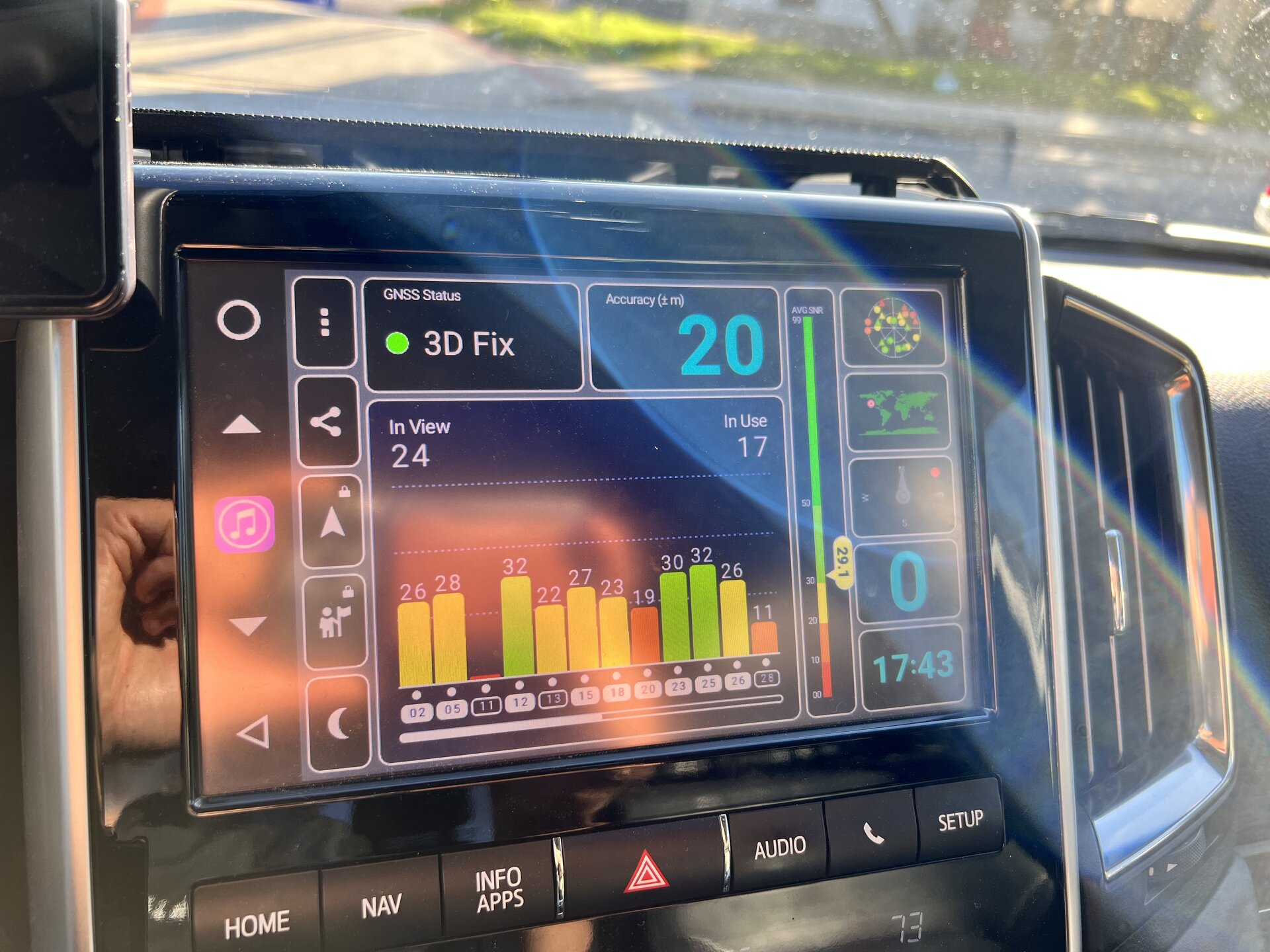

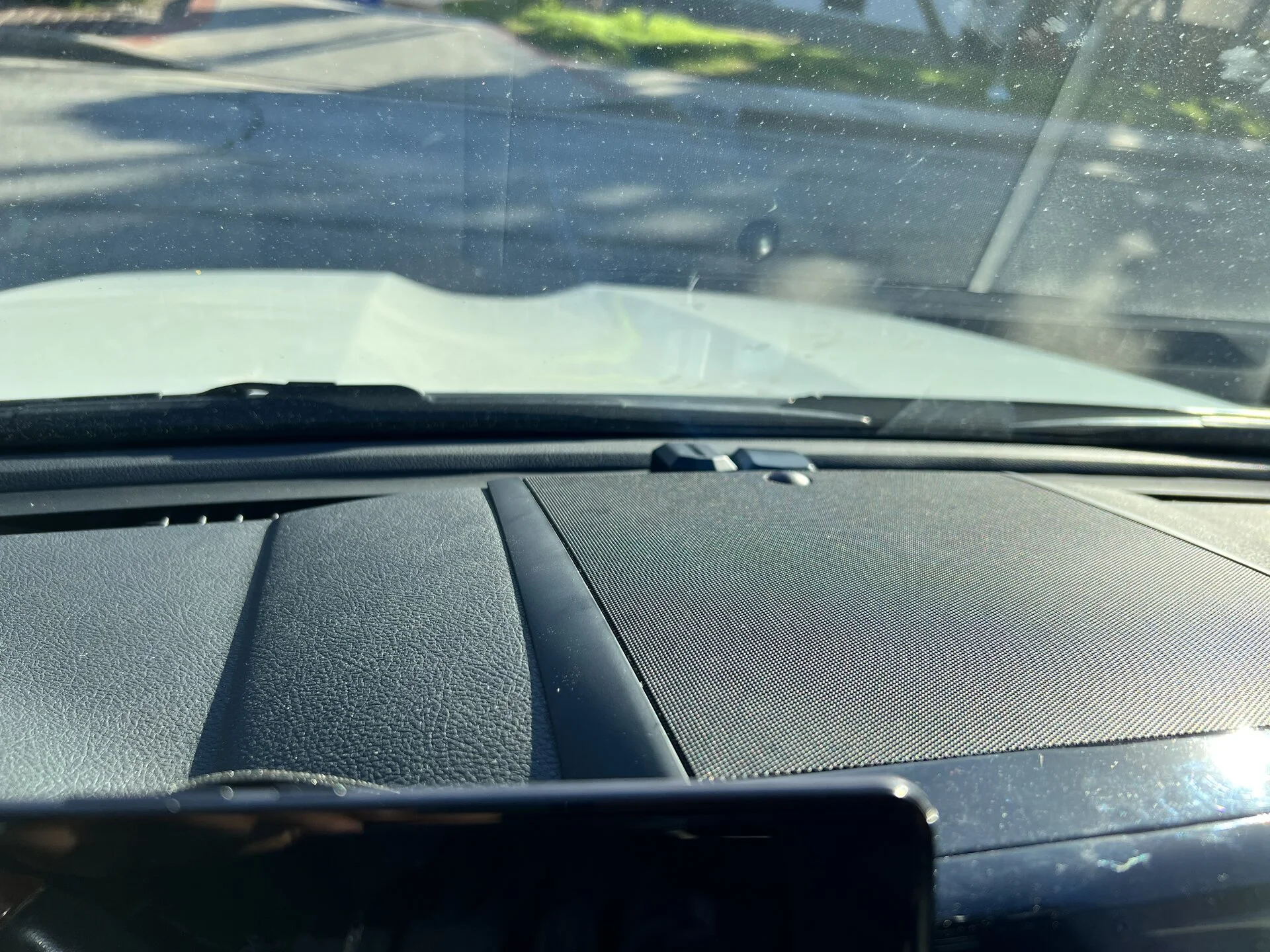

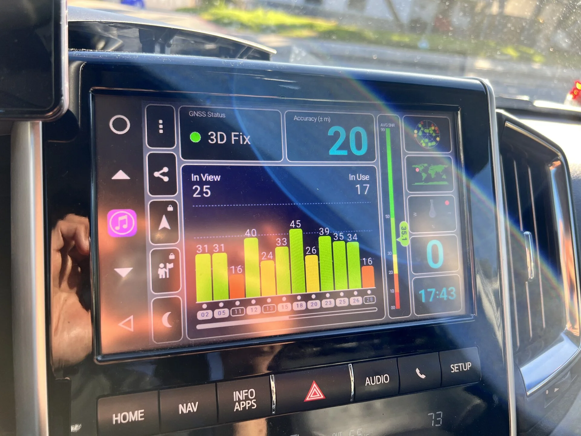

Also in case anyone wondering I compared GPS antenna mounted outside of the center mesh grille vs outside.
Second pic shows improved signal. Decided to leave mine outside
