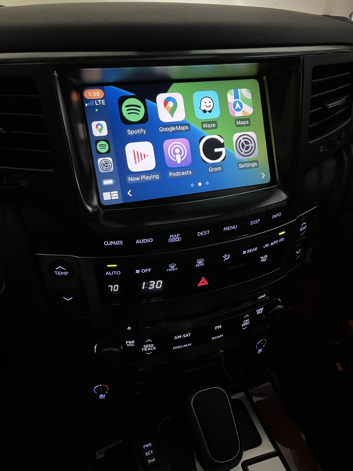

I got my vLine 2 from last group buy this weekend. I did a soft install in my 2010 LX to see how I like it. If you aren’t trying to mount anything, physical install is less than 30 min. updated the firmware and had no issues getting CarPlay going. I’m only getting audio out of left side of stereo. I tried wired and wireless CarPlay and got same results, and was eventually able to get the A2DP plugin to connect and allow audio streamed from phone, in an attempt to eliminate the CarPlay aspect. I’m guessing I just got a bad cable. I’ll be emailing Grom support tomorrow. Factory audio still works fine.
1st impressions are that I think it’s okay. It’s very clunky to control with the factory screen. Once I learn where everything is that will get easier. I didn’t instal gapps yet, so there is that as well..

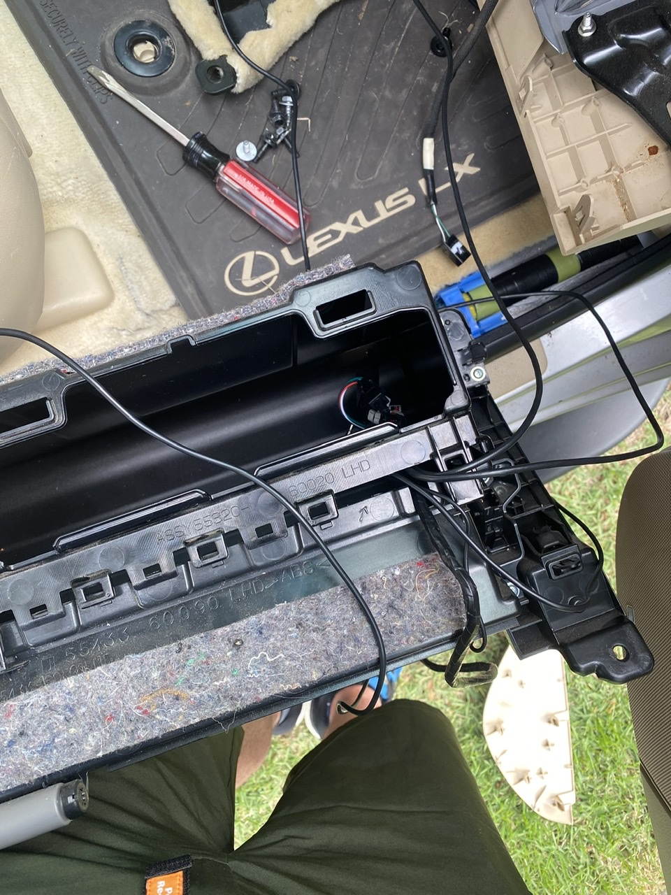

For now I plan to mount the unit in my glovebox. I removed the glovebox today and separated the two rear parts to fit the plugs through. There is already a hole in the rear big enough for the cables. It would probably be Better to drill a small hole in the rear of the left side as the cables are somewhat pressed against the hvac intake box.
heres the rear of the glove box separated and cables run.
