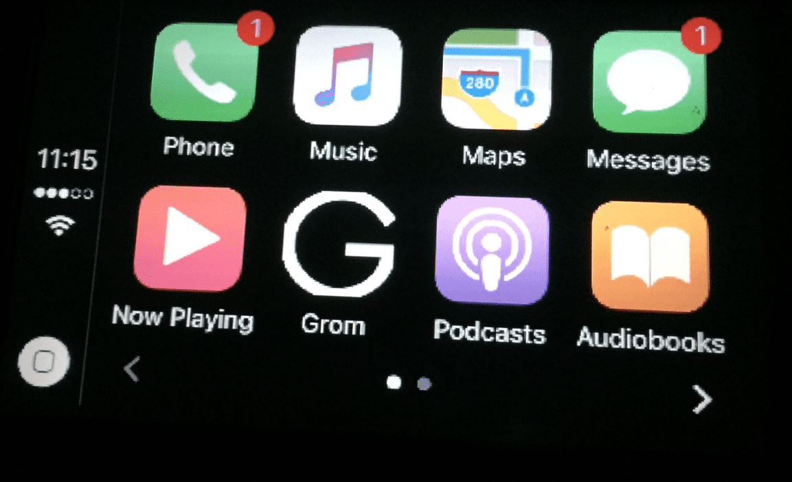

CarPlay, it seems that if you do this:
Then plug your iPhone via lightning cable into USB1 of the Vline, you get this:
(Oops, I'm probably not supposed to do that...) It does seem to work better for me if I have the Vline CarPlay set to manual and wait for the system to boot up before I connect the phone.​
