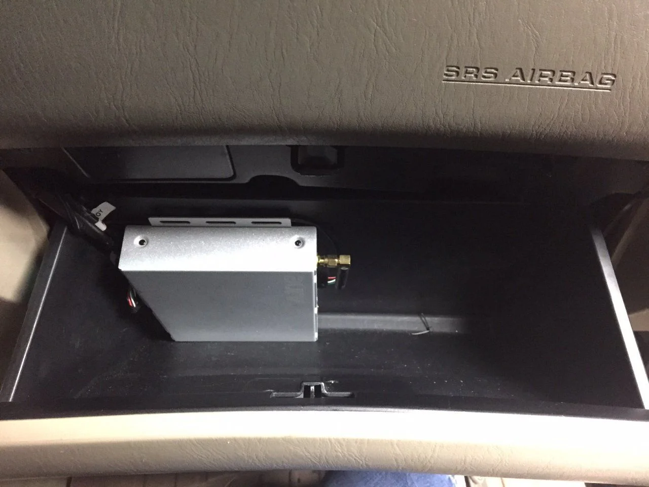

Are you okay with loosing the glove box ? I'm looking to find a mount so I can hide mine in a place that won't bother and won't be seen. I really need the glove box.
I would really prefer another option (like under the passenger seat).
We will need a longer wiring harness for that and a bit more work. Do you think Grom could provide us a longer wiring harness that won't degrade the video quality even further ?
Yes, the provided cables limit the install to the dash/glovebox area. While mine has shown interesting promise, it has not demonstrated enough stability for me to pursue a more permanent mounting solution just yet.
You don't loose the entire space of the glove box- just a portion of the left side of it. Not much space anywhere else for it to live with out rearranging fixed wire and cable looms. I'm hesitant to rearrange much behind the nav unit- there are strands x 10 of delicate 20 or 22 awg wires that could easily be boogered up or pulled from a connector.
