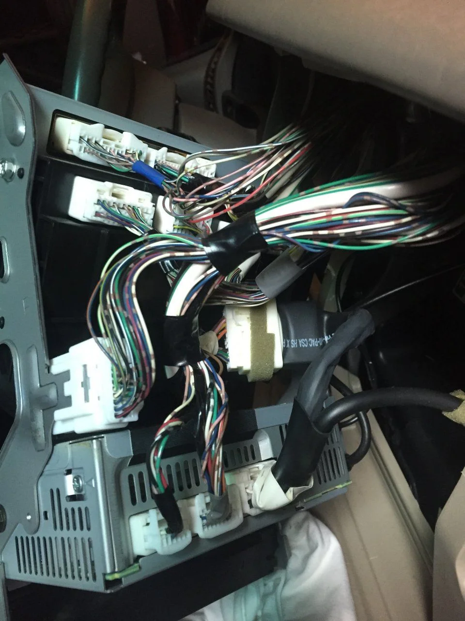

Got everything pulled out and ready to plug in my Vline and the supplied display harness VTOYA3 cable does not fit any connector on the back of my display. The instructions for connecting the video display port also show 4 connection ports on 1 row, Ive got 3. Wondering if the Lexus is different than the LC?
EDIT:12-20 Even though I entered my correct vehicle info, there are 2 different wiring kits for 2005 models: you either fall under the 2003-2005 LEX3VL1 or the 2004-2006 LEX4VL1. After providing this MFD picture to Grom, they told me I needed the wiring kit from the LEX4VL1 which they are priority mailing to me. Hopefully that covers it. Grom has been very responsive thus far.
