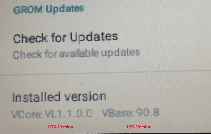

Are you guys that have done updates, doing via wifi or via USB memory stick?
Both, the OTA updates are not the same thing as USB updates
They come out in both forms, not sure why some are OTA and some are USB only but I'll update either way as they come out.
@jLB
Would you point me to the USB procedure to update the Vbase? I just did a WiFi update and got VL1.2.0.0 but VBase is still 90.5
