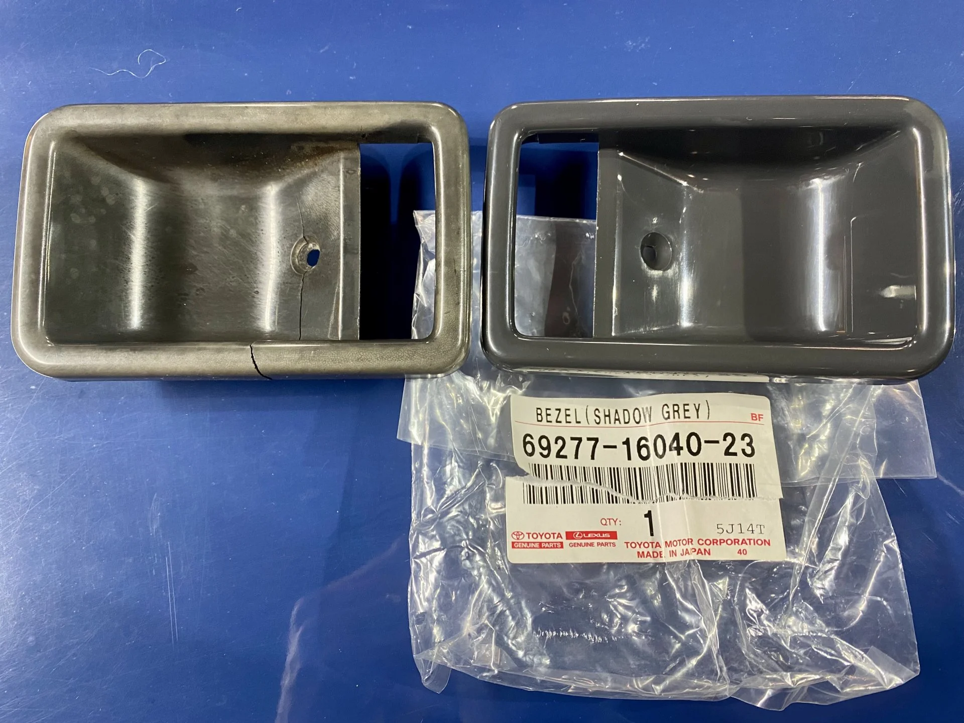

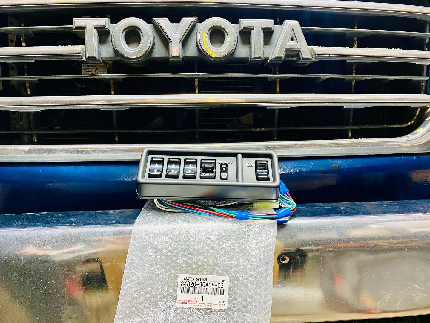

But I noticed the window was slower with the master switch actuating it vs the door switch. So I turned my attention to my original switch. I had a new one on the shelf for years but for some reason I was putting it off. Today was the day! New switch, cleaned the contacts on the door harness and installed a new handle bezel. :D The little details add up.

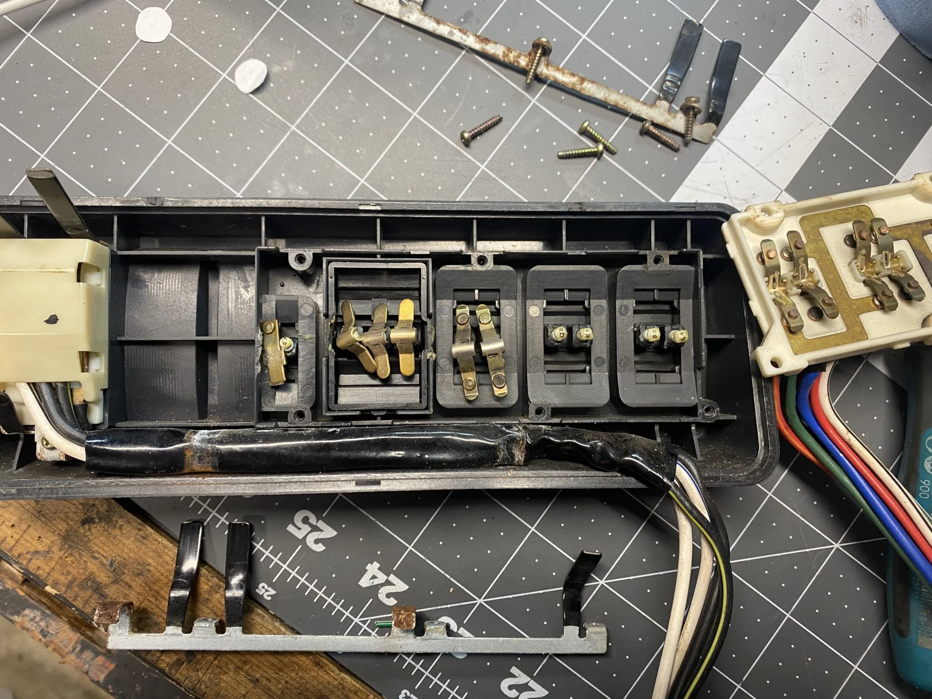

Took apart the old switch to peek inside. The old contacts were definitely dirty! I am sure if I cleaned them up it would work a lot better. I'll keep it as a spare I suppose. Still life potential in it after a cleaning. :)
A brass wheel on a Dremel works well for cleaning up those contacts without scoring them like a steel wheel would. It's not a super long term fix and not as good of quality as a brand new switch, but does provide a vast improvement if you're in a pinch but have time to take apart the switch. Keeping an old cleaned up switch as a spare is definitely a good idea.
A while back I experimented with putting a tiny dot of conductive grease on the contacts but that was a failure. Definitely want to keep them dry but a tiny spot of lithium grease where the white pushrods sit in the rockers is a good idea.
