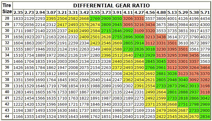

How to pick tires without ruining drivability.

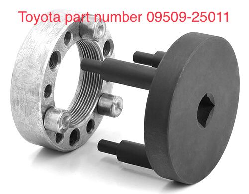

Full float Tripod socket part number for wheel bearing nut 09509-25011

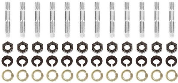

Very happy with this hub stud kit.
Trail-Gear Super Metal Hub Stud Kit, for 2 Hubs (300578-1-KIT)

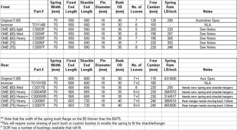

Suspension:
Leaf spring measurements.
Leaf spring bushing sizes.

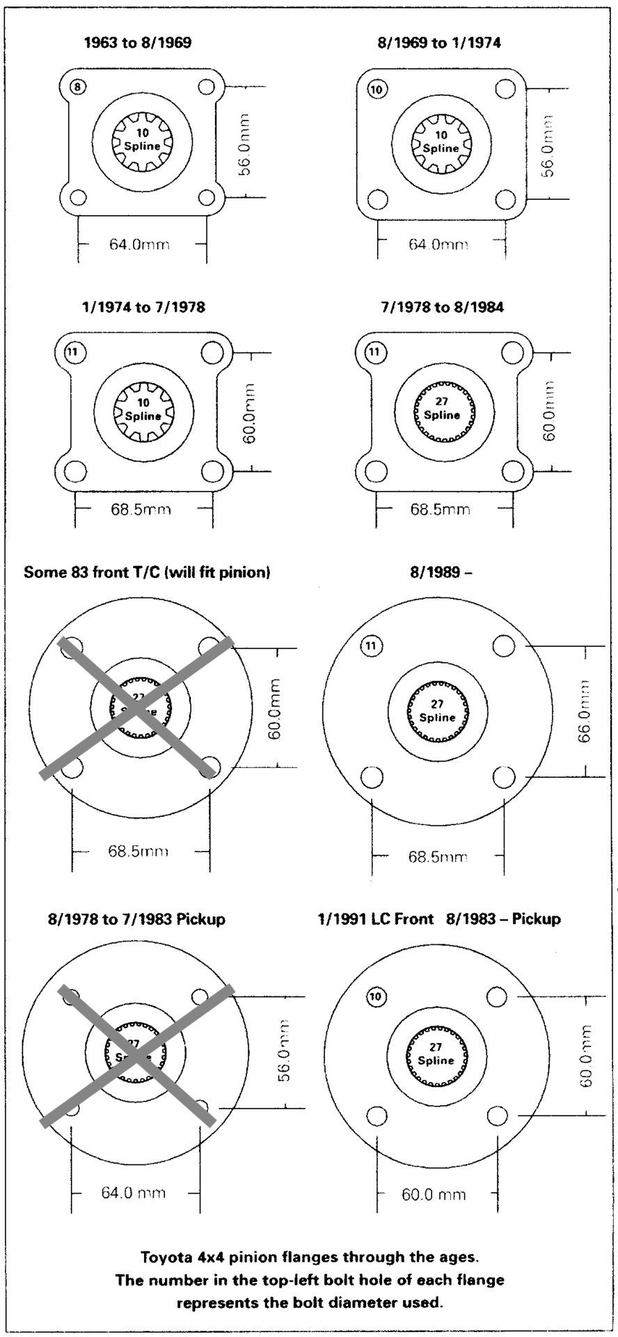

Identifying pinion flange bolt patterns.

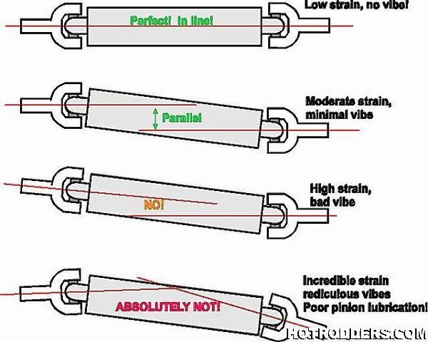

Drive shaft angles.
60 series with h55 (5 speed)
img_1416-jpg.1557504
I would like to get better measurements of the length of five and four speed drive shafts.

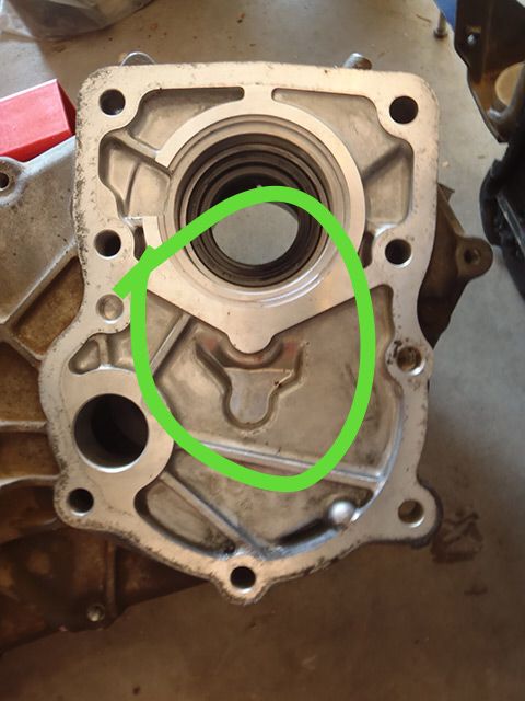

For those upgrading to a h55 your split case must have this oiler cup provision.

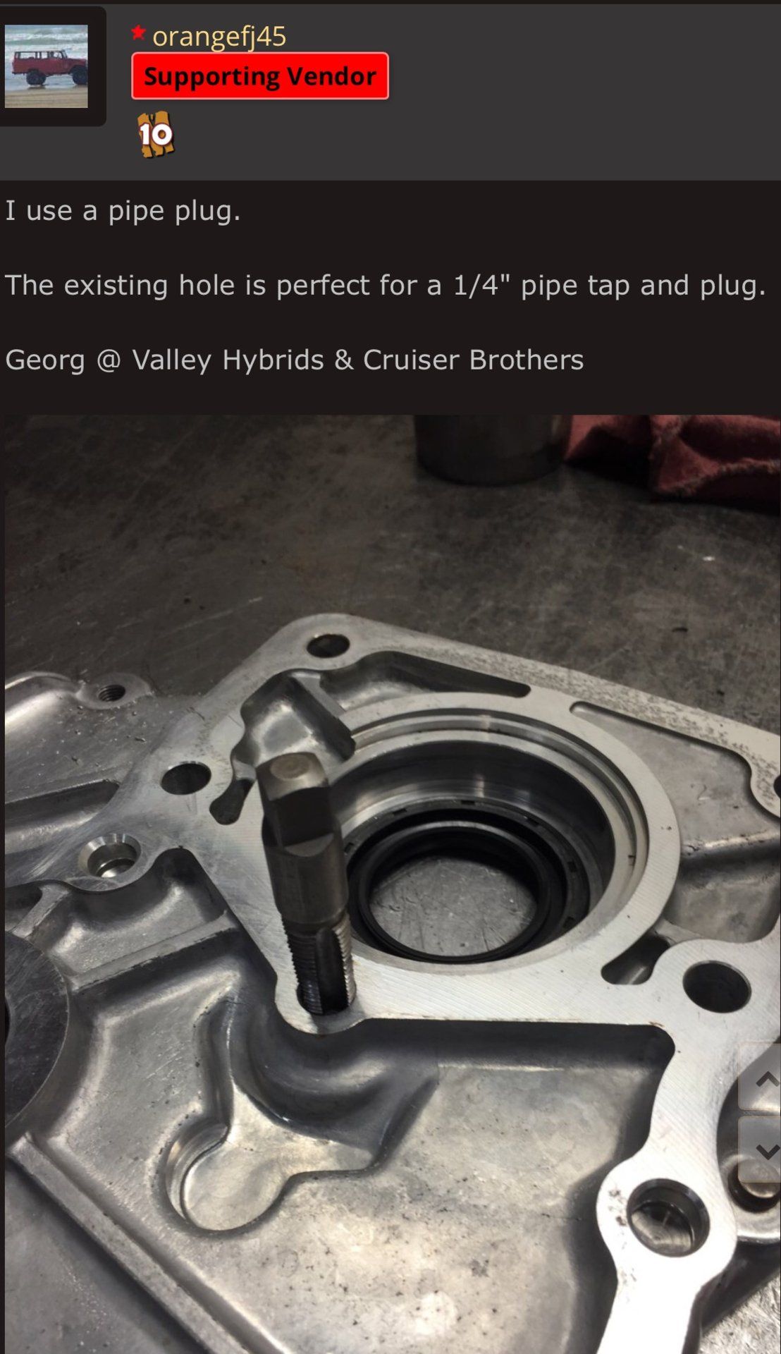

For people adding a later 38mm case to a h55 this hole needs to me plugged.

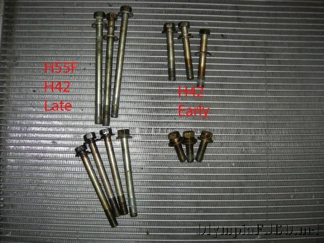

Bolt differences between short h42 and the longer h42 and h55.

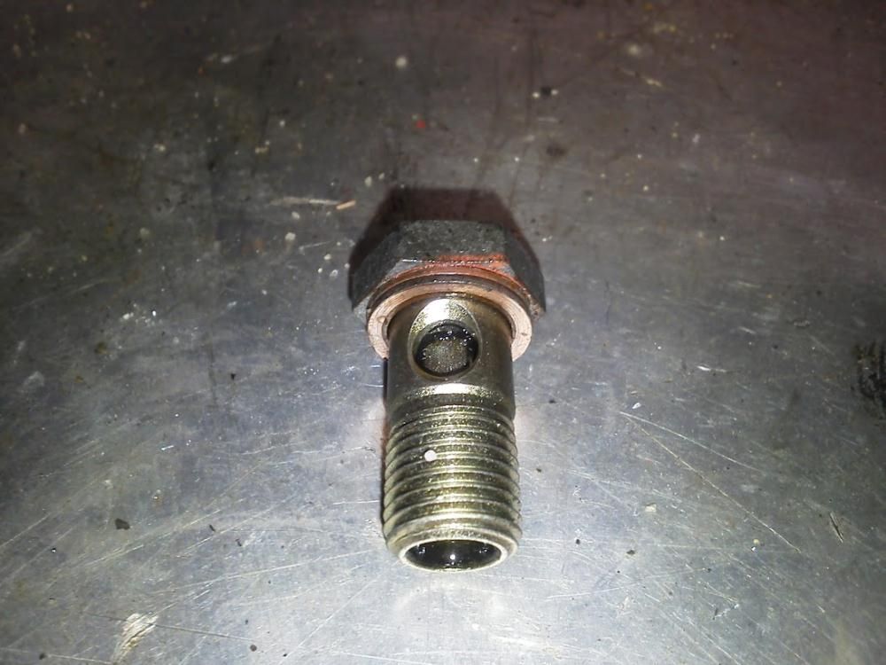

On The 3b there is a often over looked hidden screen in the banjo bolt on the primer pump where fuel line coming from the tank connects.

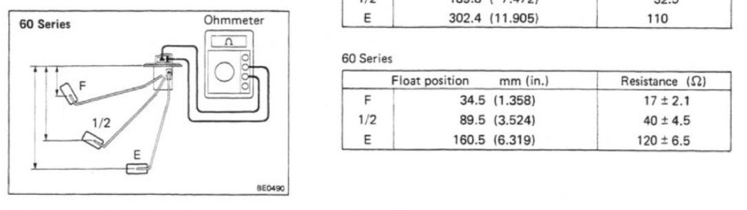

Part numbers:
60 series Fuel float sender 83320-69015
60 series float sender gasket 83361-20030
