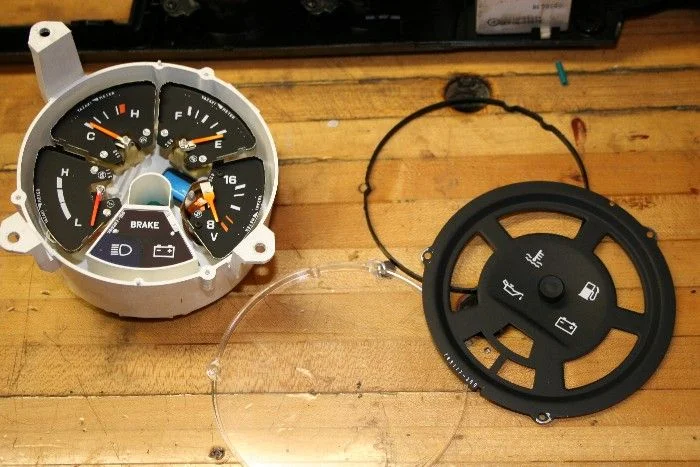

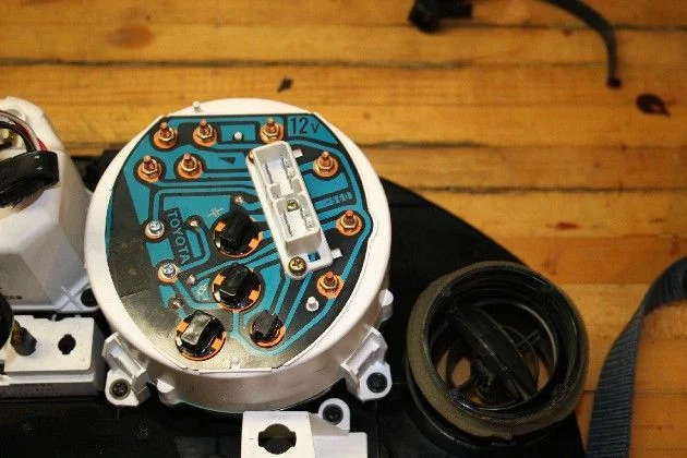

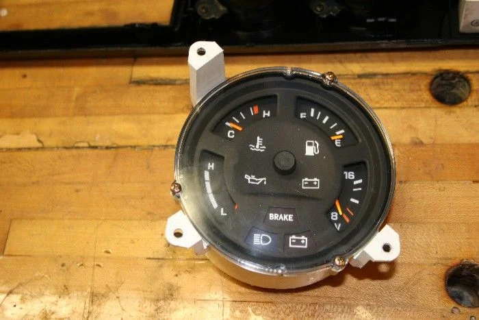

    Changing fuel gauge
    Since I had the dash apart figured I throw up some pics, please correct me if I describe something incorrectly.
    Remove the three screws holding the cluster to the dash faceplate.
    Remove the three gold screws that hold the clear plastic cover and the spacer on.
    Separate the plastic cover, spacer and the metal gauge cluster faceplate.
