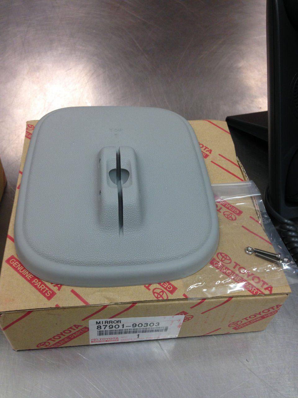

40 series side mirror 87901-90303

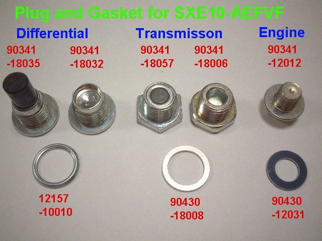

Drain plug Allen head with magnet 90341-18021
Drain plug gasket 12157-10010

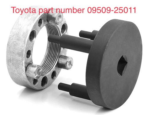

Full float Tripod socket part number for wheel bearing nut 09509-25011
