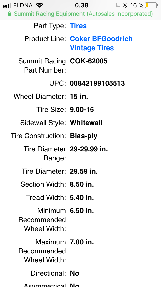

This is not a vintage, its a Light Truck Size, that indicates the aspect ratio about 100%.
So a simple calculation is 15''+9''*100%+9''*100%
We arrive at around 34''.
But the exact diameter depends on the Model. For example 9.00-15 with 33.1'' diameter (840mm)
