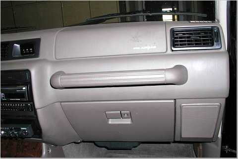

Well I finally found time to install the grab bar...thanks MOT it was perfect. I had the whole dash taken apart to install the diff switch, relocate some switches, and install the 520 CB so I just kept going and installed the grab bar. I used landtank's updated instructions and removed the ECU and so the ac duct was way easy the hard part for someone with large hands as placing the nut on the left side behind the other ac vent...but after some bleeding and much scratching i got it buttoned up. I think it looks great!!! I found it interesting that the ac vent even had a dent in it to go around the back of the bar once installed....:idea: it's like it was ment to go there are something.

Thread revival. I have never heard anyone say how sturdy these things are after mounted. It looks like they only mount into the plastic of the dash. Are these plenty strong to hold on to if needed? No fear of ripping them out, or damaging the dash? And about what do these cost? (calling mot)
They are mounted to the metal bracket behind the dash, they are as sturdy as the overhead grab handles. They are a permanent install, ie. the dash is "damaged" with two holes, if you ever want to remove the grab handle...
It is a solid OEM fit, rock solid. IIRC it is standard equipment on some overseas models. I can't imagine why you would ever want to remove it. Looks stock, feels stock, it is stock.
