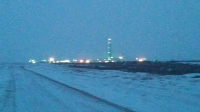

IMG_20140204_070256_808.webp New work site
