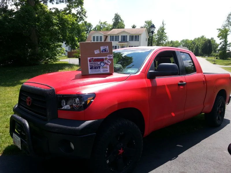

G, bringing back an old post of yours.... I said no on the whole rig, but as YOU ALL KNOW... constant changes with me............I'm about to pull the trigger on 3 gallons of the Monstaliner- Read My Lips.. Here is a Tundra that was done in the same color scheme I'm going for... I will be adding black to the center of Goss' hood as well..

Is there a way to get a smooth finish on it? I would think washing it would be impossible. I'd forever be worried about missing that one spot of rust that just gets to grown un-noticed (is that a word?) under the monstaliner. (though i have thought about rolling that stuff in my interior. :)
^...and if you change your mind later down-stream...well you'd need to be body-work handy as J to make it go away :D
The Monstaliner finish on Marley (last build) was pretty smooth, never had an issue with washing the East Texas red clay off him... RUST... WELL.. nothing a tiger disc, 16 ga sheet, a welder, quart of Monstaliner, and a few hours can't take care of.. The Monstaliner (well any liner.. can be shaved down, cleaned and applied over) Just have to be patient and pay attention to what you are doing.... I'm not worried about that issue one bit..

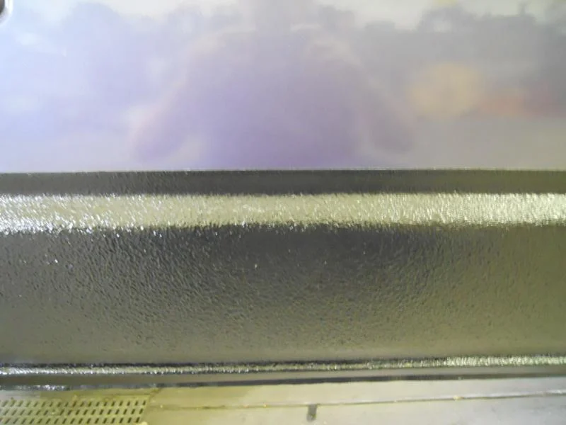

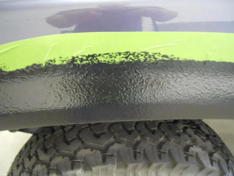

Yes, prep is everything and with ML it can't be applied over bare metal it is NOT a DTM product. I spray my rigs with a minimum of 2-3 coats of epoxy primer and let it completely cure out prior to scuffing and applying the ML (a week or longer), scuff the epoxy, clean and apply. Ambient temp is important during the application as well. Gotta love a heated shop.
Here is the texture of the ML on my last build. Washed clean every time.

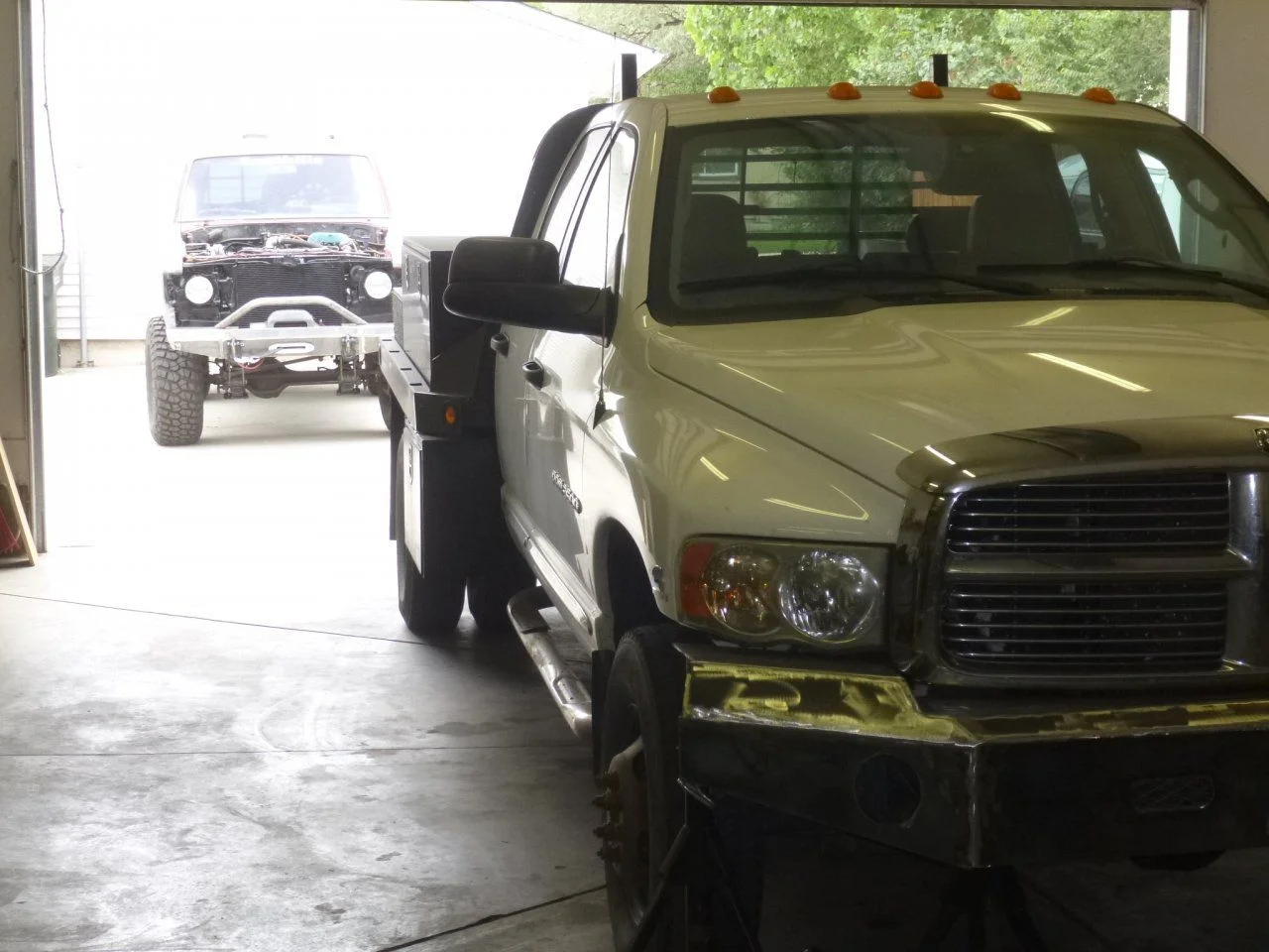

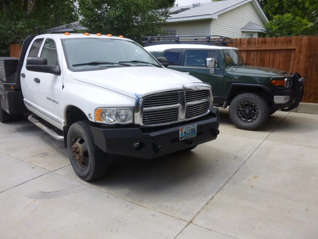

Dodge bumper is done. My buddy needs his truck for a few days so I'll start on orders now. Front and rear to build and ship out.

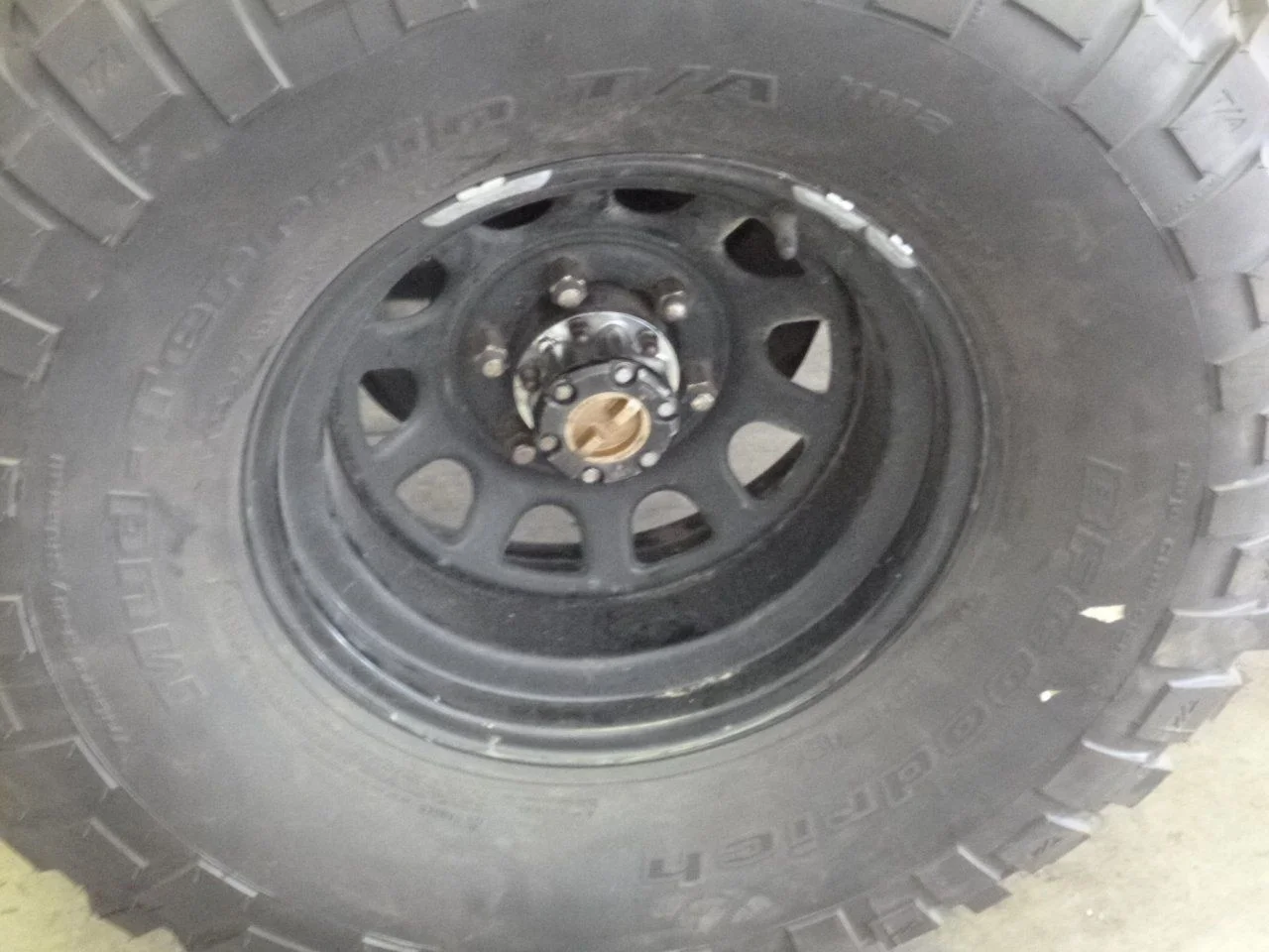

Cleaned up the shop and installed the Aisin hubs on Goss. Thanks again Georg for a fast delivery.

With all the plate work in that dodge bumper it looks as if you have your plasma table up and running...?
