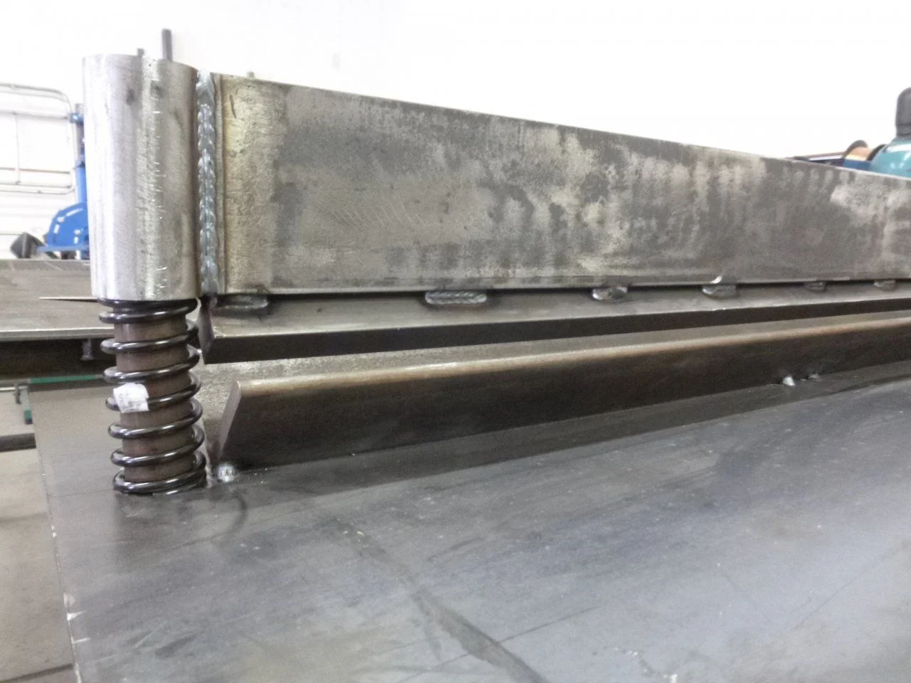

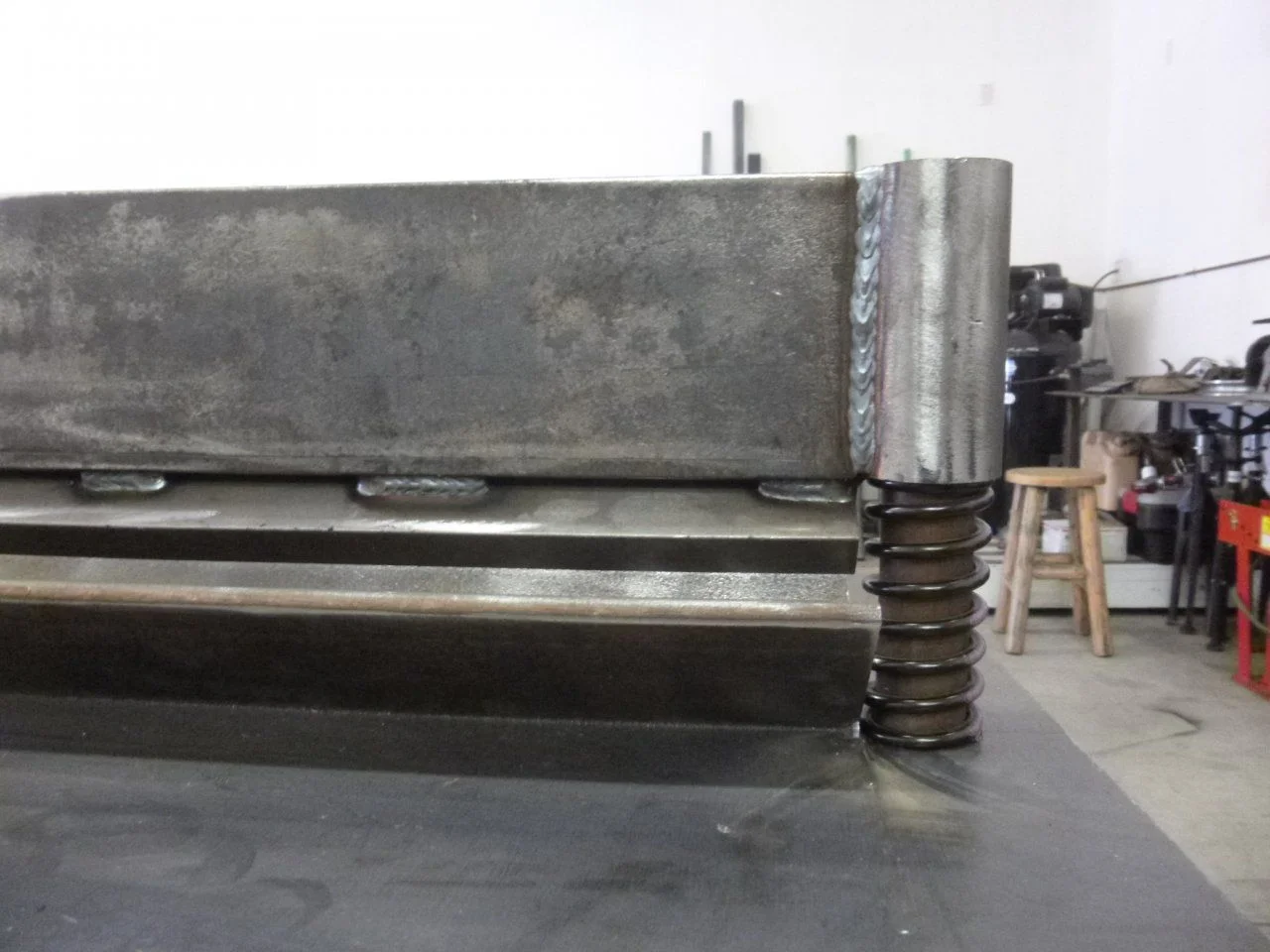

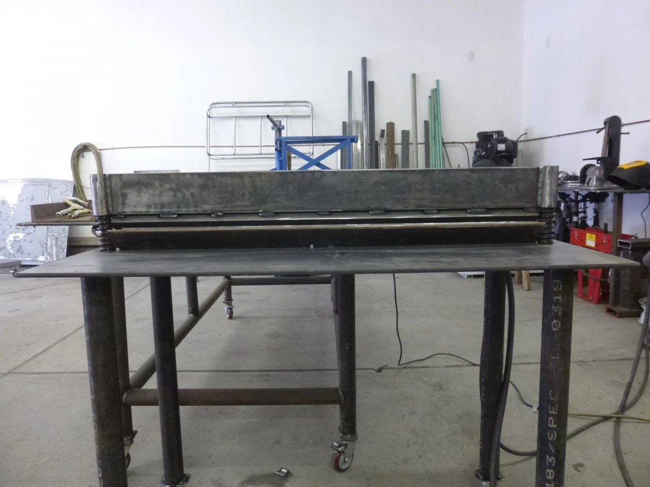

Got into the shop this morning and didn't feel like doing much. I decided to clean up, I have been lazy the last few days and have been in a metal hoarding state of mind... every piece of scrap has been saved until today.
After cleaning up, I decided to start on a 32/64 ton - 42" press brake :meh: , TT--SWAG hybrid in the making. Should help out quite a bit on a day to day basis. Got most everything tacked/stitched in place. Table/stand started as well... :grinpimp: Build the bridge and jack supports .. whenever... HA!

J, just curious: when you consider your brake to be a 32/64 with a 32 ton jack, do you have a secondary mounting point, say, a rocker arm of sorts that doubles the jack output? Pretty sweet. You could potentially widen your customer base if you started making Roll Pans for Minitrucks. Nah, I don't want to share... stick to the TLC!
Hey Danny, good to hear from you.
I have 2- 32 ton air/hydraulic jacks. The top of the "punch" will allow for either 1 or 2 jacks to be positioned there. I will mainly use a single jack, but if I want to say brake 36" of .250".. I'll have that luxury.
Until I get it built, I'm not sure of its capabilities.. I am using two brake calculators. One must have a safety factor built in where the other one doesn't.. So, I'm looking at expectations through the higher needed capacity at the moment.
