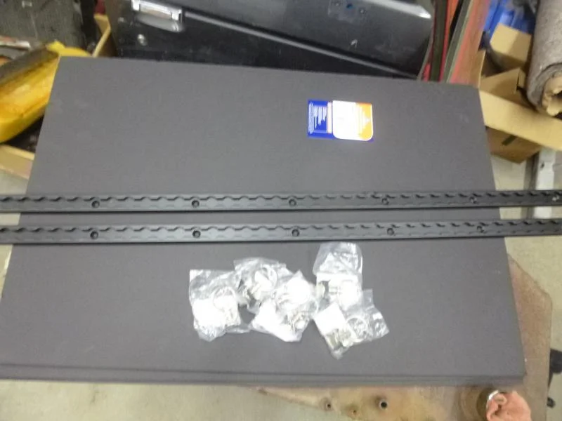

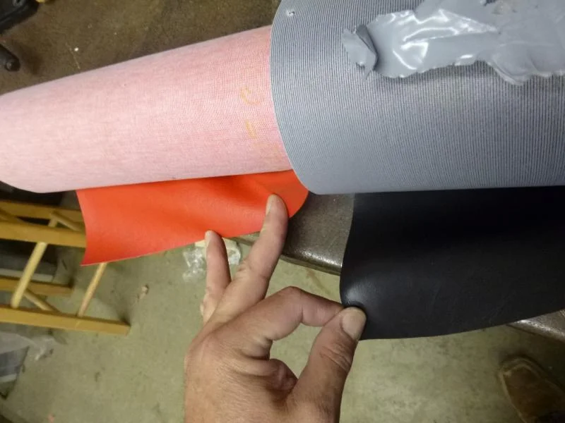

Kurt is LIGHTNING QUICK on shipping. Marine vinyl, aluminum cargo slide rails, and parachute hammock arrived. (Jas you know you want this mod..):grinpimp:
I should have the front suspension covered with the planned additions to come... (winch and aux battery) Winch will be here in a day or two.

I missed what the vinyl is for. Whatcha doin' with it?
So you're gonna string up the hammock inside Goss? :D
A, hammock (waiting on the second one) is a mod that Jas @ CY and I have played with for several months now. It will go nicely under Goss' awning for those hot days to help enjoy the beer and trail conversations... NEXT TO THE FRIDGE AND BBQ BUMPER! :grinpimp:
Vinyl is for all the custom door and cargo panels..
