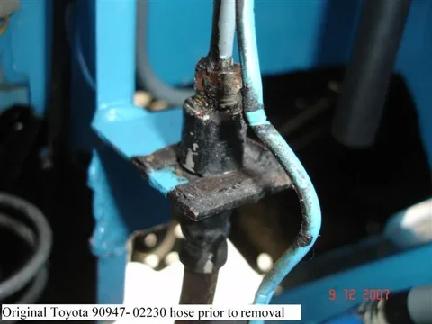

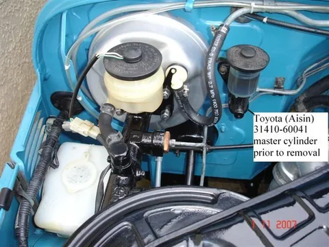

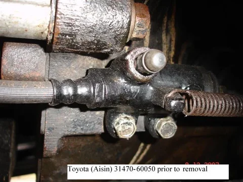

Here's some photos of the original gear:

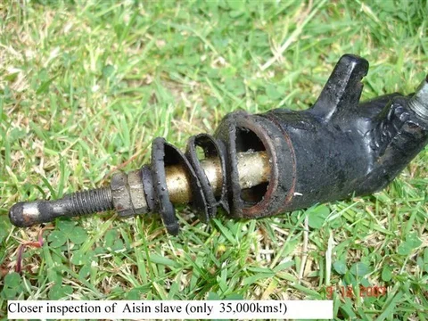

That Toyota stuff still looks OK until you take a closer look:

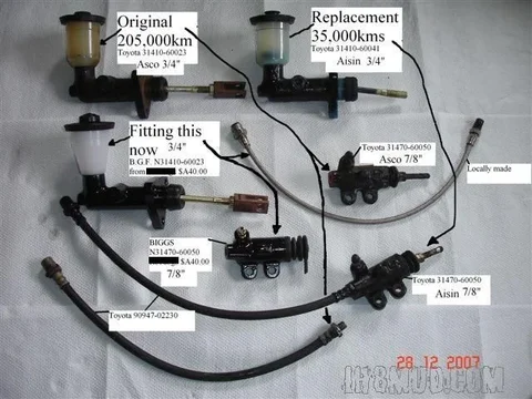

Here is a photo of all the clutch gear used on my BJ40 since it was new, including the new gear I'm about to fit:

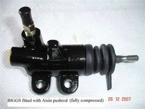

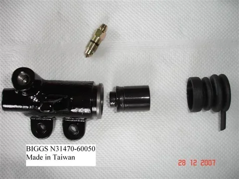

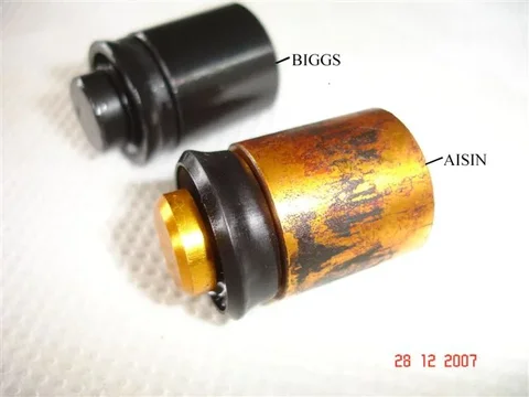

I've painted this new slave cylinder, but since I'm inquisitive about the quality, I took it apart:
I wasn't disappointed with the quality of manufacture:
Points against the BIGGS slave were that there was no "cap" supplied for the bleed nipple and no pushrod supplied. (I had to re-use the rod off one of the earlier slaves.)

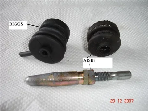

You can see from this photo the differences in the rubber boots too. The BIGGS version seals on the threaded part of the pushrod so the adjustment locknuts become hidden within the boot. (Unlike the Toyota Aisin/Asco where they are exposed.) But that is not a problem really. Perhaps it is even nicer to have your nuts concealed :D.

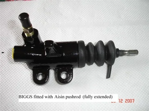

Here's a photo of the slave under "maximum extension":
And here it is in "minimum" position:

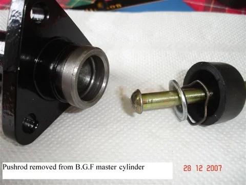

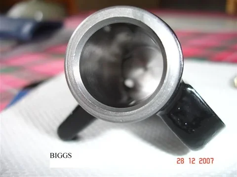

Here's a photo of the BGF master with the pushrod removed:
I was going to blow that piston out with compressed air (because it didn't want to come out any further) but I could already see that the bore was perfectly machined and everything was nicely lubed so I didn't bother looking further to try and find faults.

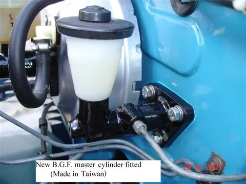

Here's a picture of the BGF on the firewall: (PM me if you see a speck of dirt!)

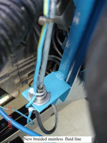

And here's the new braided stainless line installed. (I had to cut a slot in a stainless washer to act as a clip. I was going to use loctite beneath it but it's all so tight I didn't bother.)

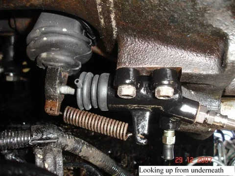

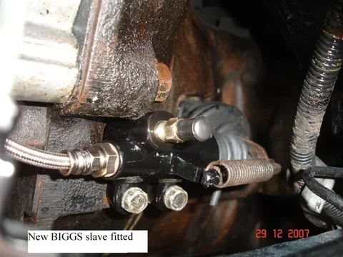

And here's a photo of the BIGGS slave installed:
And here's another view of it looking directly up from underneath:

Hey. ----Maybe someone can give me advice on what they think caused the premature failure of the Aisin gear I've just removed? It lasted only 7 years/35,000kms!
There are a couple of things that I think could be related:
  1. The top radiator hose recently burst off the t/stat housing as I bounced over a rough railway level crossing at speed. That covered my lovely clean engine bay in hot ethylene glycol mix :crybaby::crybaby::crybaby::crybaby:. Perhaps some got in the clutch reservoir?
  2. Then there was the time I was rather sloppy with the Marine Clean (powerful degreaser) just above the clutch reservoir. Perhaps some of that got inside?
Anyway, next time I poke the hose into the engine bay I'm sure as hell going to have the brake and clutch reservoirs covered in "clingwrap" or similar.
This photo shows some of the black crud on the Aisin slave piston:
And here's a photo of the fluid I drained. You can see the amount of black crud that has settled to the bottom. At first I thought that black stuff was "disintegrated rubber" from the seals but they look too good for that.
Whatever it is was sure seizing things up though. The last time I put my foot on the clutch (before removing the Aisin gear) it felt like the pistons were stuck fast - then they suddenly broke free. Not a nice feeling!!!!!!!!!
I'm using Castrol DOT4 brake fluid - But I doubt that is the cause. (Castrol doesn't have a bad reputation here.)
PS. Forgot - Some will no doubt suggest "lack of maintenance" for the premature failure. However I religeously change all the fluid once every two years (and I'm not prepared to do it more frequently than that. - Hell. Most people don't change theirs at all!!)

Dot 5 silicone definitely swells/damages old rubber seals. I converted my Triumph Bonneville motorbike to silicone and now it is lethal to ride (until I get around to fixing it). When you hit the brakes approaching a bend, the front disc calliper pistons won't release, so you end up taking the corner with the front brake still jammed on. (Needless to say, I'm not riding it till I replace the seals with silicone-capatible ones or do some other kind of fix.) The brake releases only when I stop moving!
My guess is that a drip or two of "Marine Clean" is capable of doing this damage and that it got in through that little vent cap on the top of the reservoir cap.
