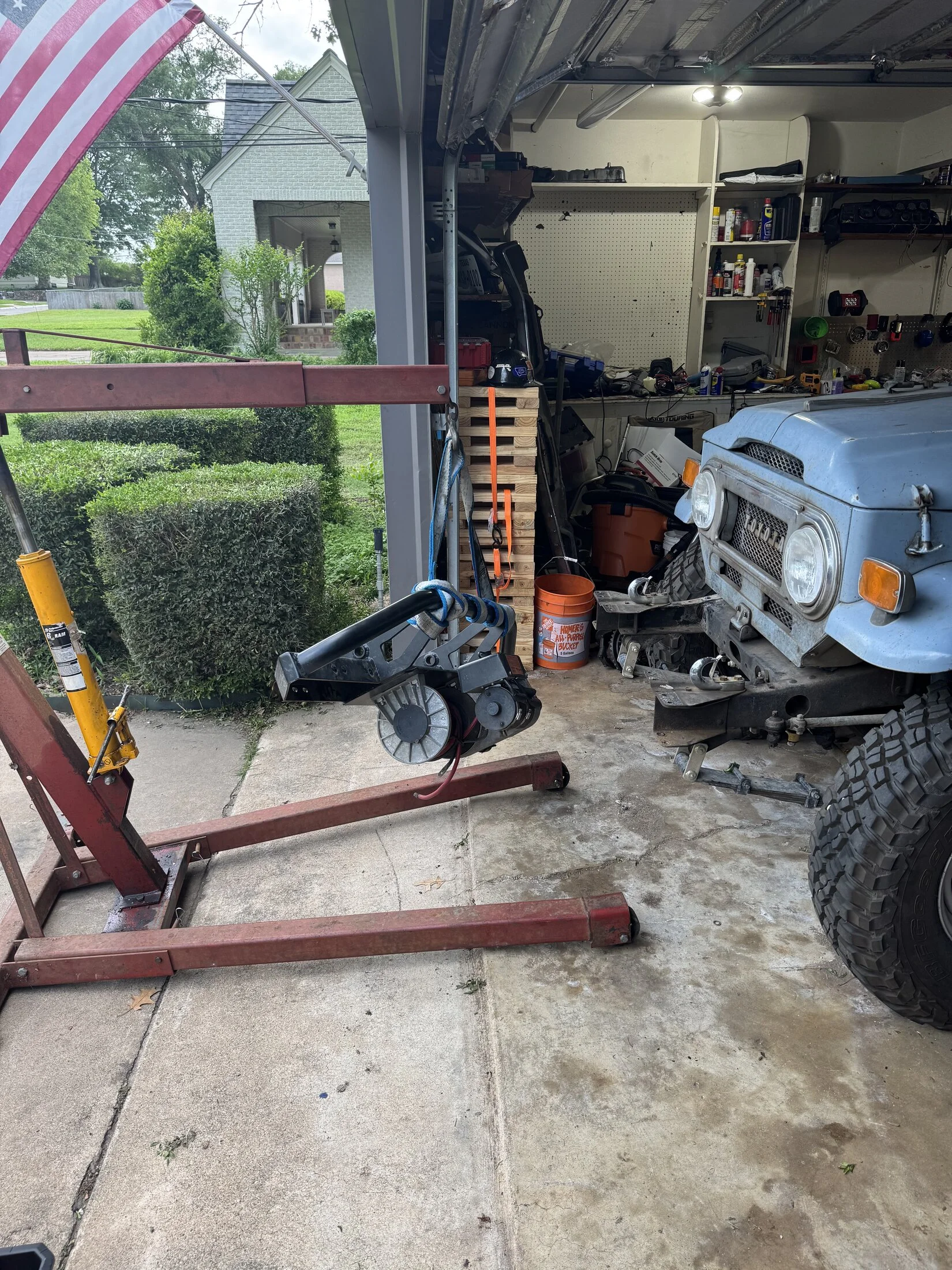

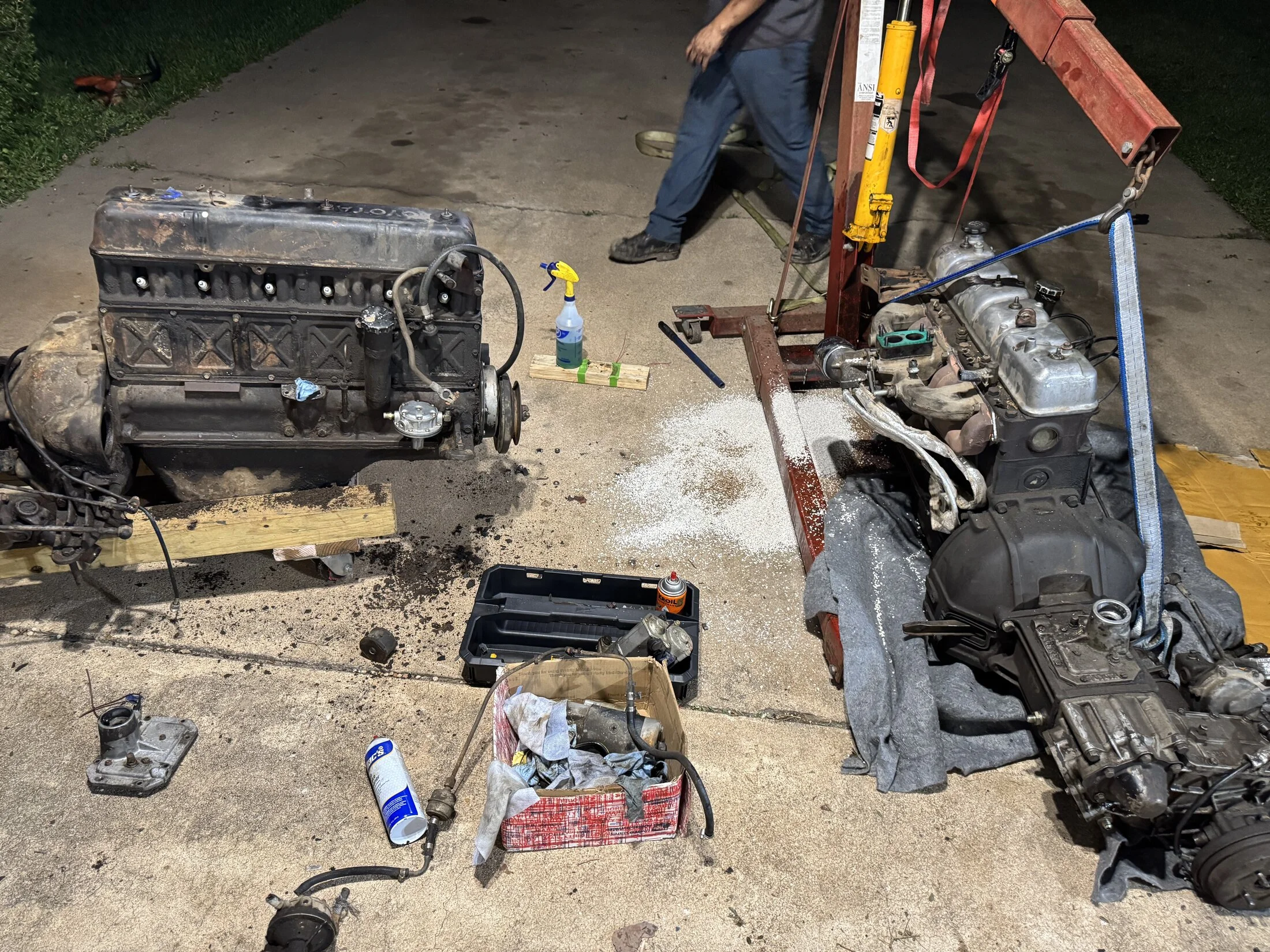

One of my biggest ongoing concerns had been the engine. So the first major upgrade on the list is a 1HZ swap. I ended up picking up a full kit from a fellow mudder.

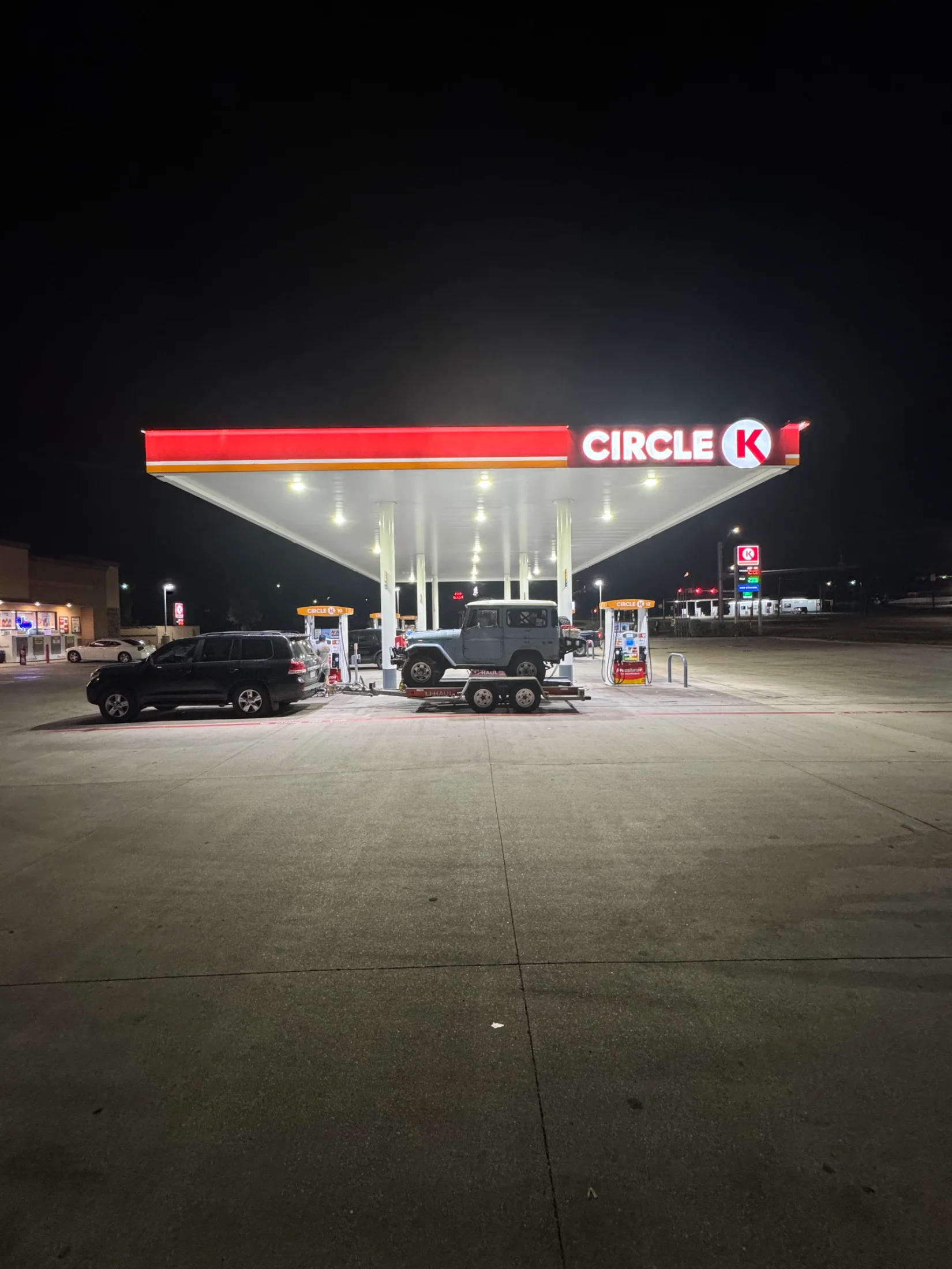

Went to get some gas that afternoon. Was idling parked in the shade in a parking lot, when the unthinkable happened. With no notice, the engine started making noise.
A sad day
Weird way to meet the legend Rob.
Big thanks to Cody for picking me up at the gas station and towing the 40 back to camp.

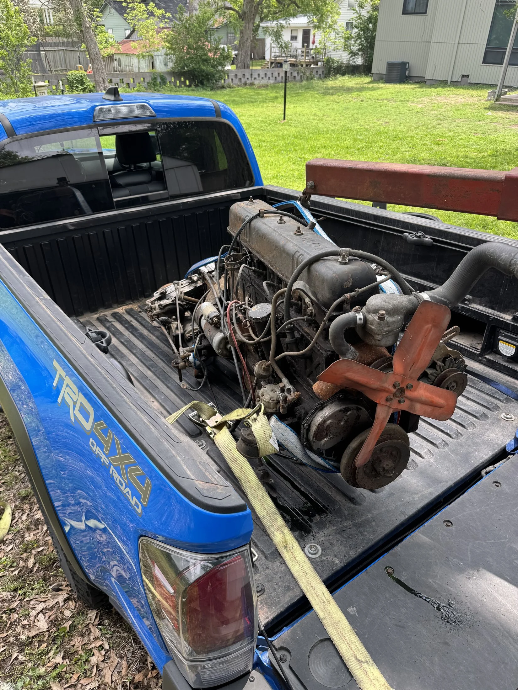

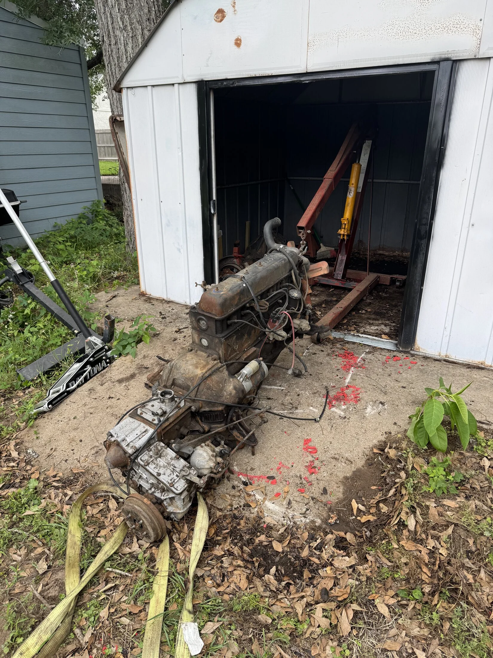

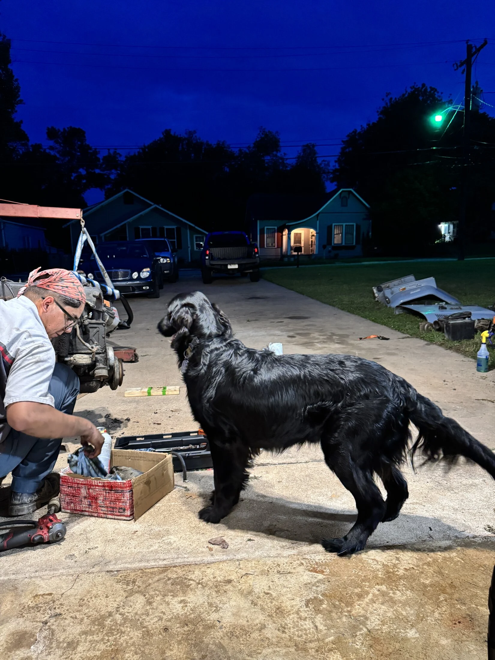

Camp diagnosis is it’s F’d. something went wrong in the bottom end, likely back cylinders.
Had a busy from Houston drive out to mason and pick me up.
For now, it’s it’s been put out to pasture with @HemiAlex ‘s cruisers.

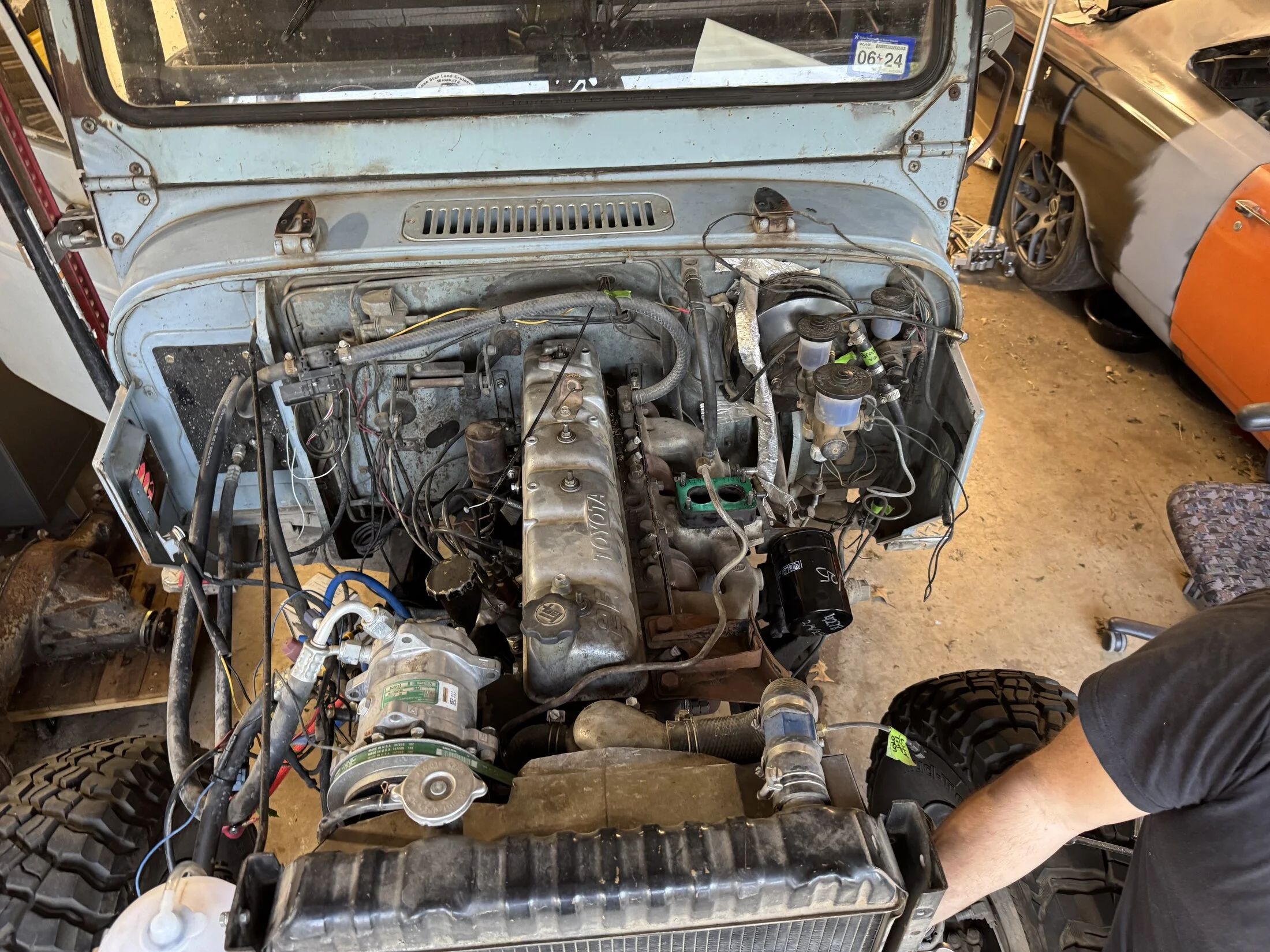

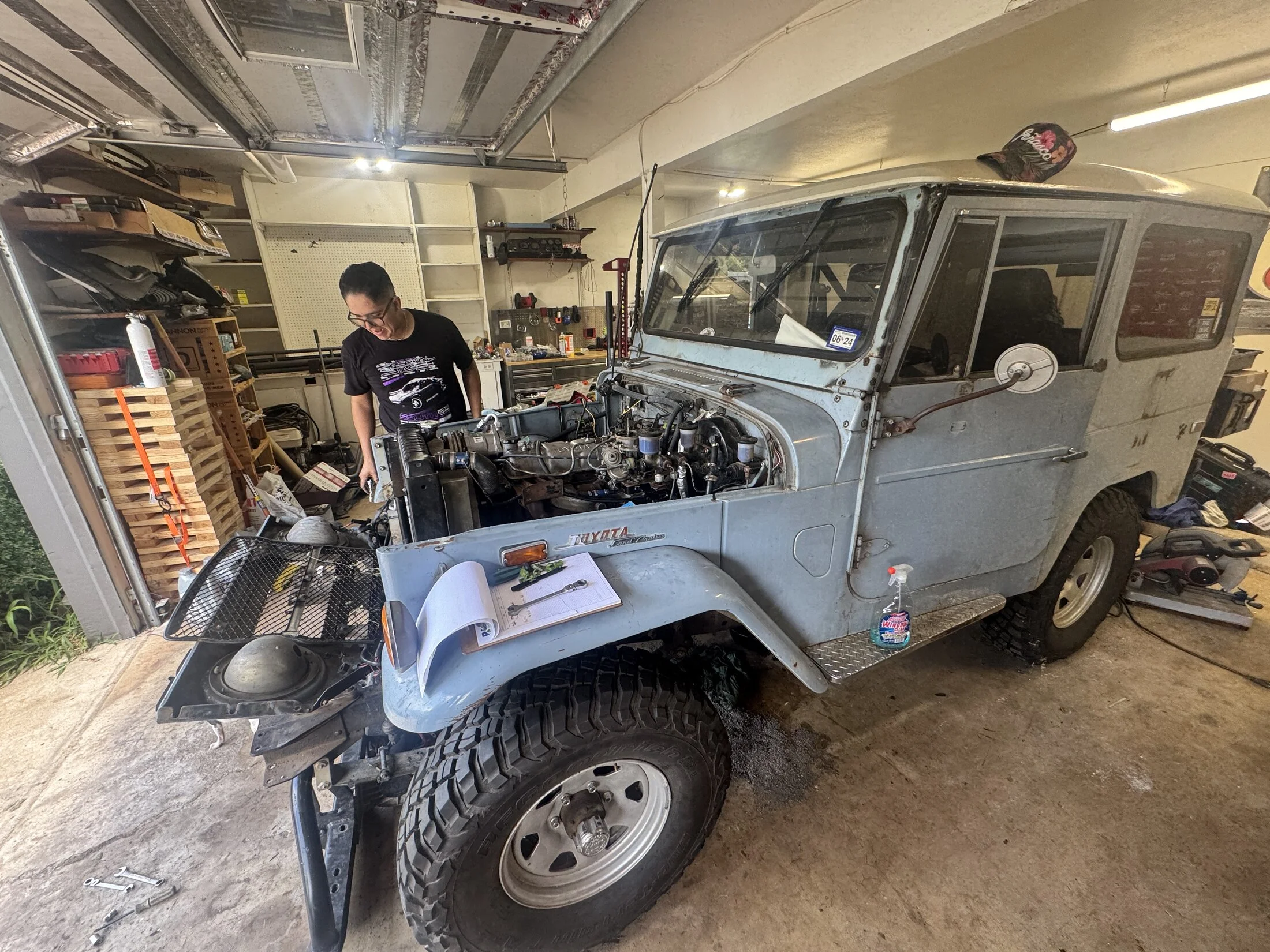

Runs and drives. I need to re torque the carb and fix a small leak.
Ready for some more miles soon.

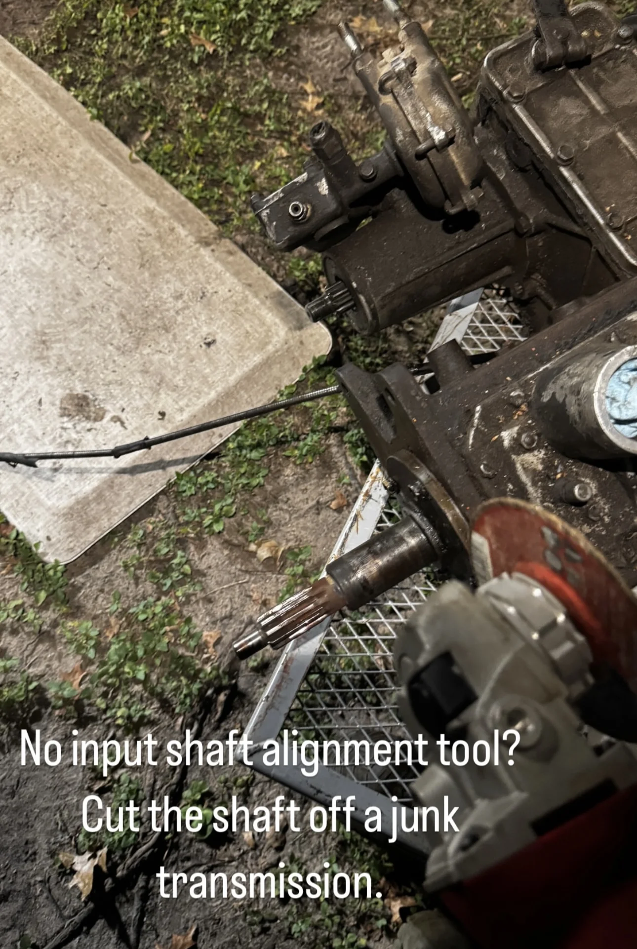

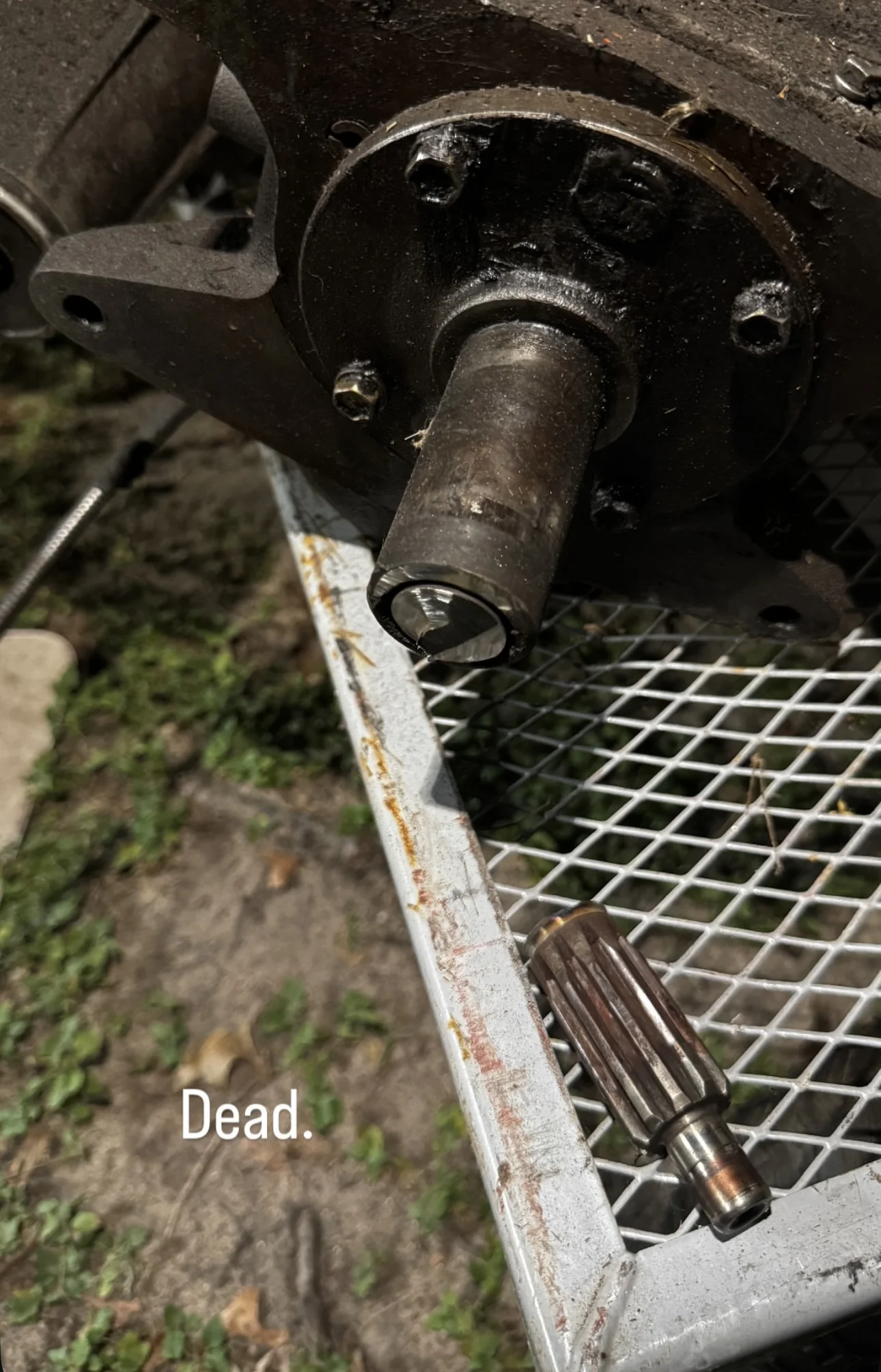

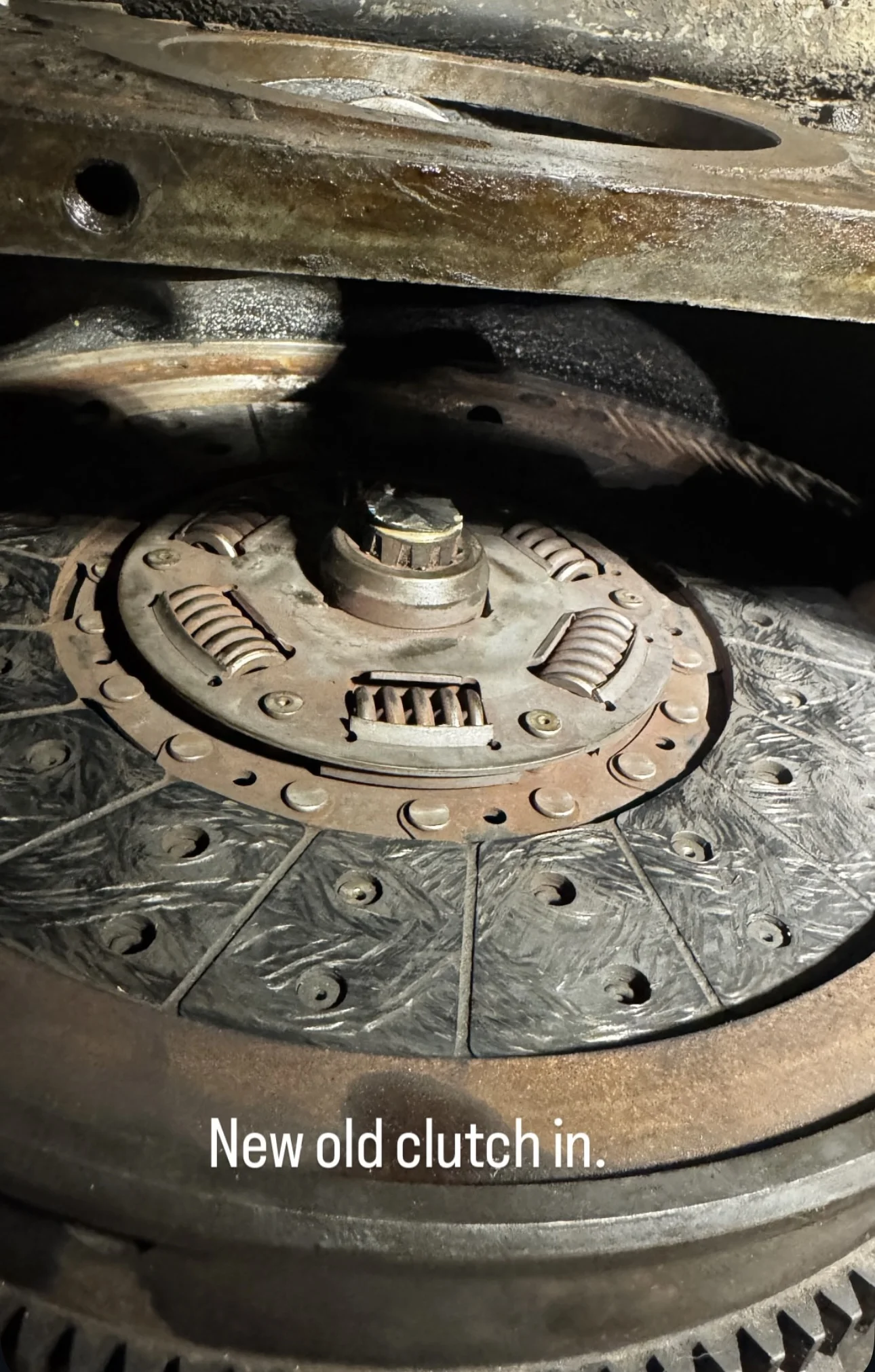

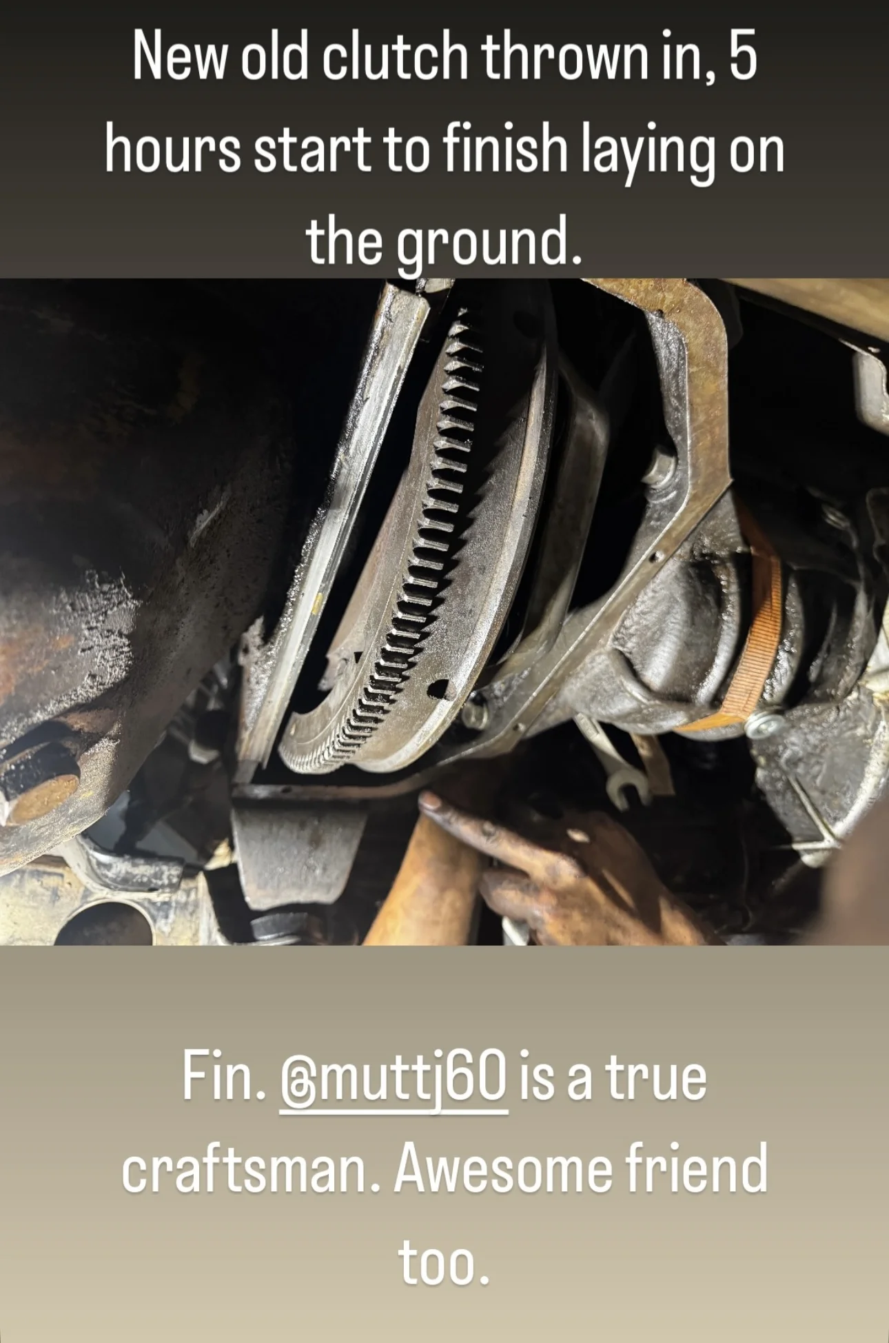

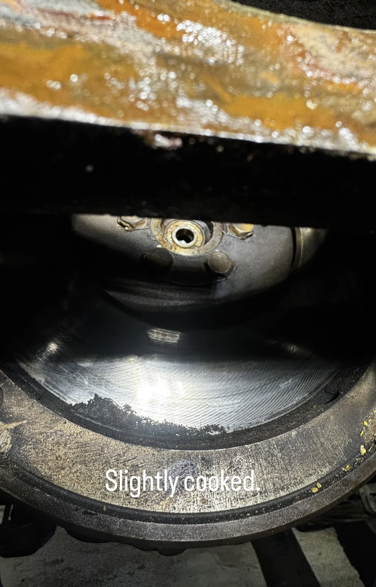

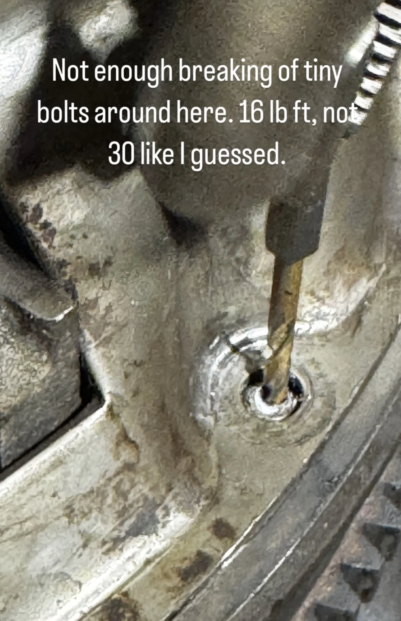

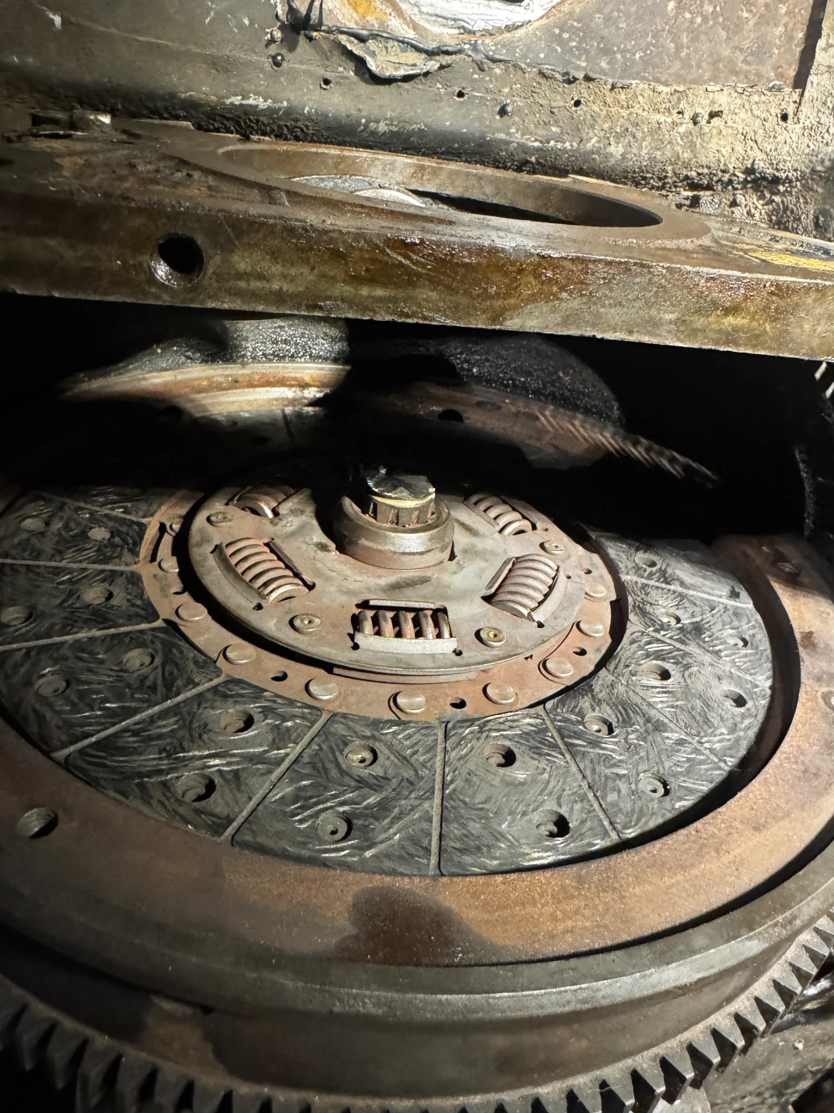

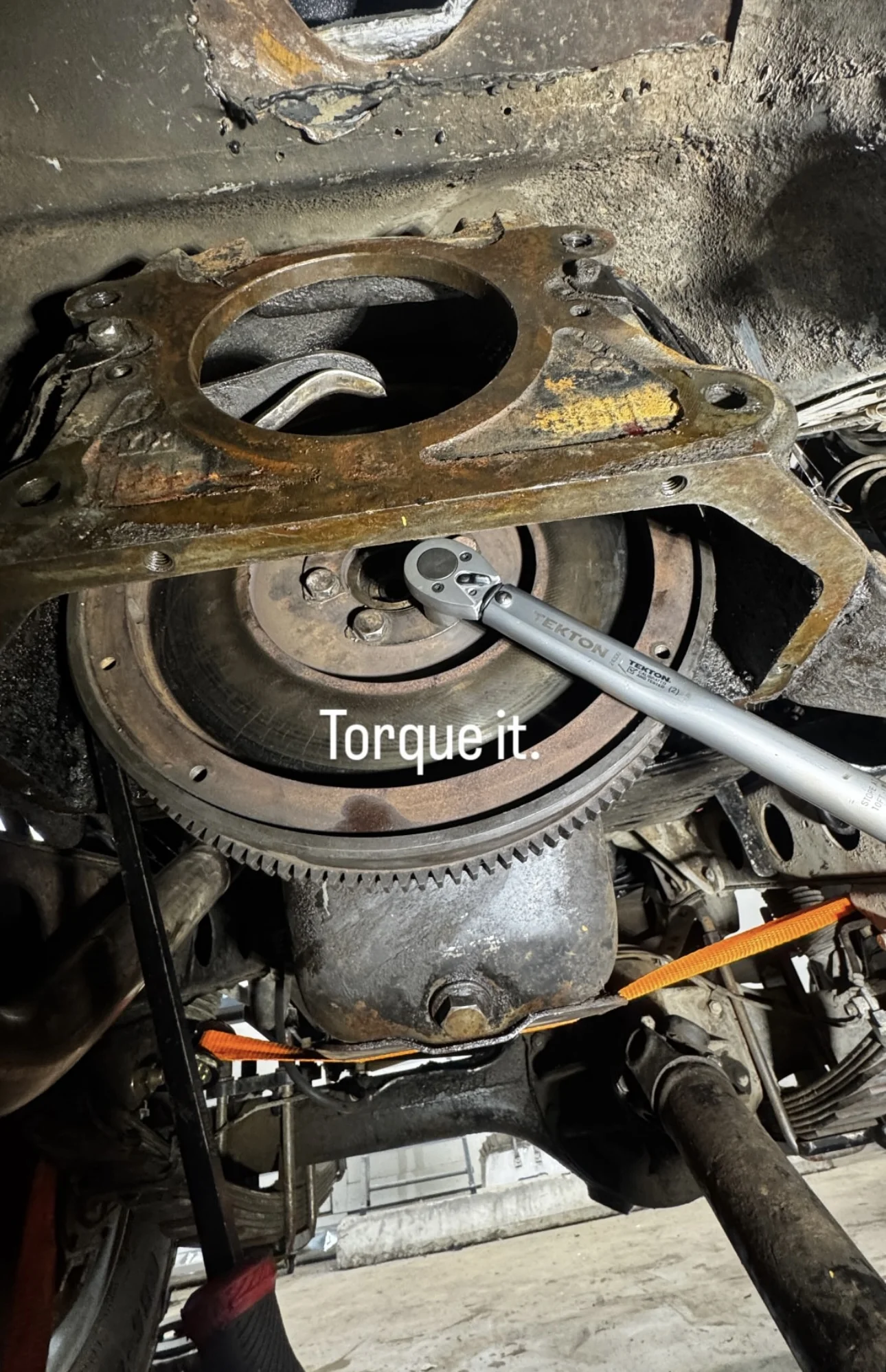

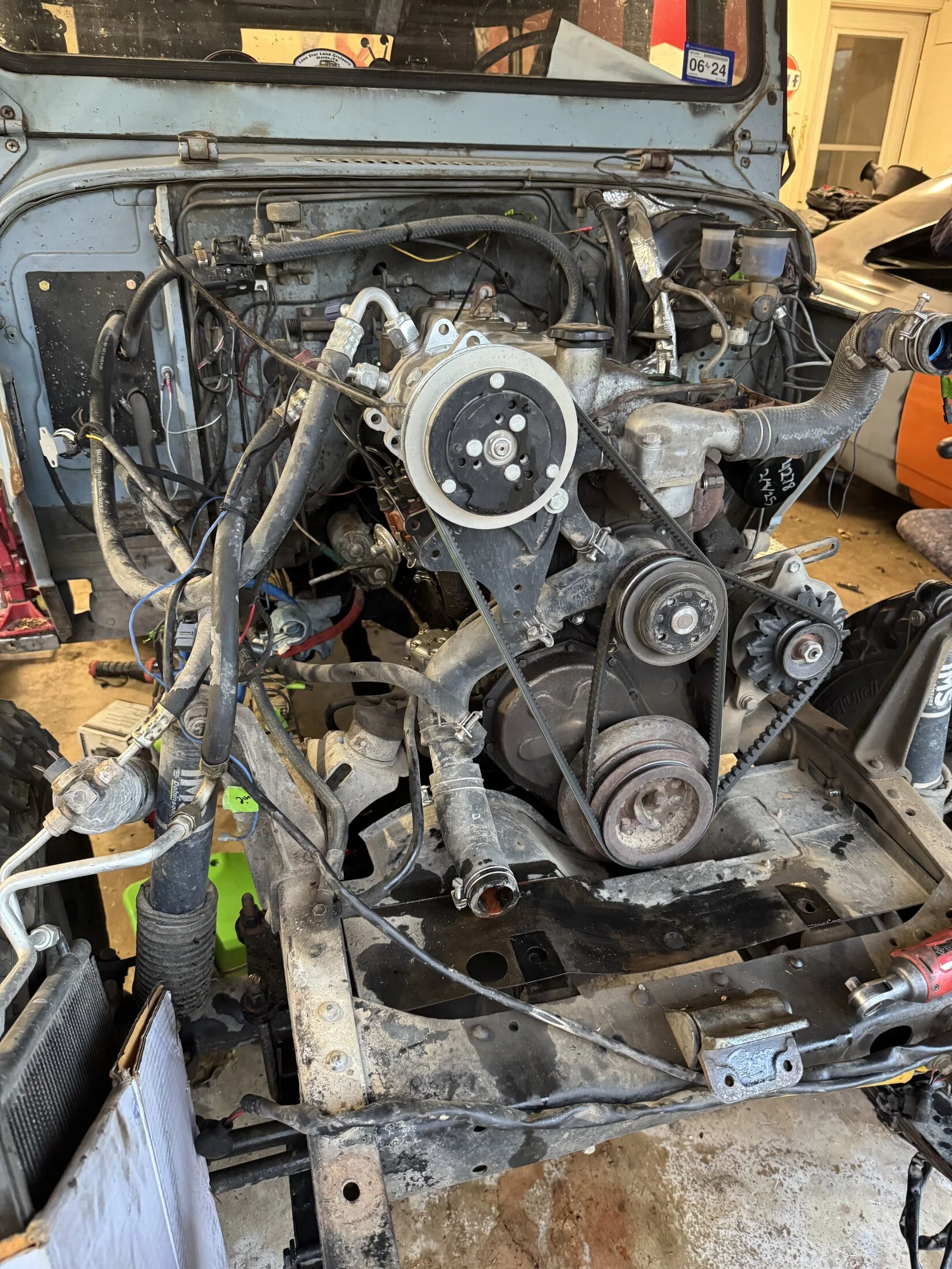

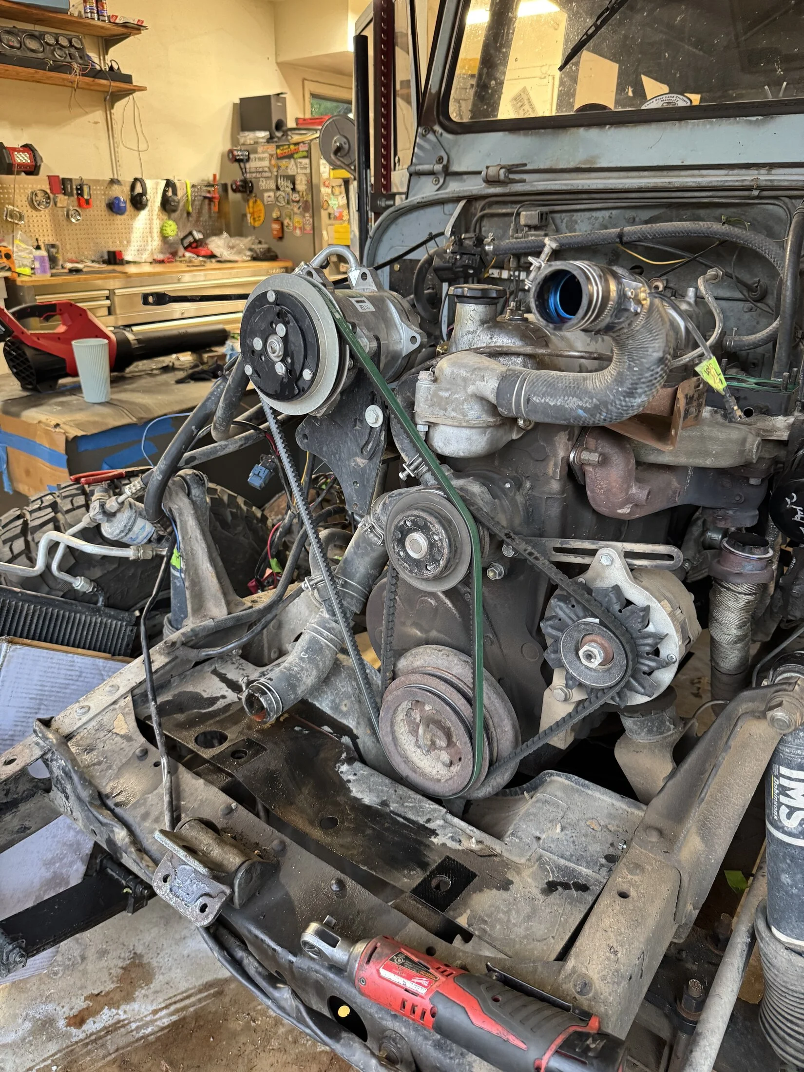

Threw a new used clutch in it. Finishing the details.
It was shuddering and the clutch assembly was cooked.

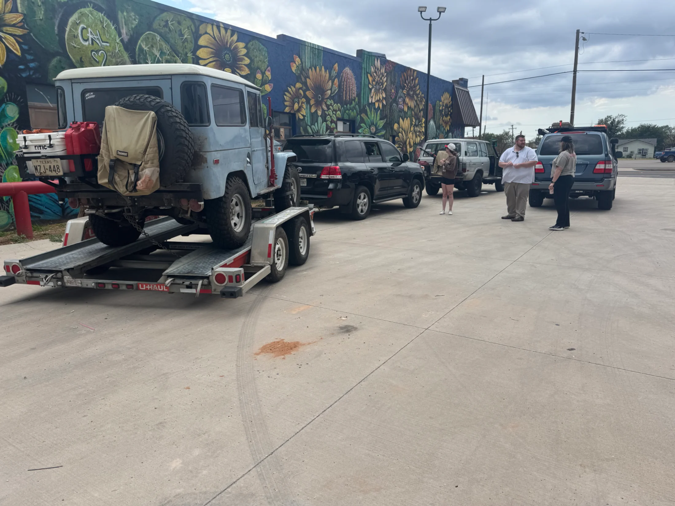

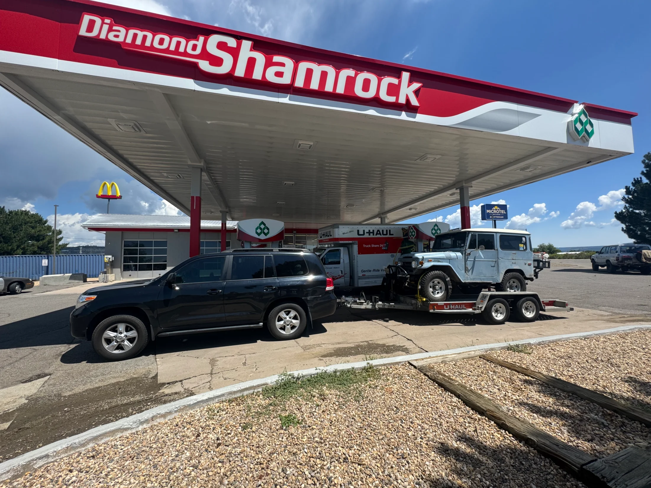

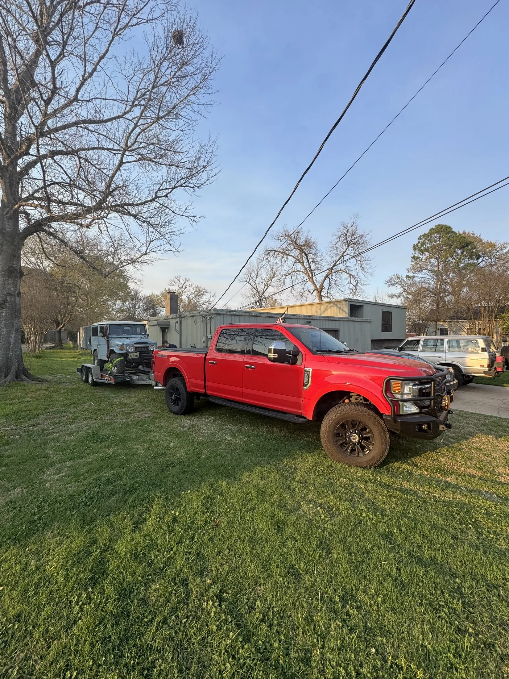

I ended up trailering the 40 and towing with a group coming from Texas. In all the haste to throw the engine in and clutch, I really wanted to get some solid miles before it made it to the trails. Never actually made it on the trails in Colorado 😩🤣 but probably put 200 road miles on the new engine and clutch in Colorado. Next year we will be there and ready for the trails.
The few photos from the trip. Really gotta do better next year. For the record, the cruiser did make it off the trailer. 🤣
Trailer drama after a loud pop.

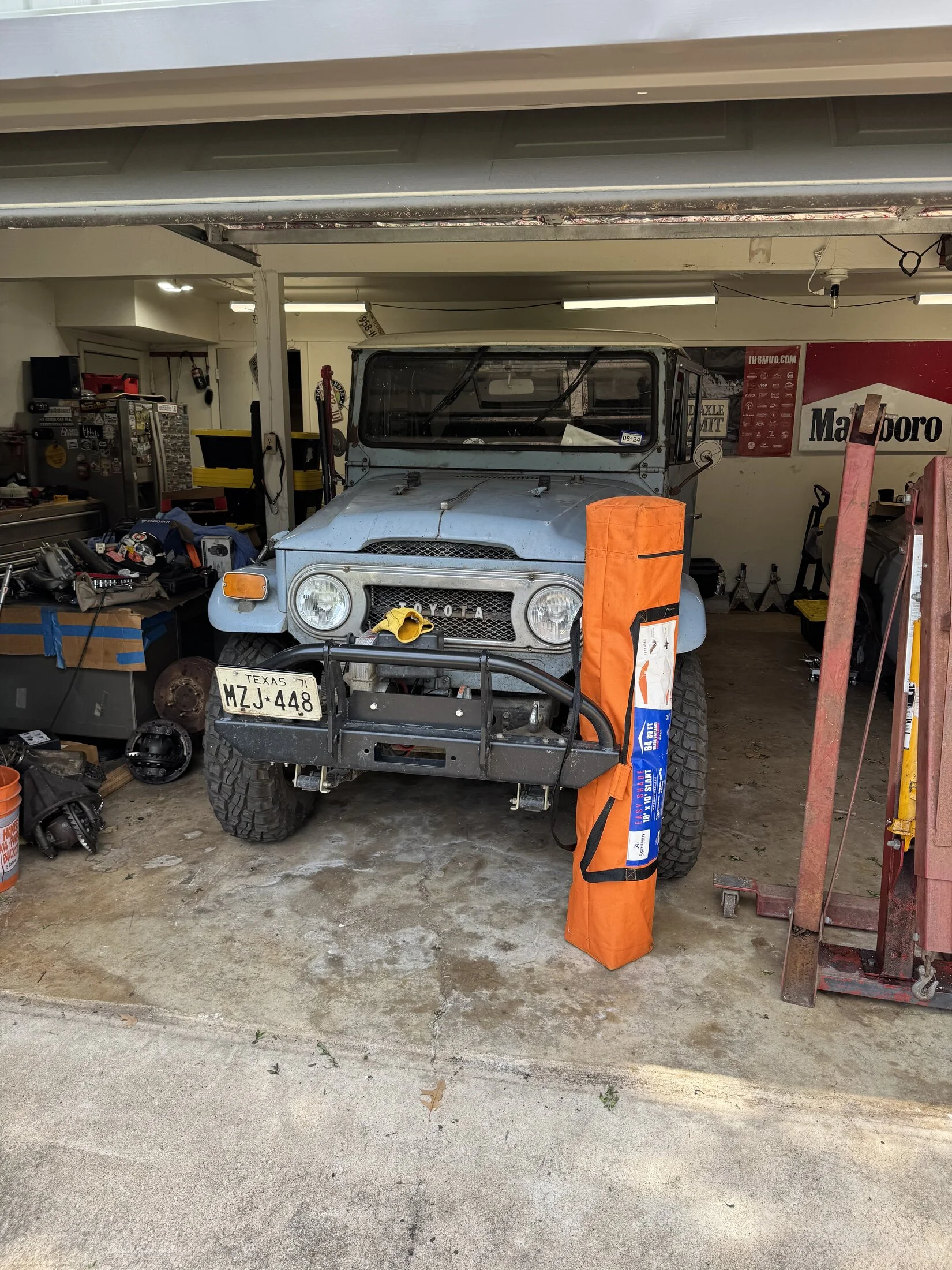

On the other side I’ve got a couple items that will need to get addressed:
1. Emergency brake is non functioning for many reasons: cable drum not connected, significant leak at the rear spline seal. I’ve got a valley hybrids double seal kit and will install soon.
2. AC isn’t connected because the new engine has a single v belt harmonic balancer. The aC is all connected, just not belt driven. Pulled the old harmonic balancer off to try to put it on the new but no go. New one has a nut and the old one was only slipon (WTH???). I tried picking up a Chevy add-a-pulley to bolt onto the front, but it sticks out too much. Not exactly sure how I’m going to address that one.
3. Disc brakes Fj60 up front and smaller one in the rear. The kit was purchased just before blowing the last engine.
4. E-Stopp parking brake. For extra stopping power.
5. Dakota digital dash.
