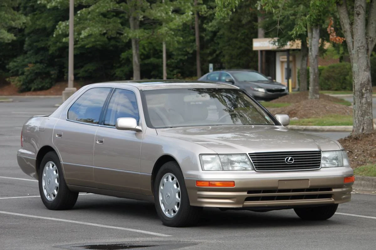

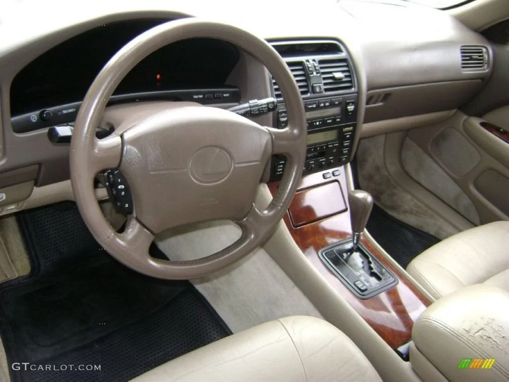

The Lexus sedan LS400 has the identical steering wheel as the 80. Check your local pick n pull.
I've raided my local wrench-a-part for visors and LS400 brakes (for my SC), but never knew I could take the wheel! Can I replace just the wheel and not the airbag? Judging by the existing Toyota logo, I'm assuming so. Do you know if there's a particular year range?
Yep... that’s the airbag from my old 80 wheel. The steering wheel is exactly the same. A direct plug and play to the 80 series. I’m not sure about the year range, but would guess 96-97

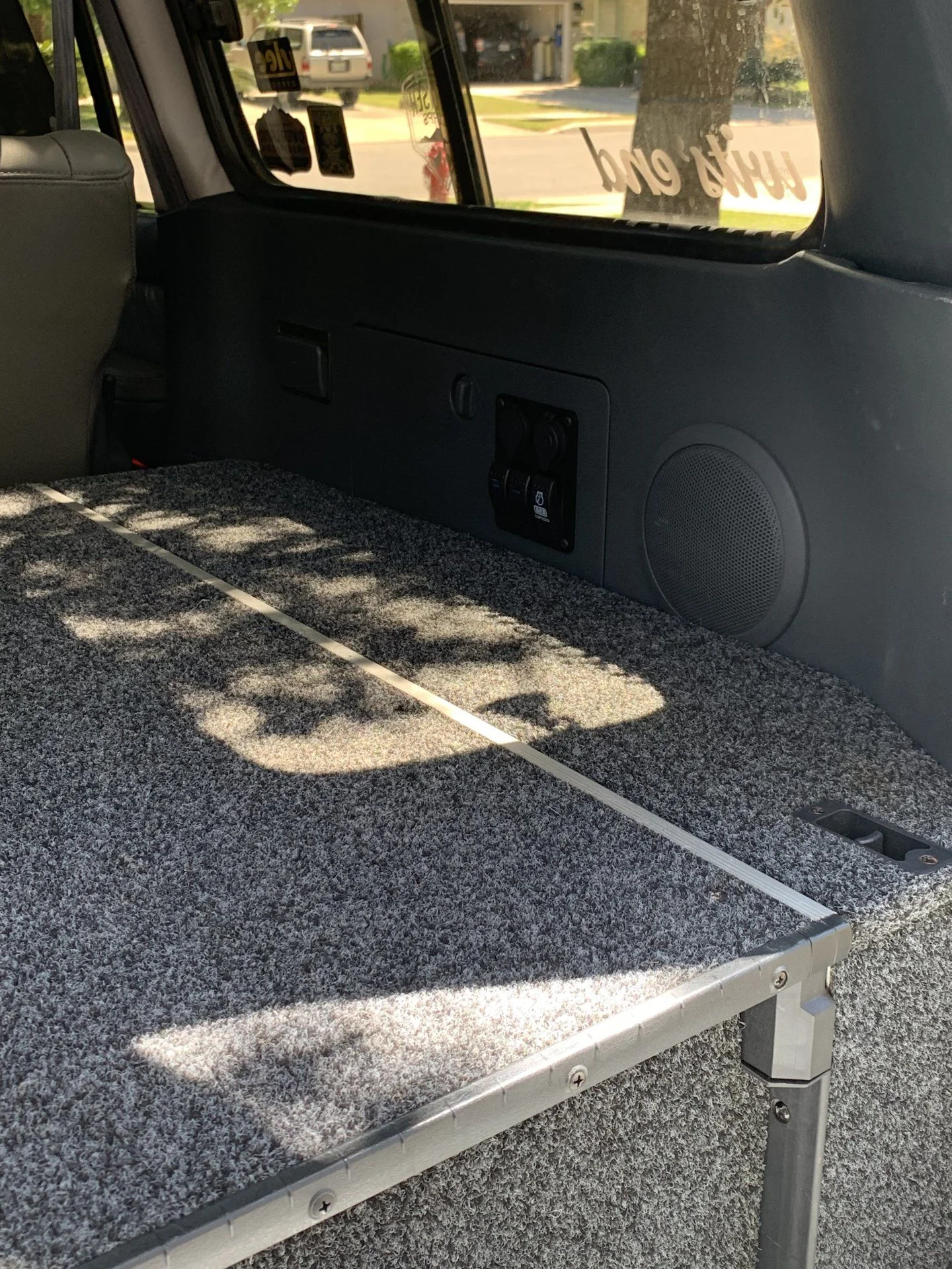

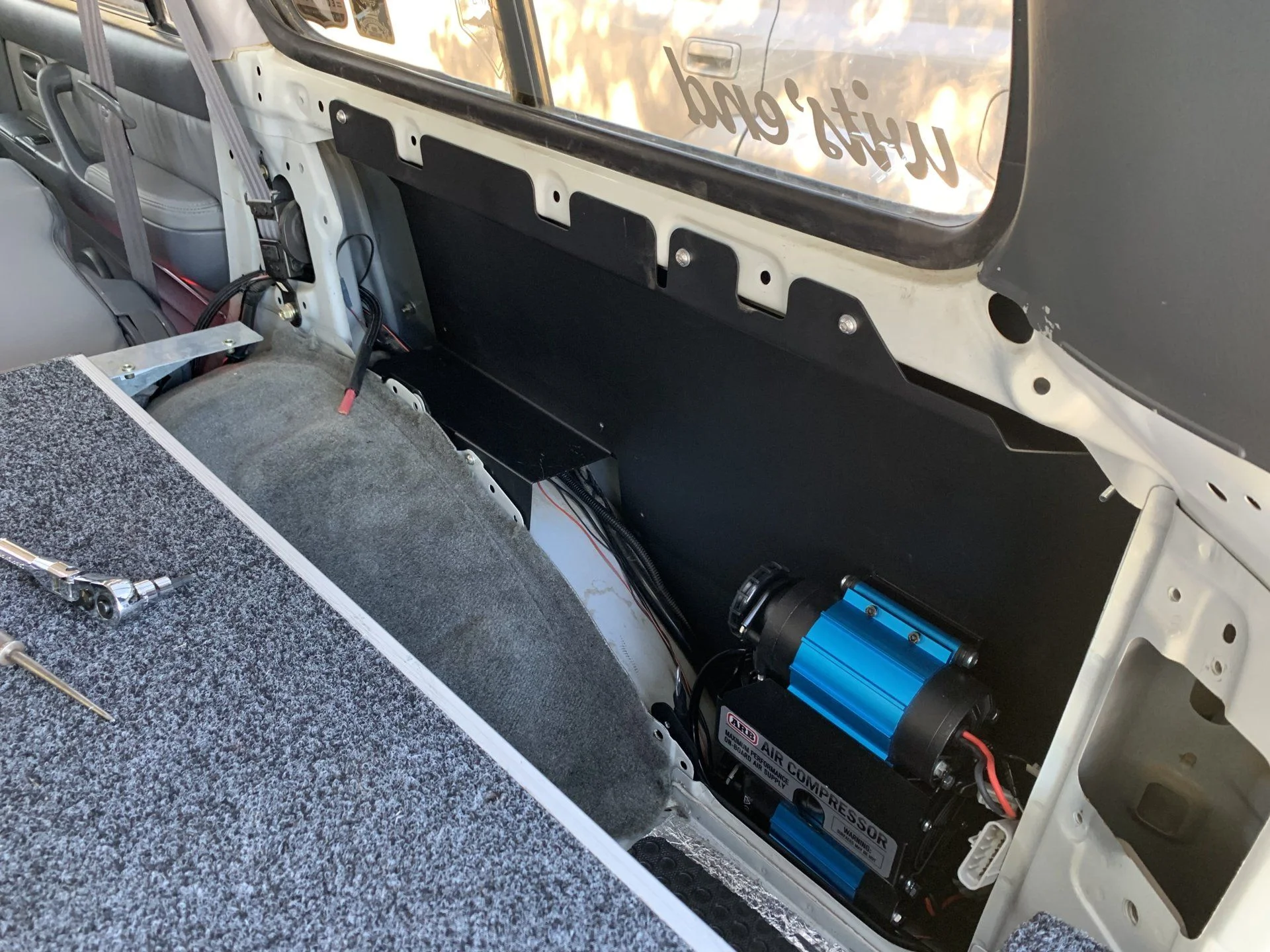

Onboard air is just about done. Just waiting on the RATS setup from Wit’s End, but the compressor is in and operational
The best thing is, it’s all tucked away and you’d never know it was there.

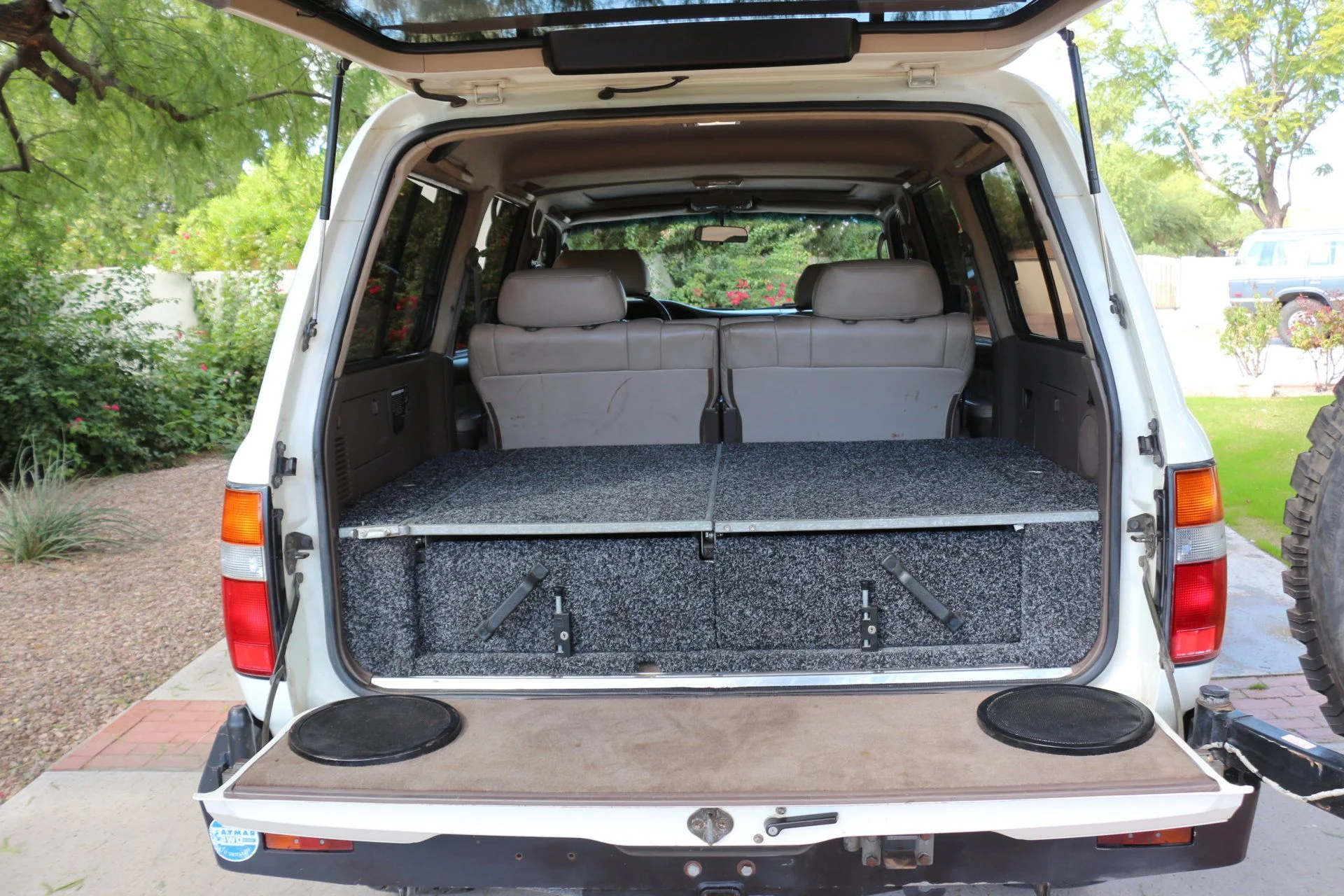

And nice job on the cruiser. That Wit's End rear panel is awesome, definitely on my shopping list.

Btw I've got the granddaddy of your drawer system in my truck. Looks like ARB has made a few improvements over the years, but still pretty similar.

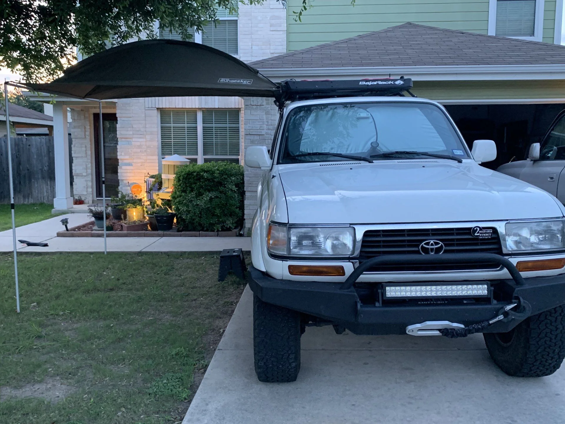

Truck looks great! Did you put OME lift on it? How do you like the sound system you installed, what amp did you end up using? Damn stereo systems cost more than a lift! I saw someone else installed the same one in his GX and I’m thinking about it. I like the component pioneer system I put in my jeep better than alpine. Enough questions for now. Keep up the good work!
Thanks! I really like the stereo. It can be glitchy sometimes when using CarPlay. Sometimes I have to reconnect my phone to get it to recognize my phone, but that’s not a huge deal.
I’m running just the four door speakers. I deleted all the other speakers, including the sub. I needed that space anyway. Since my factory amp was blown, I just took it out and I’m using the headunit only to power the speakers. It sounds good to me. It’s not going to win any awards, but I am not building the truck with the audiophile in mind anyway. It’s defin capable of much more than I’m currently asking of it.
The lift is indeed OME. Very original, I know haha. Another Mud member was selling a NIB setup that happened to fit my needs perfectly, so I jumped at the opportunity to take advantage of the discount.
I’m running OME 2850 heavy springs in the front and OME 2864 extra heavy springs in the rear.
CaptClose, great job on the install I like the way the compressor goes in there and the plugs on the other side. I will be looking at you’re post when I do mine. And I am ready with my second battery and have everything relocated and the battery box put in place so again great job.
Let me know if you have any issues brother. I’ll be glad to share what I’ve learned.

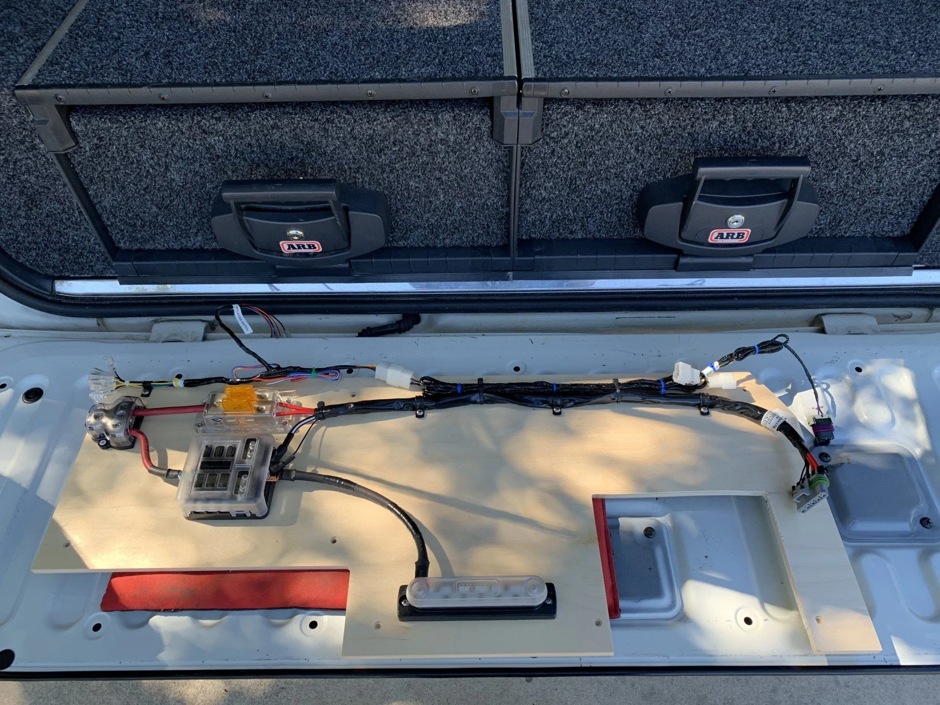

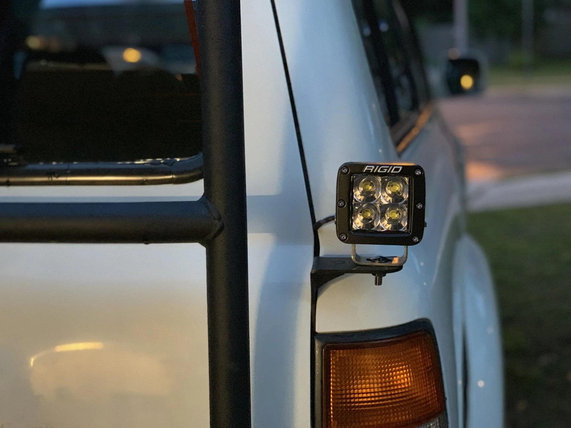

Added some rear lighting a few weeks back.
Don’t cringe. I painted the bare metal and put a tight fitting grommet in the hole.

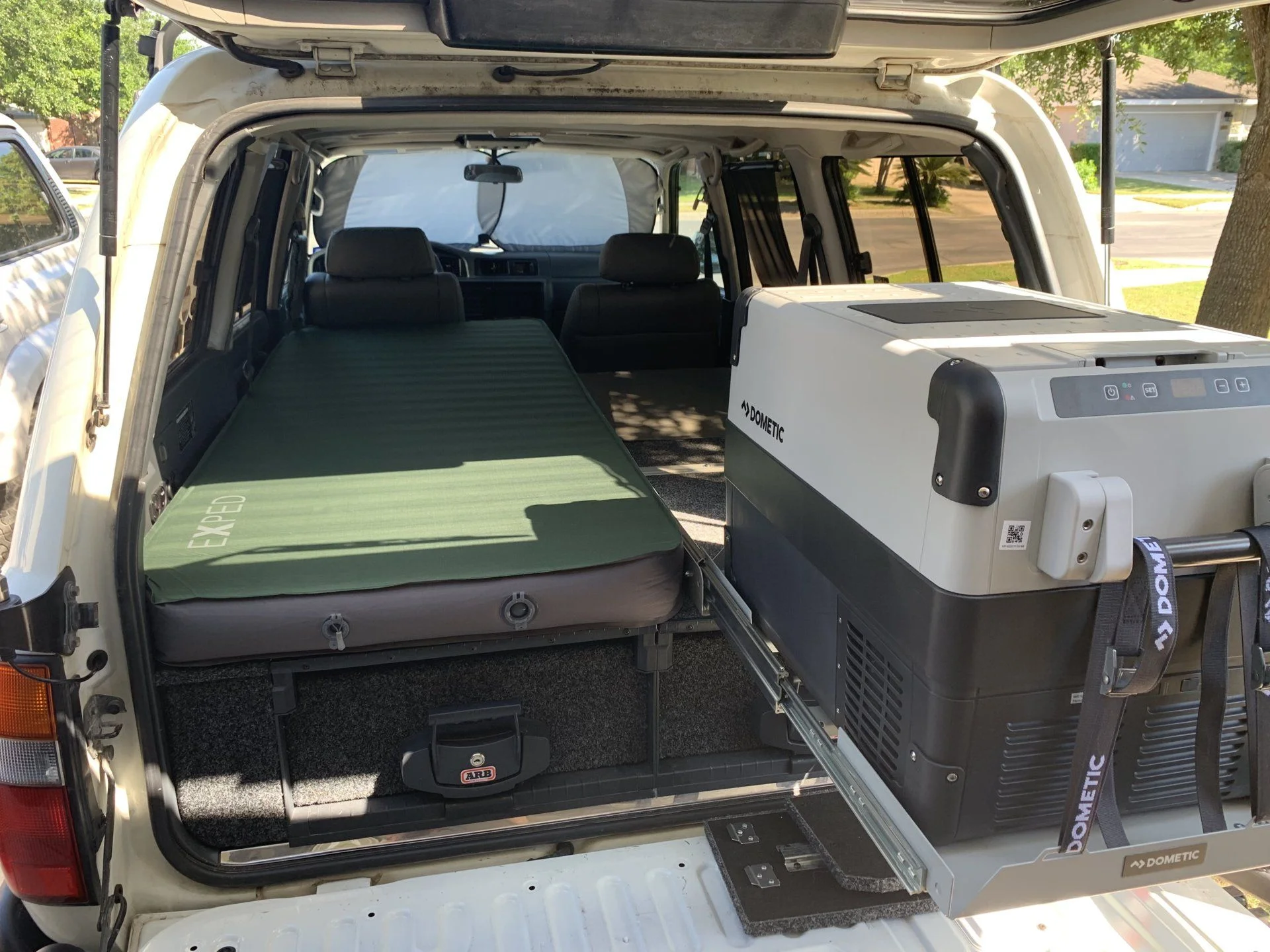

Also got my fridge and sleeping mat all test fitted for the Solid Axle Summit in Colorado this year. I’m finally giving up the ground tent.
Just waiting for my fridge slide to come in and I’ll get that secured to the drawers.
