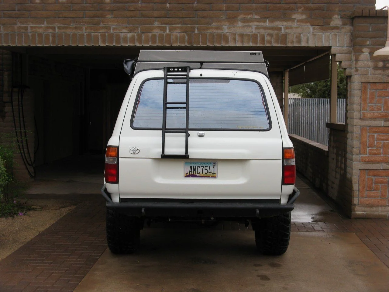

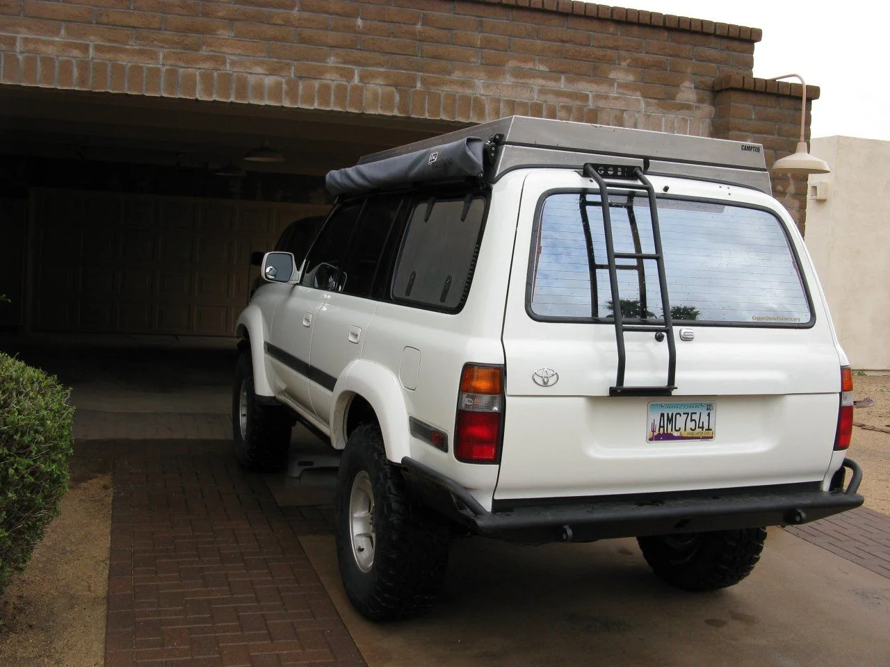

Been wanting a rear hatch ladder for a while now to access the top of my CampTeq for a quick access to the viewing platform. One of our CSC club members took a chance and ordered one and after checking it out I knew it was the one for me.

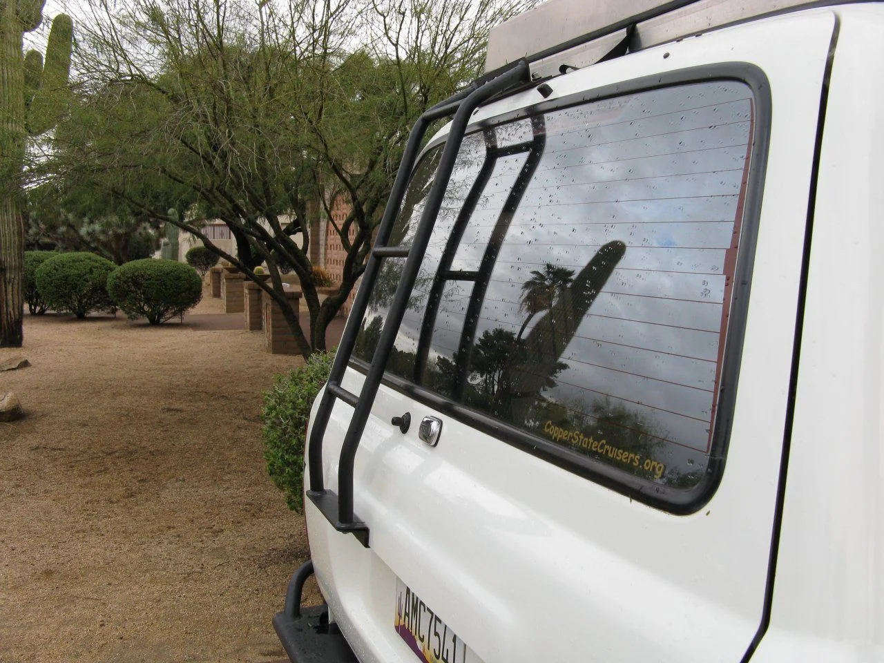

Comes packaged well with all the needed hardware for a complete install. The design and the way it attaches to the hatch is first rate. The only other tool you really need to complete the install is hand pliers. Instruction are complete with lots of pictures(5 pages). I did the install but did not like the way it covered the Land Cruiser emblem. I decided to removed the emblem and start L-o-n-g tedious process of removing the adhesive under it. Once removed I hit it with the buffer and its hard to tell it was ever there. It does look naked back there and was thinking maybe and emblem from a 60 series???
The ladder is very solid and secure much so than I would of expected. At 200lb it feels like it could take much more weight making the hatch the weak link. Also with the additional weight my original strut still lift and hold the hatch open just fine for now.
Retail pick up price $180
