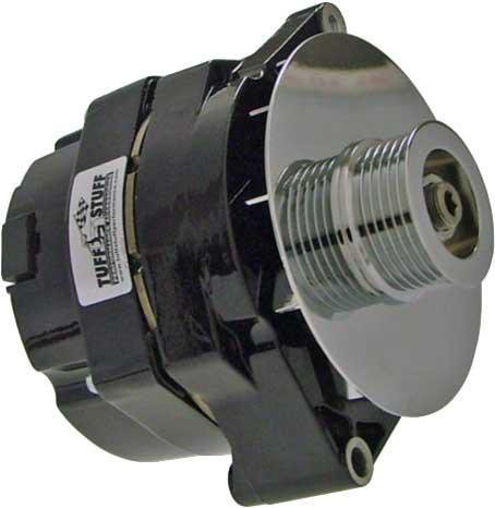

What about Tuff Stuff?
They are brand new...
100 amp / $90
