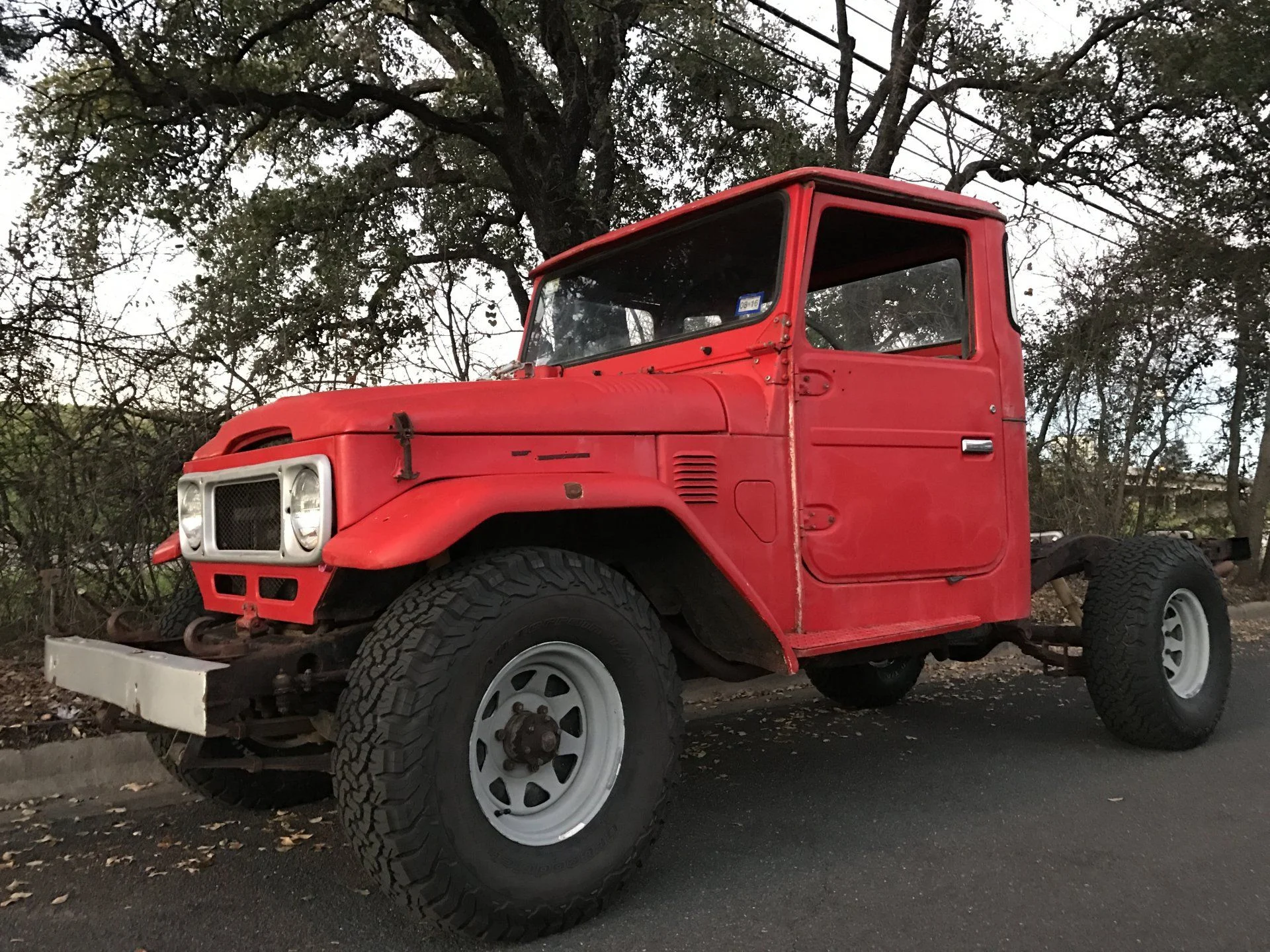

Needing a bit of help with my glow plug system on my 1980 HJ45...Currently runs and drives but only by a using a ghetto Wilson switch if you can even call it that. The way the PO had it was to basically warm up the plugs directly with the battery. also using a direct wire to the battery to pull in the fuel "pull bar" not sure what that part is called (on the left with the yellow cable) and (orange one connected to the busbar) once both of these are touched directly to battery it will start and drive down the road great. Trying to figure what exactly i need to do to make this operate the way it was designed. As you can see i'm fairly new to diesels..(1st one 1st week with it :D)

What year is that? 1979? 80? Looks like an H.
Sorry my computer died mid description on this post... But its a 1980 I originally thought it was a 2h but now that I wiped the engine block down I only see (H-73362) I guess its just an H
(I need to look up the differences betweens the two now :hmm:)
