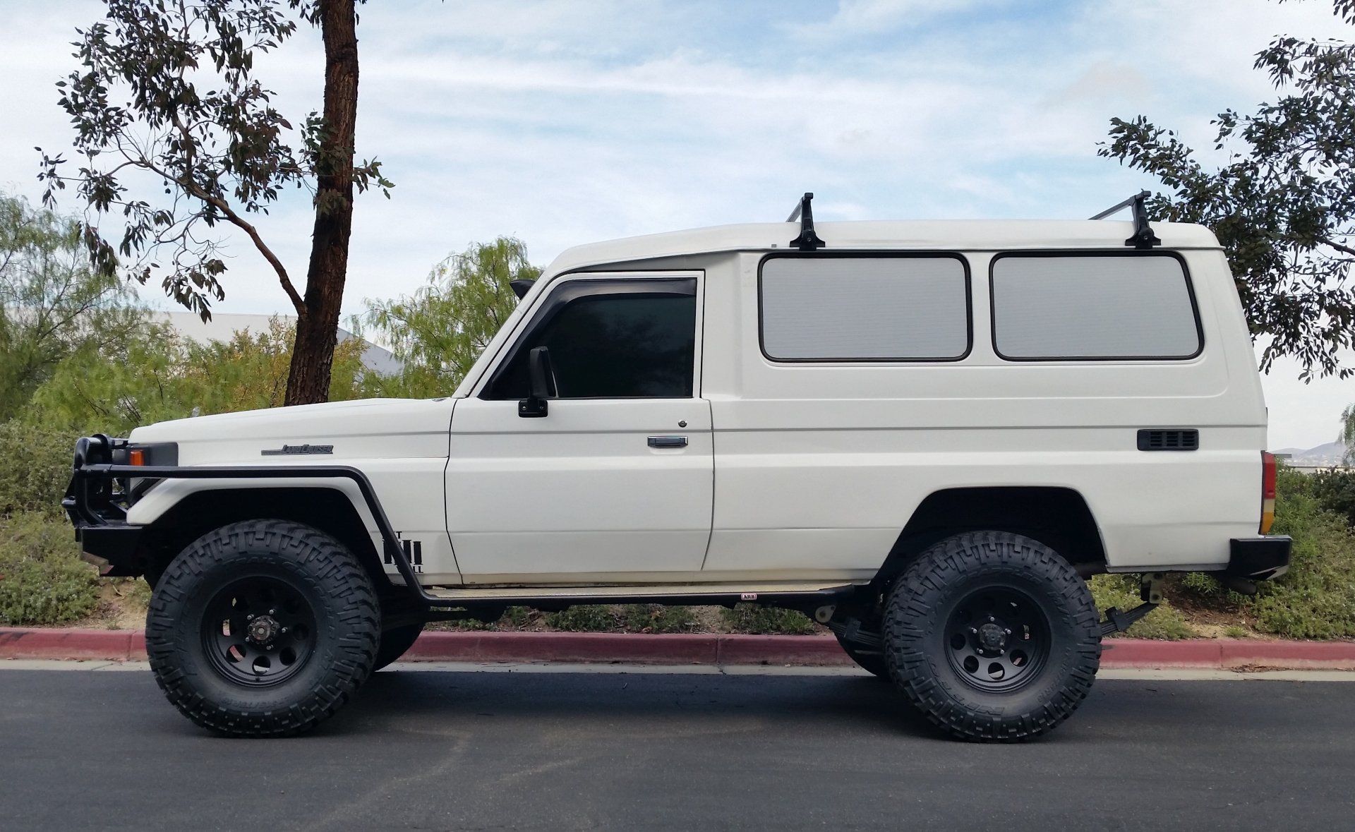

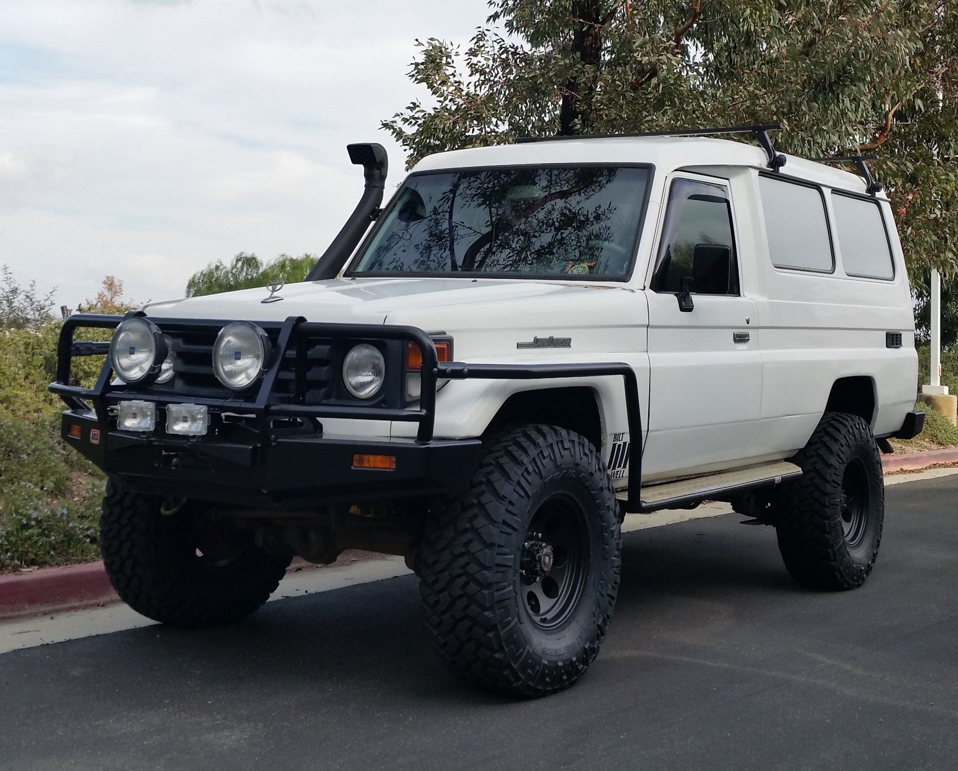

1. 2002 HZJ78
2. ROUSER
3. Panama (currently in California)
4. Panama
5. 257,XXX Km
6. OME lift
Safari Snorkel
ARB front bumper
ARB 76 Series rear bumper
ARB side protection and steps
Hella Ralley 4000 driving lights
Hella 450 lights
Ciebie headlight lenses
Orsam Nightbreaker H3 bulbs
Rigid Industries diffused D series back up lights
LED under hood light
Blue Sea batt switch and ARC
Dual Interstate batteries MTP-27 & SMR-24
Dual digital voltmeter in dash
Autometer tachometer, pyrometer, and mechanical oil pressure gauge
Yale door locks
Backup camera and monitor
Magnetic drain/fill plugs in diff, tranny, and transfer case
Safebrake extended SS brake lines
Trail-Gear rock rings
Pro Comp 69 Series wheels (powder coated black)
Nitto Trail Grapplers 315/75R16
Magna Flow 14" muffler (2.5" diameter) with side dump (not in pic)
ARB Twin Air compressor (not yet installed)
7. Daily driver, surf chaser, part time home

Love your build and such a clean Troopy for it's age and mileage. How long have you had it?

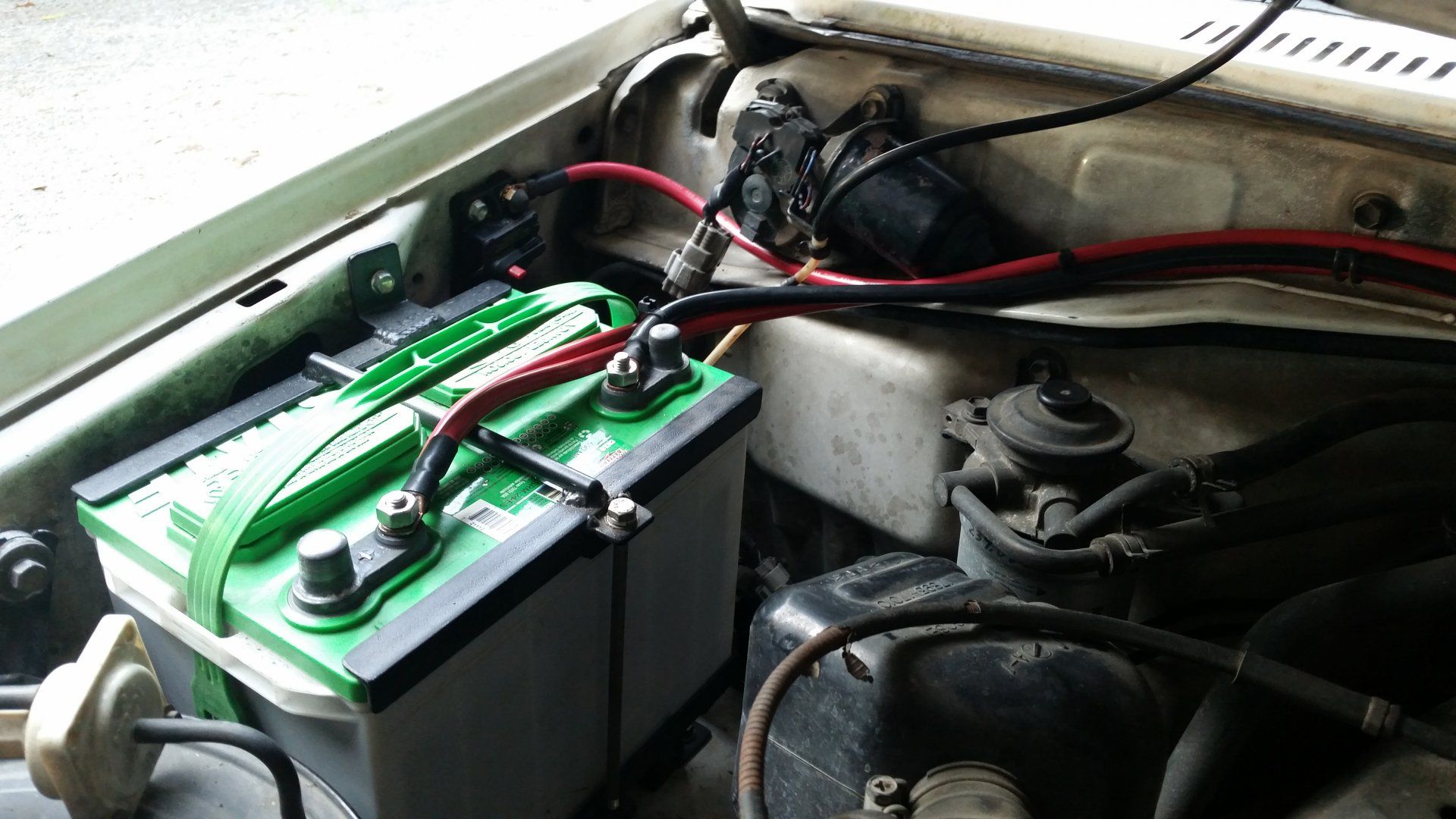

Did you do your own dual battery system design? Would love more detail on that. Which dual voltmeter?
Could you go into the Yale door locks? I've never heard of such a mod before.

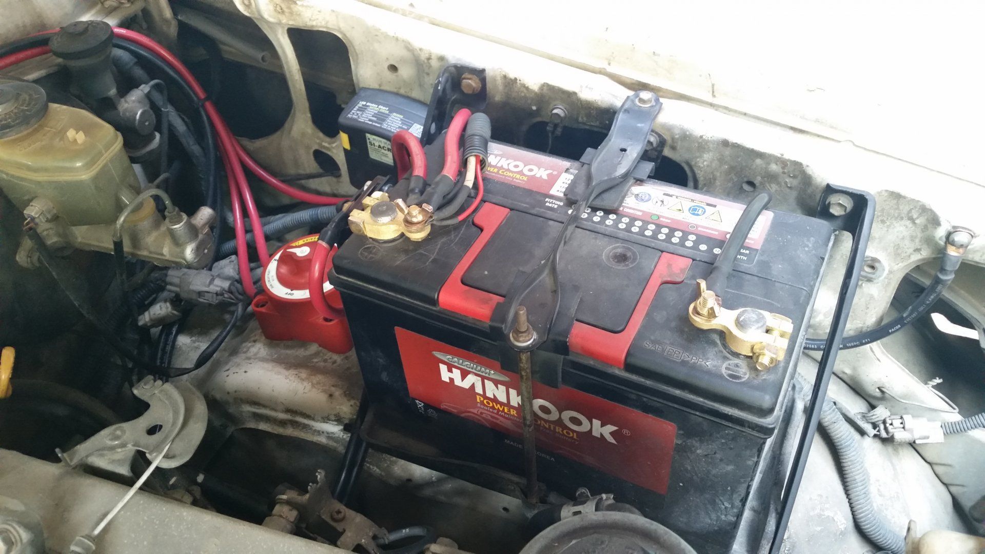

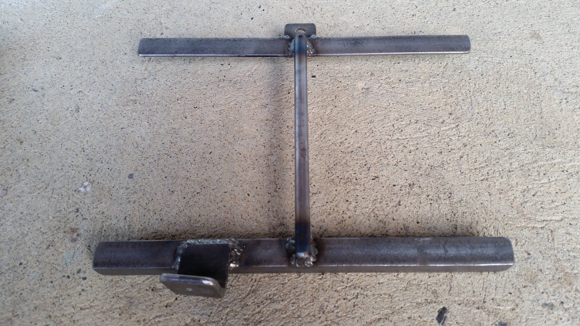

As for the dual batt, I made my own tray and mounted it on the passengers side next to the air box in the engine bay. Made my own cables with tinned 4ga wire, used a Bussman circuit breaker at each battery, run to the Blue Sea switch and ARC.
Disregard the Hankook battery, there is an Interstate one in there now.
The voltmeters are off Amazon, and fit perfectly on the faceplate below the a/c controls.

Great rig, need some more detail on those arb side steps, would you consider them sliders? Would they be able to hold the weight of the vehicle say if you put a highlift on there?
I would not consider then "true" sliders, they are bolted to the frame and are stout. Definitely can save the rocker panels from being crushed by boulders but not designed to slide/glide over them. More of a "nerf" bar in my opinion, have already used them on a horse and a lawnmower with no damage to the troopy.

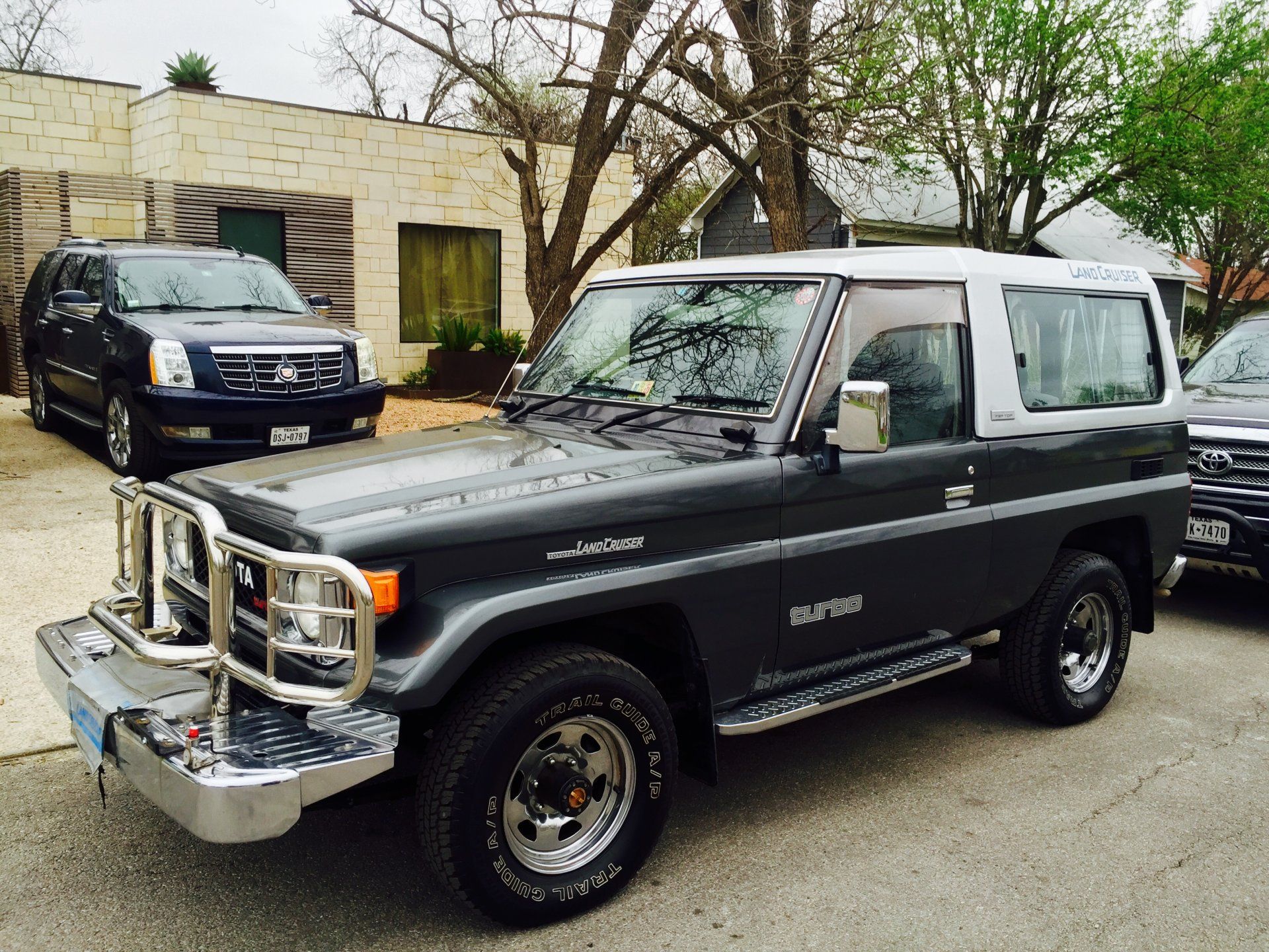

1. Year and model of vehicle
1989 BJ74 Land Cruiser (2dr) Turbo Diesel
2. IH8Mud Handle
TXBJ74
3. Location of vehicle
New Braunfels, TX
4. Country of Origin (by this I mean the country it was first shipped to- ie, my 70 is in the USA, but was originally for the Canadian market, so the country of origina would be Canada)
JDM (Japan)
5. Mileage on the truck odometer, in KMs please
165,043 KM
6. Modifications, if any
ZERO - All original and show condition
6. How you use the truck- DD, trail rig, garage queen, etc.
Trot around town showing off.
7. Photos are fine, (you must post them) but please limit them to 1 small jpg[/QUOTE]
