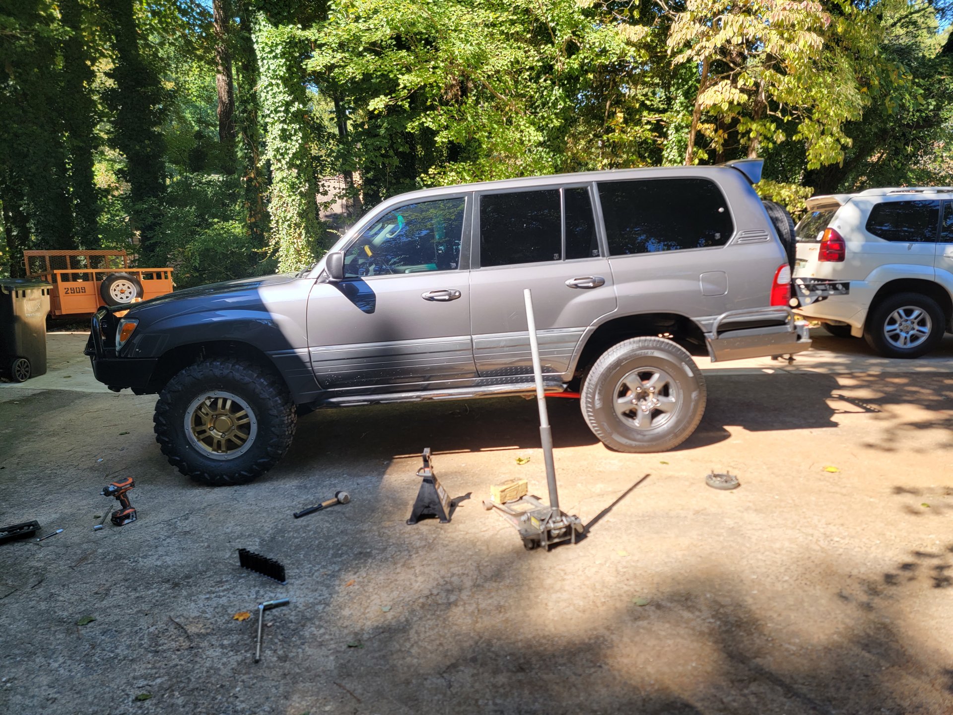

No mud on the New Balances. I swapped the Toyos on to the truck on Saturday. Are you asking if the Toyos perform well on the road? If so, they're fine. Ride like s***, enough that I just bought a whole new set for the street.
On stands, trans in neutral, manually turning the tires. I was trying not to trigger ATRAC. I never put it in drive as I felt that the intertia of moving and then stopping the Toyos, or having ATRAC grab wheels, was probably not the best idea on jack stands :meh:

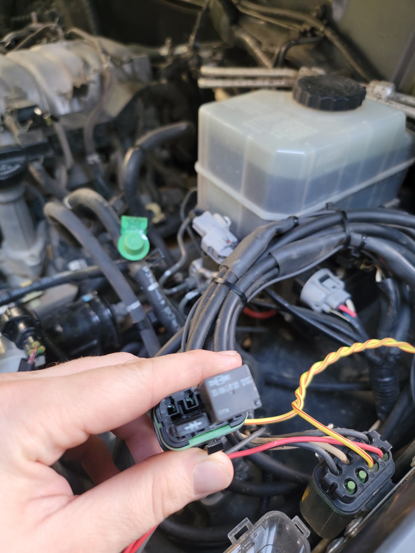

We fixed the locker. Turned out to be, best we could tell, a little corrosion on some connectors under the hood. Cleaned, added some dielectric grease. Boom, easy peasy.

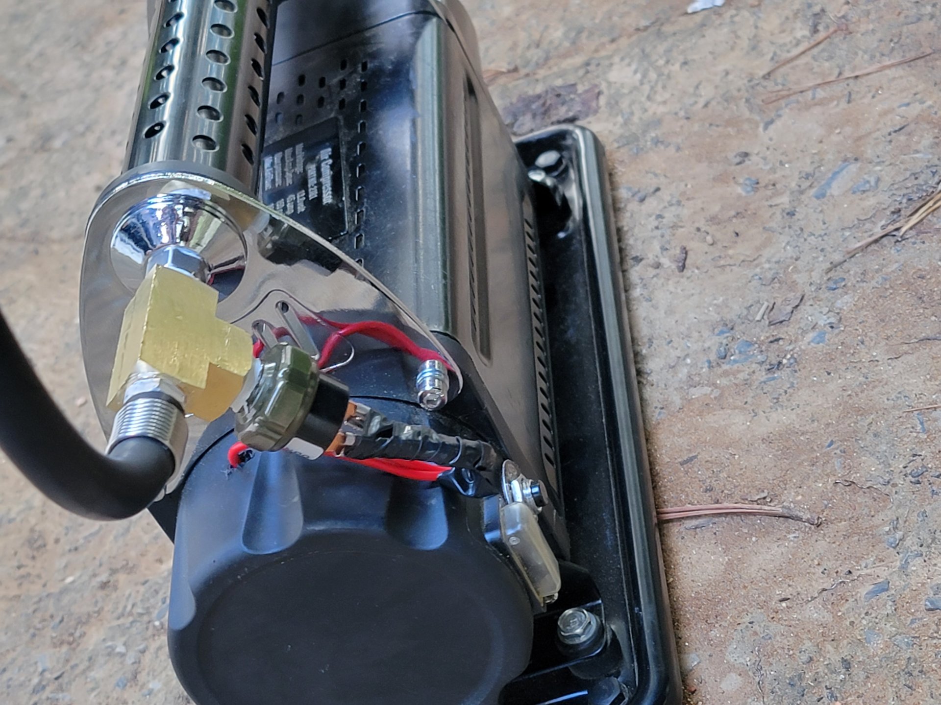

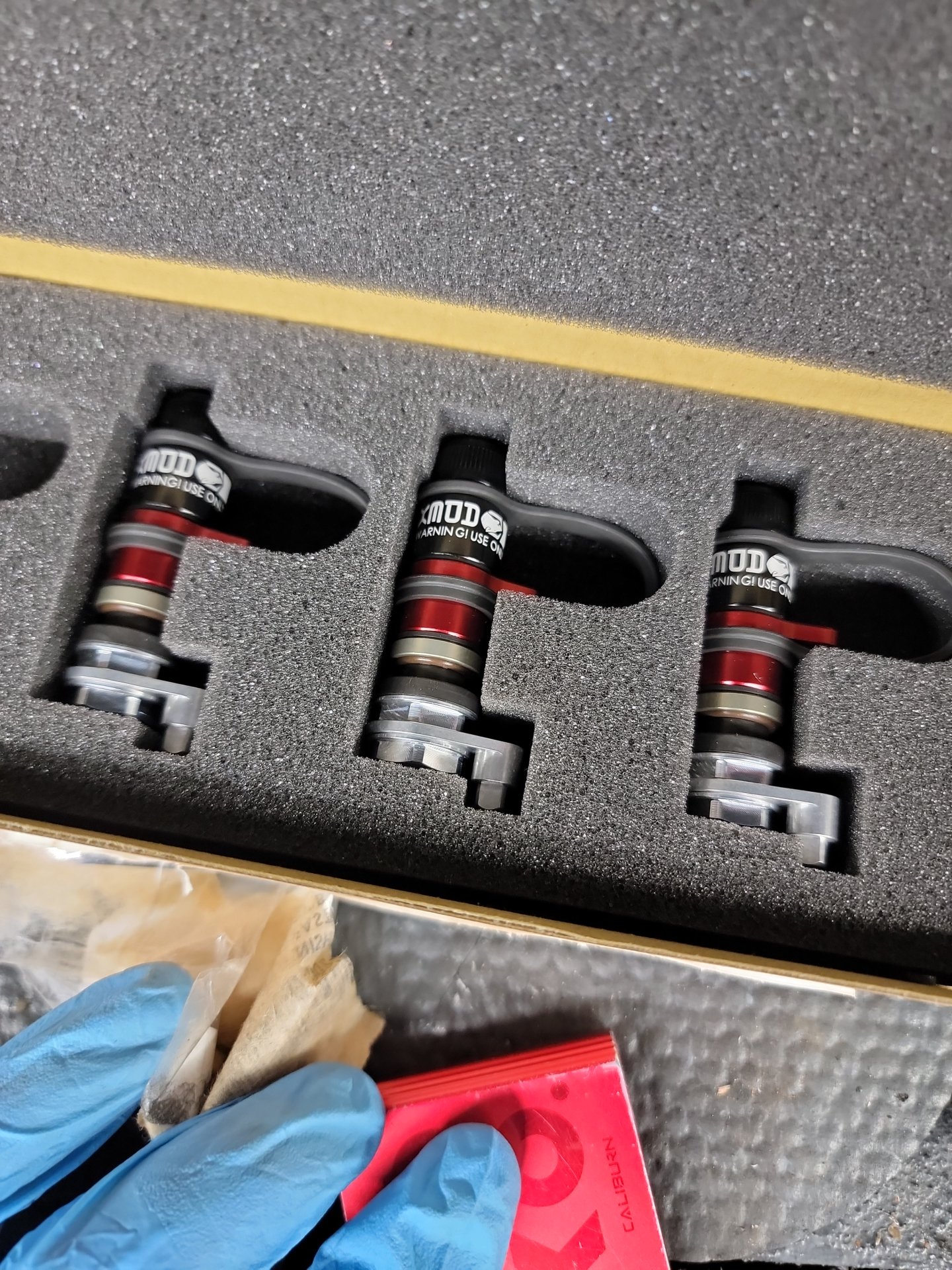

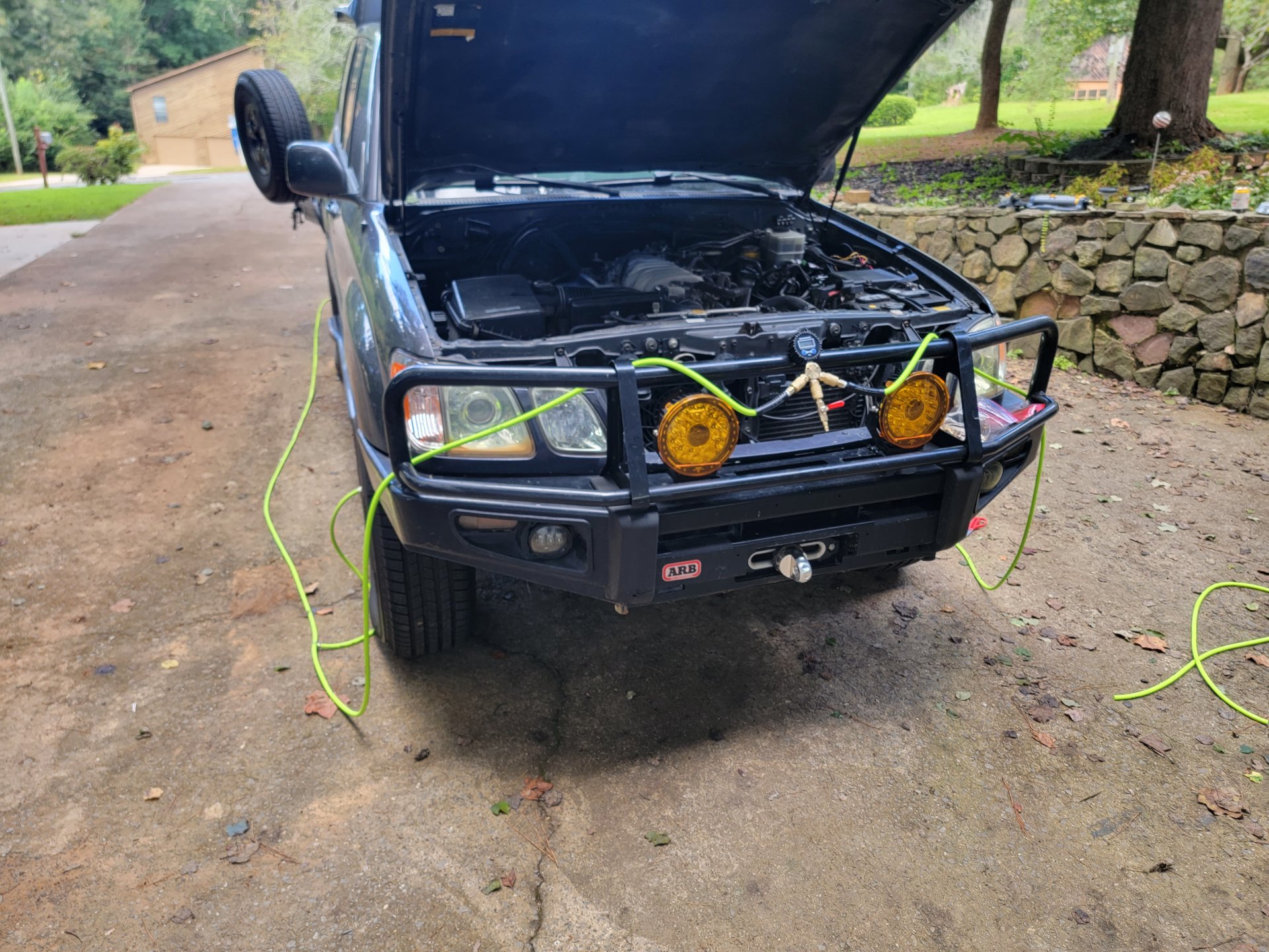

Then I decided I didn't like airing up or down the way I have been. So I ordered some fancy Apex Performance valve stems and made a 4-way inflator rig. Also wired up a pressure switch to my compressor.

What do the new valve stems do?

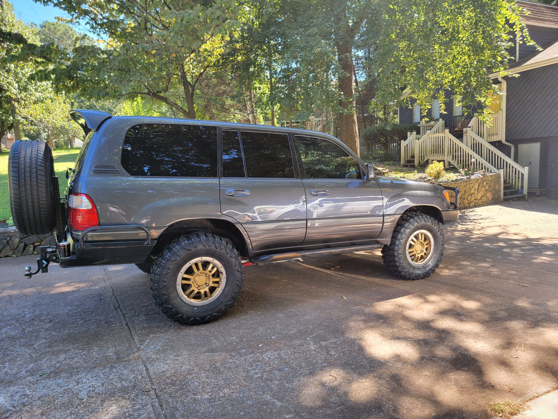

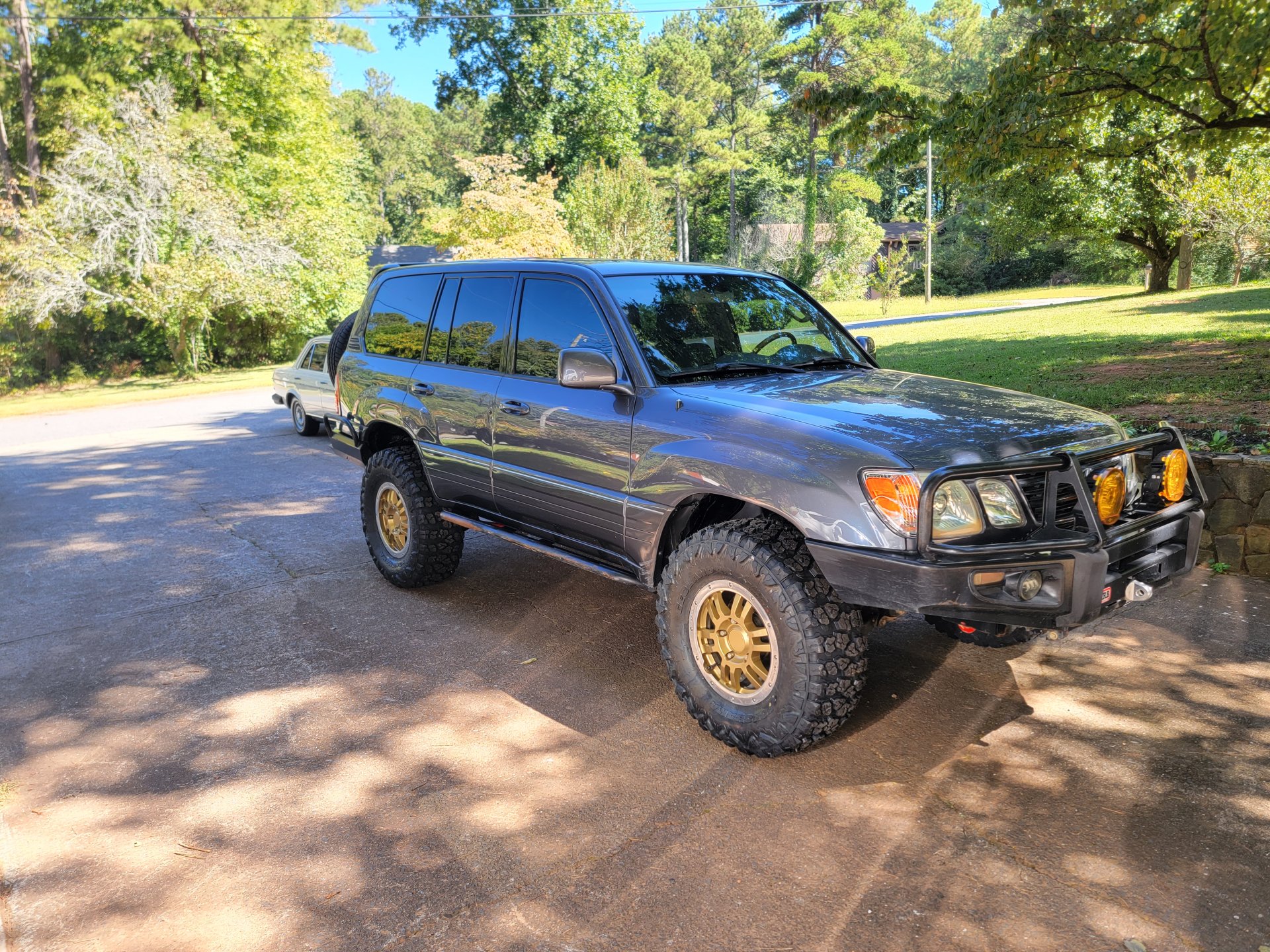

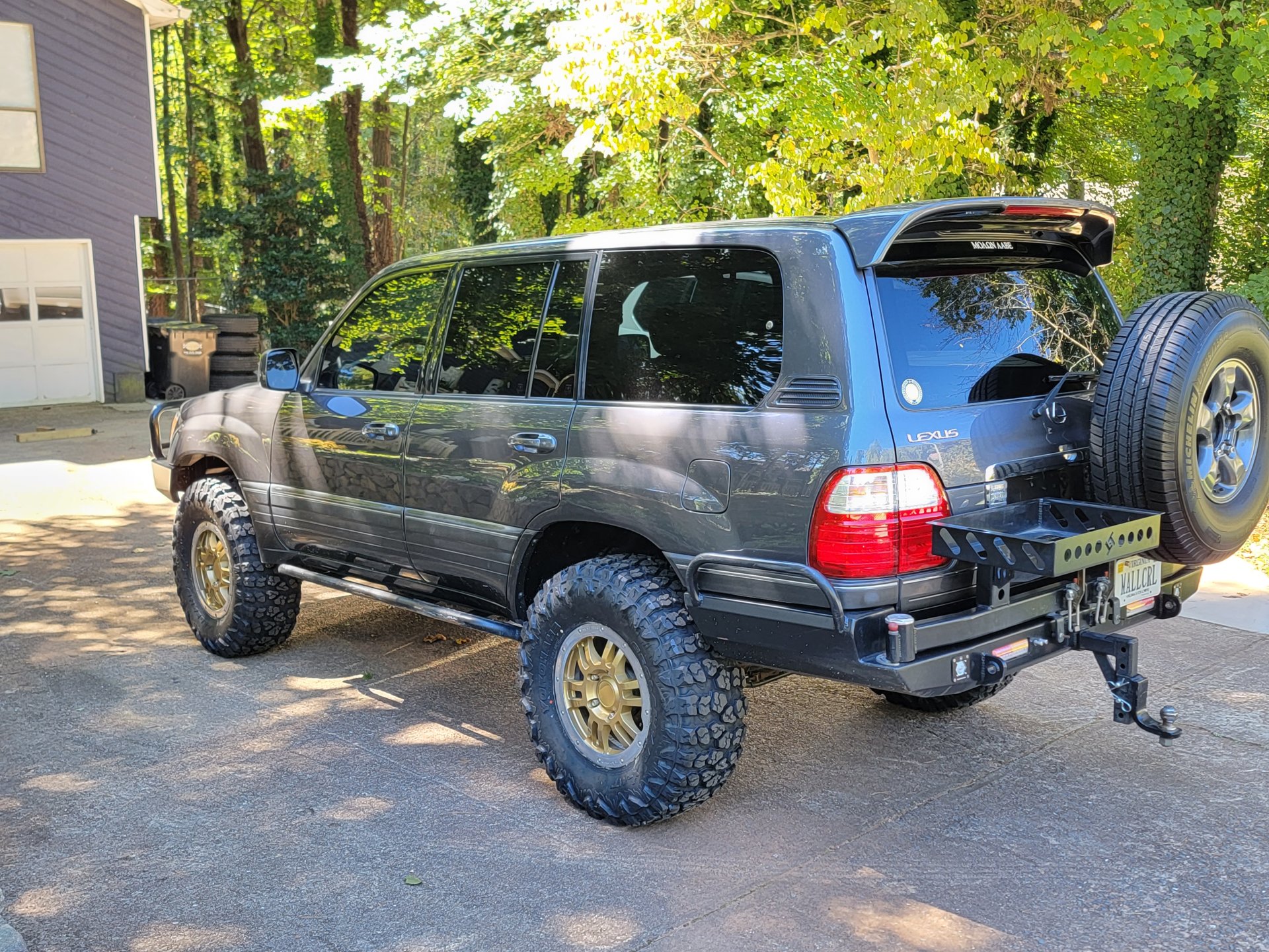

Bling bling
Don't mind the itty-bitty spare. The 35s are only on for test purposes for now. I did take them for a spin around the block. Not a huge difference than my Toyos as far as feel, acceleration, and braking. These 35x12.50s only weigh like 6lbs more each than the old 34s.

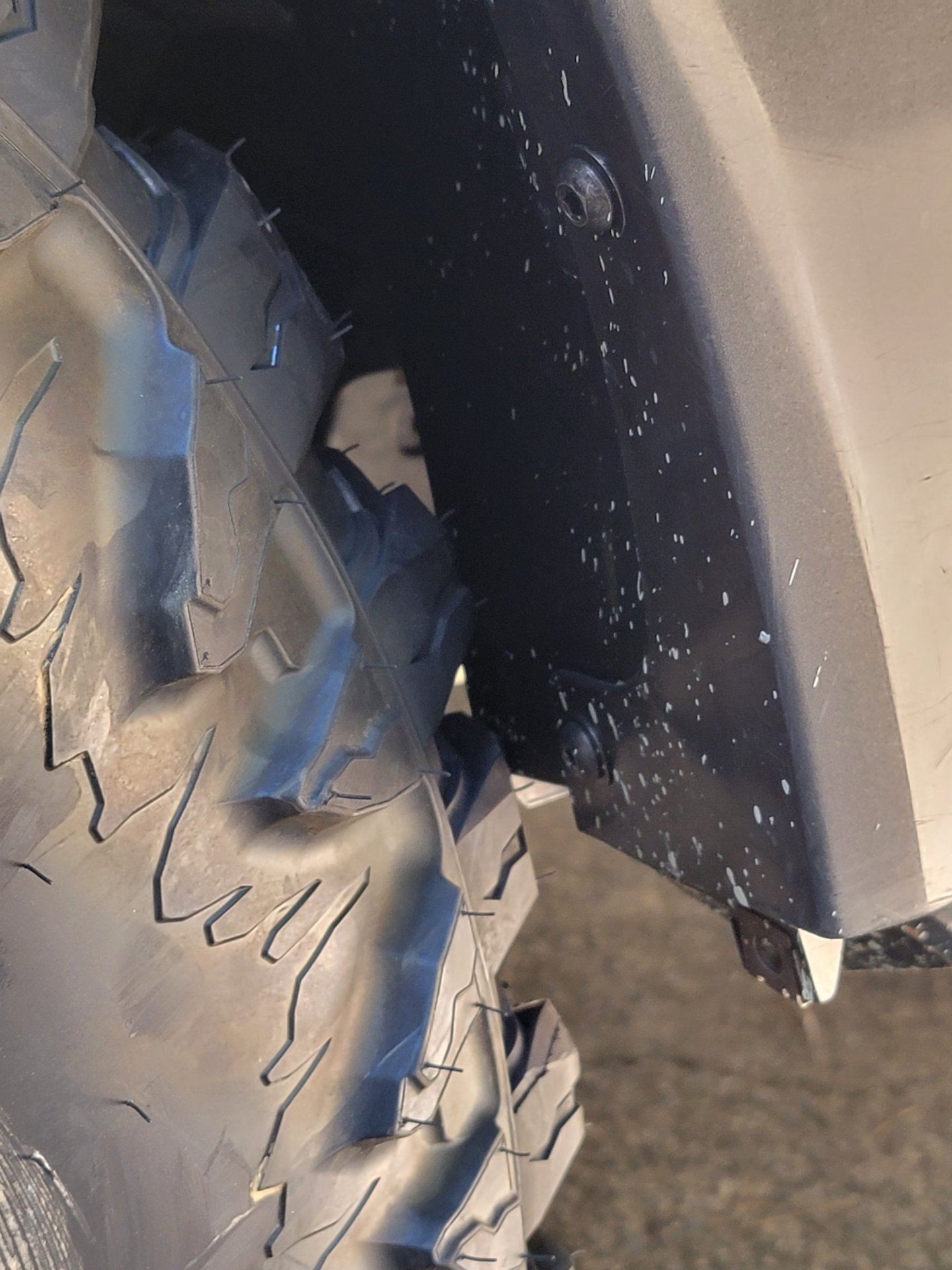

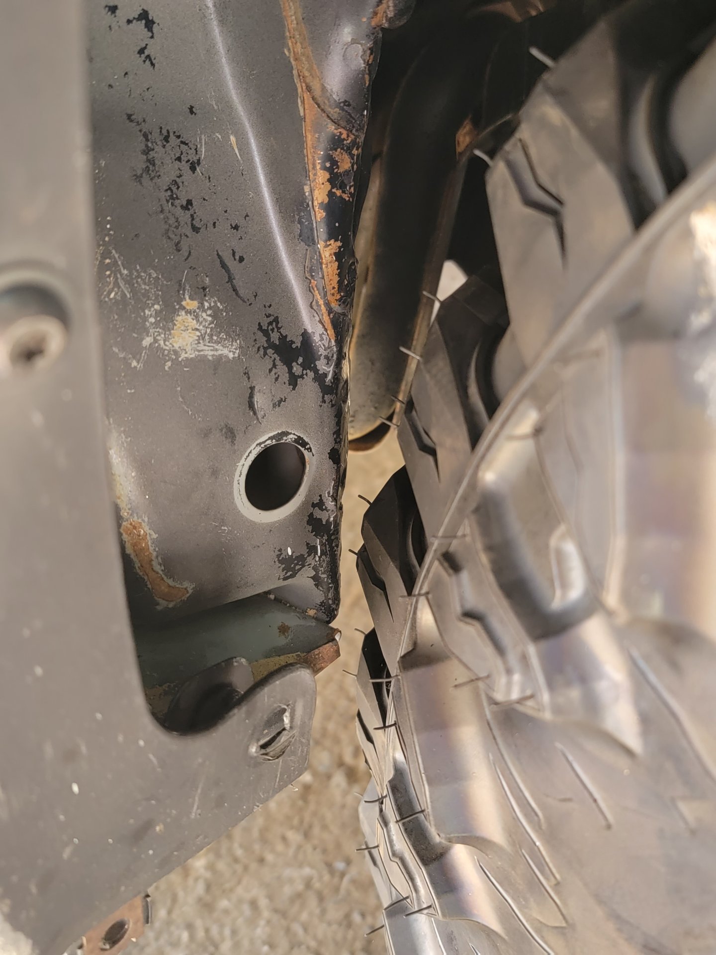

I will need to do some persuading to eliminate rubbing. Currently, the tread blocks really push the lowest point of the inner fender, moreso on the PS. I've done the pinch weld mod already but will do a little more. Will also move my PS slider rearward a bit to give some extra room.

Bling bling
