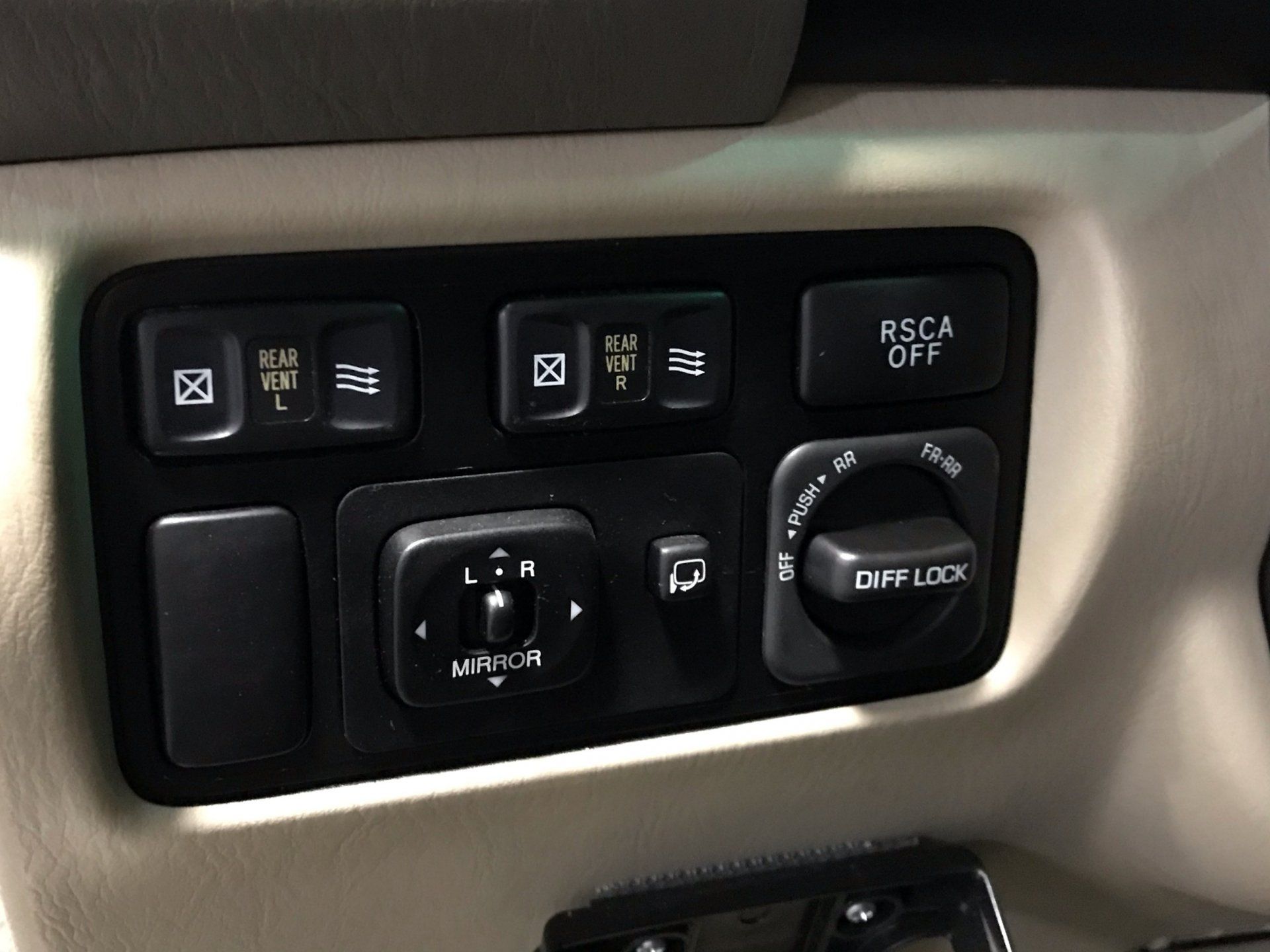

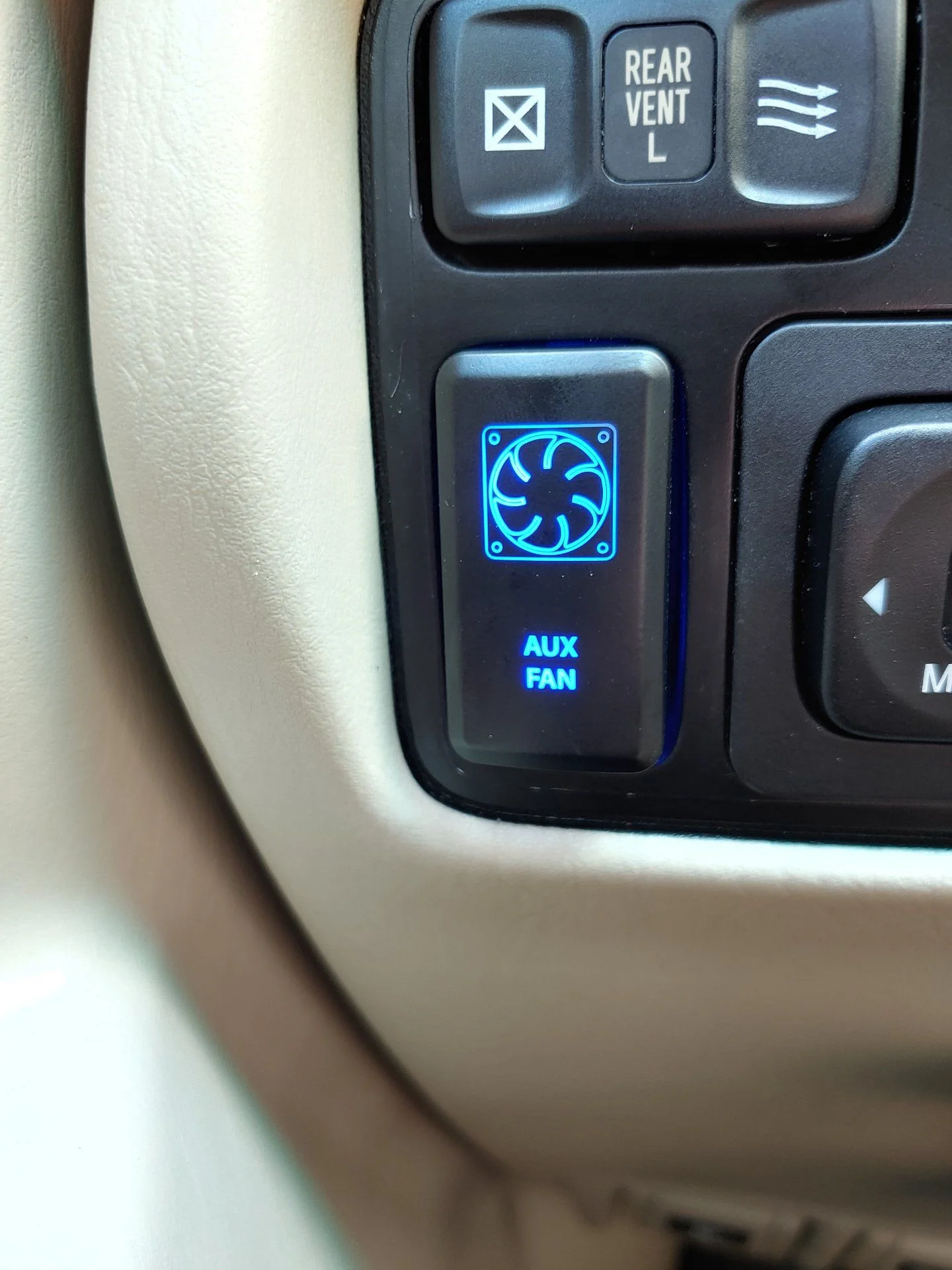

Installed the new switch for my aux fan today. The original switch was where the locker rocker now lives, so I got a cool Toyota-spec button from ch4x4.com. It fits perfectly in the blank space by the driver's left knee.
Details here: Help an idiot wire up a simple switch. Internet points awarded.
It sounds like I may still need to add a relay, and I would like to replace the blue bulb behind the text with white, but otherwise it' functioning perfectly and looks like it's supposed to be there. (Button isn't fully pressed into the surround in the pic, it's not gapped at all now).

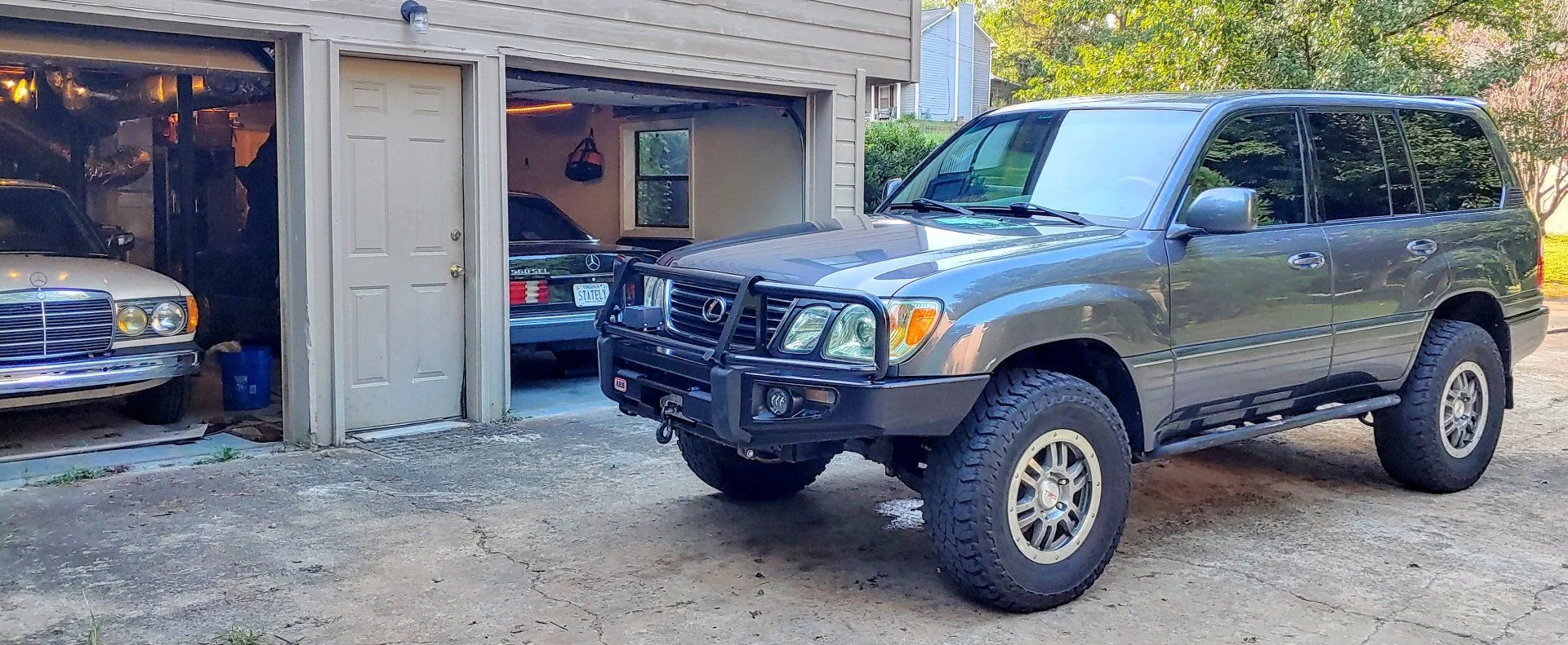

For you, @ClassyJalopy . As she sits today. No garage for her anymore. At least, not at this house. The old Benzes get to stay inside. Once the rear bumper is on the truck, the little 300 comes out so I can use that side as my work area for doing the suspension restoration on the 560.

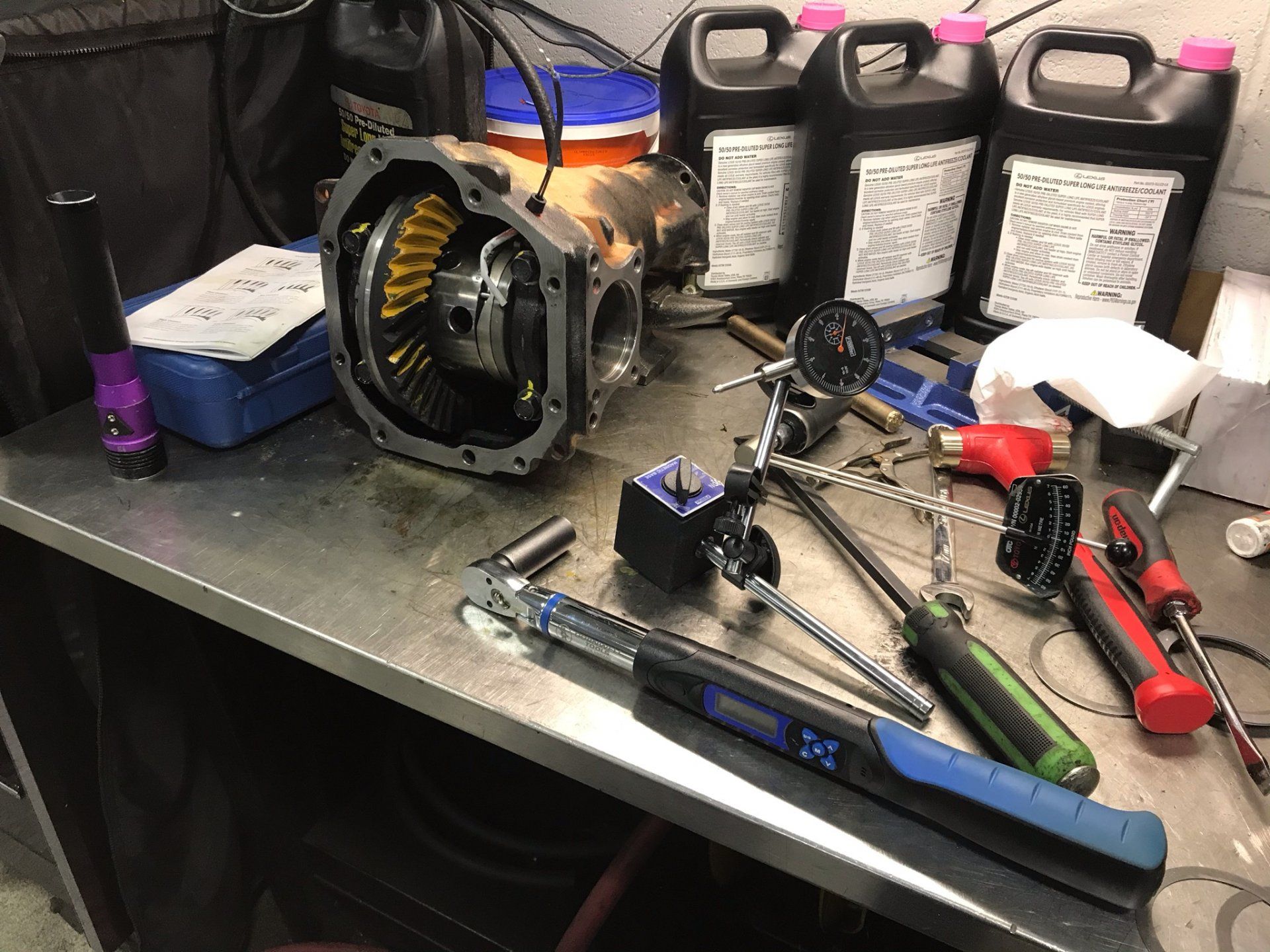

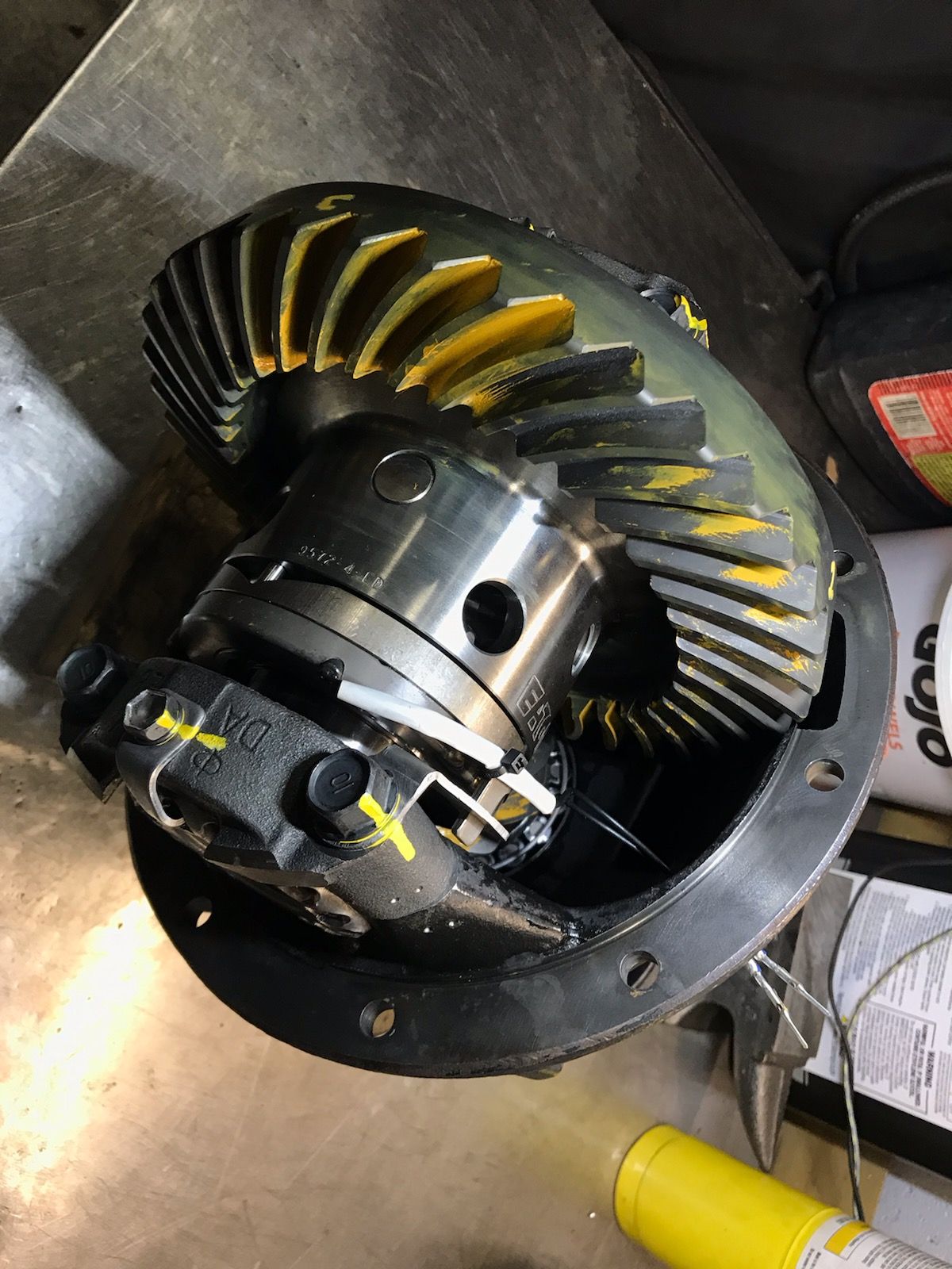

In July, I popped U-joints in both drive shafts and subsequently blew the front diff at the same time. It was a real pain, but ultimately turned out well. Since I was going to either need new or to rebuild my driveshafts (they broke beyond U-joints), and since I was going to need to replace a front diff.. I went ahead and got a bunch of cool toys 😁
@Wermz Hooked me up and installed all of the goodies in the last few weeks. Nitro Gear 4.88s, Eaton E-lockers front and rear, Tom Wood's double cardan driveshafts, and all buttoned up with a factory Toyota locker switch in the dash.
I'm still in the break-in period with the gears, so not much to say about them other than there doesn't seem to be any noticeable difference in driving. As in, there's no buzziness to the engine at all, no ill effects that I could find. After the break-in is done, I'll get to use the truck a bit more to see how the gears feel in acceleration from a stop. I can say that it's a lot less prone to downshift on slight hills around my area, so that's pretty cool. I'll get to test everything out for real in 2 weeks in Uwharrie for the Logan's Run trip.

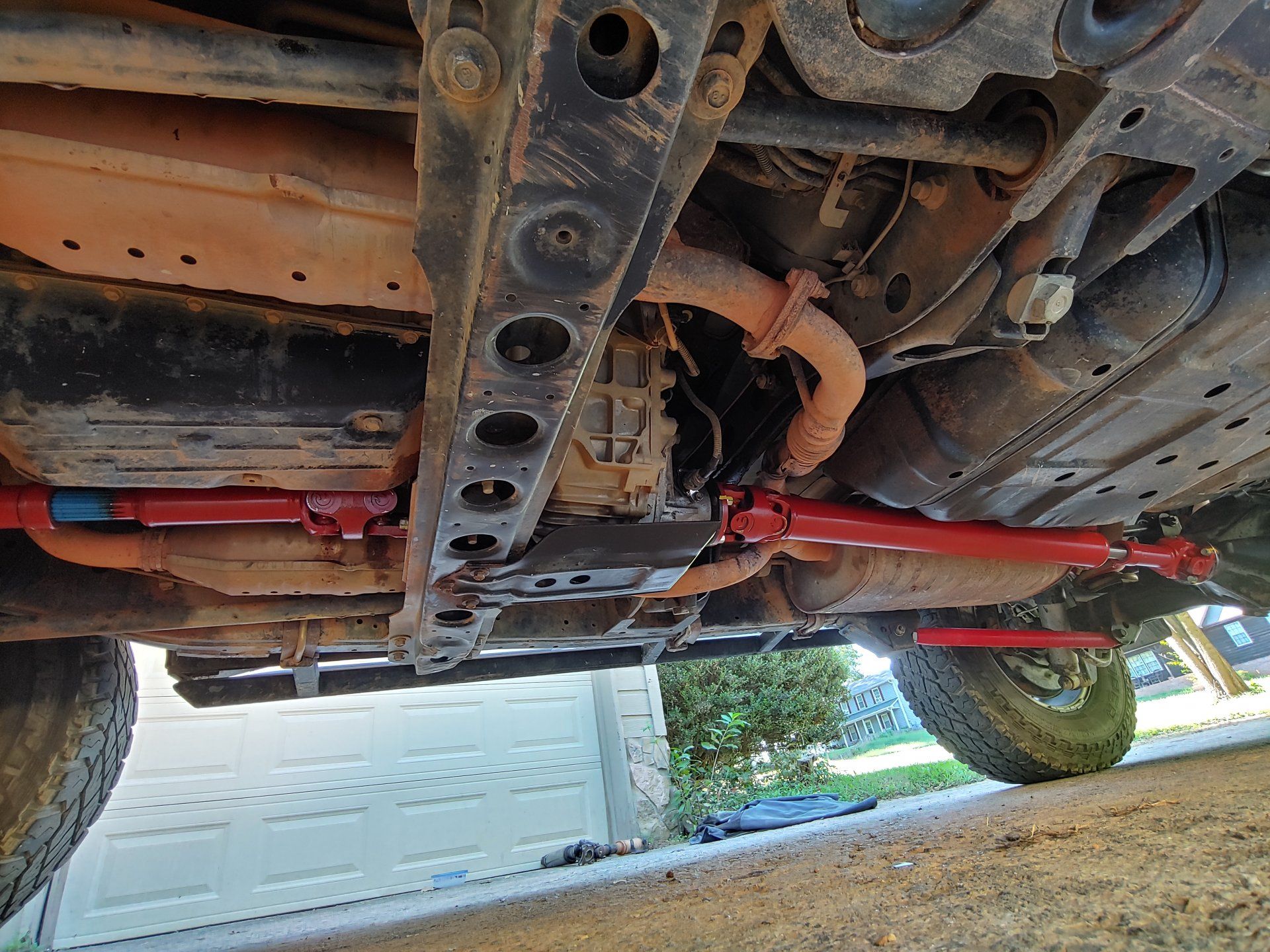

Going with the double cardan was definitely overkill for my application, especially in the front shaft. For the rear, I just wanted whatever would have been the biggest upgrade. As for how they're doing so far: horrible.
That vibration I mentioned earlier didn't go away. Driving highway speed was both uncomfortable and unnerving- enough so that if this is what I'd be stuck with, this is no longer a highway vehicle (no, I'm not going to tolerate and leave it this way). I pulled the rear shaft over the weekend to determine if it was the culprit. It was. Truck rode smooth as butter running just FWD (other than the torque steer).
It makes sense that a double cardan would be more difficult to balance. I ordered everything over the phone with the intention of having info presented along the way as I checked off the features I wanted and asked questions that popped up. However, issues with balancing weren't mentioned to me as a consideration when I spoke with TW. They did advise that they spin their shafts at 2-3,000 rpm for balancing. I'm not sure what the industry standard is, but fwiw, Mik @ JT's said the best shops spin at 10,000 rpm. :meh:
In my mind's eye, the 1310 was noticeably larger than the Toyota spec joints, however I can't confirm the size disparity right now because I've dropped the rear TW and both of my OEM shafts for rebalancing/ rebuilding this morning. When I was there, the guy at the shop said TW makes cheap shafts using cheaper parts. Take it with a grain of salt, but whatever. I was advised a similar shaft made in-house from him would run ~$650 or so. For reference sake, I paid $918 shipped for both shafts with hardware.

Driveline shop on Buford HWY “Driveline Service of N.Atl” has a high speed balancer and do good work. These guys told me the same thing about Tw driveshafts that you heard- but I also take that with a grain of salt. TW has a good rep across the industry and to be fair they are best known on Jeep and custom buggy work.
In the end if those driveshafts dont balance out- speak directly to TW not the phone sales guys. I think he will make it right one way or the other.
Fwiw- when I go to replace my driveshaft I’ll go oem. The rear is under $400 and comes built complete (ujoints and DS)

Picked up the TW shaft from the local shop today. Each end was out about 20 grams.
Got it hooked back up when I got home and high-speed tested it. So much better, very smooth now.
FWIW, I did call TW and explained the sitch. They advised me that the warranty states, once another shop has touched it, the warranty is voided. However, since the rebalance was a nominal $40 and a shipping label from TW would have been $50, he went ahead and reimbursed me for the work. Nothing to mention the time and labor to R&R, but beggars can't be choosers. At this point, I am content.
Based on first balance TW put on it, guessing even if you did send it back to them it may not have been returned with any better result. Good deal on the local balance.

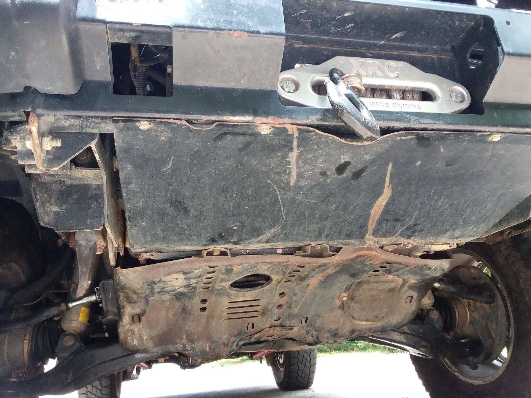

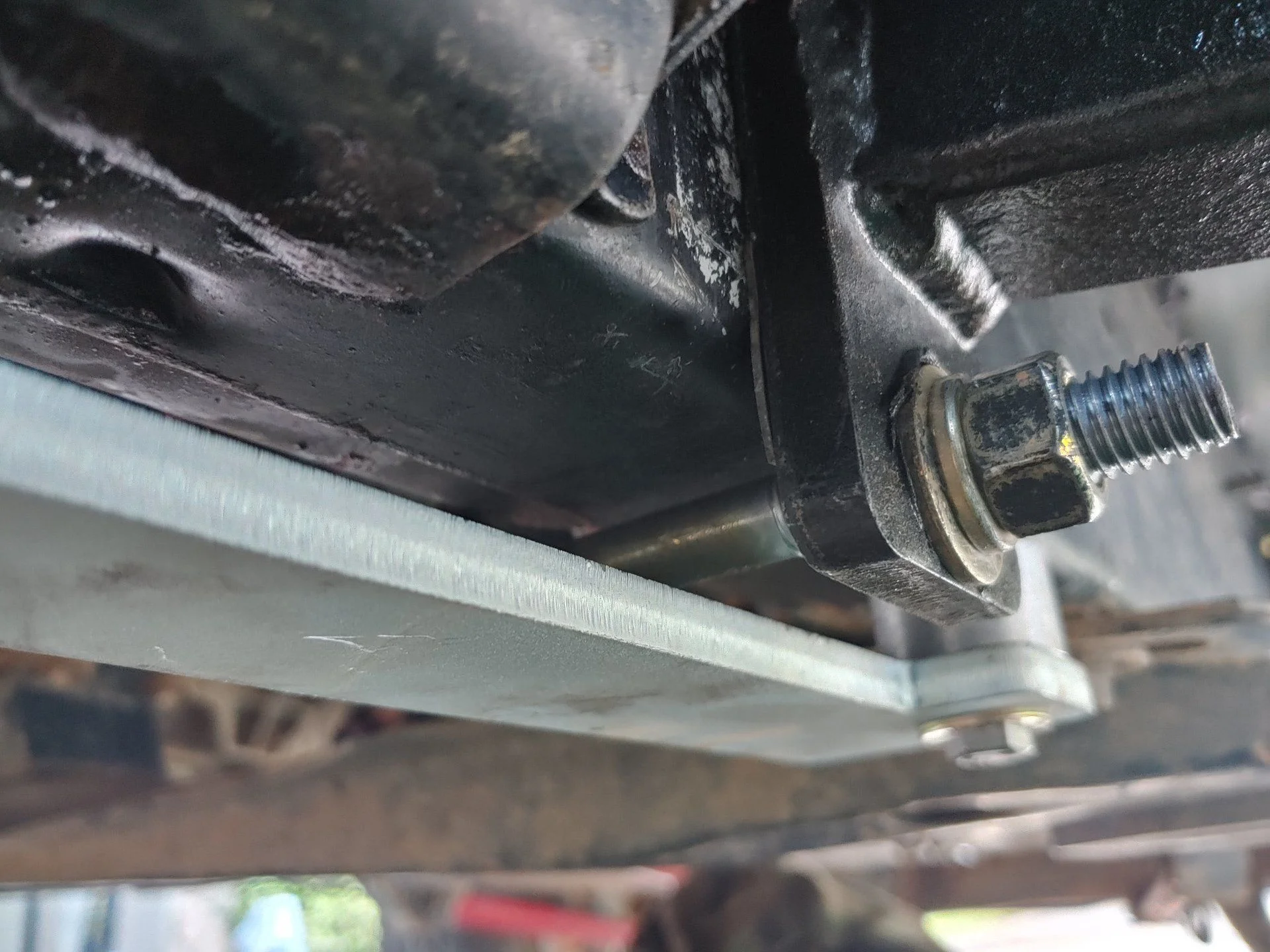

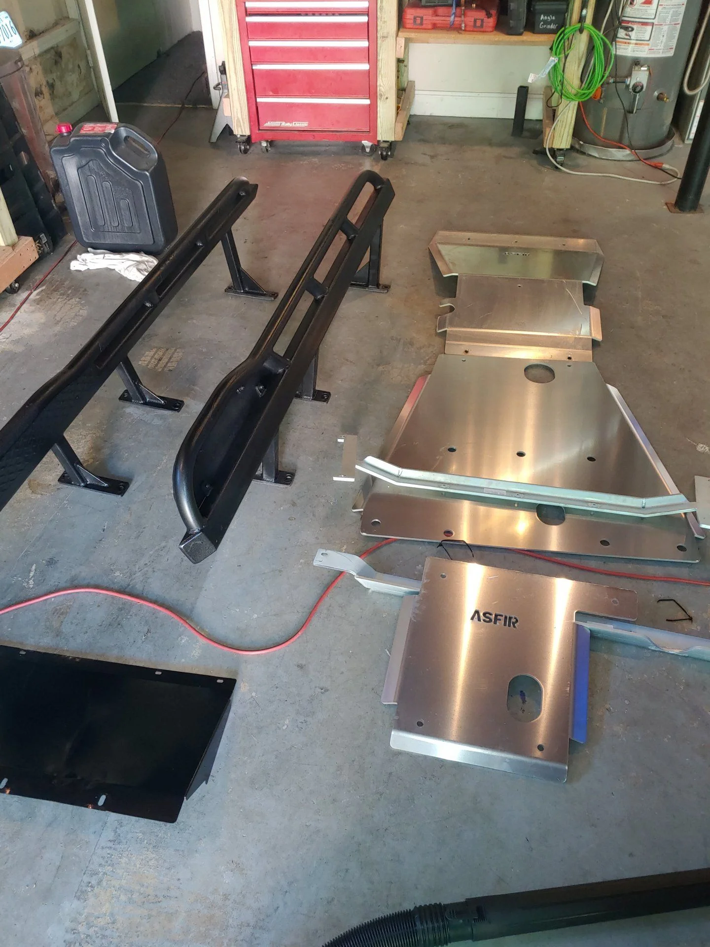

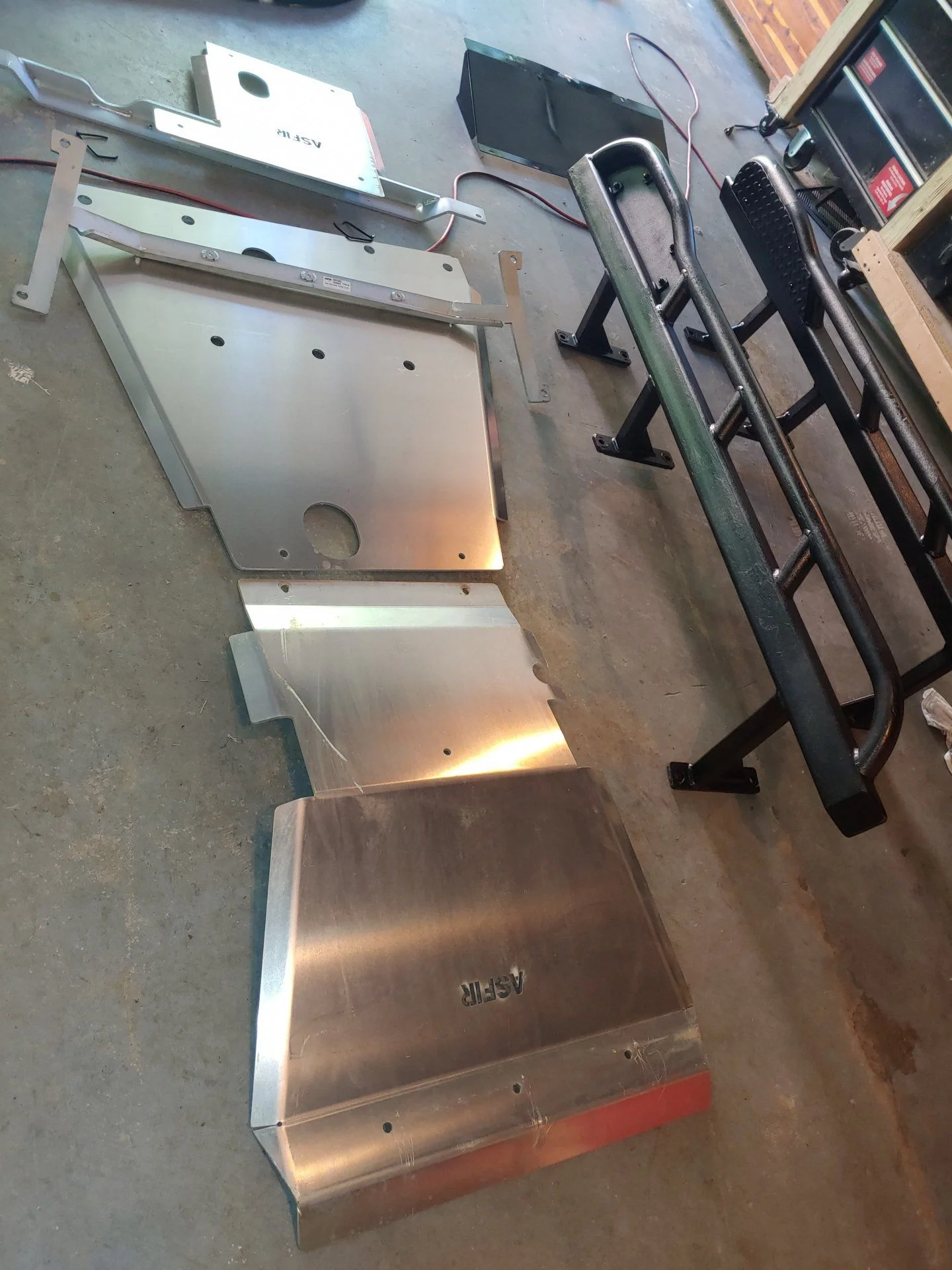

I received my Asfir skids last week just in time before a wheeling trip. Unfortunately, there was a little more work involved to get them on to my truck that I wasn't able to do the night before leaving. Basically, the legs of the center cross member for the skid needs to go right where the U-bolt lays for the front legs of my sliders. I tried my hardest to get the arm of the support to fit between the U-bolt and frame, but nothing was working. I know my sliders will get more use than this center skid would, so I opted to leave the 2nd and 3rd pieces for another day.

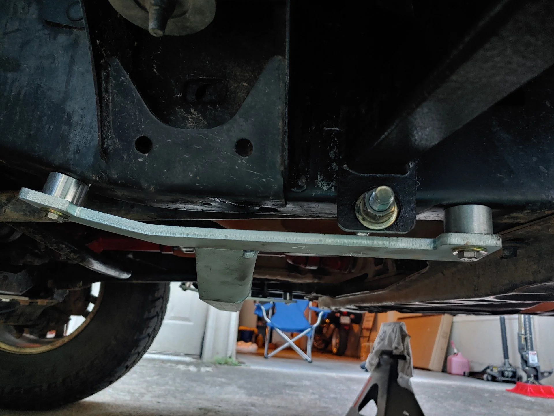

Fast-forward to today: I decided to use spacers on the cross member for the center skid, as discussed in the Asfir threads. However, my sliders were in dire need of repainting, and I wasn't about to install skids over them, so today was armor-refinishing-day.

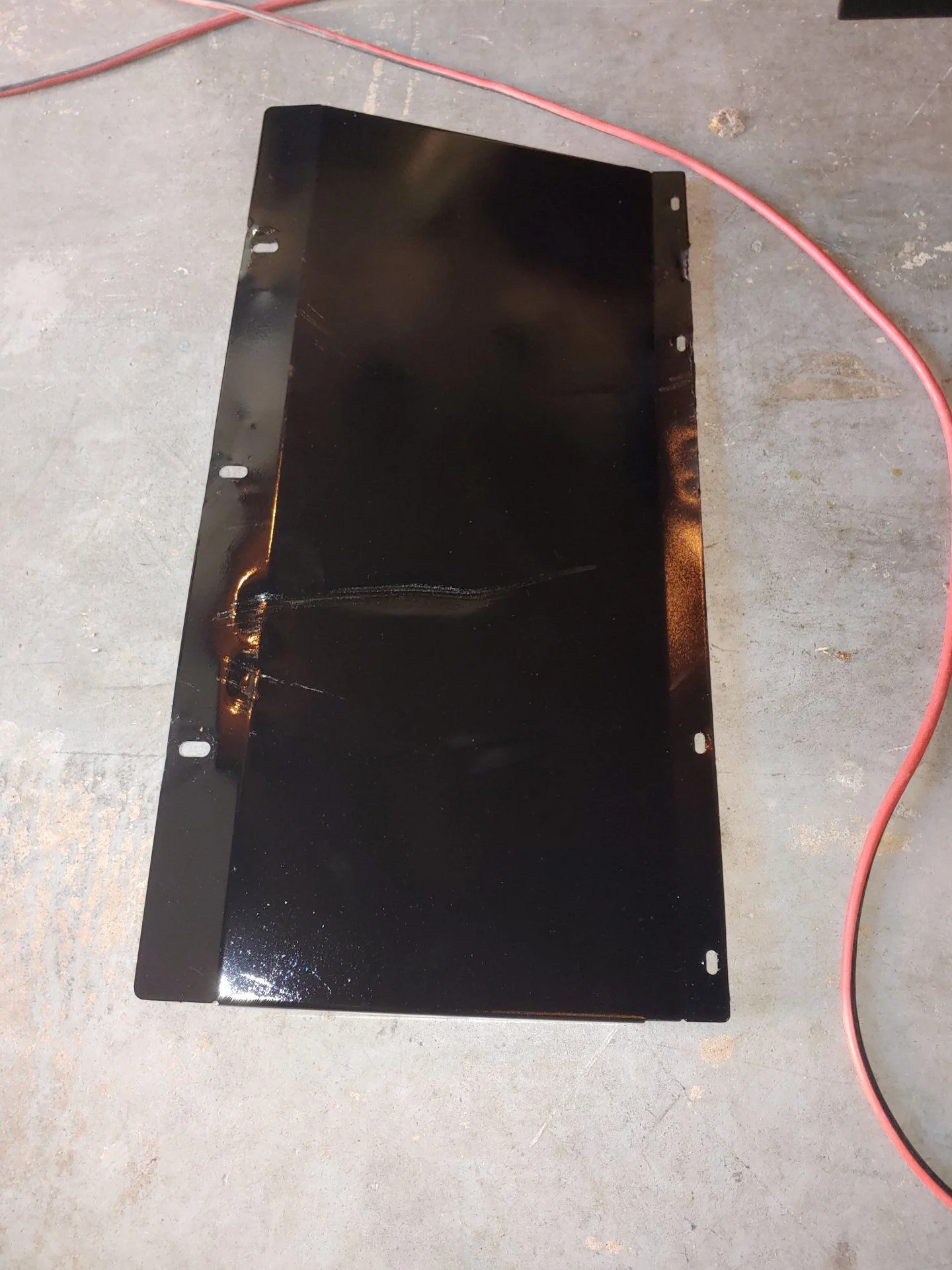

Pulled the sliders, pulled the ARB tin, hit what I needed to with the grinder and wire wheel, then sprayed everything. No before pics of the sliders, but they've definitely been used well since the last time they were pulled.
That front tin and original skid plate were pretty well loved by this point.

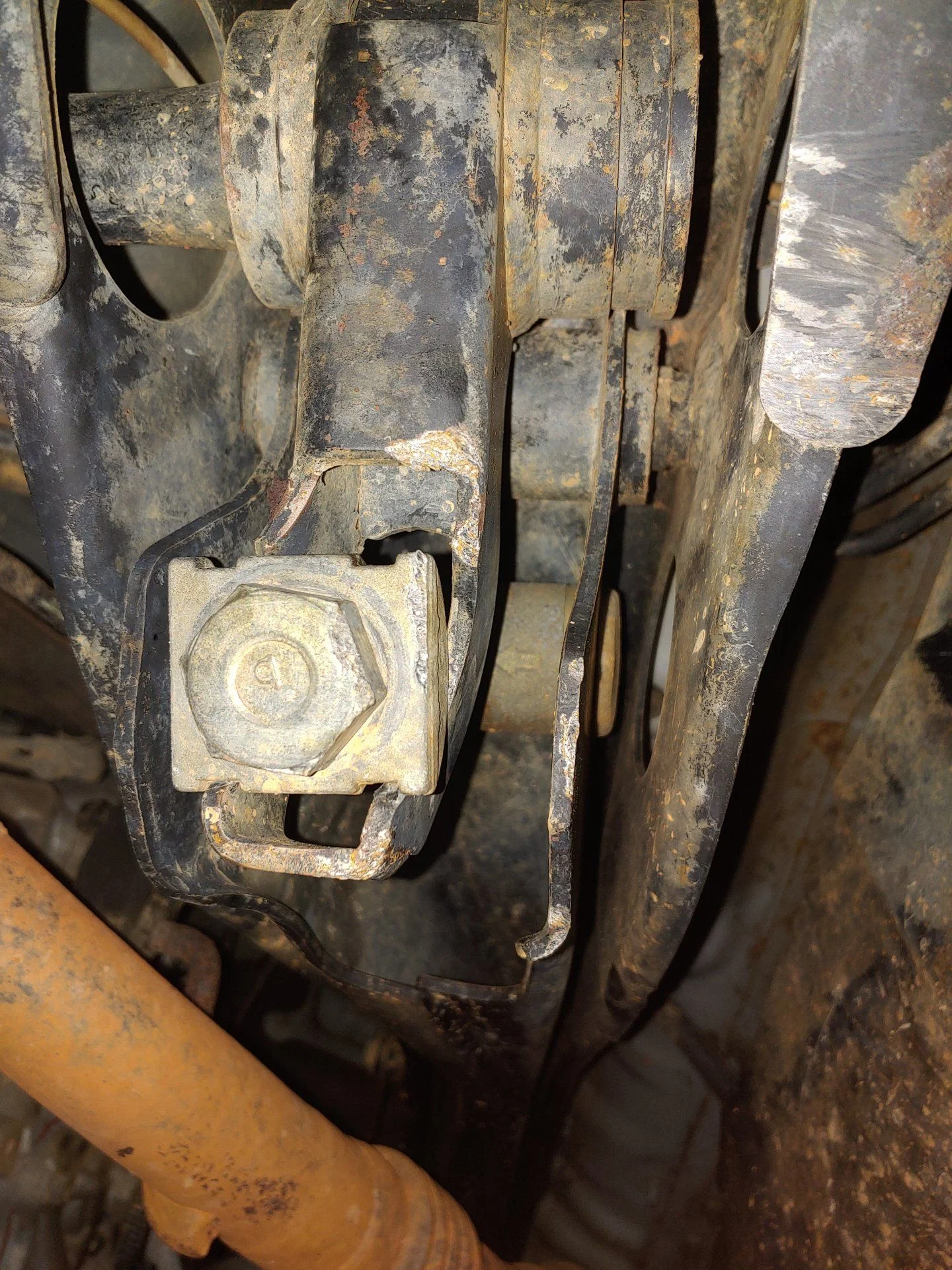

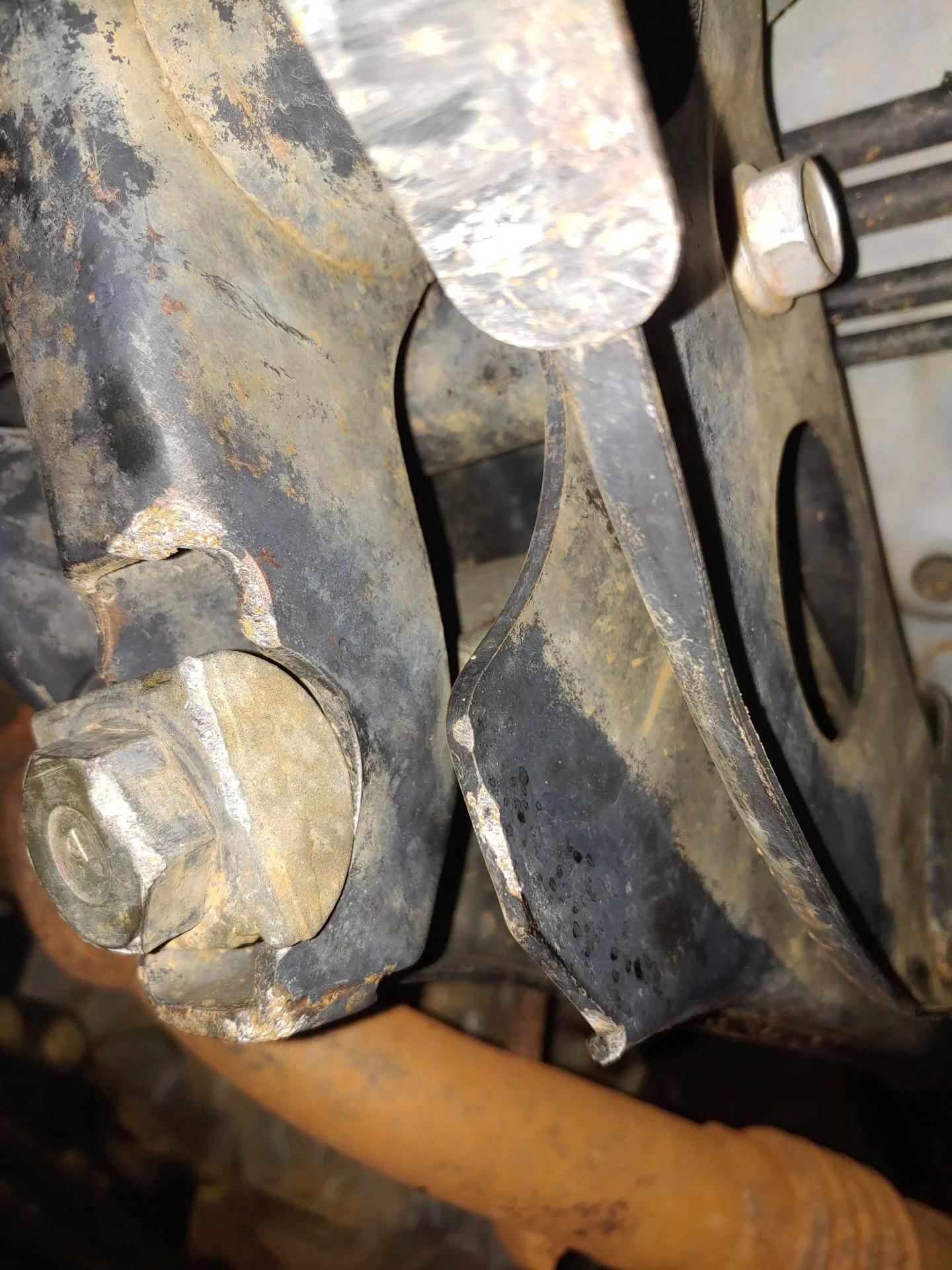

While installing the most rearward cross member for the skids, I ran into another problem: My torsion bar adjustment bracket is bent, and it's bent enough that it completely interferes with this cross member going on. So, to the cloud we go. Picked up OEM #4810860010 from eBay for about $25 less than partsouq could get it to me for. Will knock this out asap when it gets in as I have GSMTR at the end of October. (It's not rust! That's all GA clay staining under the truck)

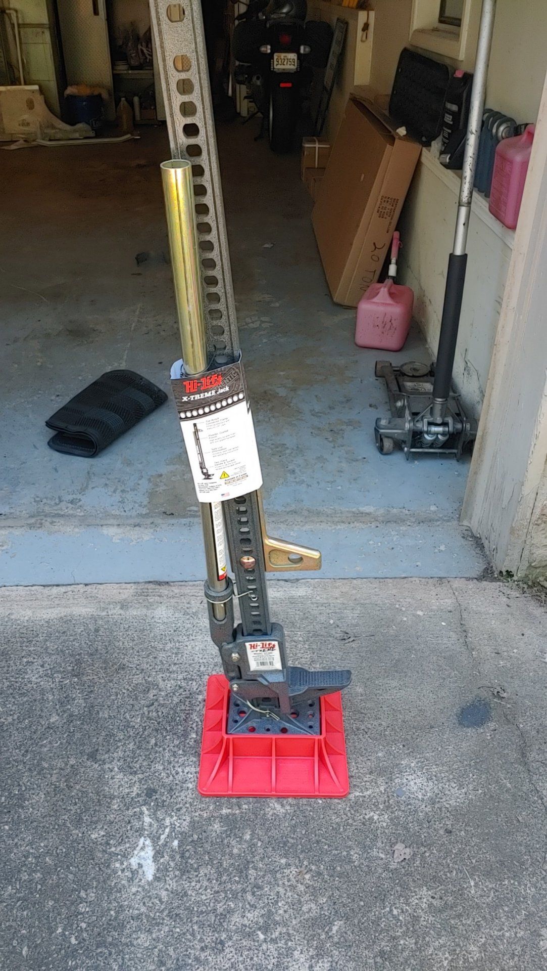

And last and probably least, I had a new Hi-Lift delivered today. My rear bumper from Trail Tailor should be in next week (hopefully) and will be home for this guy.
Way to go taking care of this. There was another post recently where someone broke one of those adjuster arms, I guess this would be a good time to replace. Are you running front LCA strengthening brackets too?

Honestly, I think it may have taken me a while to figure out the issue had I not seen that thread before. Definitely helpful! I added to it a little just this evening. Yes, using the strengthening brackets in the front.
