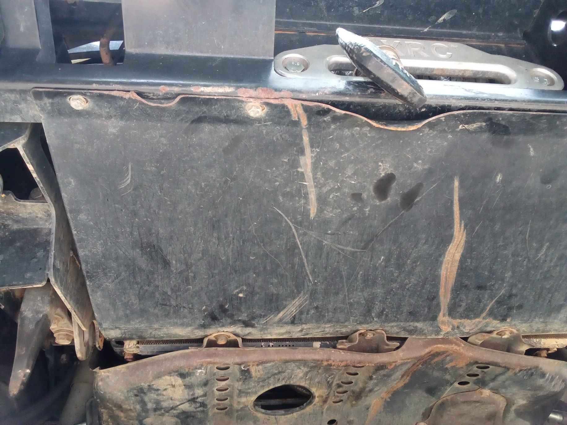

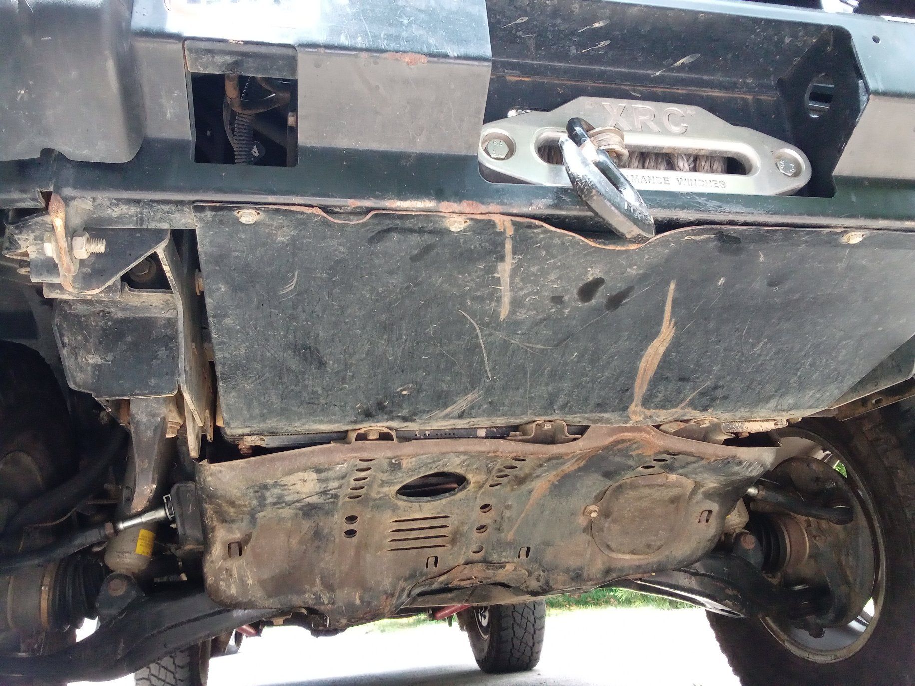

You mean this plate? Immediately under the winch and connects to the first factory skid?

Thanks for the pic - I haven't put that plate on yet - planning to do just that this weekend. Also, noticed that you are using the same hook I got with my Smittybilt winch rope. I have been warned that it is can let the D-ring or tree-saver loop slip out when pulled at an angle. I am just not convinced that I need to spend additional $$ on pricey winch shackles.

I can see where it's possible. I imagine it'd be unlikely if you tension it correctly before yanking. In the few dozen or so times I've used this winch, I haven't had any issue with it. Eventually I'll upgrade to a factor55 or something. Maybe I'll buy one of those next, I'll sure look cooler in pictures. My dad's the kinda guy who will just surprise me with something like that when I go to visit. "I accidentally bought two, here".

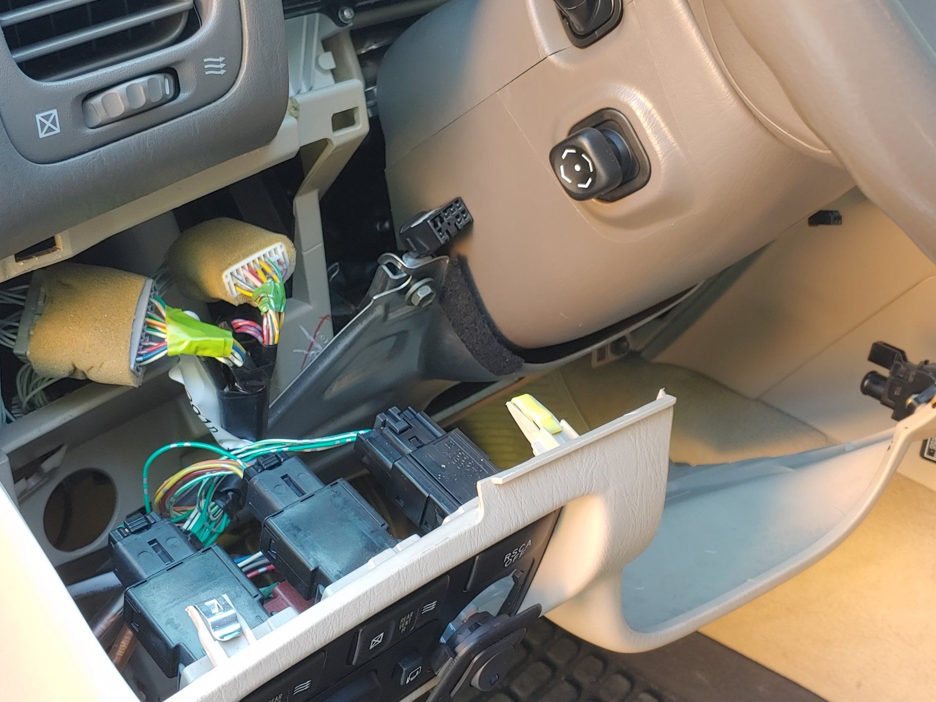

First, I wired in a brake controller. I'll be picking up a camper that I bought from my parents almost 2 years ago, and finally have a reason to prep my truck to tow. I ended up with a Tekonsha Primus IQ for like $45 on eBay. Down from $90-100 retail, I was happy. Also happy that the '05 has the factory installed connector for this, so no wiring necessary. Just pull the knee plate from the dash, lower the tin, and you'll see the connector behind the ignition.

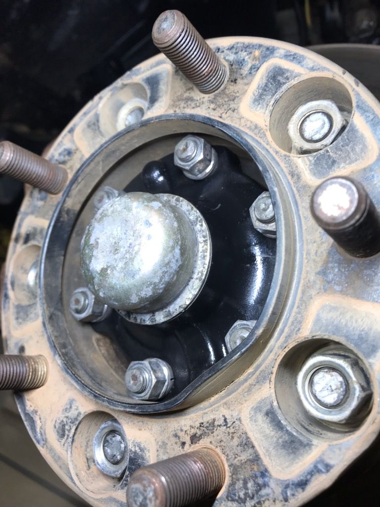

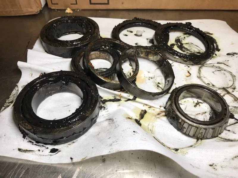

I've had an issue with vibration on acceleration for a while. An indy swapped in an after market CV about a year and a half ago (in this thread somewhere) but I never really trusted it. @sammybones got some new CVs installed recently, and said he noticed a big improvement in vibrations on acceleration. Since everything else in my truck has been replaced, and since I can't let my friends be better than me, I opted to have new OEM axles, hub flanges, wheel bearings, and all hardware installed last week. Also had the rear axle seal re-replaced, since evidently the first guy I paid an arm and a leg to didn't do it very well. Hopped out of the truck one day two weeks back to a light cloud of gear oil smoke billowing from my rear wheel. :rolleyes:
So thanks to @Wermz , Lexus tech and good-guy-extraordinaire, she was rolling smooth and smoke-free with the new goods installed.

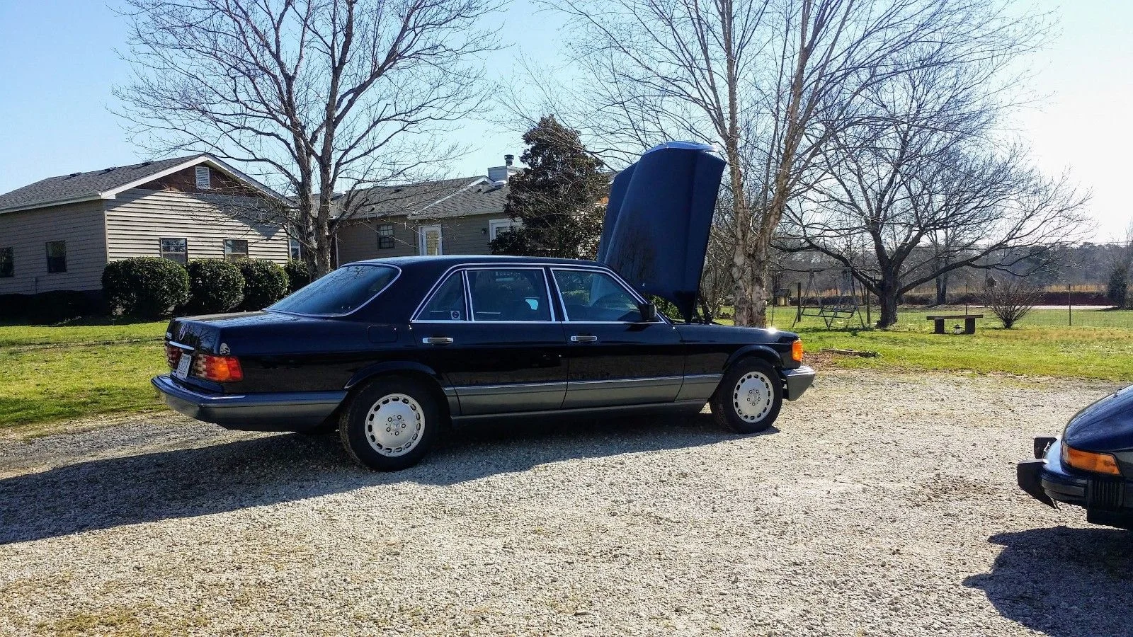

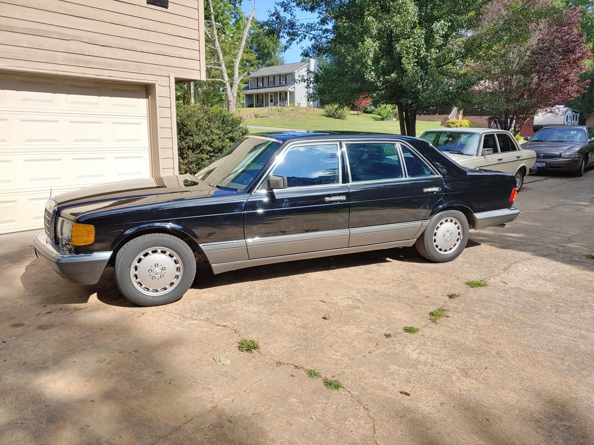

1991 W126 560SEL. I've owned it for 4-5 years, but it's been in storage in VA since I bought my first LX (about 3 years). Was supposed to have a dash-out service done but the shop who had it never touched it. Had it moved to AutoHause in Yorktown, VA and they diagnosed a faulty AC compressor. Luckily no dash-removal required. Had the AC system completely rebuilt. Had ceramic tint installed on all the glass (including windshield). We flew up to VA for the 4th of July and drove it 10 hours home. Did great other than some minor fuel issues- have to roll on the throttle from a stop else it'll stutter a little bit. I'll sort that sometime, should just be a simple fuel relay or similar. Runs like a raped-ape over 1000RPM. I just dropped it off this morning to have the 10-speaker stereo completely redone.
I've got H&R lowering springs on order, and will pick up a set of period-correct 17" AMG Aero wheels for it sometime soon. Interior is flawless, paint was just corrected last week. Have a set of all glass European style headlights waiting to be installed. It's a really, really nice car. Keeps my LX and W123 in great company.
After paint correction last week:

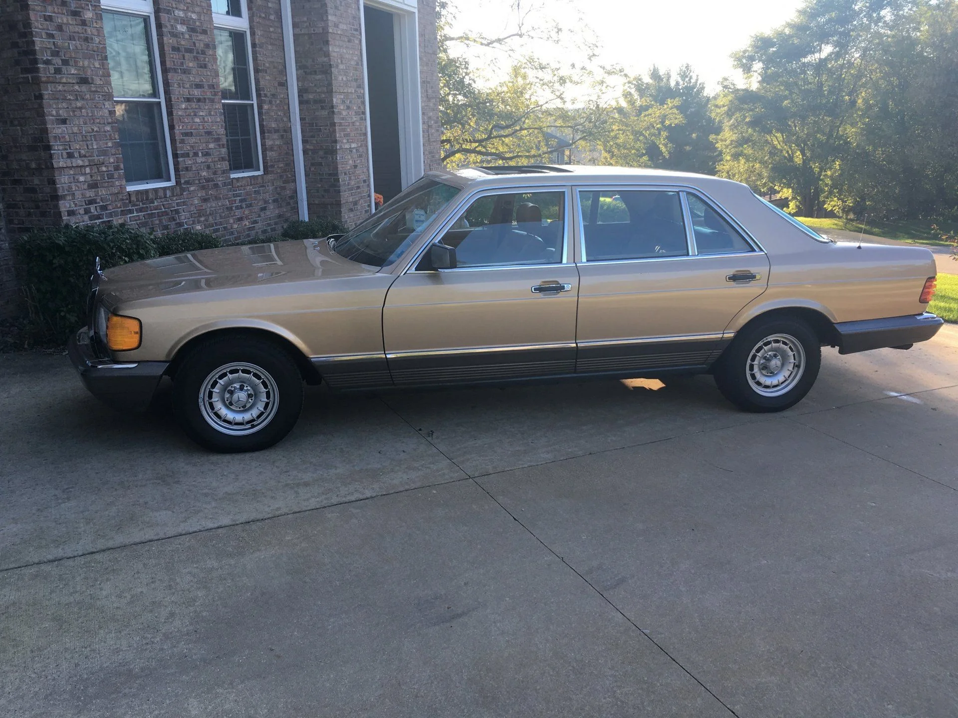

Love those cars! My brother is slowly restoring a one owner 87 SEL with like new interior. And a friend of mine sold his 84 500 SEL with just 33k miles a couple of years ago for $12k!
