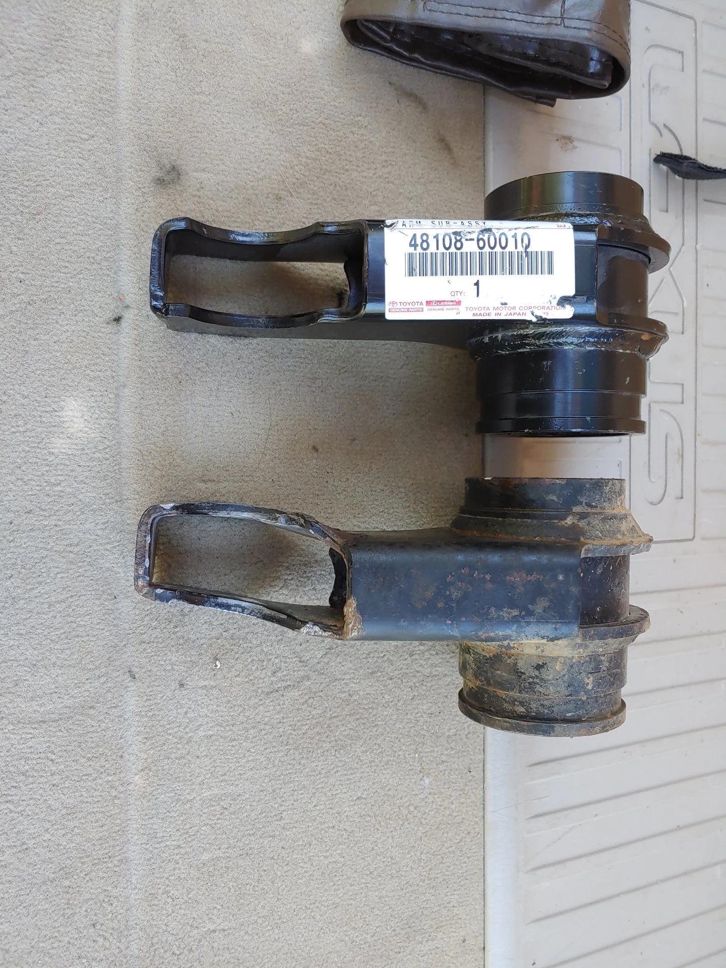

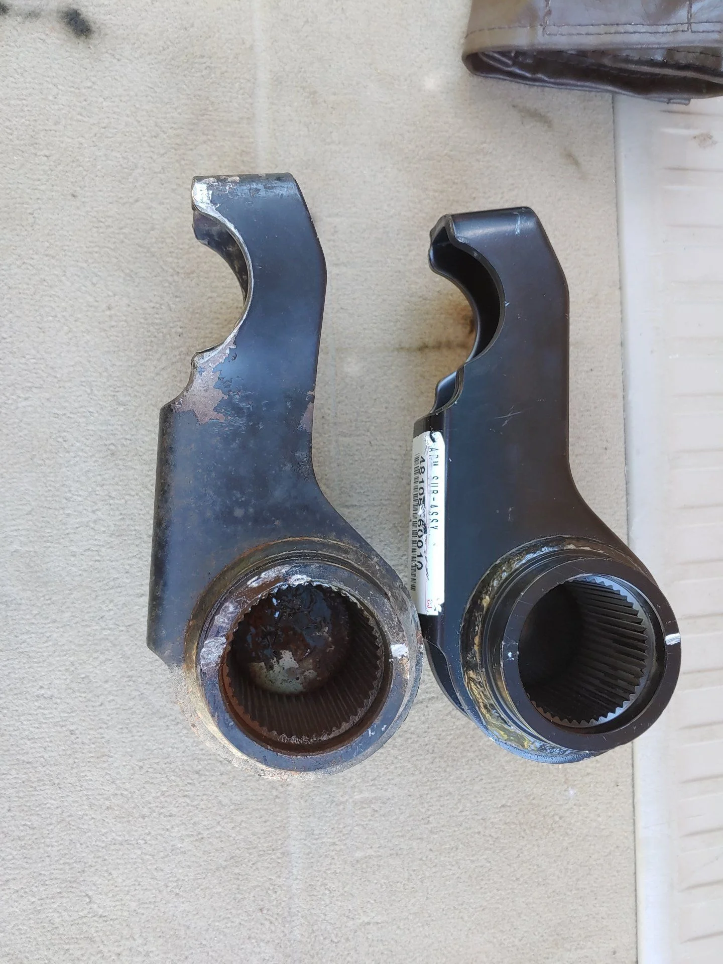

Today I replaced the bent torsion bar adjusting bracket. It's been about 2 years since I'd done the TBs, so I needed to figure it out while I was under there. Ultimately, you'll need to mark the front of the bar relative to its place in that bracket, then slide (or pull, or beat, or curse at) the bar back so you can hang the front end freely. Then you can move the rear adjuster bracket back far enough to remove it. Did I end up indexing this correctly? Hell if I know, probably not, but I did manage to get the height perfect the first time without having to jack the truck back up again. Don't forget to take the truck for a spin before measuring, it'll settle down a hair. I think mine started at 22" driver's front corner and settled down to just a hair over 21.5", which is where my PS is.

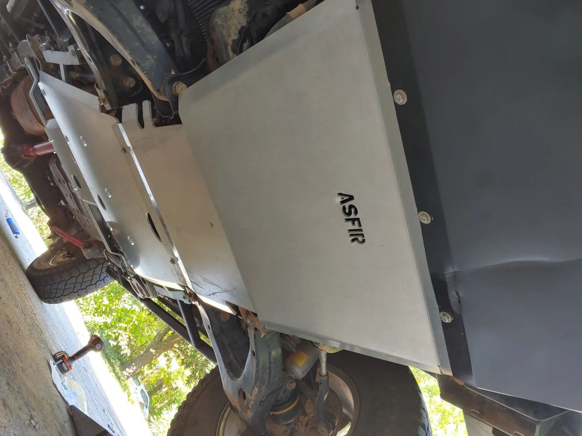

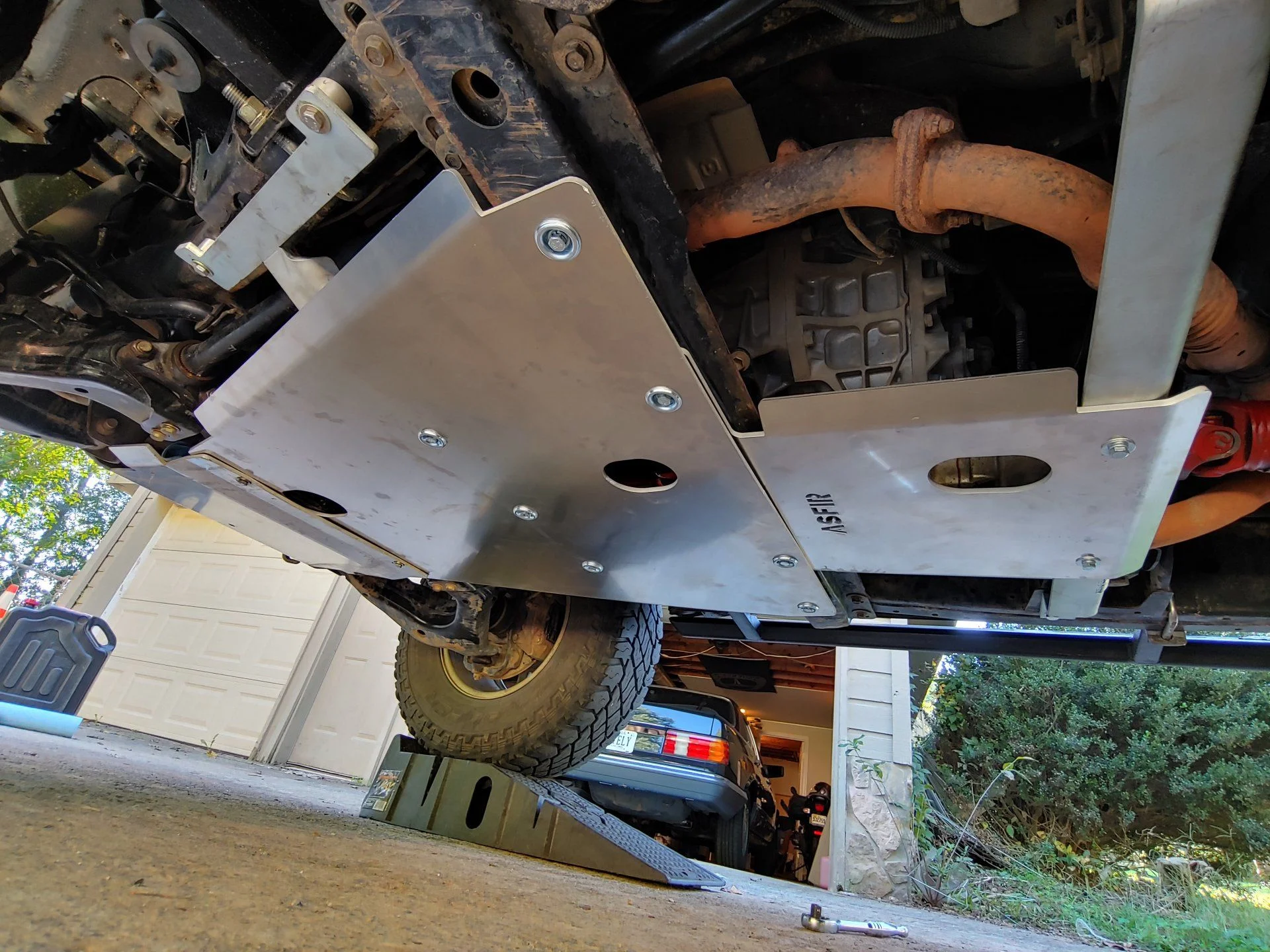

Then I installed the ASFIR skid plates. They're OK, not in love with them, but they'll keep her nuts safe I suppose.

Did you end up reinforcing these skids are all? I thought I read previous that was pretty common for these.
Reinforce? No. I must have missed the posts about it. They're pretty stout, especially for aluminum. If anything it might be able to utilize some reinforcement at the furthest rear, PS fastener. It just kind of hangs off of the cross member.
I'm about to go correct one mistake I made during install. I'll snap a pic when I'm down under.
