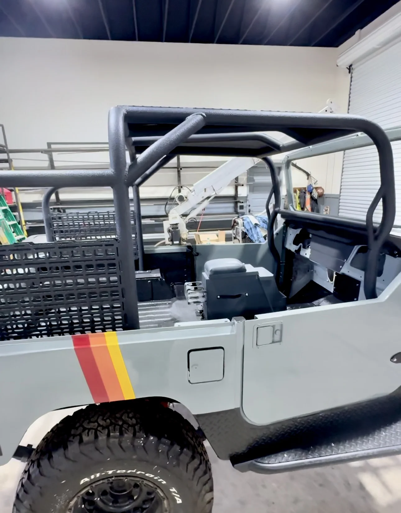

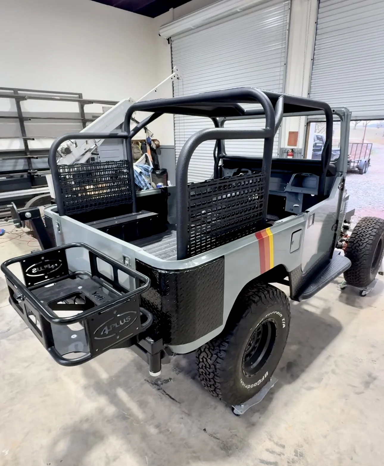

Got the finished roll bar mounted. Not gonna lie, turned out better than I could have ever imagined.

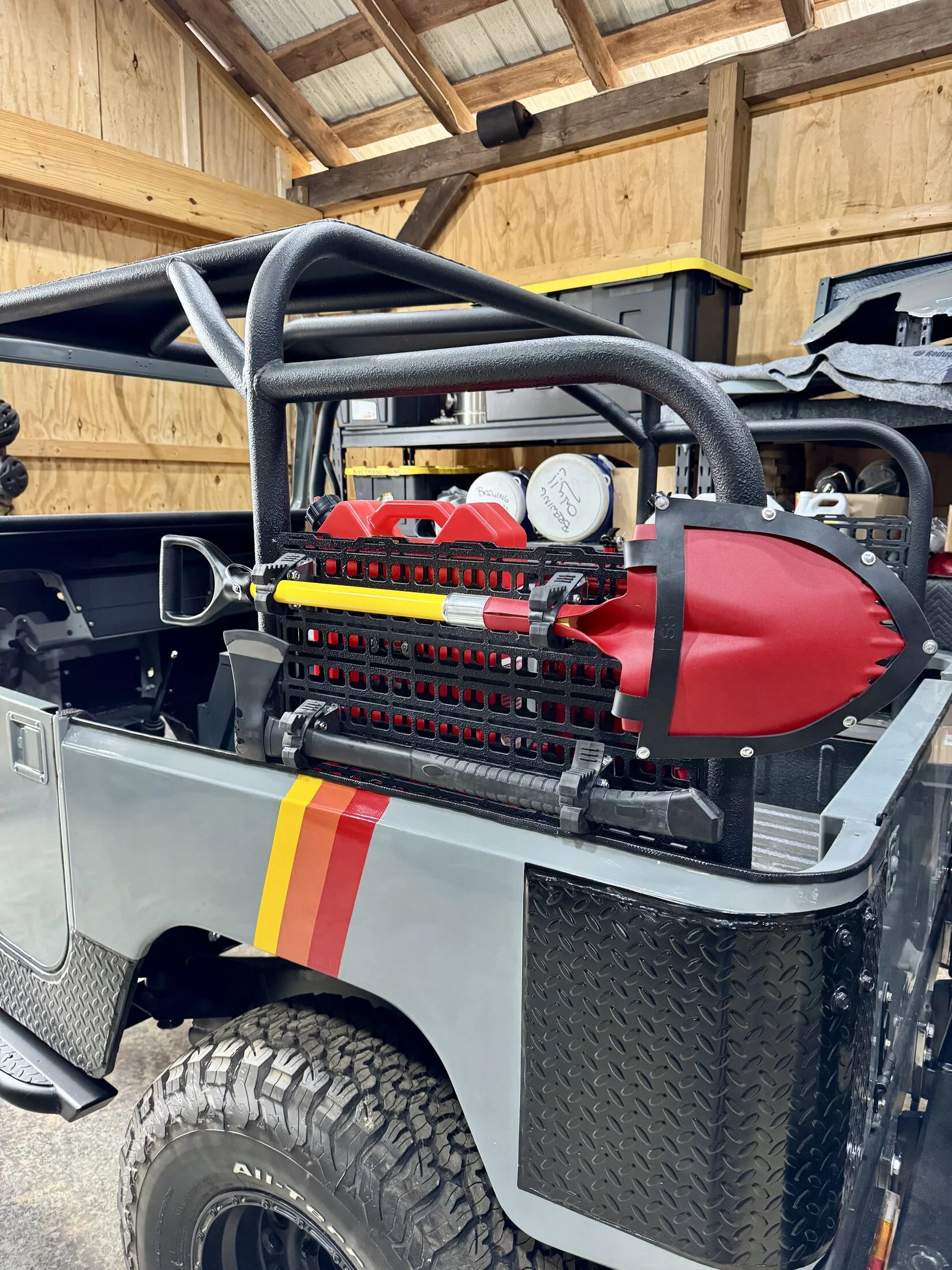

Got the custom made tool box / bear carrier that sits in the back of the tailgate. Super happy with how it came out. I tried pricing these out online, and they were a fortune…hit up a local fab shop, and the quality is excellent at about 1/4 the cost. Will be sprayed with the Raptor and modded a little to include tray system inside, etc.

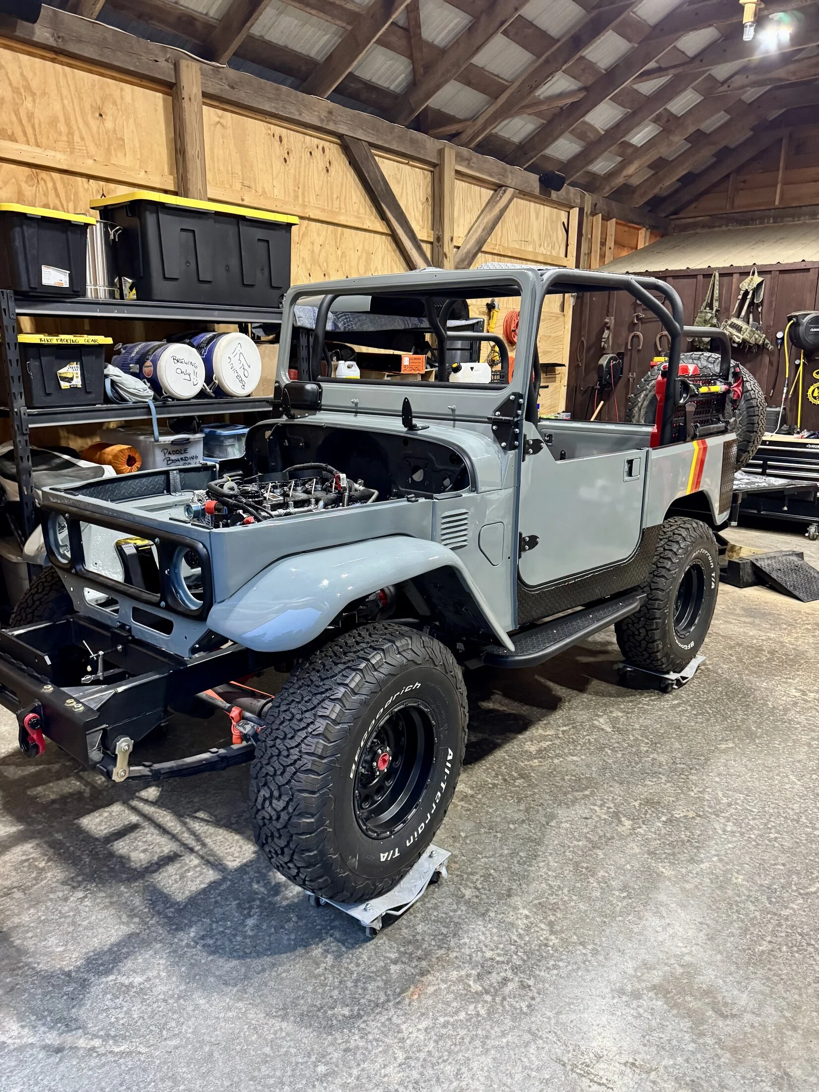

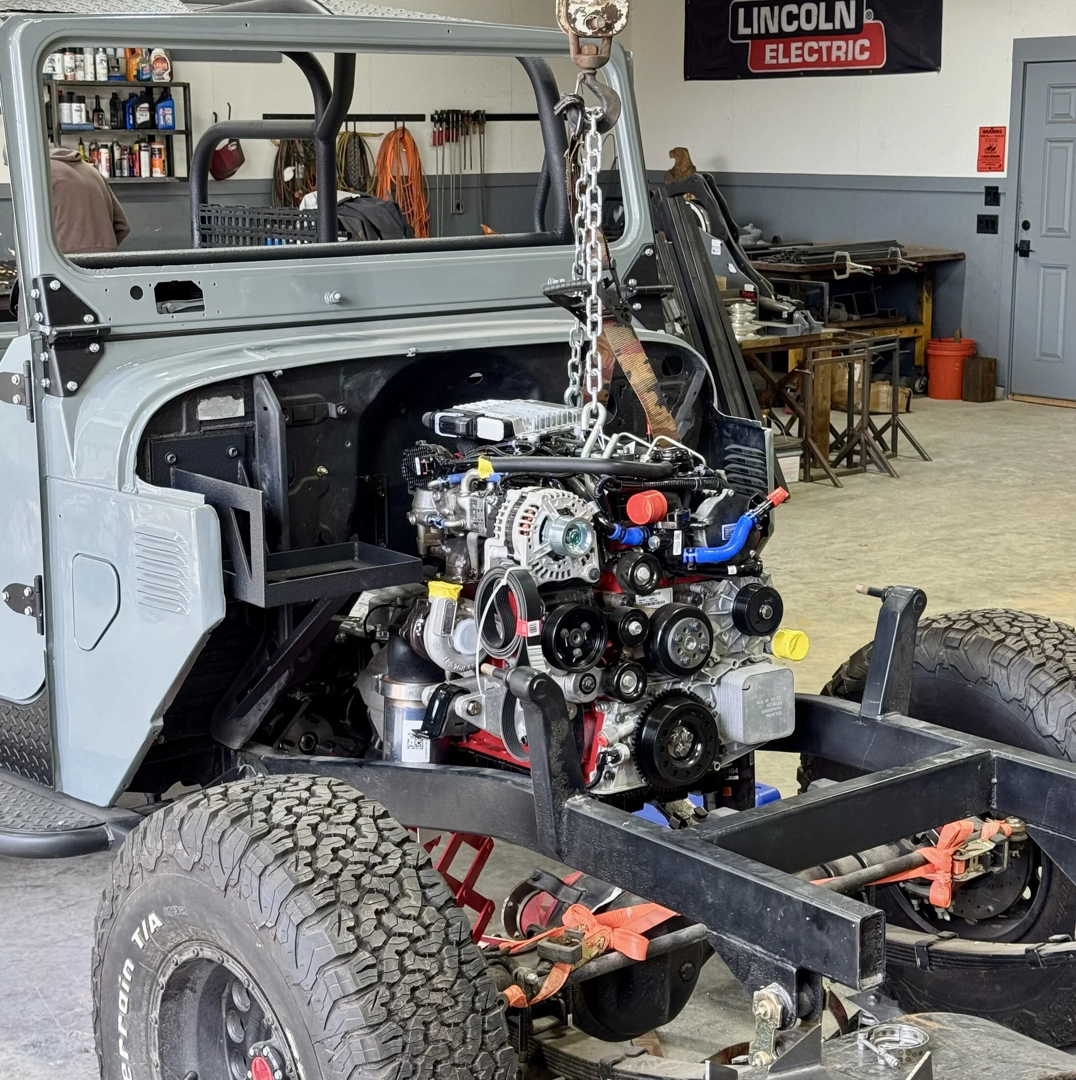

Got some Farkles added this weekend, and the front of the body. had to do a 1.5” body lift to accommodate the rock sliders, cause the front fenders were not fitting. Still, when I look at the photo from the front, I feel the fenders are drooping a tad bit, but everything has lined up perfectly. Anyone experience this? And if so, what was the issue/solution??

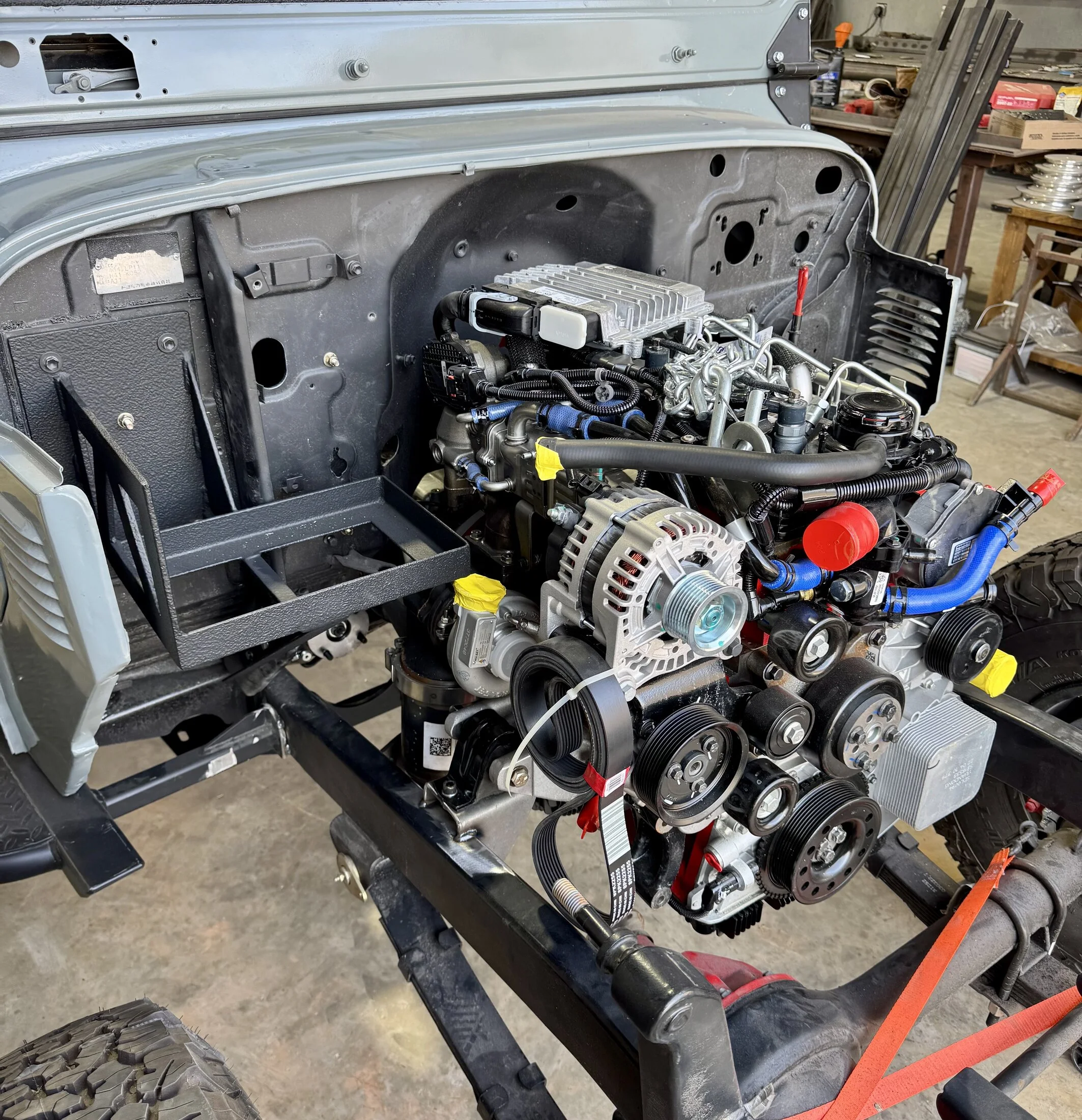

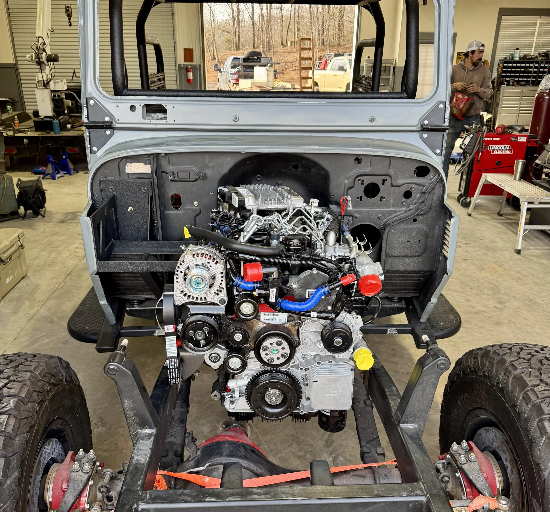

Been a hot minute since ,my last post…been a hectic and crazy ass year…..some new pictures from last weekend…working out the final details on the complete and finished diffs, knuckles, disc brakes. Also, starting to work on the fuel tank, and seeing how to run a Dakota Dig dash to the OEM gas tank, with sending unit, etc. Hearing that there are issues with the Toyota OEM sending unit communications with Dakota’s gauges…Any insights would be greatly appreciated. Pictures for reference. Starting to get to the home stretch on this build, trying to have it finished NLT Feb. 18th…for my 50th. We shall see.
