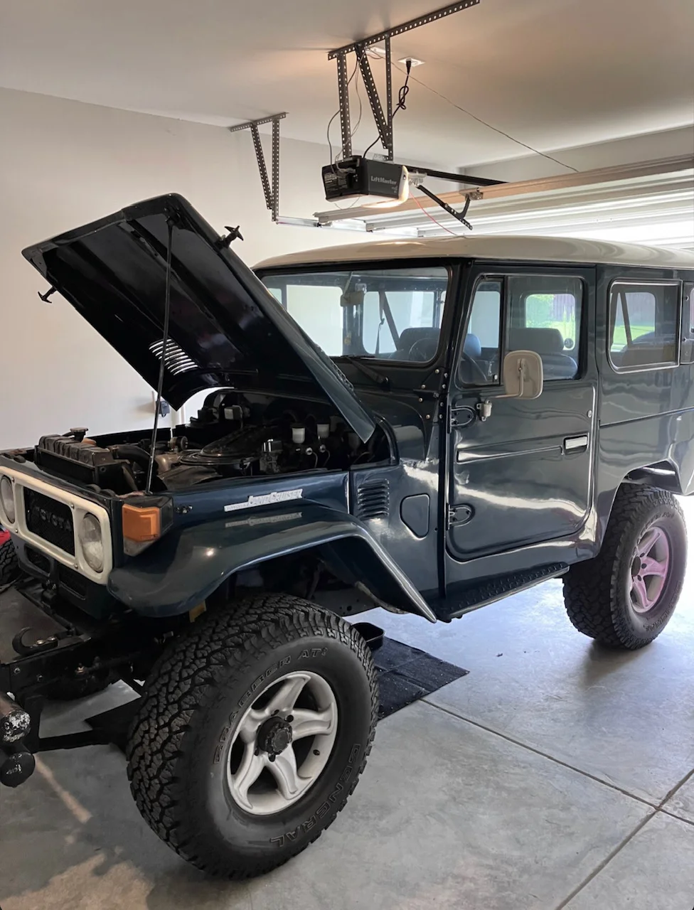

Well here we go. A little history on this FJ. Bought this a few months back from a fellow whom worked overseas, yes...S. America FJ out of Peru. He owned the vehicle for 5 years, brought it back with him and it sat in storage for a few years. Story goes wife wanted him to sell it, to which my response was "you can always get rid of the wife", lol.
Anywho, went and looked at it and since it had been sitting in storage for some time, it was running a little rough, but the body looked in decent shape from what I could see at the time. We drove it around the block, checked the 4-wheel drive, etc. and it all seemed good-to-go. Came back a week later and picked it up for a decent price. Took the FJ to a local mechanic friend of mine, and he showed me how to do a general tune up, change all the fluids, new battery, etc. We did so and the vehicle came to life running significantly better day-after-day the more I drove it. Drove it for about 3 weeks and then decided I was going to start restoring it.

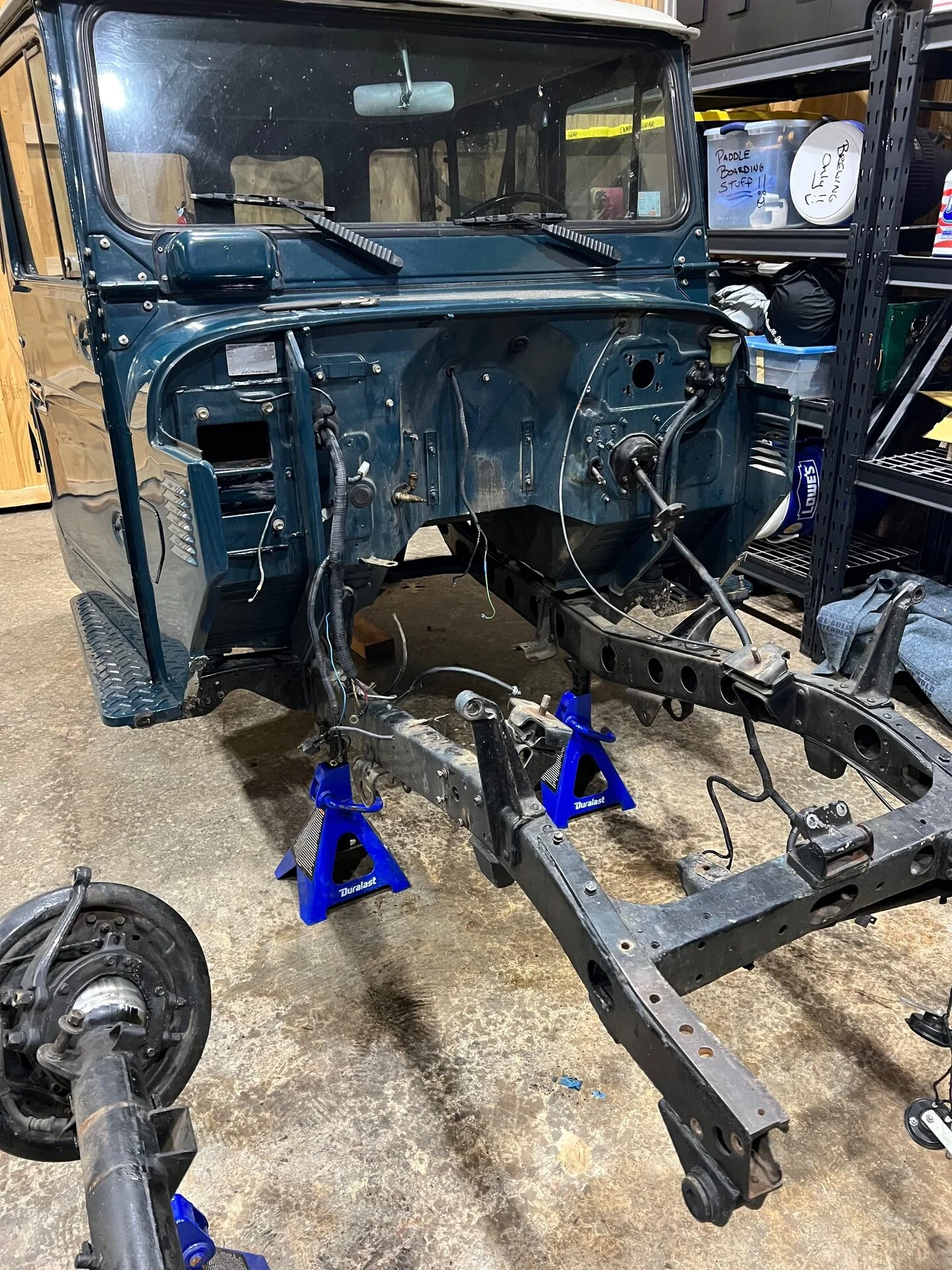

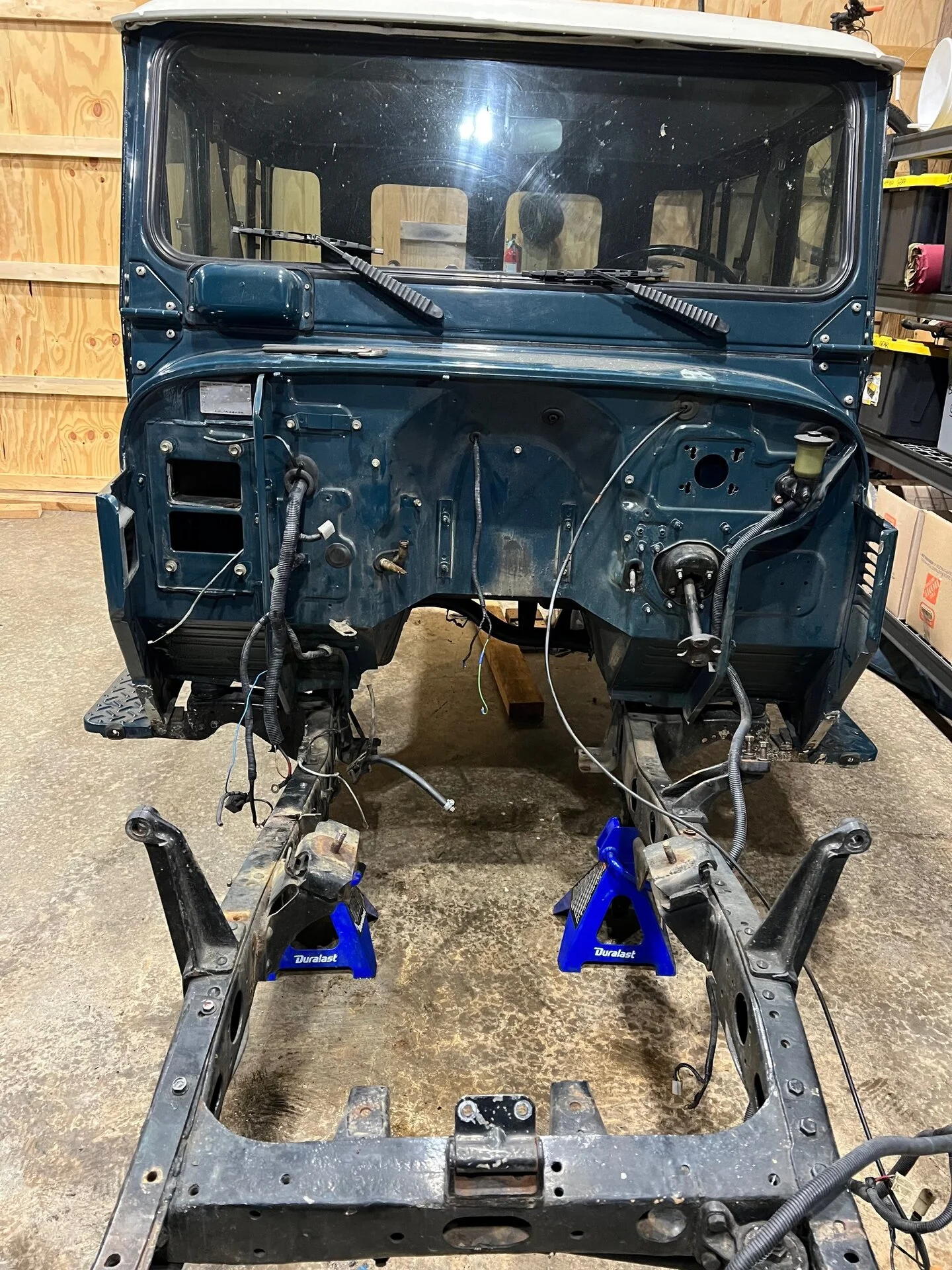

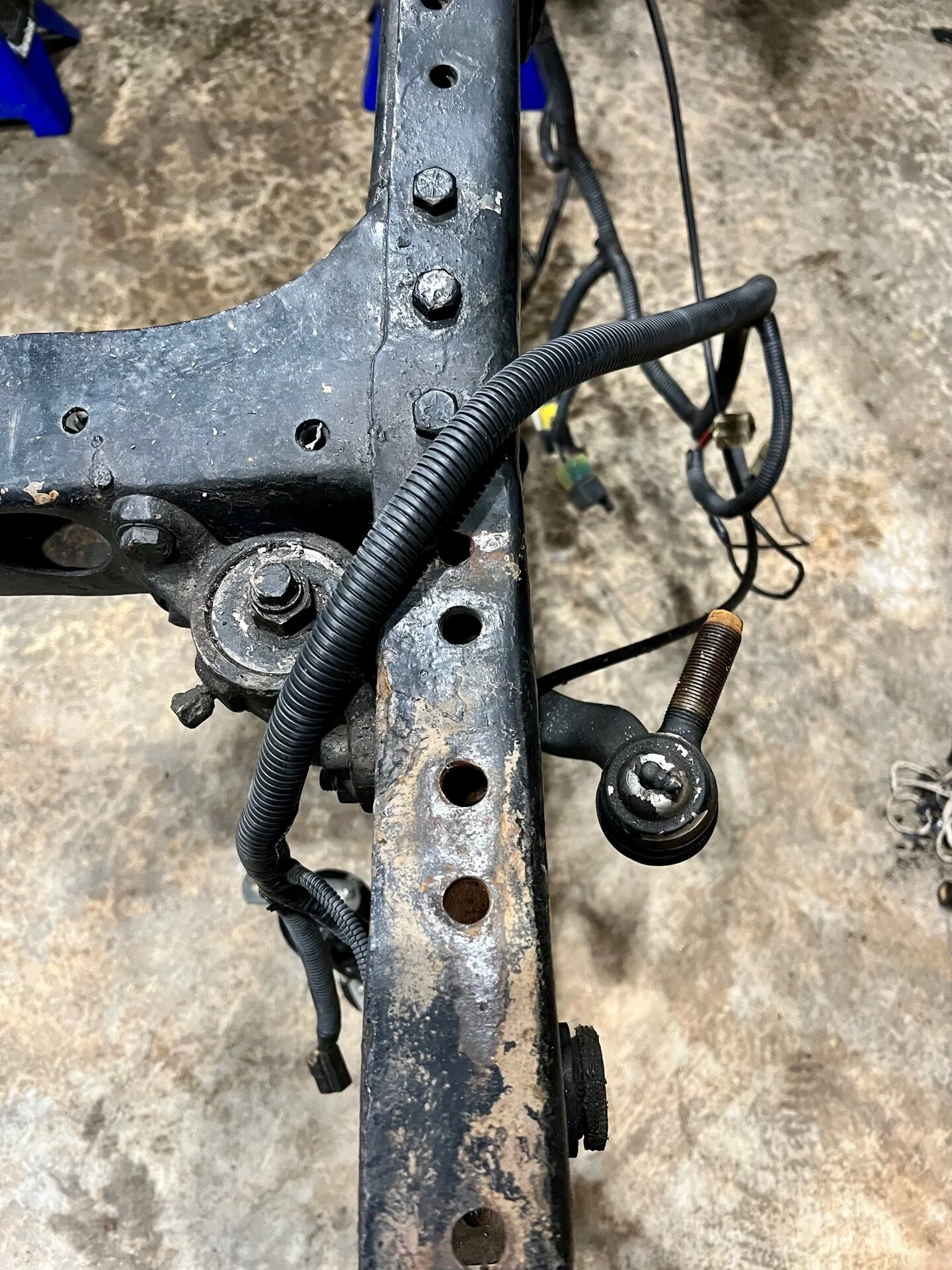

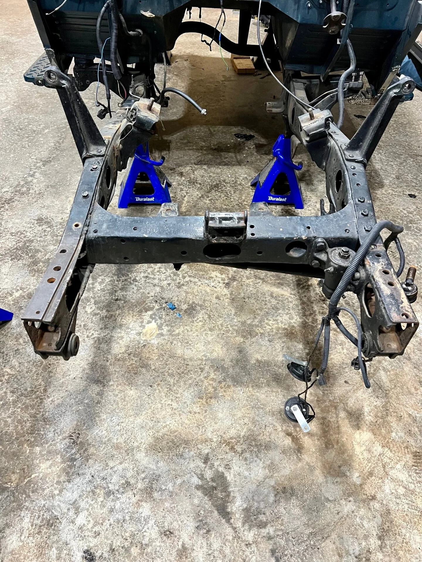

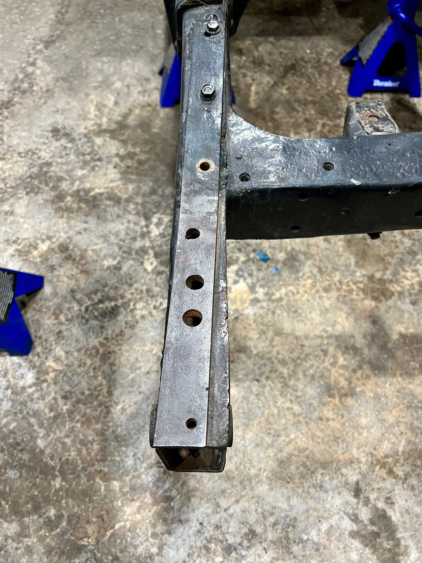

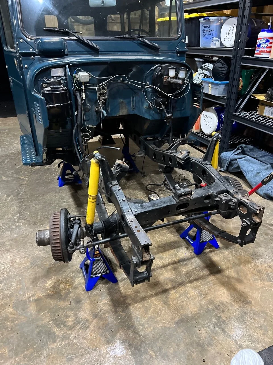

So started pulling the FJ completely apart to start the restoration. This came with a massive bumper/plate on the front. When i removed it, I instantly noticed something was off....as in the entire frame from the forward front leafspring mount forward was crooked as all hell. The frame was reinforced from the leafspring all the way back to the trans mount. Clearly this frame that was used to build this truck was abused. I know, I know, S. American FJ's. No need to remind me. Here are a few pics:

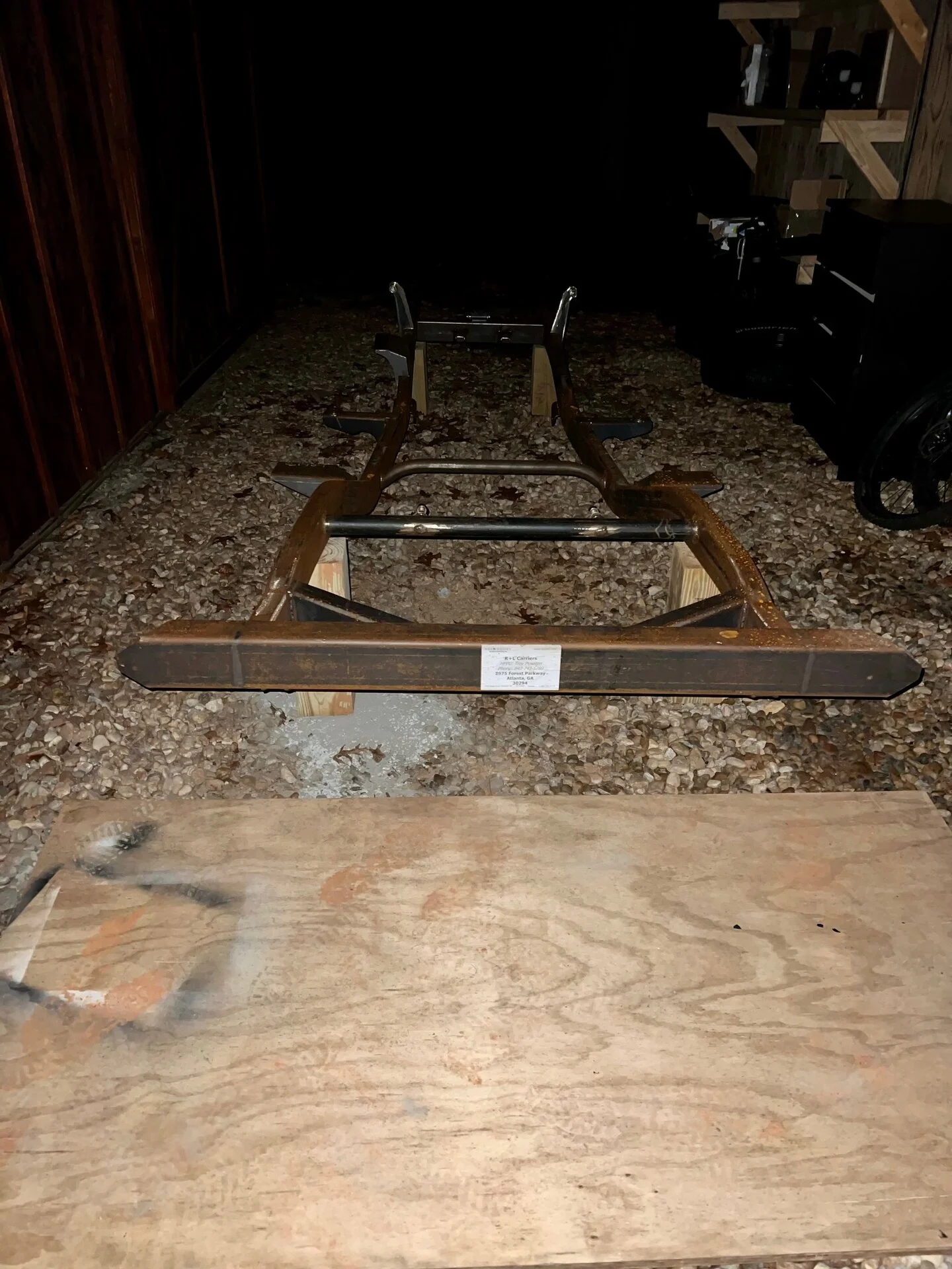

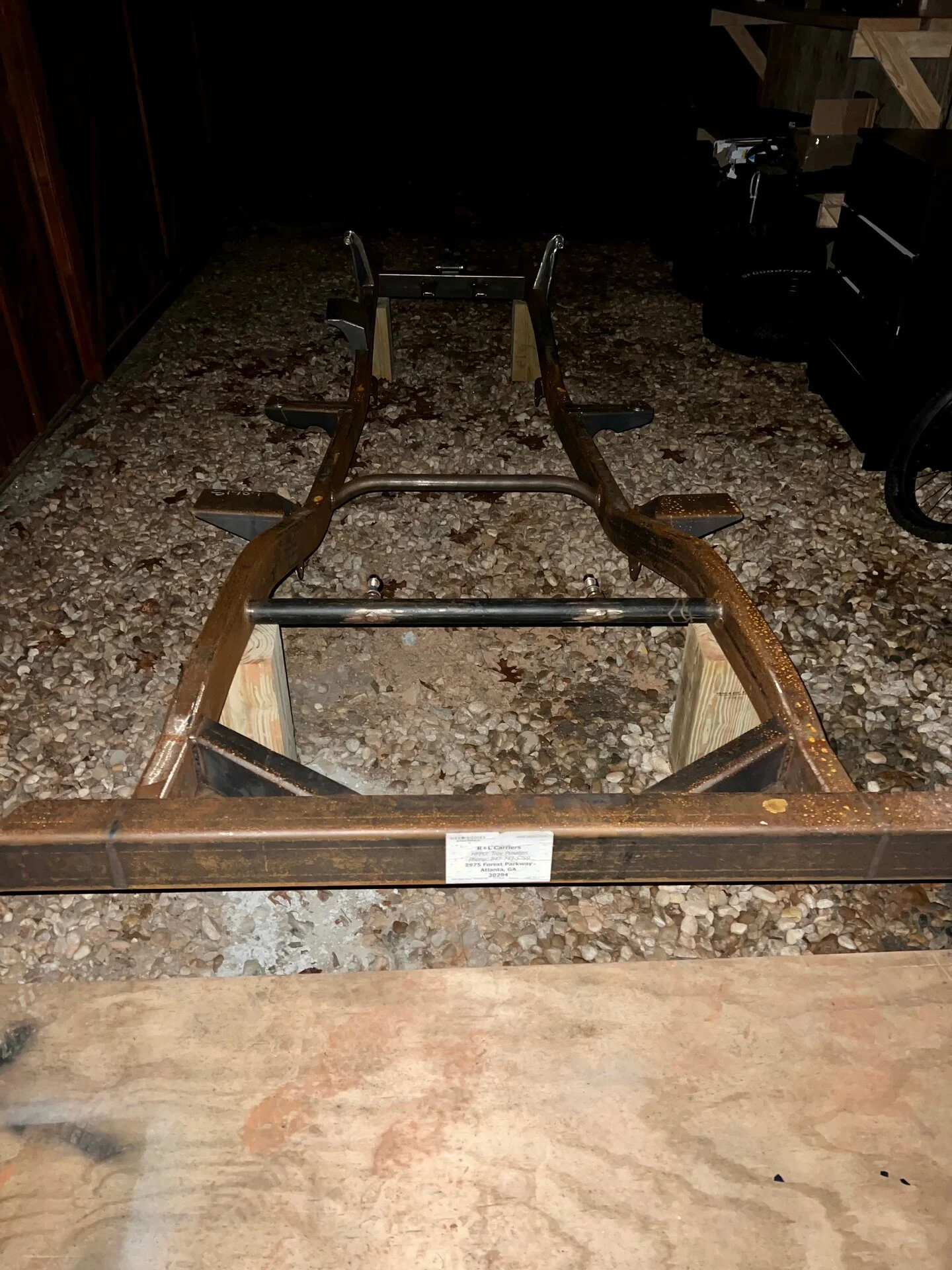

Anyways, not a big deal as since I knew when I got this I was going to go with a new frame from Aqualu. I gotta say, they mnake some nice frames. Amd their customer service goes above and beyond to answer any'all questions, and help along the way. Top notch folks up there in Canada. I received the frame a few weeks ago, and from time of order, to build, ship and deliver it took 5 weeks. Not bad at all. here are a few pics I just took of it, in the dark. Sorry bout that. Here ya go:

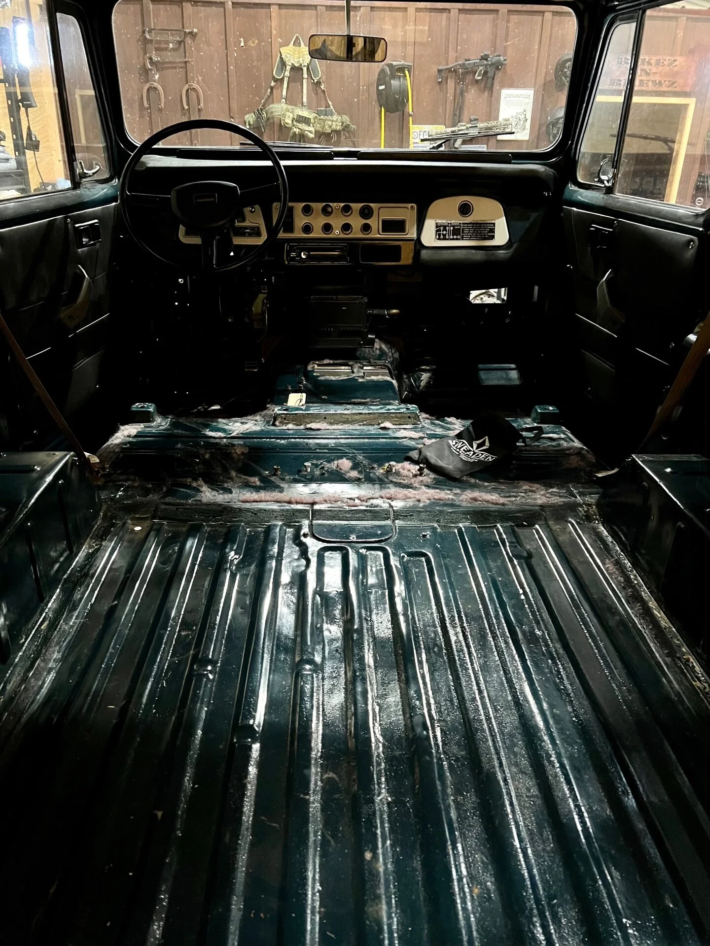

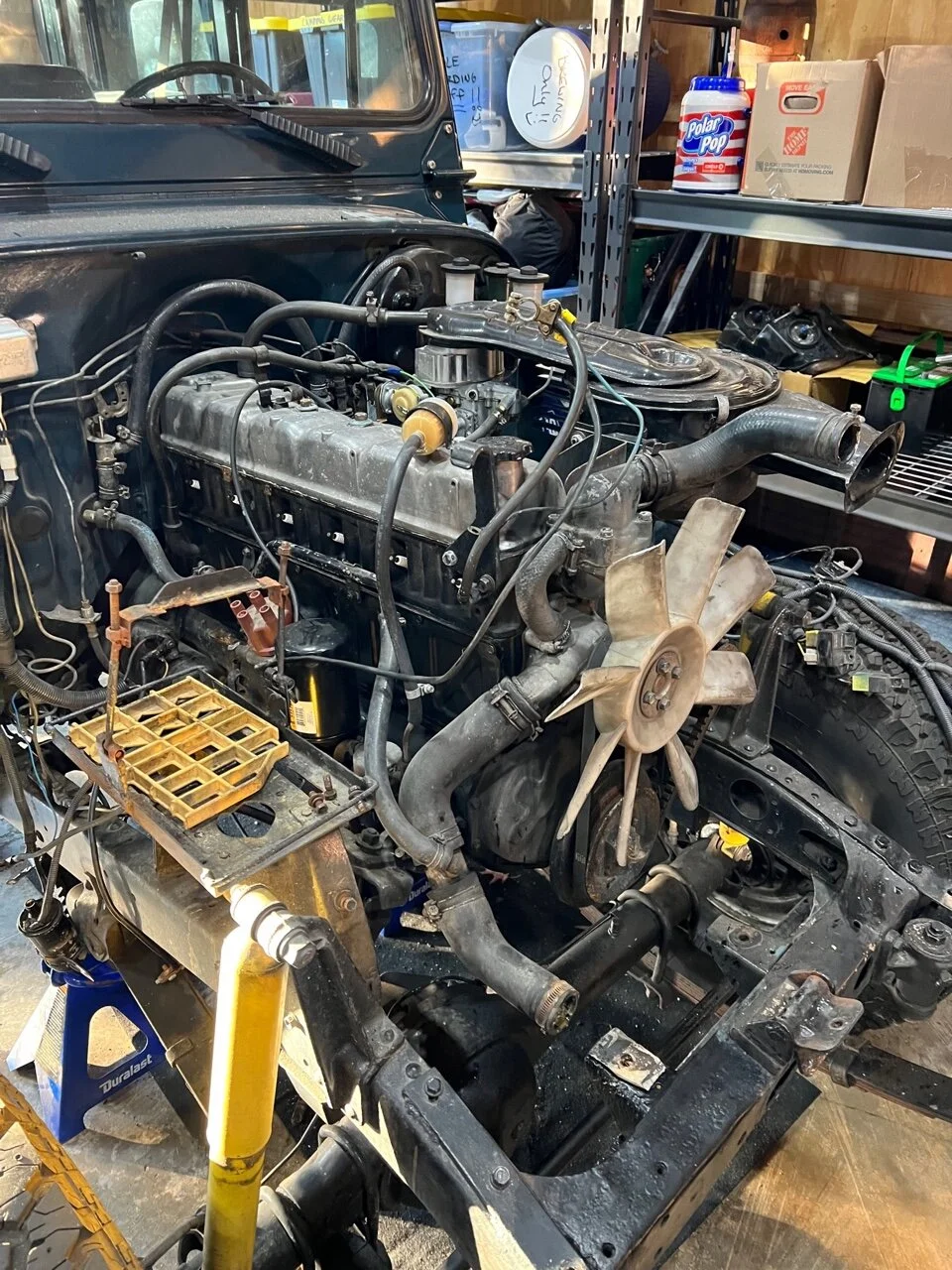

This past weekend the weather cooperated, and was able to get a lot done. Completely removed the entire drain train, axles (starting rebuilding the rear), and removed all the interior. Even though the frame was a complete disaster, the body is in really good condition. Also received my order from Redline to include:

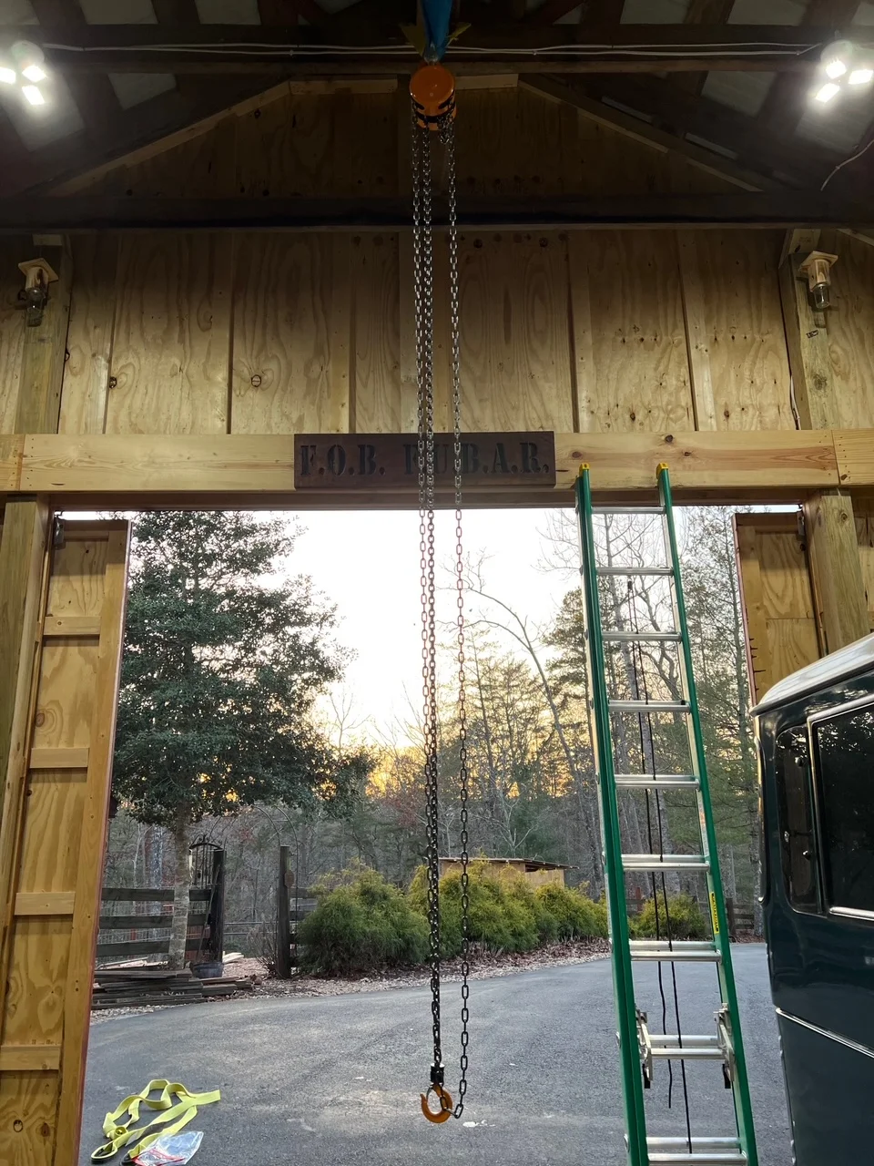

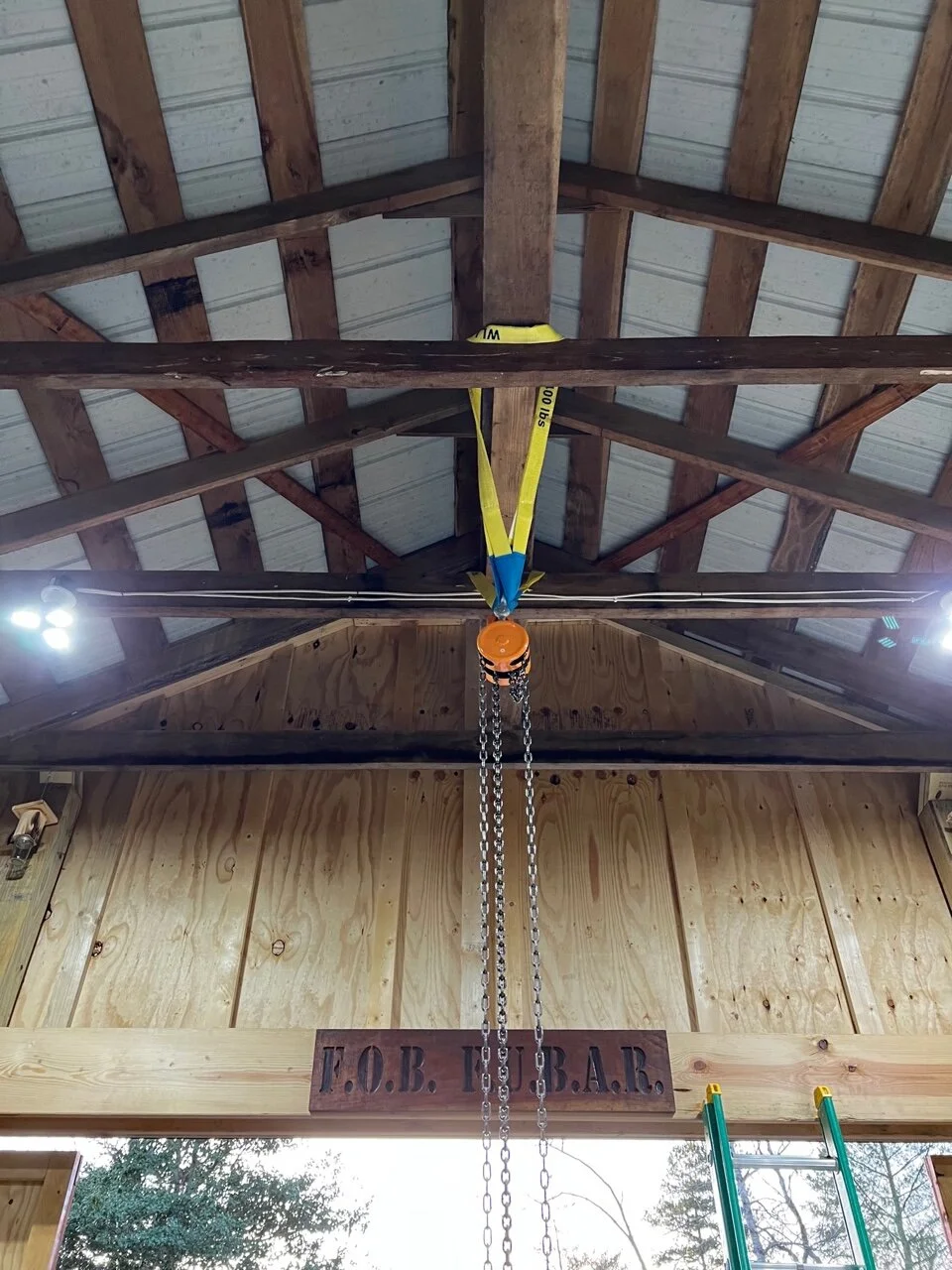

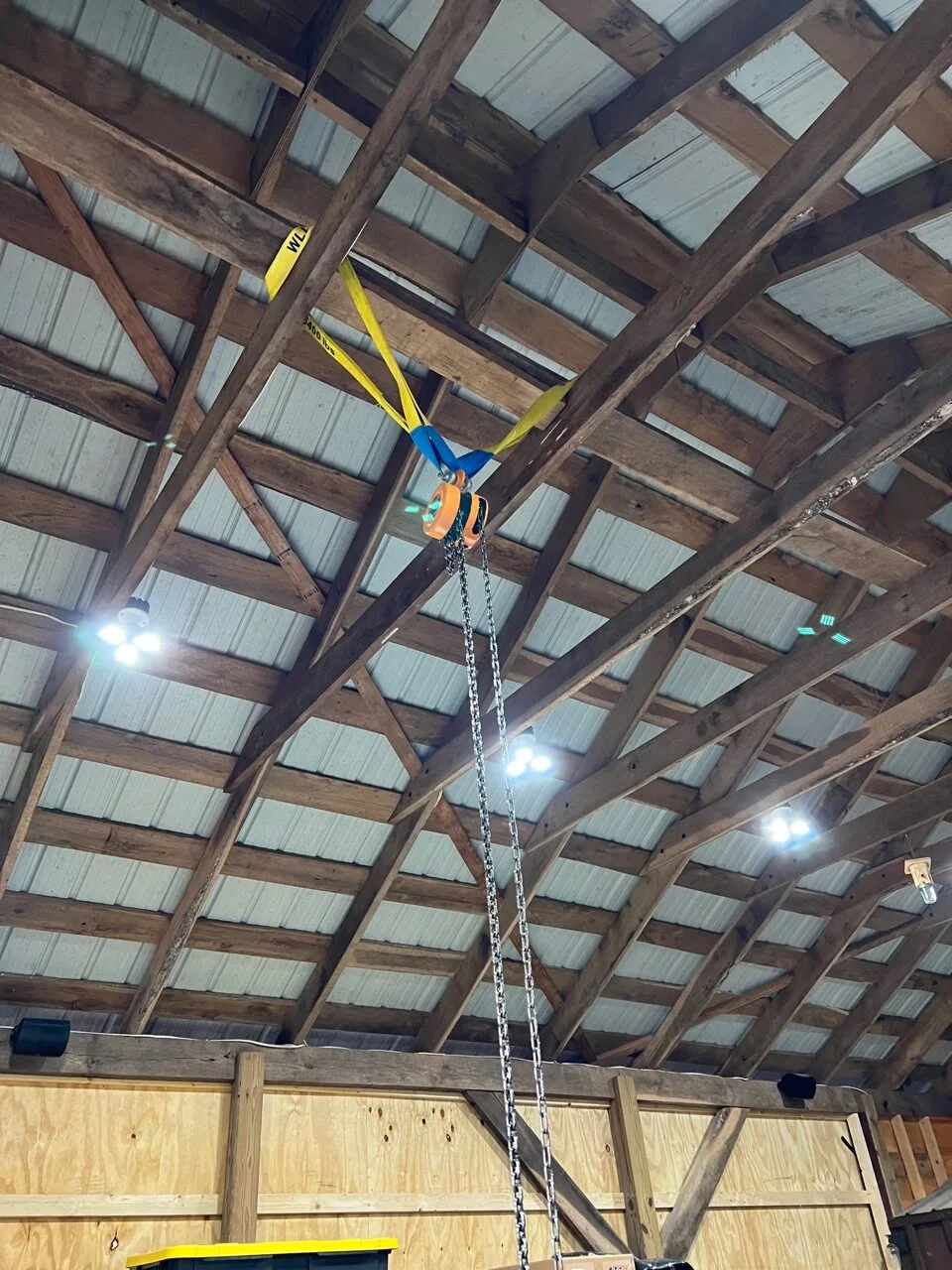

Great job so far. Maybe it is just the photo angel, but the rigging on that hoist looks a bit sketchy.
Must be the angle...It's reinforced up top, and the beams holding it all are 2x10's solid oak. I tested it all with 2 100lb. boxing punching bags, lifted it with ease, and no problem. I have a tendency to over engineer things like this, and this is definitely solid. Fingers crossed, lol.

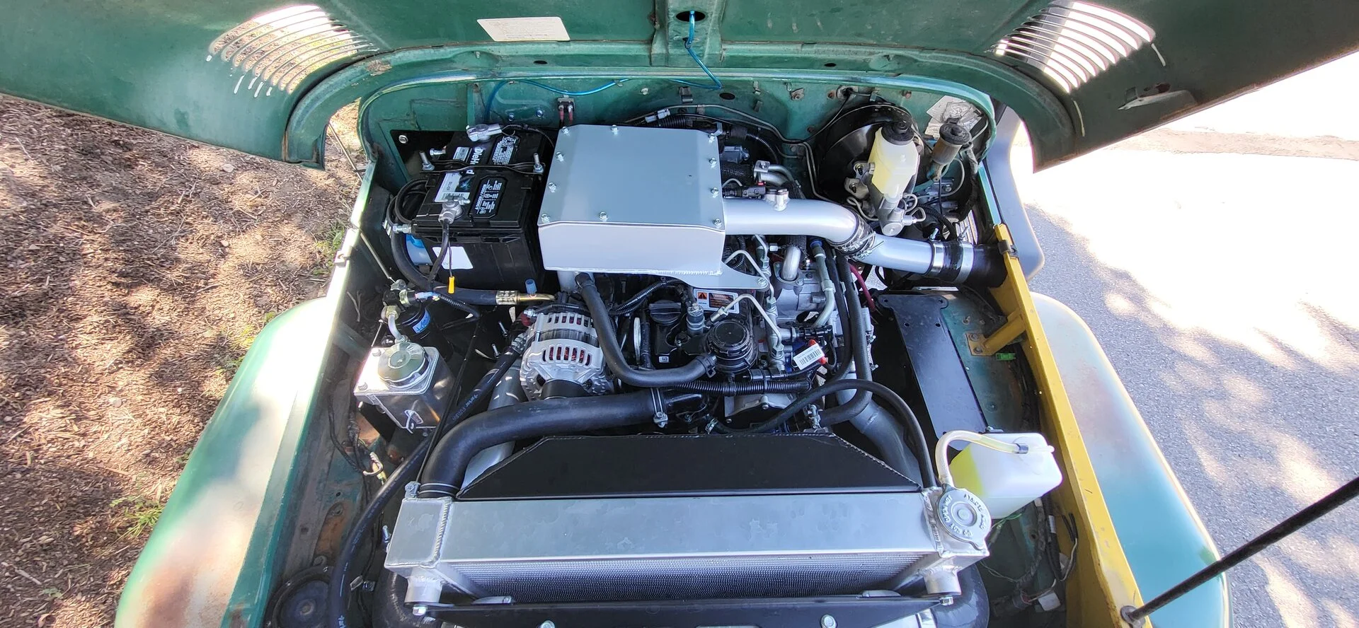

Would you mind posting more photos of that dash setup?

There is Cummins, and then there is Cummins. This not an industrial engine. I believe this to be more consumer grade.
It requires a massive radiator to keep cool. When worked, it gets really hot, really fast. Too little cooling, it'll go into limp mode until temps drop. I don't expect it to live a lifetime of abuse the way a 6BT would.
Also, (I've gotten used to it), that engine vibrates like a mofo.
Disclaimer: I did zero of the installation work on this. It was hired out, and they did a far better job than I could have.

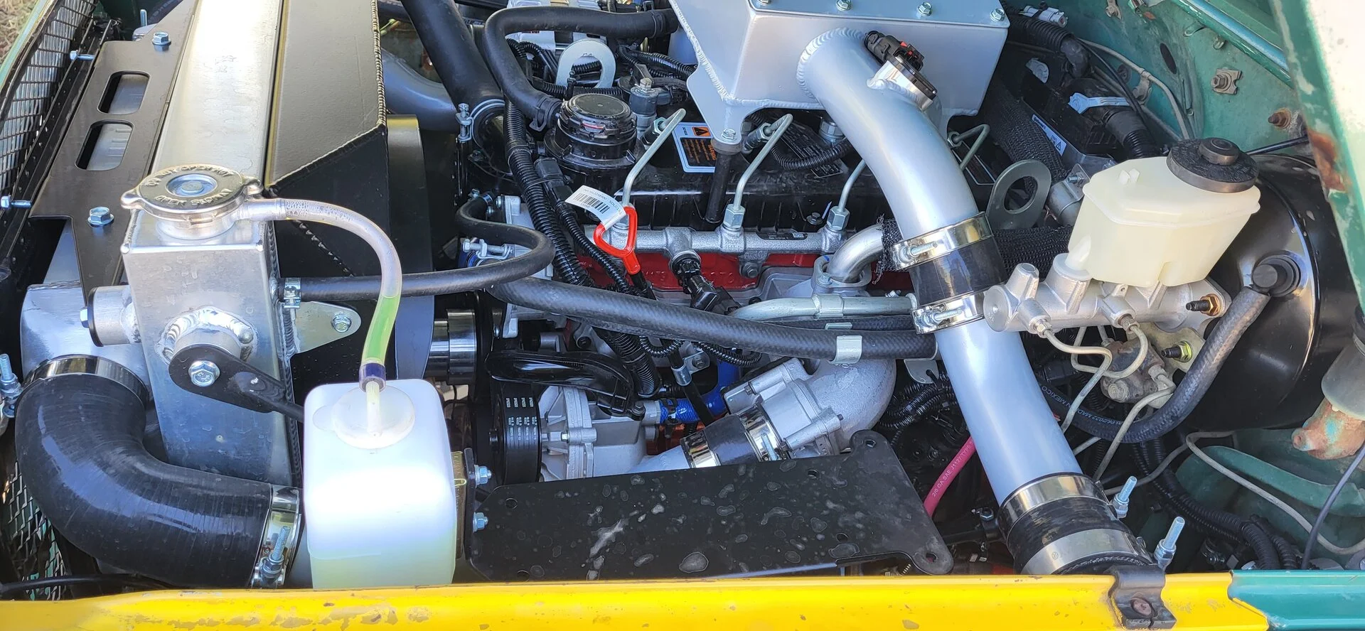

What did you go with for the radiator set up? Interested in that, as its on my list to first tackle when I get the new engine. Also, I am going w/ the H55 Transmission, as well as already have ditched the drum brakes all around and have disc brakes to replace them. Got a small lift as well....so I think I have already covered your above points with all new parts...thanks a ton for the pointers....might hit you up wit ha few more questions as I progress sir.
I'll have to measure the radiator. The shroud is important too. That was custom fab'd
