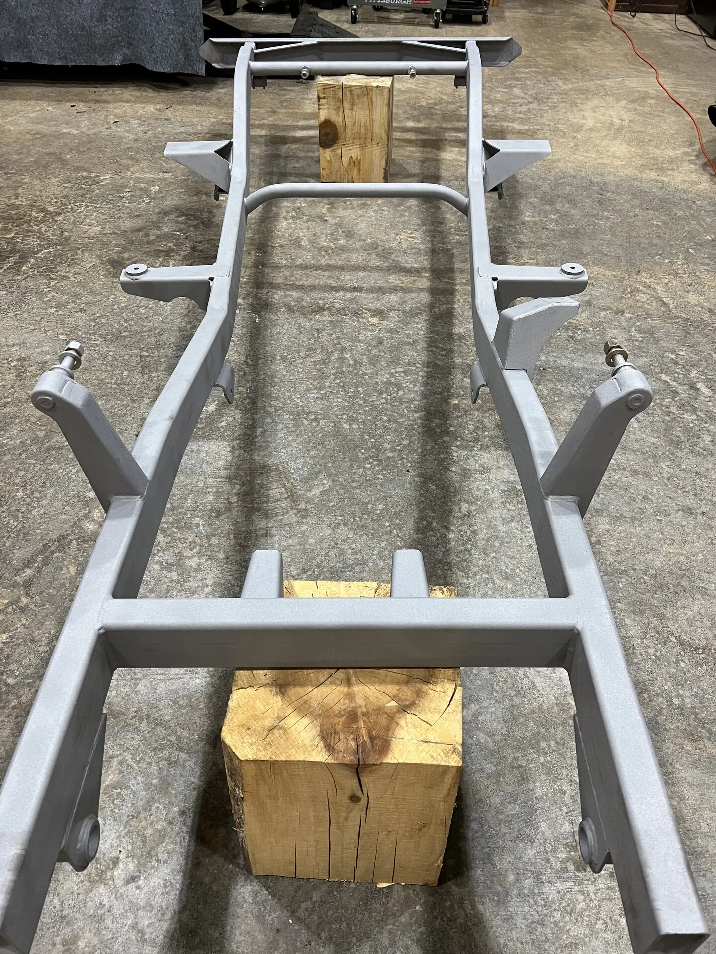

Interesting 40. I've always like the final year dash configurations so that's kind of neat. Your original frame is good enough for the rust belt crew to get good use out of. Remember to transfer over your frame number to the new frame to keep the next owner from cursing your offspring. Best of luck with the build.

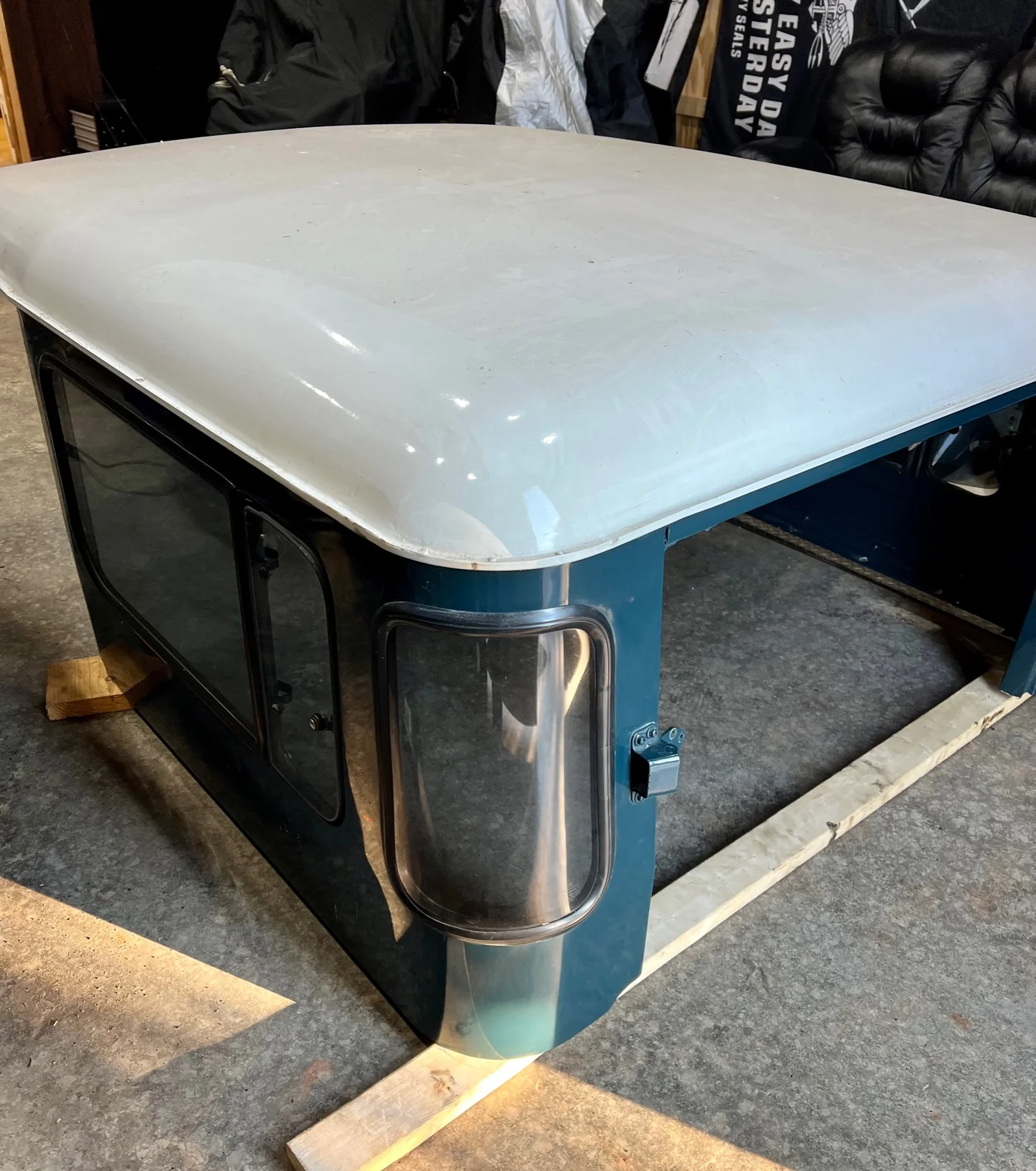

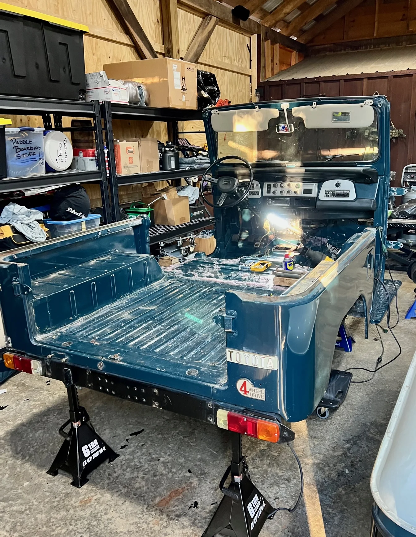

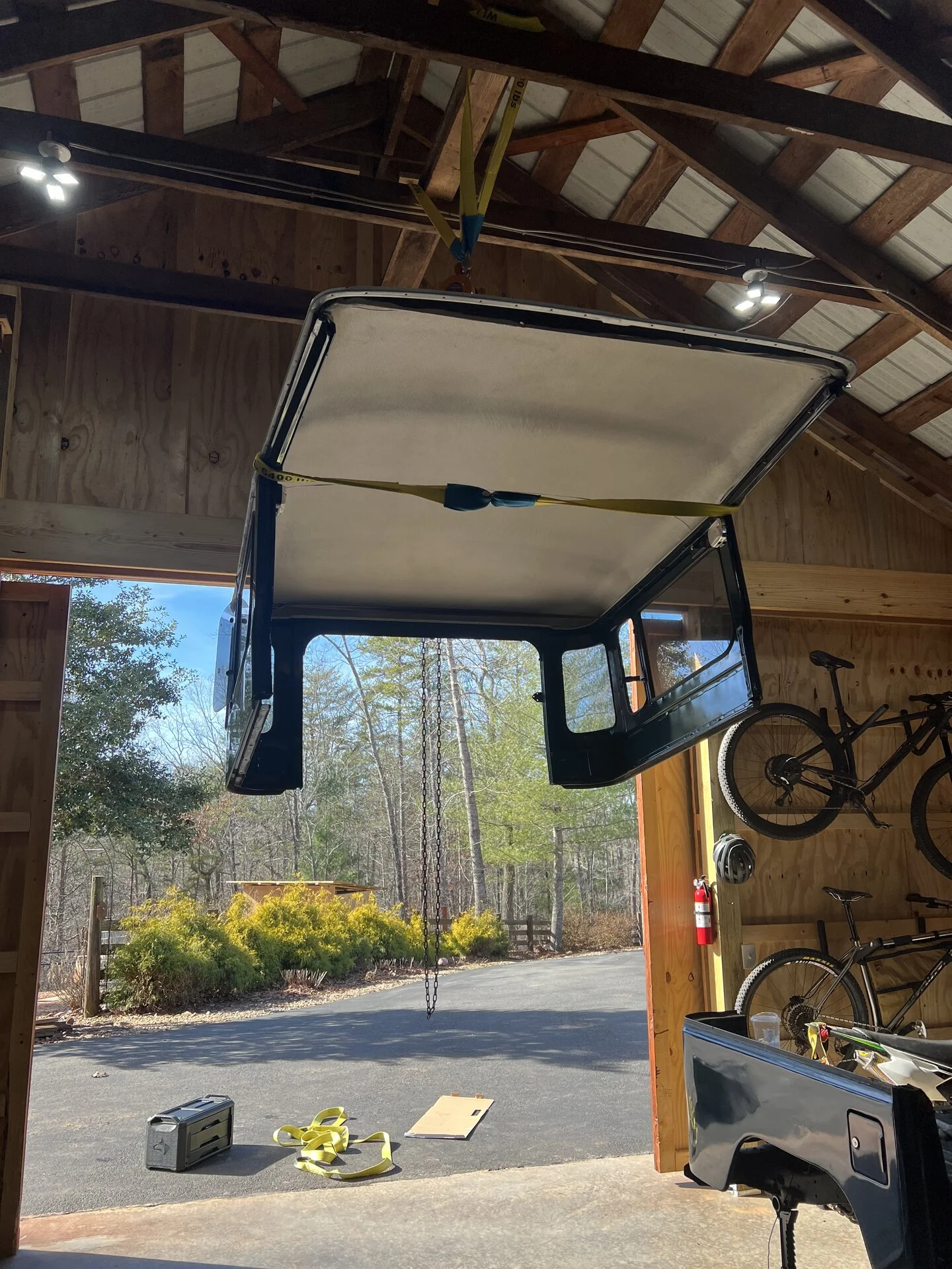

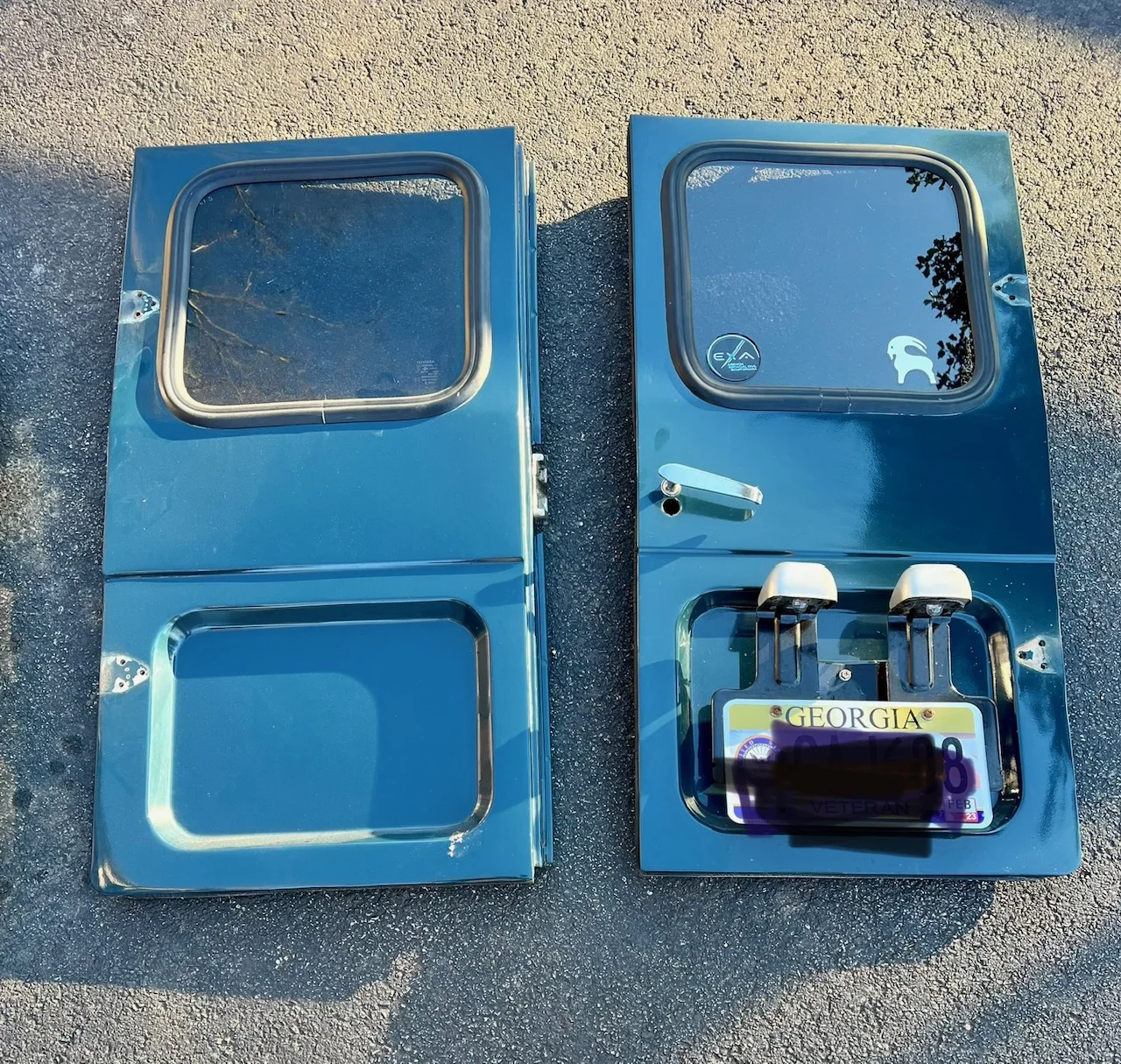

Well got some work done this past weekend, Managed to remove the doors, entire roof, ambo doors as well. Already have a buyer coming to take them away tomorrow am. So that’s good. I know a lot of folks advised me not to sell these, but not my vision for this 40 at all. Next steps are to remove the dash, the old wire harness, etc and then onto removing all the old paint and any bonds, etc….see what the body looks like. Then make repairs as necessary, and prime for painting.

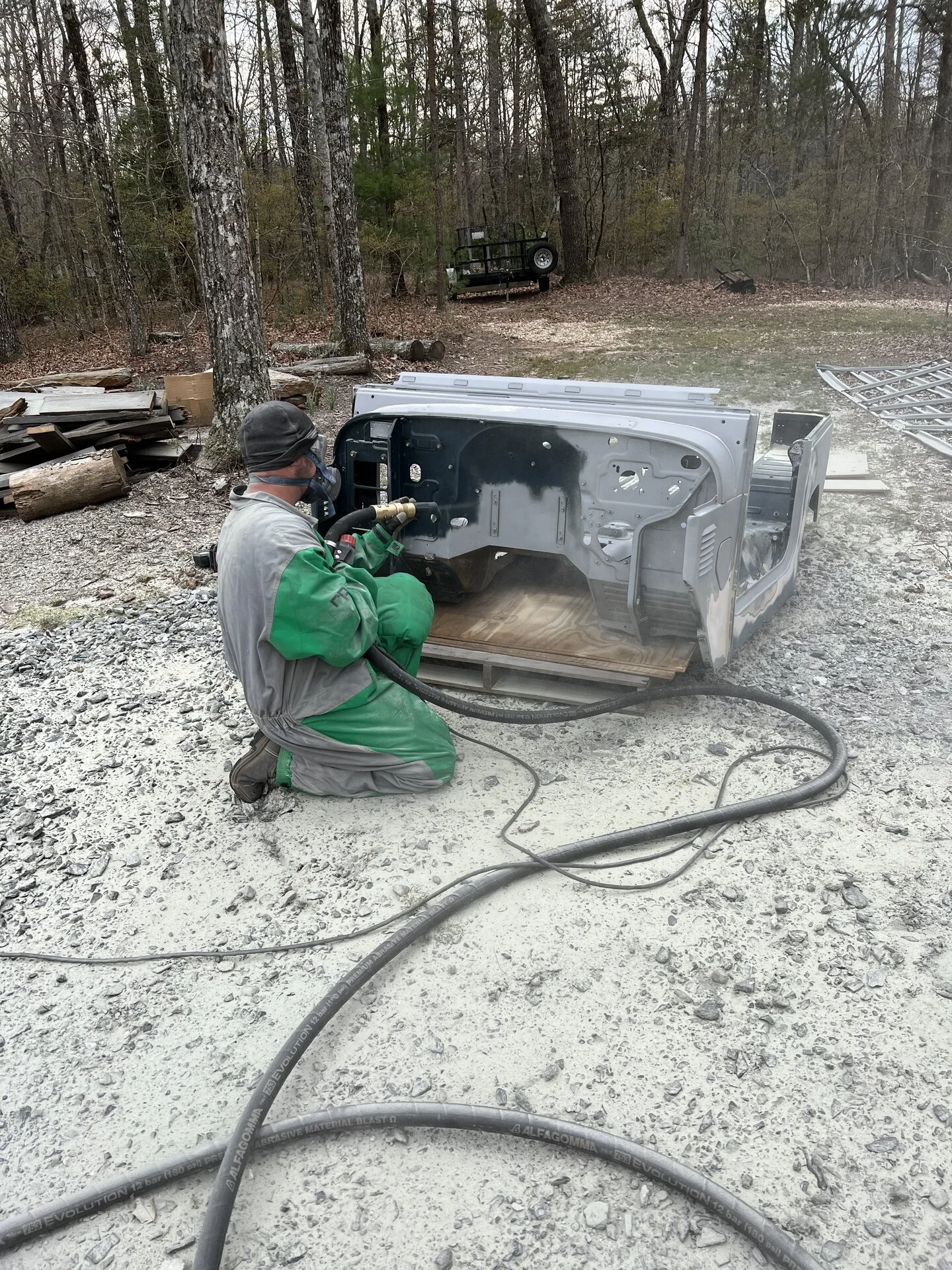

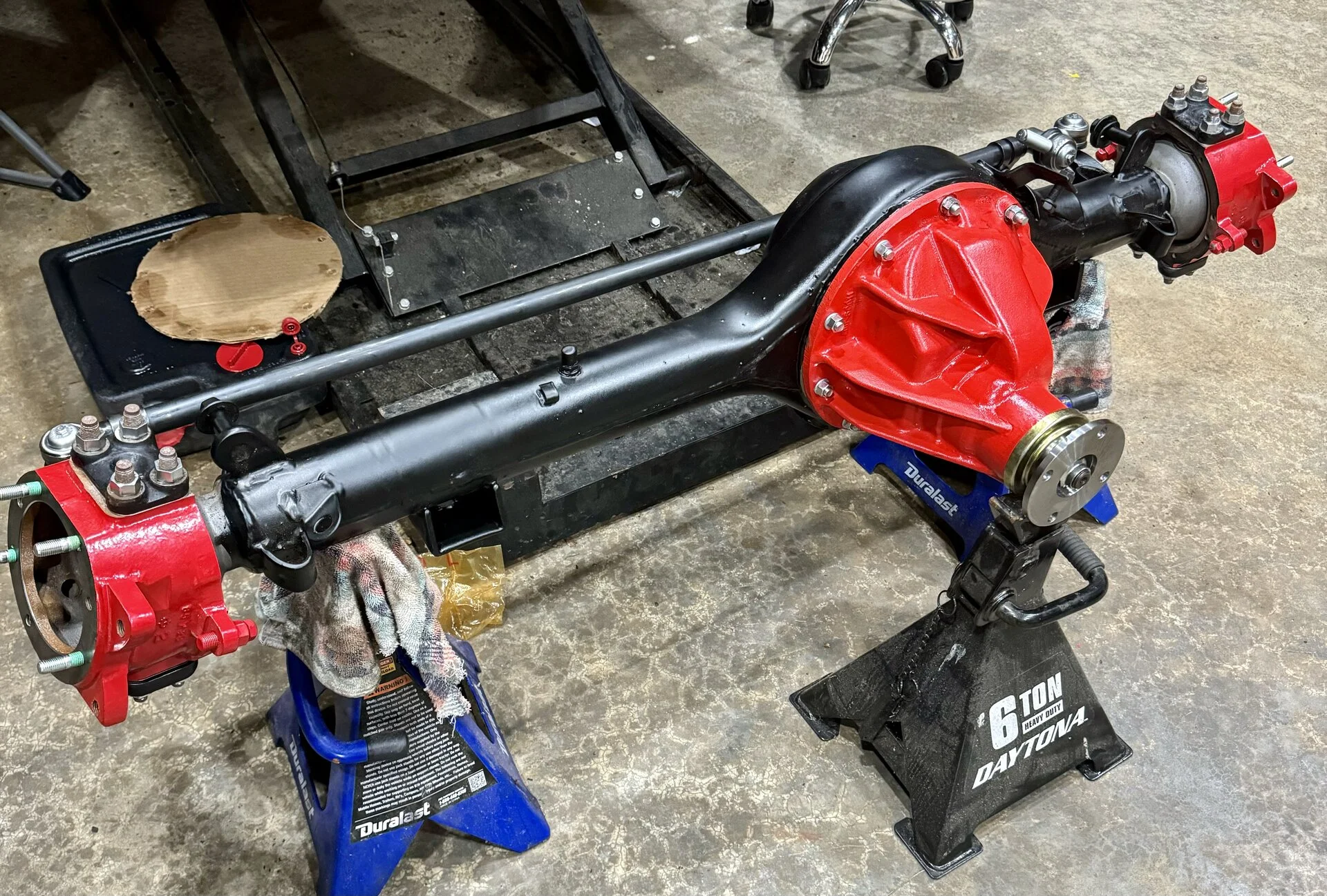

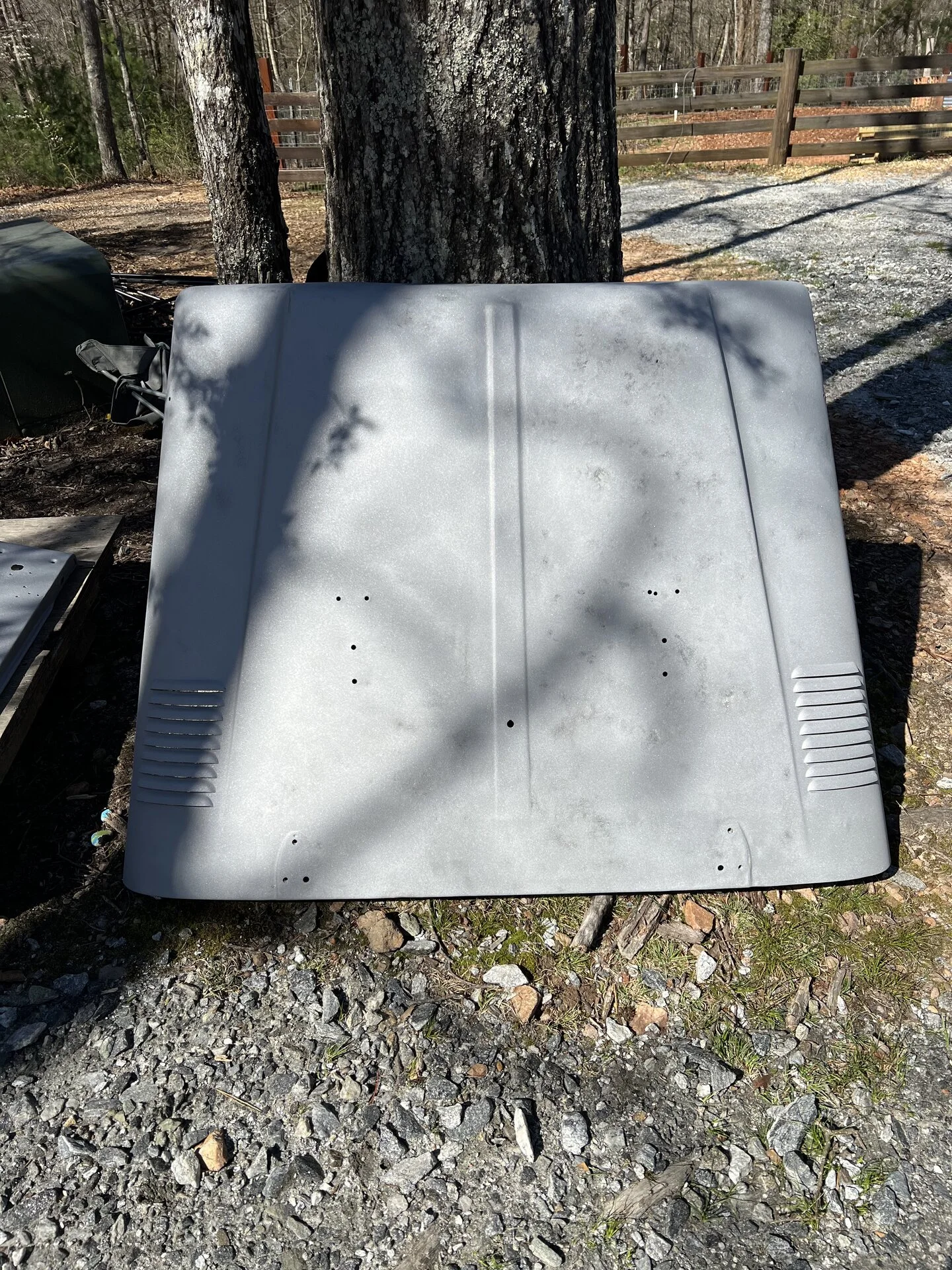

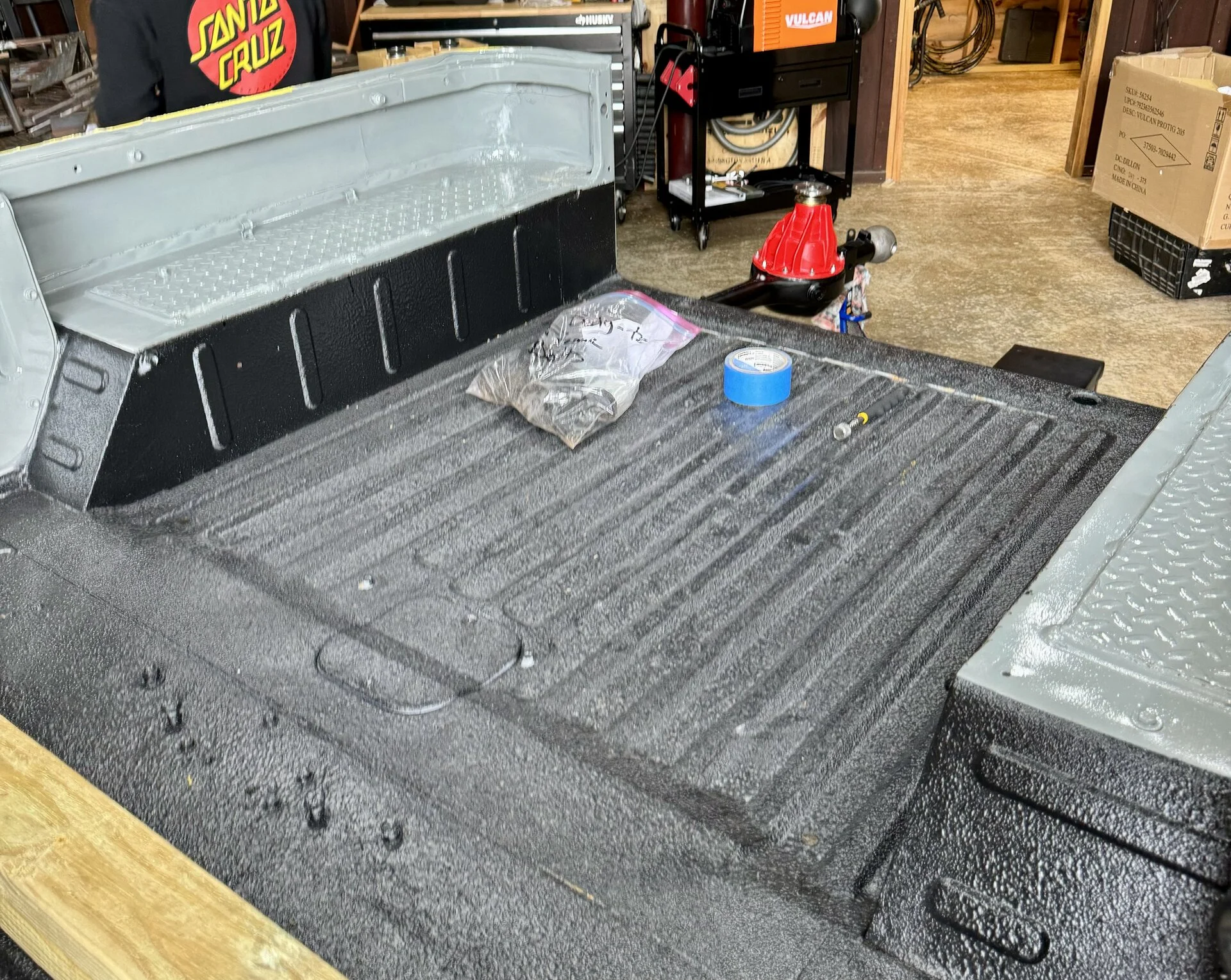

Long time, work busy as hell lately. So got off the body, etc, down to nothing. Always nice to have a buddy with a mobile sand blaster. WELL WORTH THE MONEY just for the amount of time saved removing the paint. Some pictures of the action below. Body is now in the hands of the paint shop, where we will be LINE-X’ing the underside, floor and firewall. Decided on paint color, which will be the newer Toyota Lunar Rock color. Also, powder coated the axles, came out pretty nice. Still waiting on the R2.8 from Quick Draw…new delivery date is end of May/June timeframe. Working on rebuilding the rear/front axles/knuckles this weekend. MORE TO FOLLOW.

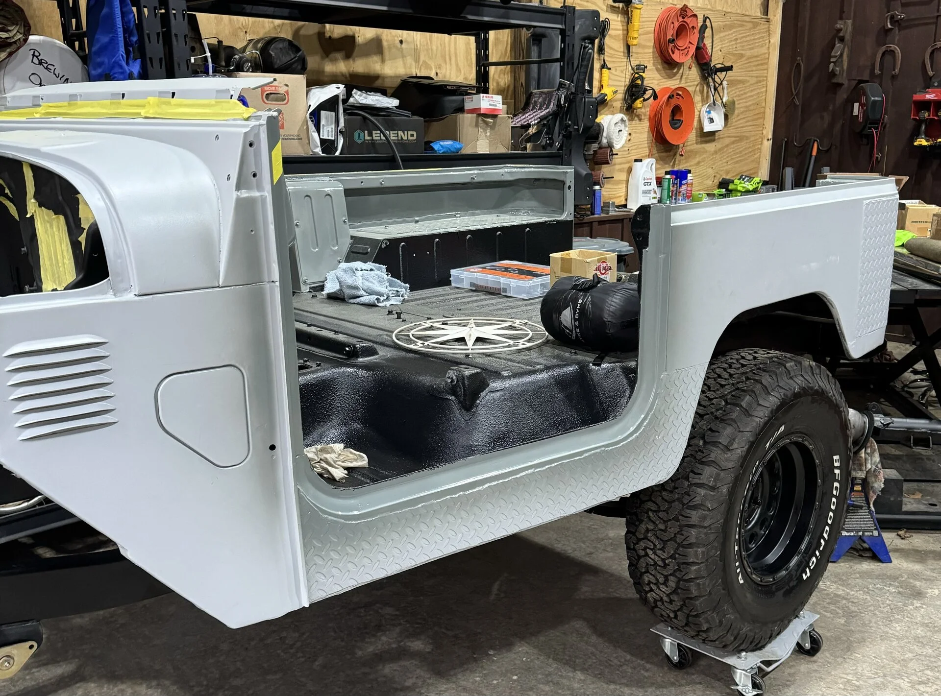

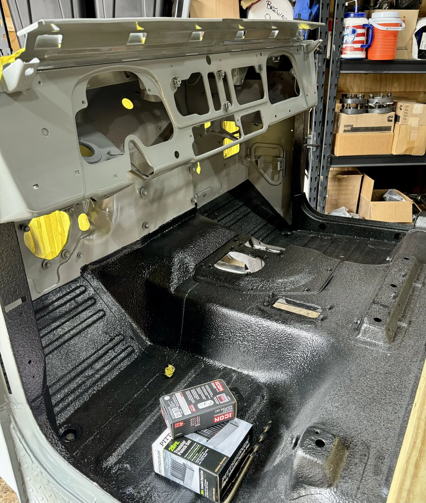

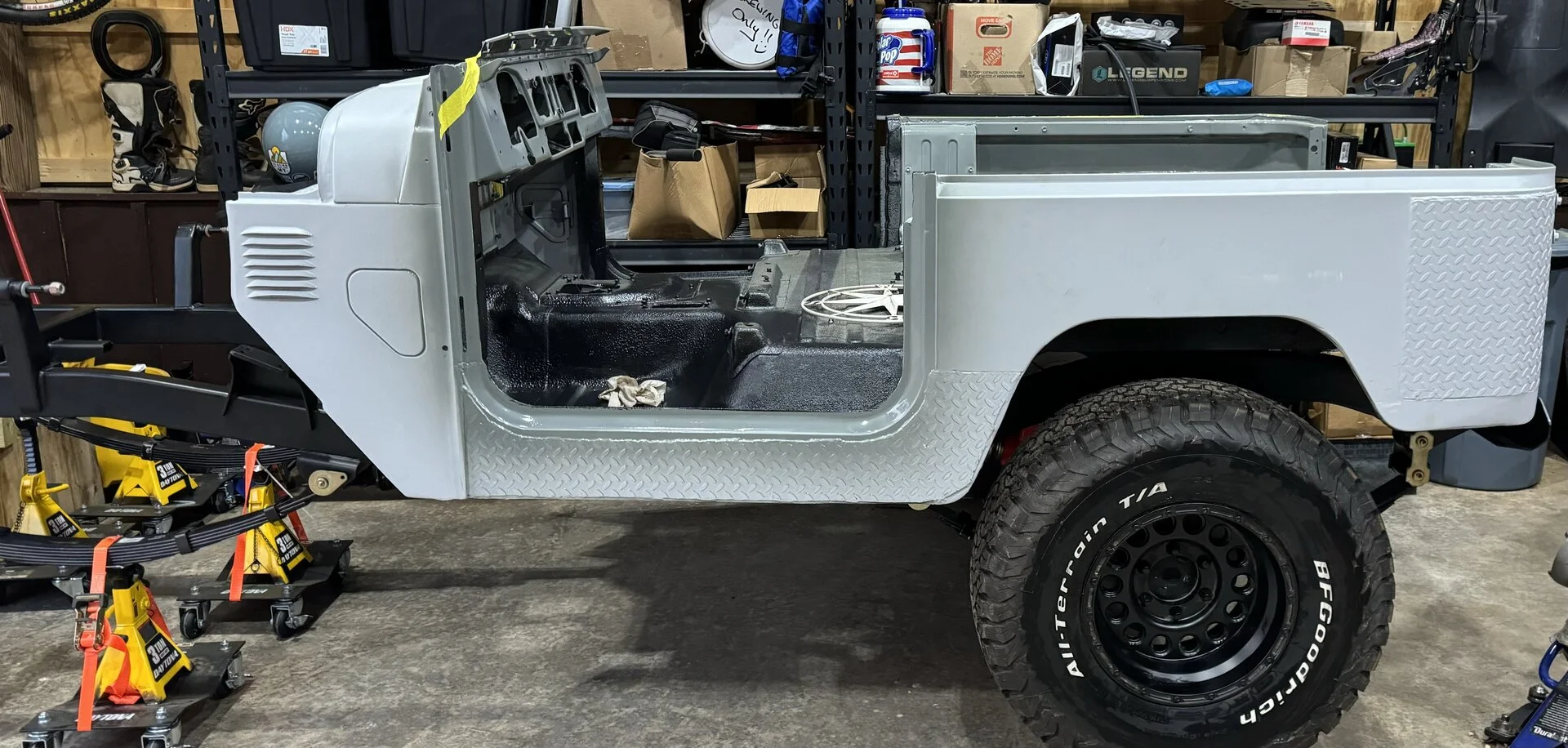

Well, been a hot minute….life sure gets busy when you get married an inherit 3 step teens, lol. lol good though, wouldn’t trade it for the world…back to the build. Finally got my R2.8 and got the axles rebuilt, and body fully sandblasted, all metal repaired, and underside LineX’d. Got the primer on and started toying with the color, gonna be the newer gray/green color you see on the newer Yota’s, I believe it’s called Lunar Rock. Anywho, here are some recent pics…..
You have the steering knuckles installed on the housing upside down. Also looks like there’s no grease in there?
Yeah, not done with the front axle/knuckles just yet…..thanks for the heads up…..just getting axles on the truck with wheels, so I can get it on a trailer, and get the body back to the painter, and get all the painting done….then I will get back to finalizing the axles fully.
Where'd the diamond plate come from? I don't see any in the blasting pic. Cool build though!

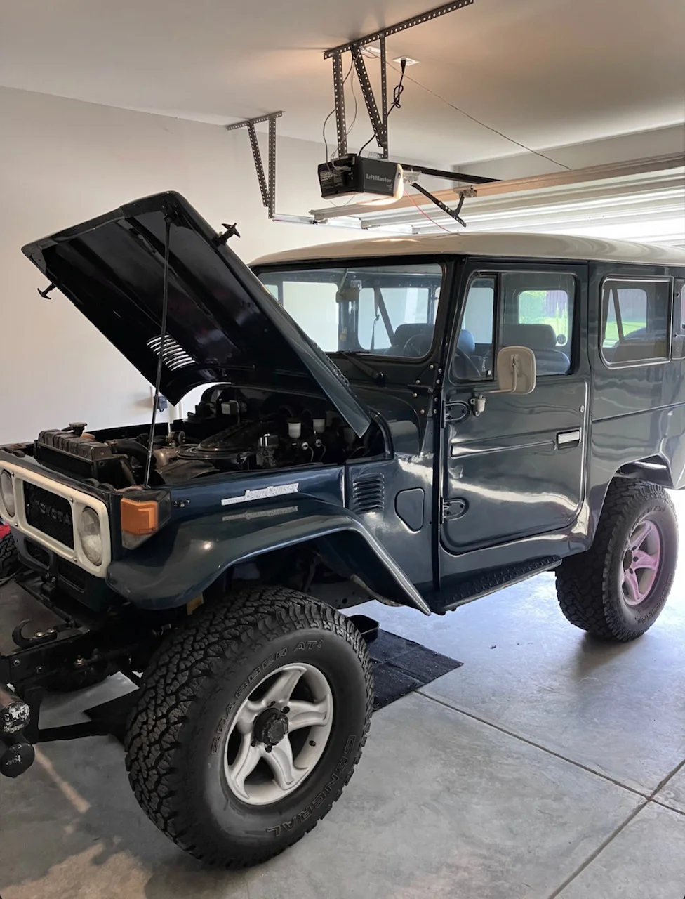

Well here we go. A little history on this FJ. Bought this a few months back from a fellow whom worked overseas, yes...S. America FJ out of Peru. He owned the vehicle for 5 years, brought it back with him and it sat in storage for a few years. Story goes wife wanted him to sell it, to which my response was "you can always get rid of the wife", lol.
Anywho, went and looked at it and since it had been sitting in storage for some time, it was running a little rough, but the body looked in decent shape from what I could see at the time. We drove it around the block, checked the 4-wheel drive, etc. and it all seemed good-to-go. Came back a week later and picked it up for a decent price. Took the FJ to a local mechanic friend of mine, and he showed me how to do a general tune up, change all the fluids, new battery, etc. We did so and the vehicle came to life running significantly better day-after-day the more I drove it. Drove it for about 3 weeks and then decided I was going to start restoring it.

Yeah, for real…the 6 months was a pipe dream. I guess we all start out with good intentions, lol. Spent a lot of time waiting on the Cummins….and also getting the body work completely redone by a professional metal worker since I am not one lol. It will all be on four wheels with completely rebuilt front/rear axles, and off to final paint this weekend. Fingers crossed.
