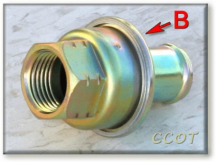

Anyone by chance know the size of the threads of these Air Injection Check Valves?
Has anyone found a substitute?

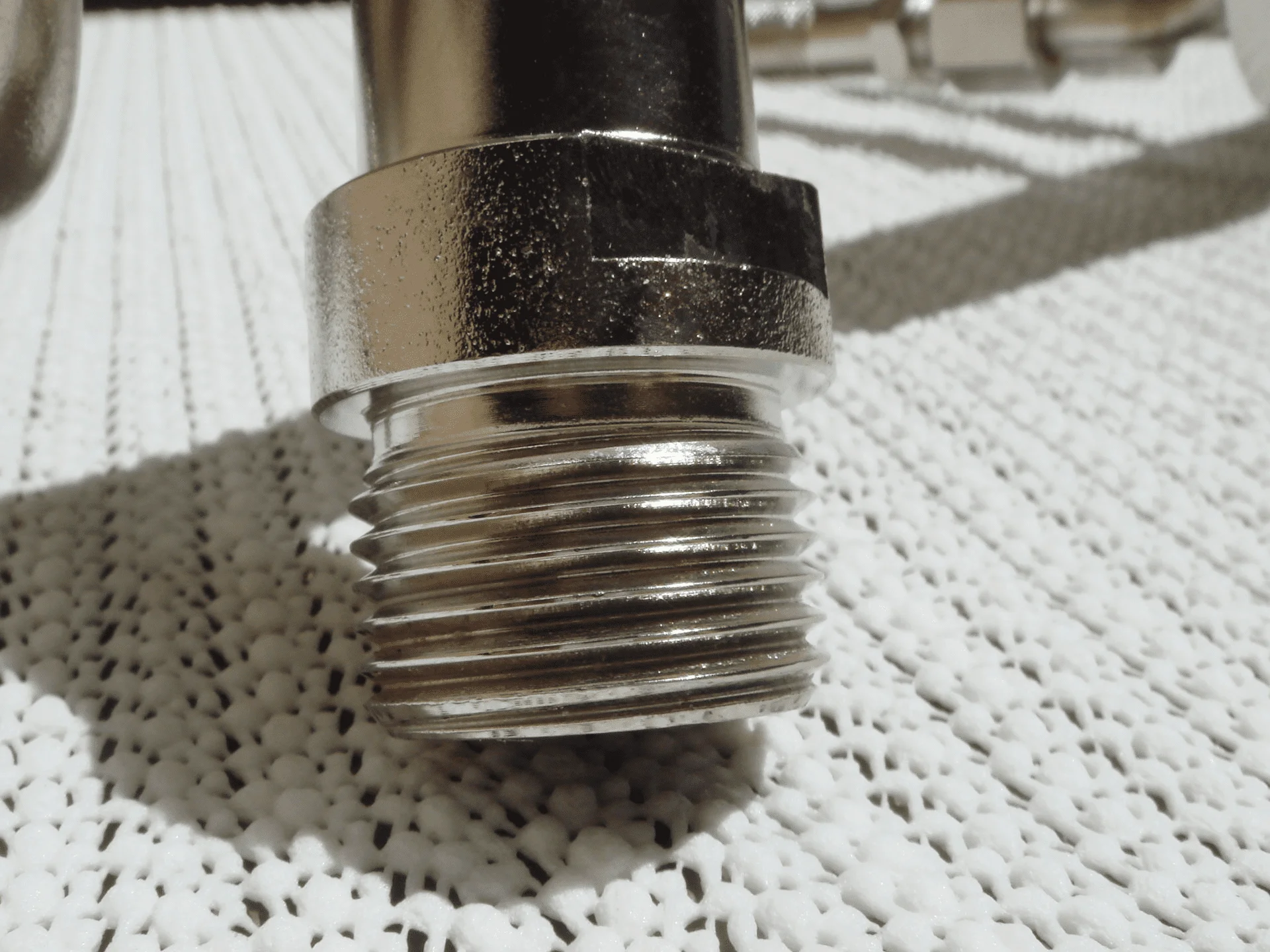

M24x2.0mm

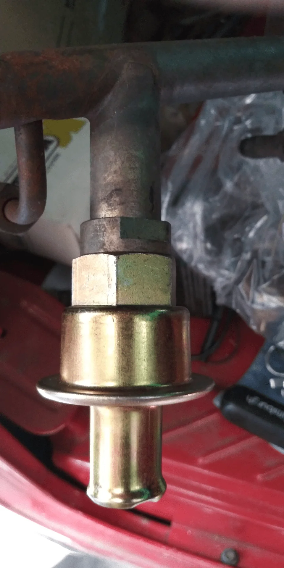

STandard AV8 is a direct replacement that i just bought recently but it has an 18mm hose barb which is smaller than stock, but i made up the space with high temp pipe tape and it worked just fine for smog.
Another option I found is the standard AV13 which is M24x1.5 and the correct hose barb size, but would need to be retapped to 24x2.0mm.
Post #16, @cps432 reports that Napa 2-29002 works but as above needs a wrap to make the smaller hose barb work. For some reason napa won't let you order it online though, says you have to have a napa store order it.
I haven't tried it yet - I patched a hole in my air rail with exhuast paste and it is holding up for now.

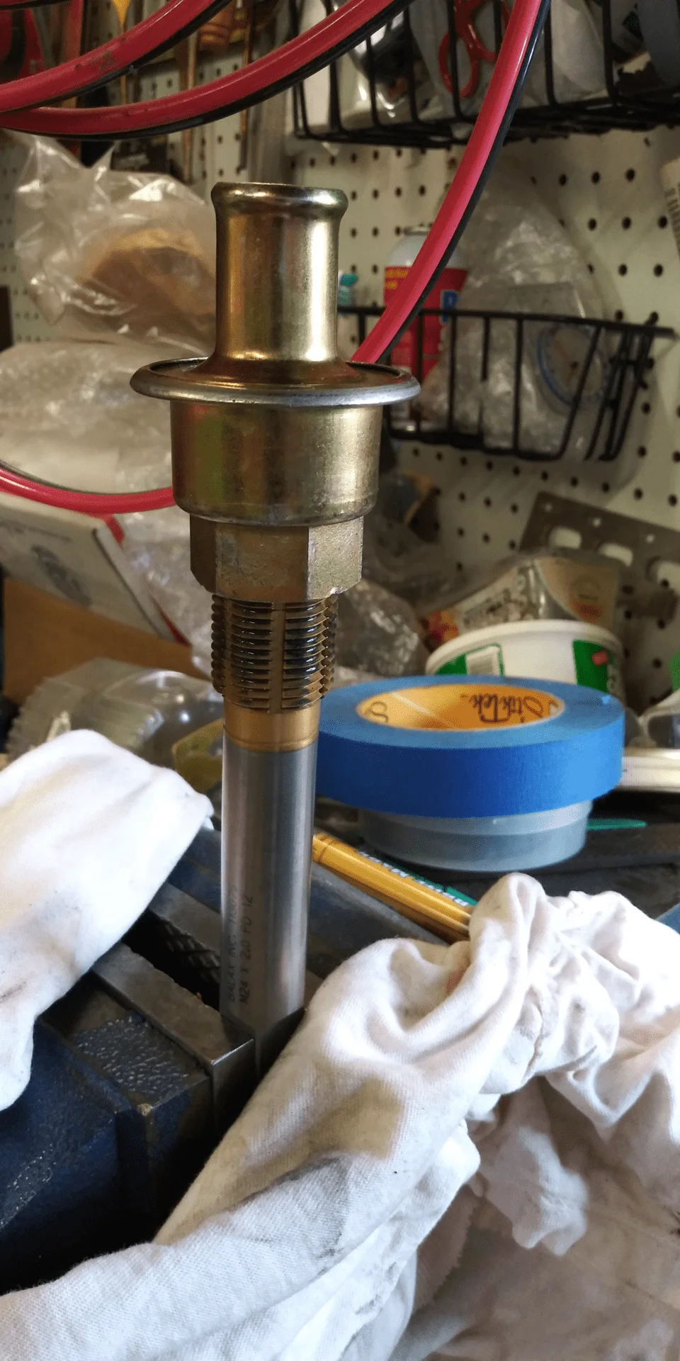

I have a couple of the AV14 which are listed as fitting early Toyotas, Corolla, etc and they're the right size, including the nib, but the wrong thread pitch.
That's what I was thinking of doing - Tapping the thread for the correct pitch. I'll call cruiser parts Monday and if that doesn't work out then maybe I'll look for a tap or just get the AV8. They seem to be readily available. That NAPA part # should be 2-29001 and it's the same as the AV8.
I also found a M24x2 Tap on ebay (that didn't have to come from China) for a reasonable price, so I can experiment with the CV14 to see if it will work without leaking...
It's a CV14A, but that's just the BWD brand part of the SMP AV14
