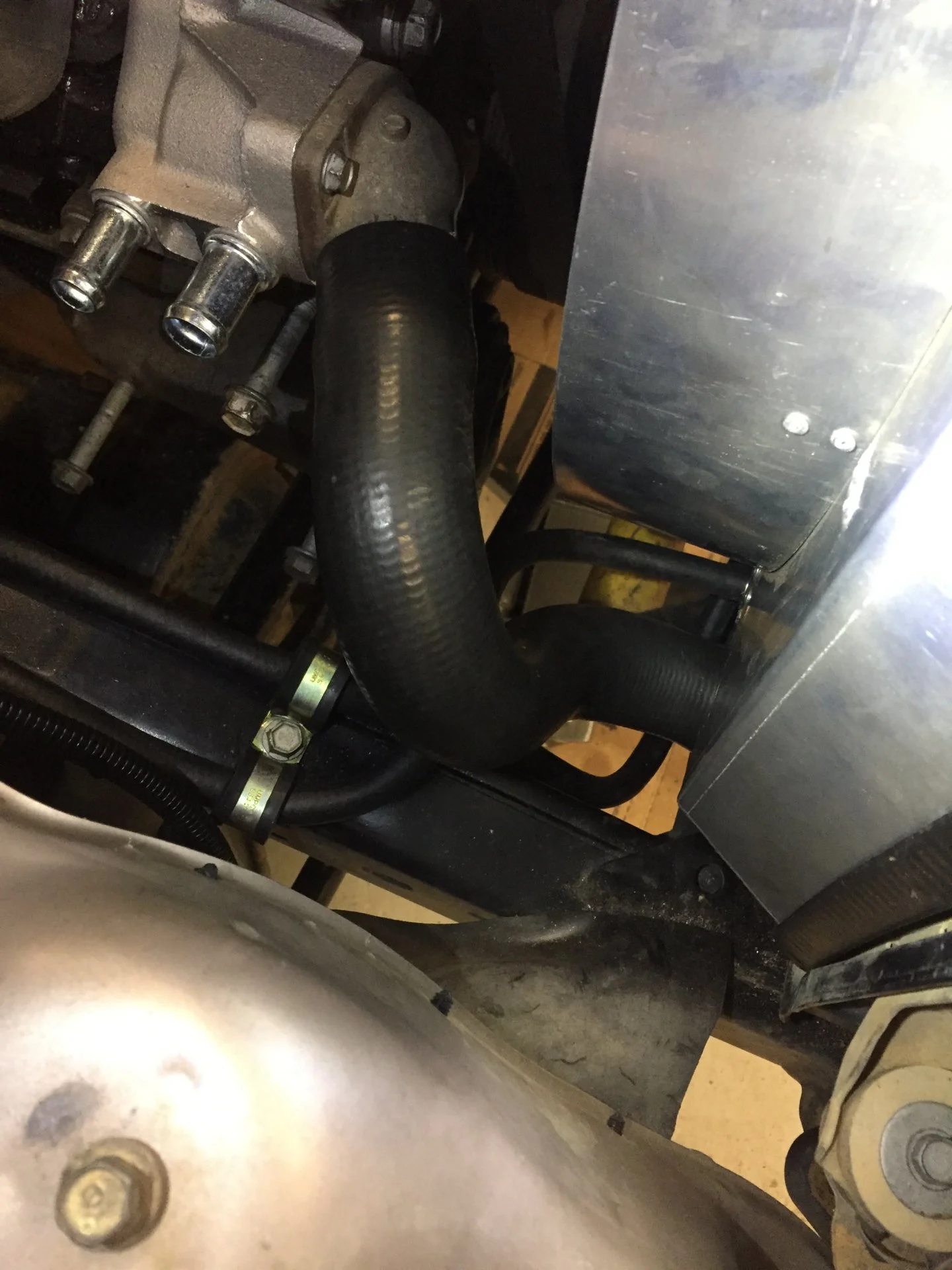

I'm almost done with mine. Having issues trying to source a lower rad hose. I reused the factory radiator.
Did you finalize cooling?

Gates 20230. It’s a upper radiator hose for a Ford Explorer.
Pic on my swapped 80:
Not sure that will work on a gen5 L83 motor unless you adapt to the older style water pump or the very new L84 style pump.
No update on the swap. We used adapters and an LS2 pump with aftermarket radiator though. That hose should work for us with the Gen3/4 style pumps.

for cooling, I ended up using a GM truck hose for a newer Tahoe. The upper was a generic, not sure what car it came out of.

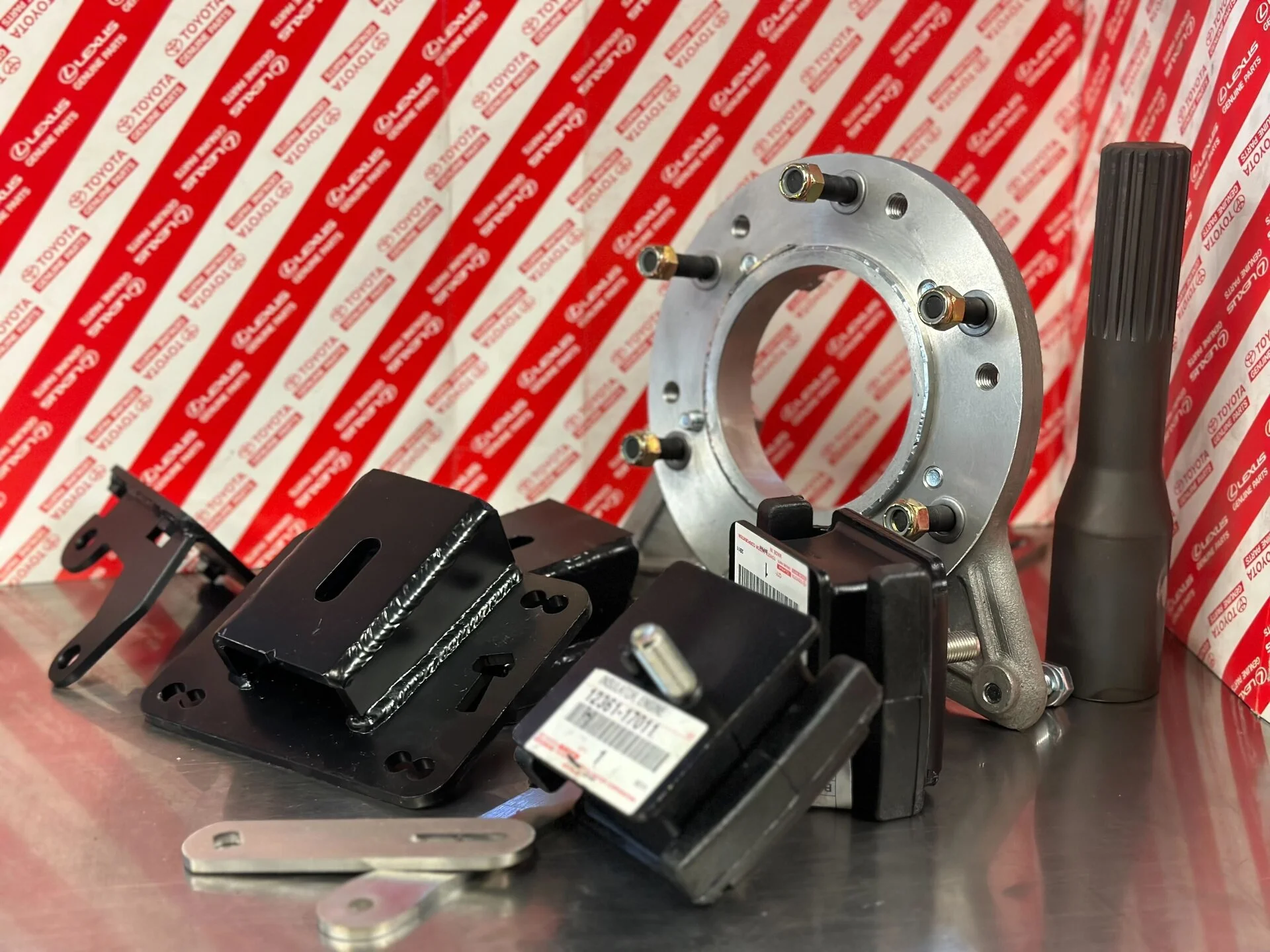

Dave from Torfab. We have an adapter launching for the GenV to 80 series Transfer case. Price will be $2630 with free shipping.
We will be offering this as a kit which will allow you to bolt in a 6.2/5.3L LT motor into an 80 series in the factory engine mount location without any modifications to the drivelines or need for welding on the Toyota frame. With our adapter kit you keep the engine/trans into the stock frame brackets and stock t-case crossmember, and also allows the stock drivelines to be used. This simplifies your engine placement and location mounting with out needing to worry about drivelines and make it a bolt in process.
The kit will include:
  • * OEM Toyota Engine Mounts
  • * Engine mount adapter brackets (mounts to the LT motor and allows Toyota 80 series engine mounts to bolt in factory frame location)
  • * Torfab Adapter for the GM Trans to HF2A transfer case
  • * Transmission shifter linkage (this will adapt the 8/10 speed transmission to your stock 80 Transmission Shift Lever (P-R-N-D-2-L)
  • * Transfer case shifter adapter bracket. (This bracket allows you to mount the early 80 transfer shift lever to the GM transmission in the stock location without modifying the body.)
The kit will require the following:
  • * Early 80 (91-94) transfer case shifter base (retainer and shaft). If you have a 95-97 you will need to source this part. PN: 36344-60021
  • * Factory adapter/extension housing from A343 transmission 1995-1997 and 6 mounting bolts (this can be used from old drivetrain or source a used one). PN: 35015-60070
  • * GM LT Motor L83/ L84/ L86/ L87
  • * Factory GM 4WD 8 or 10 speed transmission (8L90 or 10L90)
  • * HF2A Transfer case
