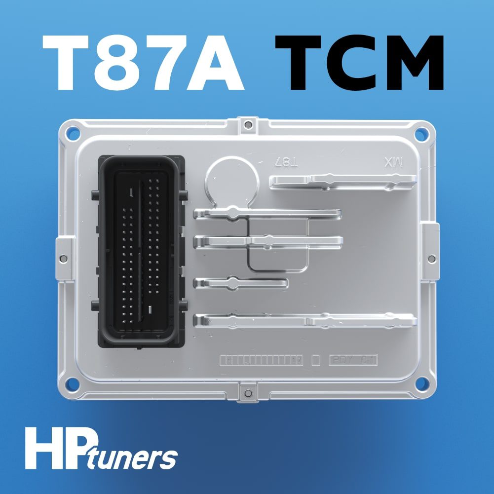

I would be VERY careful about mixing and matching an engine and 10L transmission. There are many combinations that will bolt together but very few correct: engine harness, engine computer, transmission, transmission wiring harness and transmission controller that will function without a massive headache. If I did a 10L transmission (and having driven them I really want one) then I would get the full engine and transmission, wiring harness and both computers from a Pre-2020 GM truck. T-93 controllers (2020+) are no bueno, T-87a can be unlocked, T-87 are not locked, but are 8L90 only.
If you keep the drivetrain intact you may not need to unlock your transmission or even engine controller at all. The more modules you use, especially the body control module and the gauge cluster and you can fool the computers into thinking they are still in the "host" vehicle. That's not really an option for me in my FJ45 because I have no need for the BCM or the fancy gauges, so I would have to at least unlock the engine controller to remove the vehicle anti-theft programming (VATS).
