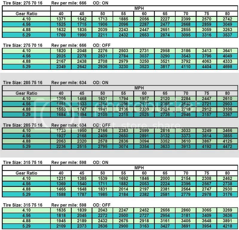

Searched quite a few threads but the info is a bit jumbled; or perhaps it's my brain.
`97 LX, BFG a/t 315/75/16
Highway speed/rpm?
4:56 & 4:88
Input requested,
Thanx, KR
1996 FZJ80 on ProComp 315/75/16 geared with 4.88
My lead foot keeps me around 70mph... translates to about 2600rpm...
When not paying attention I climb to 75mph.... which pushes to nearly 3,000rpm
Those numbers come from my Scan Gauge II.... already adjusted for tire size and gear ratio.

Exactly the kind of info I was looking for. I had my eyes set on 4.88's but after a little research I've been thinking 4.56's, as the rig sees quite alot of highway.

This sounds high for 4.88's to be @ 3,000 RPM @ 75 mph.
I ran 5.29's with 35's and was right around 3,000 RPM @ 75 mph, with GPS set yellow box speedo correction.
I would expect 4.88's to cruise 70 mph at about 2,400 or so.
Don't get 4.56's for 35's, that's a waste of regearing, unless you plan to drive consistently 80-90 mph.
If you cruise 70-75, IMO 4.88's are a no brainer unless you wanted lower gearing (5.29) not higher. 4.88's leave you about 6% lower than stock on 35's - an ideal combo for most people.

I'm moving to 315/75R16 on 4.88 inside of a month. Which would be closer for the speedo, leaving in the Slee speedo gear or going back to a factory speedo gear?
If I'm reading that chart right - I should leave the Slee speedo gear -in- and not go back to a factory speedo gear?
I am going to regear soon. Listen to Nay and Landtank. I have reserched this for quite some time. The 4.56 are a waist of time and money. Go 4.88 they will help compinsate for the added unslung weight of the tires as well.
Yes, it sounds like I will loose all credibility if I go 4.56:crybaby:
After looking at the chart, if I'm happy with 70mph, the engine wont be revving too bad.
OK, it's 4.88's. Anybody got $1200 bux I can borrow?

So what is the stock set at for gearing? I'm assuming that it is the 5.29, since that's the only one that I can't find gear changes for...
I'm going to assume that the stock tire size is the 275 70 16- I would check on mine, but i can't physically access it right now...
So can someone explain what this chart means to someone stoopid :flipoff2: like me? How do RPM's reflect Gas mileage- I know lower RPM means lower gas milage... Your Help is Much appreciated-

I understand now that it's 275/70/16 and a 4.10- :bang::bang: Now that i feel stupid...
Yes seriously- I was using the numbers i knew- I've done absolutely no tinkinering, and I can't get at any of my paperwork- That probably was common sense, and I felt stupid asking, but that's the truth....
So from this chart, i gather that the Lower the RPM, the better the gas mileage at high speeds? What does that do to lower speeds? For instance, what would happen to my city gas mileage if i changed my tires to 285/75/16's with the 5.29? Freeway? I just don't know how these work... Thanks for putting up with my stupid questions... but these are answers that i don't just know....
