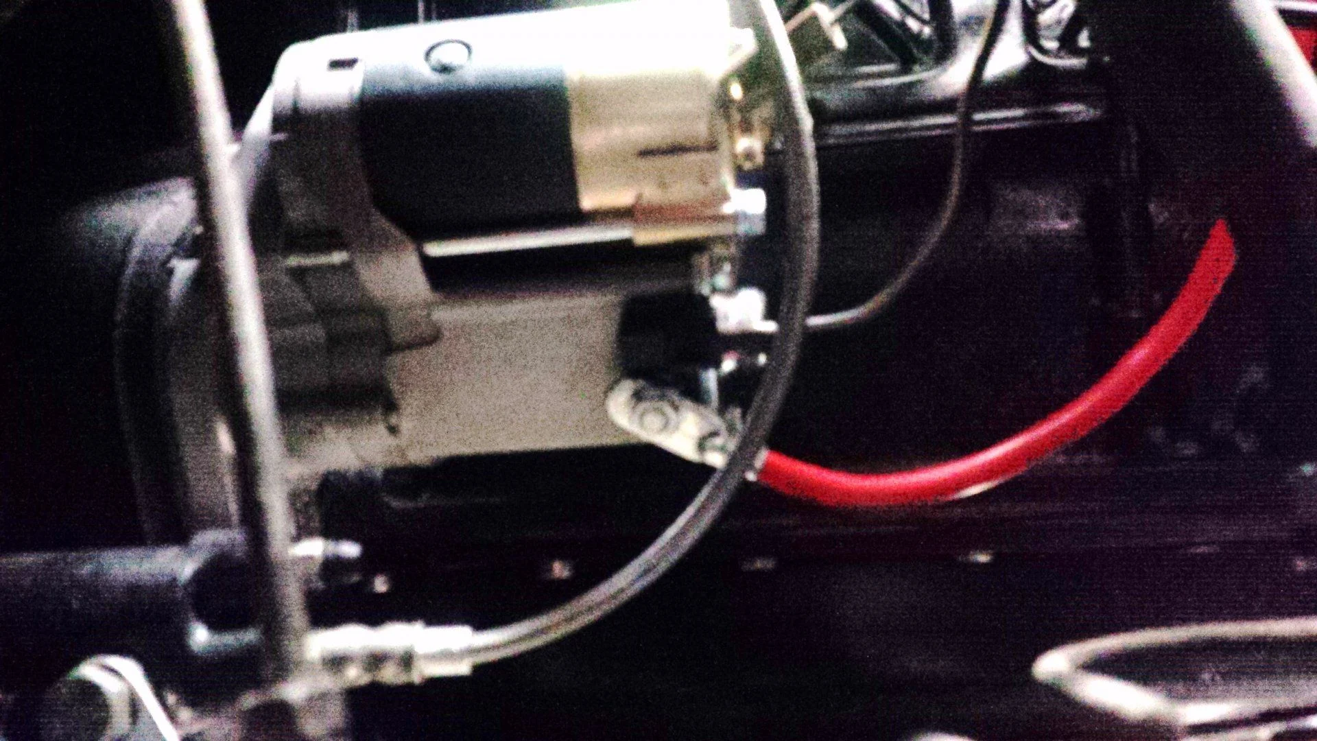

My only question is why does the 40 have two different size bolts (upper 18mm, lower 19mm) for the starter? Is this an isolated characteristic to mine only or is typical for all?

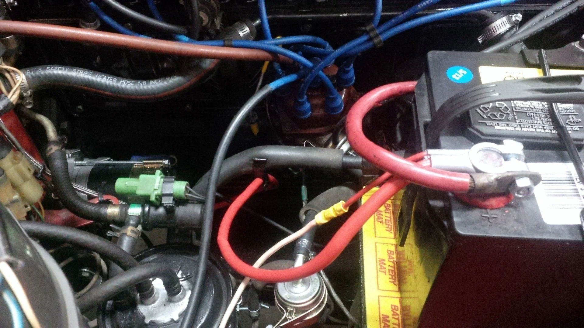

Next I'll be installing new cables and making the final electrical connections

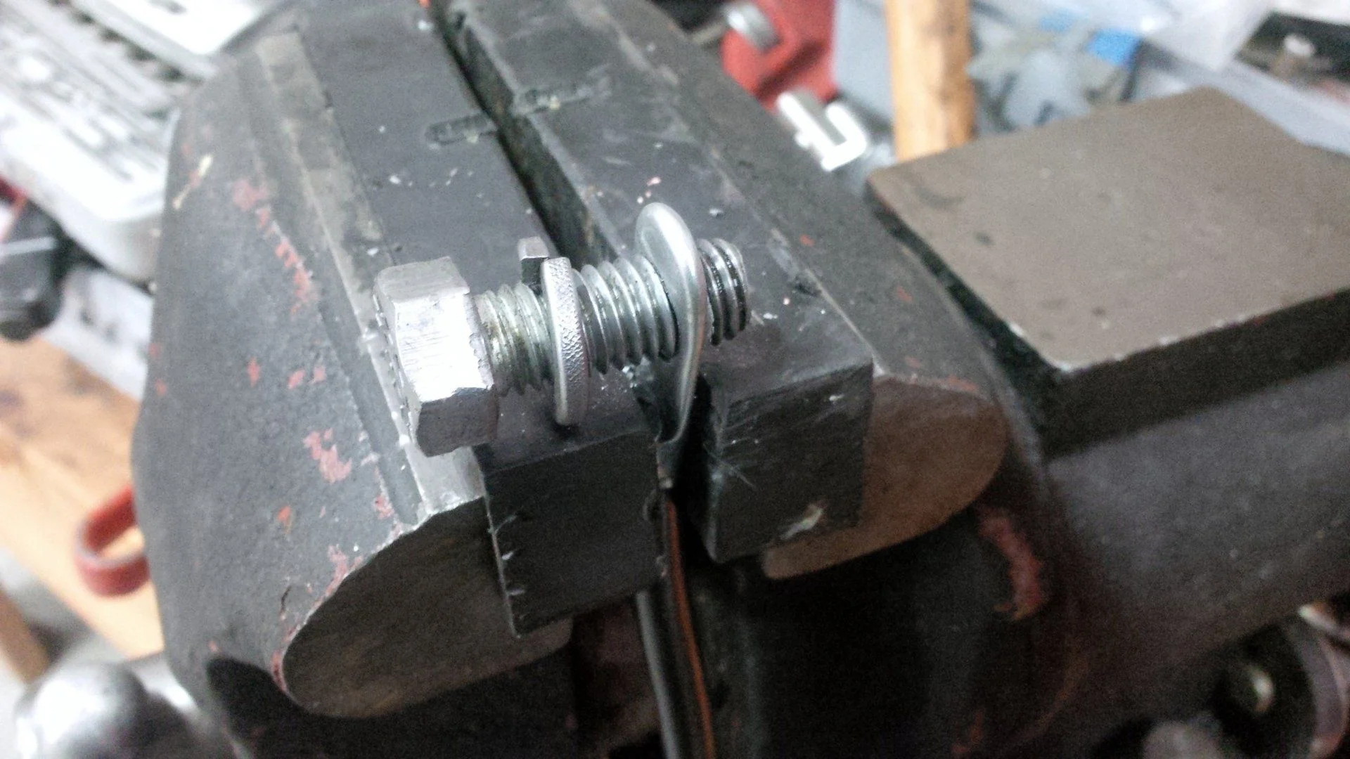

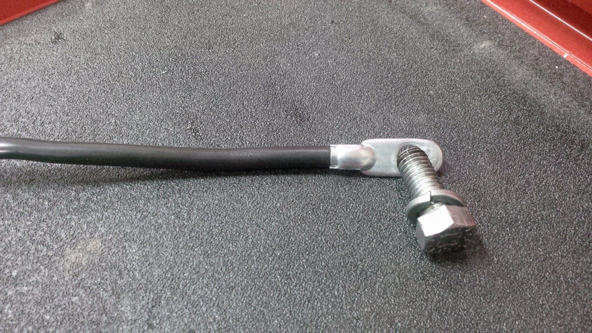

Yet another issue with the lower 19mm bolt for the GRS, the bolt would not fit through the ground loop hole, needless to say it had to be drilled as well.

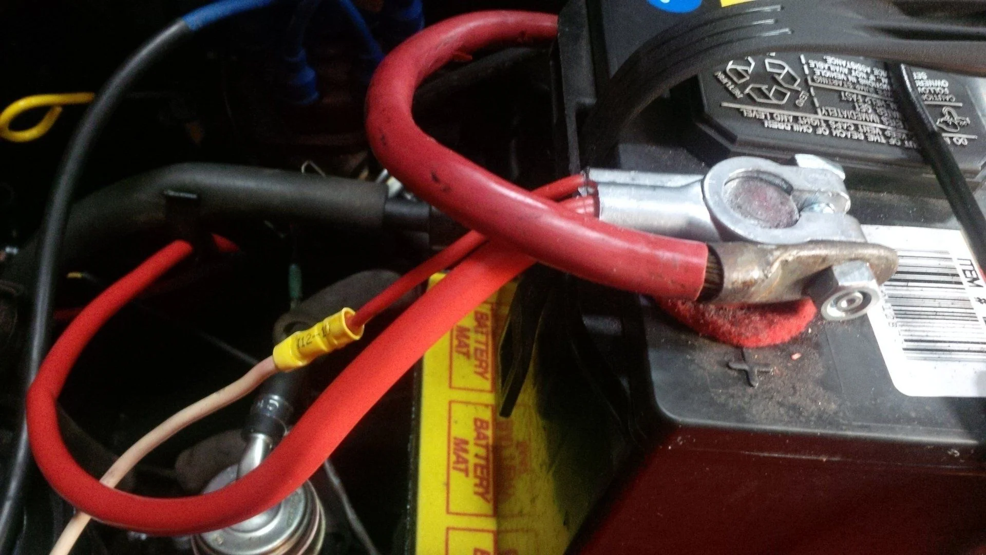

Made all the final connections

You kind of have the terminology wrong. It isn't an 18 or 19mm bolt. Bolts are not measured by head size.
In stock form it's a 12mm bolt with I believe a 17mm head. Yours must have been previously stripped, tapped and a larger bolt installed. Does the original started have signs that the hole in the ear was tampered with in the past?

78 if you don't mind me asking what is the grounding strap on your starter connected to. I just pulled my old one and the grounding strap was a frayed mess of copper wire that wasn't connected to anything at all but the starter. In other words I don't believe it was grounded before hand. Thanks.
The starter body is grounded to the passenger side frame rail, forward of the two brake line elbows. The bolt is the back most bolt on the splash guard under the battery.

As Danny mentioned above the neg strap connects to the frame rail. Make sure you clean the rail down to bare metal prior to installing and bolting down the neg cable.
