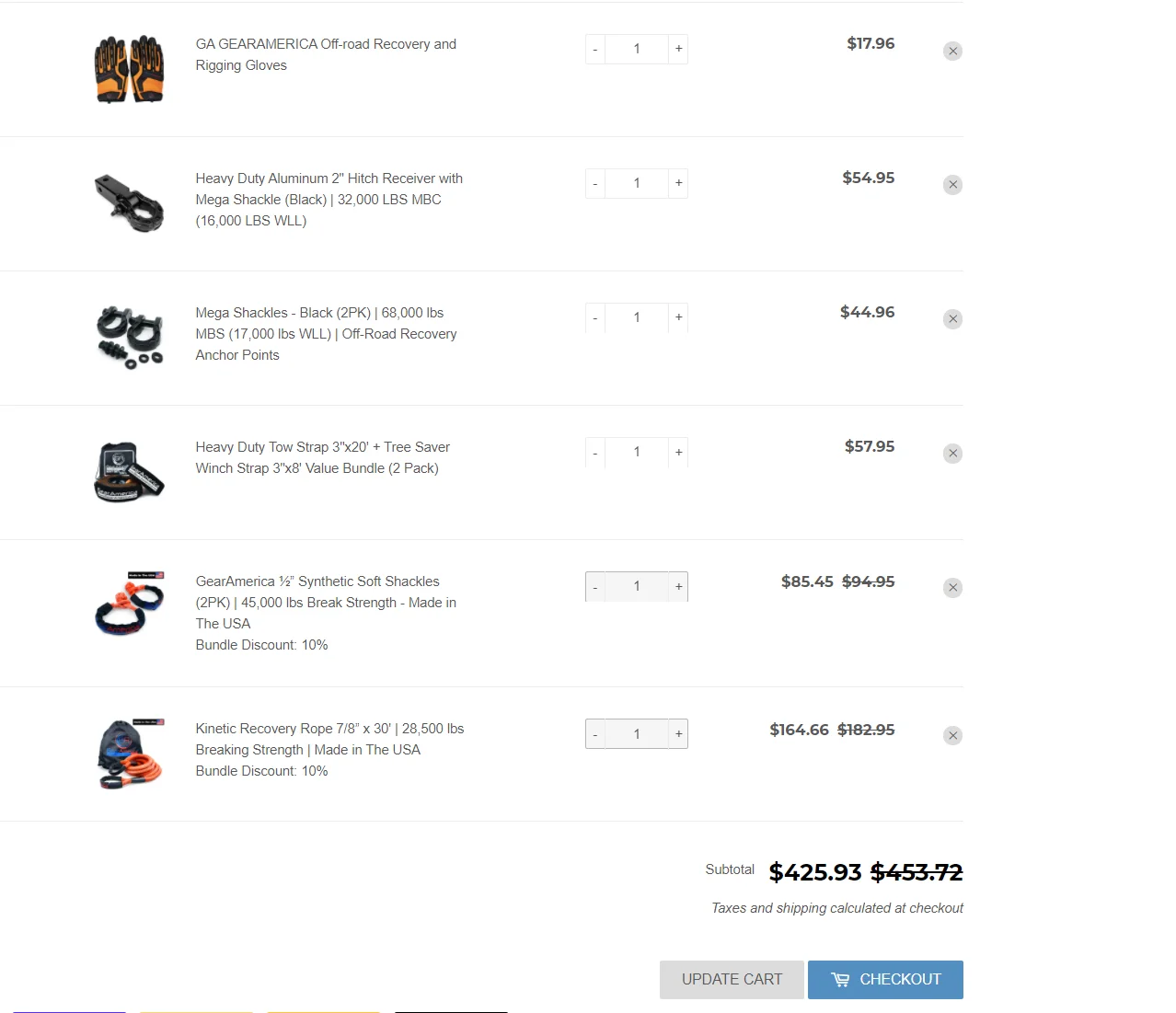

Any updates on this vendor? Looking to build out my basic recovery kit with their gear. Anything I'm missing or overdoing?

The only thing I don’t see here is a snatch block or two. I have the small one and the mega. The small one is made with UTV’s in mind due to smaller storage capacity on that type of vehicle but it’s strong enough for an 80. The soft shackles are required to use with it because the hole in the snatch block is too small for a conventional shackle/“D” ring. I ordered the small one unintentionally and decided to keep it due to the cost of restocking and shipping it back. In hindsight, I wouldn’t order the small one again.

I don't have a winch. Do I still need a snatch block?
If you believe you need a recovery kit…probably also need a winch. One is not much good w/o the other.
Sometimes $$ can be an issue when putting stuff together. But I would start with the winch 1st.
@Littlehouse you definitely don't need the 2" receiver thingy or the tow strap or two pairs of shackles. Buy the snatch rope and one pair of shackles. Then worry about getting a winch as mentioned above if you are going to be in situations where you need a winch.

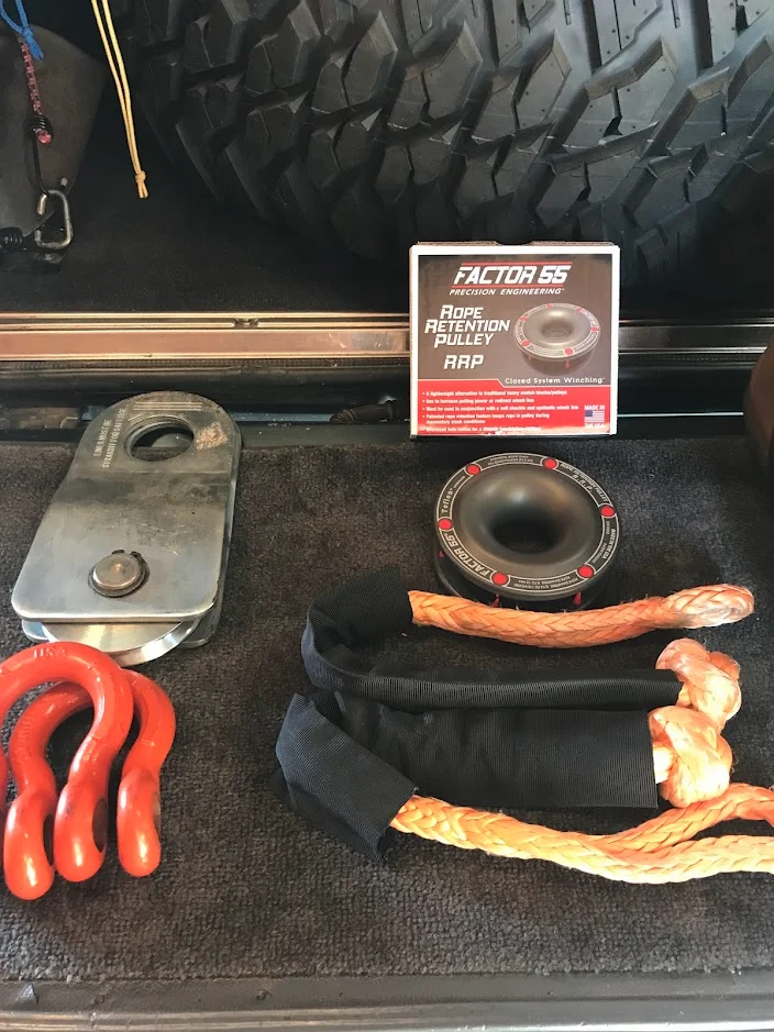

I just went from a conventional snatch block to the new Factor 55 rope pulley.
It does the same job as long as you have a synthetic line.
With a fraction of the weight and space
Old set up on the right, new on the left.
