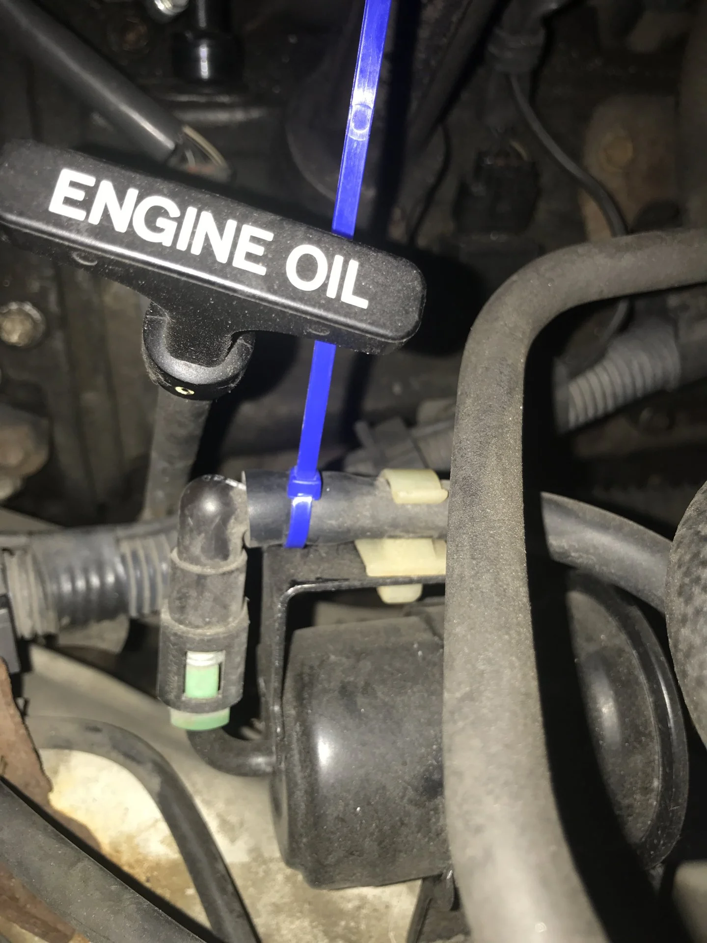

Maybe anecdotal, I recently developed a fuel smell even after short drives. Did a lot of research and went to poke around under the hood of my 98. Vacume lines to vapor canister all seemed to be snug. Moving on to the fuel filter I look d at the hose connected to 90 degree green elbow clamp that routes to engine. Hose on the elbow clamp was very loose and swelled larger than elbow diameter. Snugged it tight with zip tie and so far fuel smell has stopped. Will replace that hose soon, but thought I’d share as possible culprit for those trouble shooting in the future.
