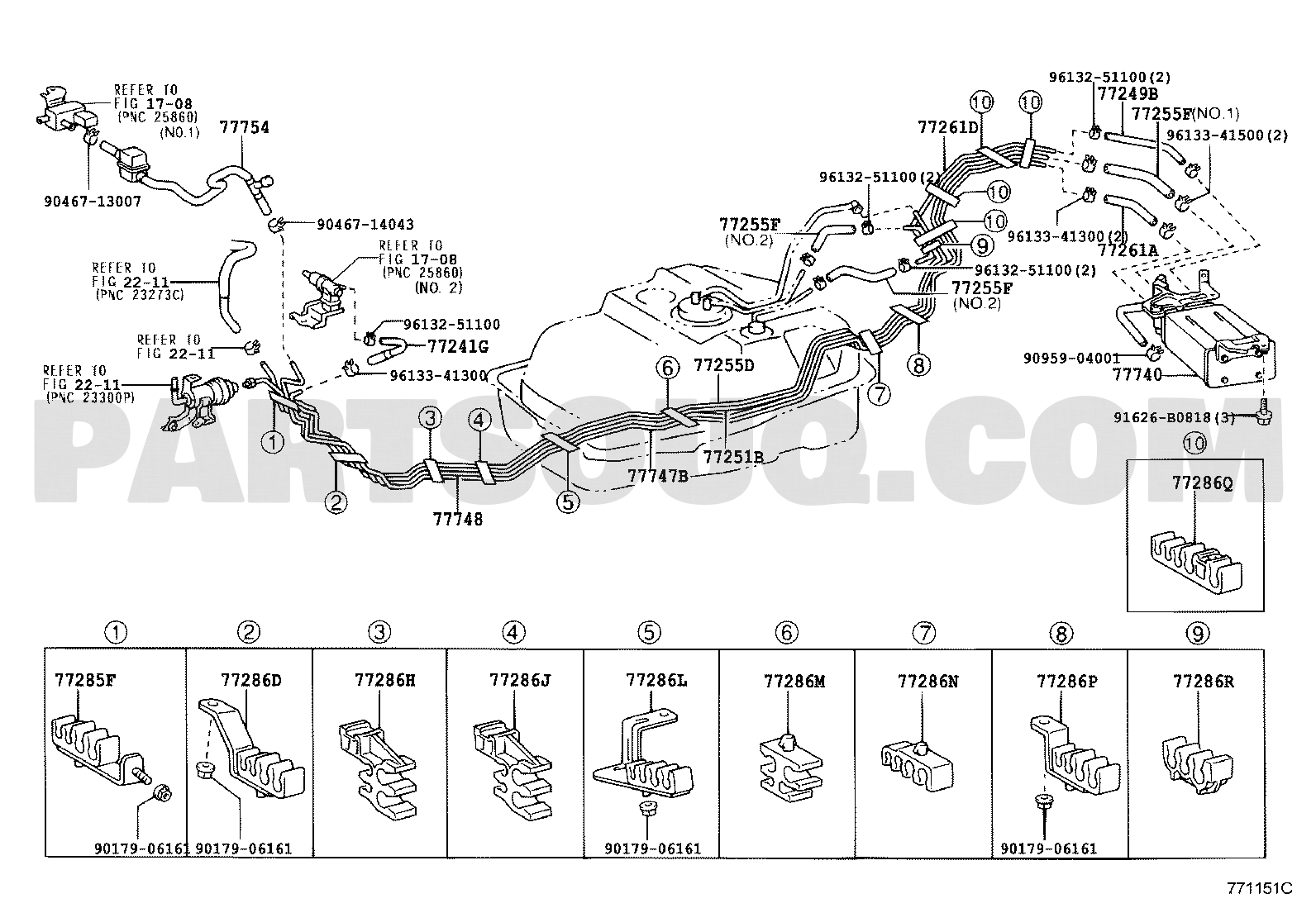

The valve inside the cap will flutter and vent off excess tank pressure the evap can’t keep up with. Mine does it occasionally.
With your 04, topping off the tank past the first click will eventually saturate your charcoal canister with fuel and kill it- as it resides just below the filler, it’s easy for the overflow to flow right into it. This contributes to evap issues & tank over pressurization.
Early model years with canister in the engine compartment don’t experience the same overfilling problem

I have a question about the charcoal canister - I purchased part number 77740-60440. It said it would fit my 06, but it doesn't really look the same. Can I use it anyway? Is there a specific part number for the later years? I apologize if this is spelled out somewhere else. I haven't been able to find the answer.
