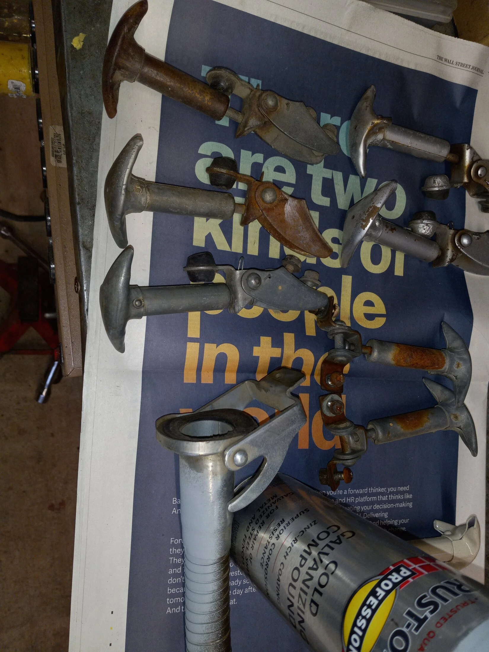

I have some OEM galvanized hood hooks (stored in a barn forever, so fairly clean) that I would like to spruce up and use 'as is' (rather than painting them silver or pewter).
I test-sprayed the (shown) fuel hose with cold galv., which is a lousy color match. Should I just clear over the rust and leave it, and not try to make them look new-ish, but not 'shiny new'? How can I match the OEM galv. look?
Any ideas? Thanks!

Consider wire wheeling them back to bare steel then getting them zinc or nickel plated. Usually cheaper than you’d think and it’ll look like OEM. I’m partial to nickel bc it’s more durable (or so I’ve been told) but it can end up shinier and it isn’t what Mr. Toyota used. Also zinc will patina faster to get you that “new-ish” look you’re after.

This is a good question and I definitely answered too confidently above. I’ve seen a mix of body colored, galv, and all flavors of rattle can silver. I’m sure someone who was actually born in the decades these were new will have more insight than I. That said, the OEM ones I’ve seen for sale on eBay and cruiser parts sites trend galv.
Do the home evaporust solution, then phosphate them as the rust preventive under coat. Powder coat to youn color of choice. Every year or so bake on a new layer. I though at one time there were stainless steel after market ones at a fair price for never having to fool with them again, ever.

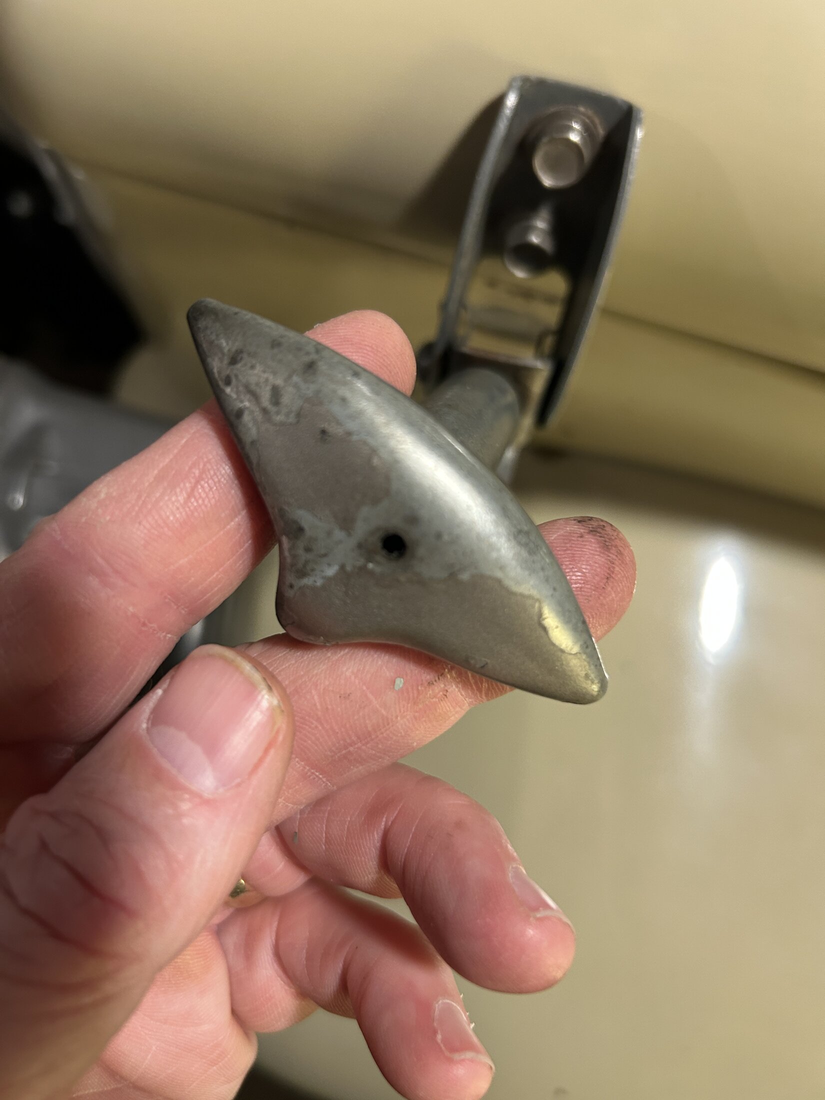

The hood latches and windshield hold downs on my '72 I've owned since Oct '78 are painted the same color as the body. Were they OEM silver, pewter, or had some other plating at some time over the years?
My 79 were pewter over gavalnized steel. The hood latches still show some of the original paint. The windshield hold downs are more worn and oxidized from the sun but they have a little left as well.
