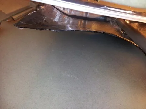

I am trying out Ted's suggestion from the Home Depot Lowes roofing material. I had to replace the electric lock on my wife's car and was inside the door already, so I decided to try the material out. It is much thinner but it does work here's a picture of it. It goes on fairly easily and seems to adhere well. I am hoping for better sound as I like crisp sound and bass like the band is in the back seat....
You start by peeling back about an inch of material and lining it up against the first one you put in and then stick it on. My typical measurements were about 11"-13" in length x 6". I used a small block of plywood to make sure it had good adherence to the metal. It took about 1 hr to do the door. It does have less "tinniness", but it is not as thick, about 1/4 as thick as the kno-knoise stuff I used.
As some additional comments, my wife's car is pretty quiet, so I really do not need as much as I needed for my truck.
However, I broke this down to cost per square foot.
the stuff at HD/Lowes is $1.44/Square foot at 1/4 the thickness, so if you multiply by 4, your at about $6.00/Square foot, plus 4x the installation headache.
One thought, to keep the costs down is to only double it up and stick two sheets together before installing it inside the door.
The stuff Steve and I installed is $4.00/square foot.
So beware of the perceived cost differences and decide based on your noise needs....
GXes have factory sound deadening so the new stereo pumps in mine. This is a really good idea though!
