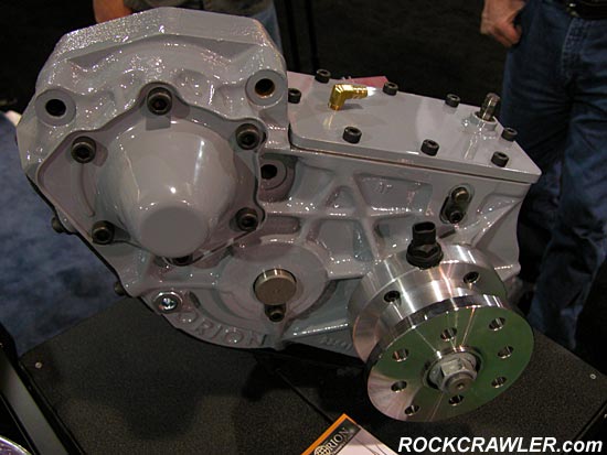

That plate retains the rear bearing in the tranfer case. The input shaft and bearings are from the FZJ80 transfer case, so it requires a custom rear plate to hold the 80 bearing in place.
Here is a picture if an Orion HD with the normal bearing cap...
