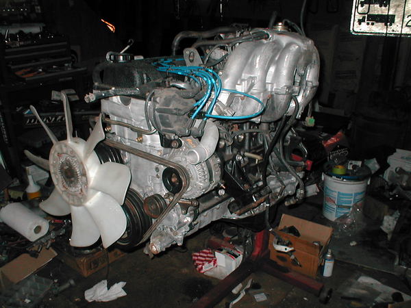

Sorry for delays, folks. Moving along again, we have an engine that is roughly 95% complete. Any day the engine hoist will get wheeled up to it, then bolt up the tranny etc etc.
Nice to see this project moving again, it's one of my favorites :)

A teaser pic for you...
