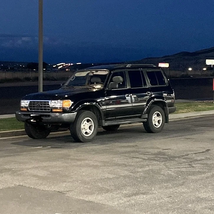

Hi there, I brought this beast out from Maryland, luckily not much rust, as it was originally from the SW anyway. Since buying, I've replaced the tires and battery, done what I could with the undercarriage rust, probably needs a new starter. It has aftermarket seats and a new stereo. Spare tire winch has already rusted itself off, so I've got to see about getting a new one. Definitely want to know if I need to stick with the 80 series chain winch, or if I can a newer version that will fit the existing screws (?). Great car, 230k miles, figuring out what I can afford to put on it. It's amazing how few drinkholders Toyota thought they could get away with in the '90s...

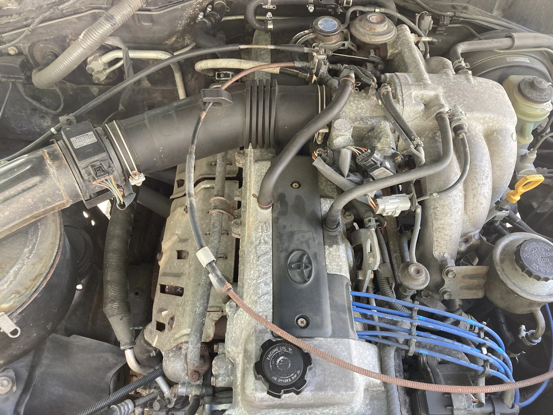

Based on where it lived (Rust Belt) and the photo of the engine bay I would assume that the spare tire carrier mechanism and bracket is also rusty (er), so it might help to remove the spare and inspect the whole assembly for rust. If bad you can remove the entire bracket/cross-member then remove the rust, treat the remaining rust in pits with a rust-killer product, prime, paint, etc,etc. Definitely soak the bolts first from both ends (head and threaded end) in penetrating oil a few times over a few days.

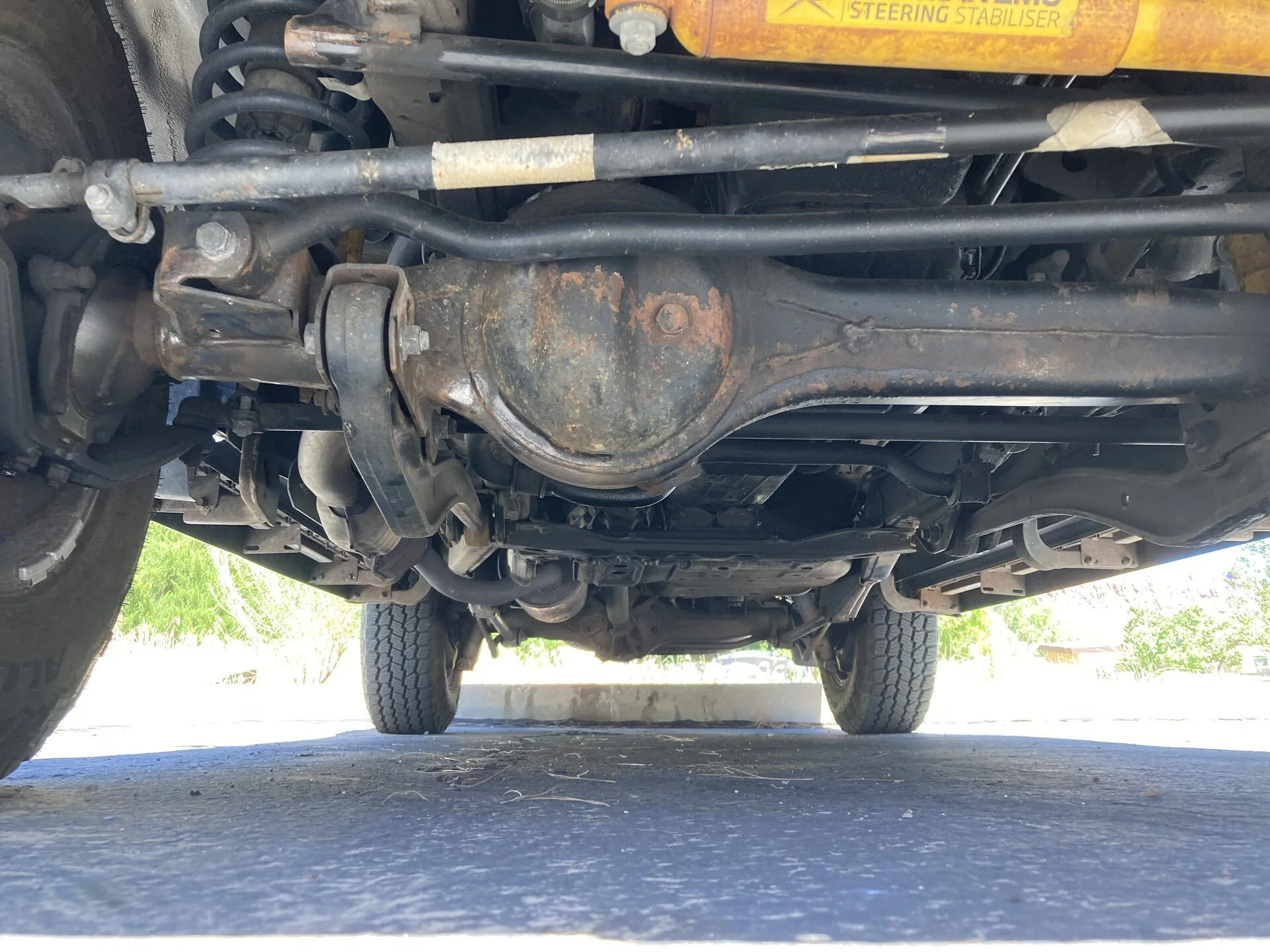

Yeah getting that cross-member piece off was my original goal, but- with the rust at the contact with the rear frame- settling for bolt cleaning for now. This car will make you want a garage lift quick.
