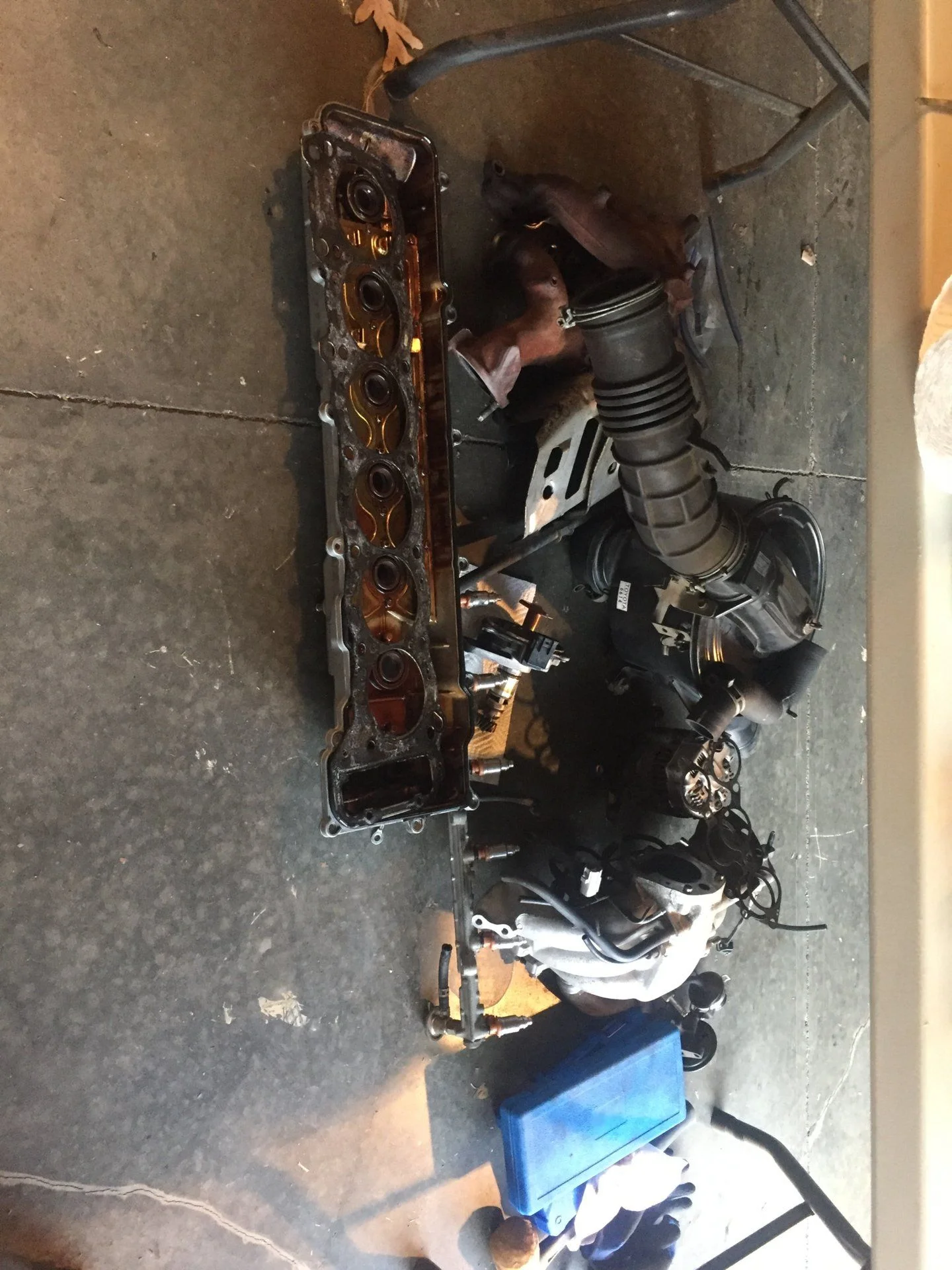

I just found out i’m Going to have the put all this back together at some point.

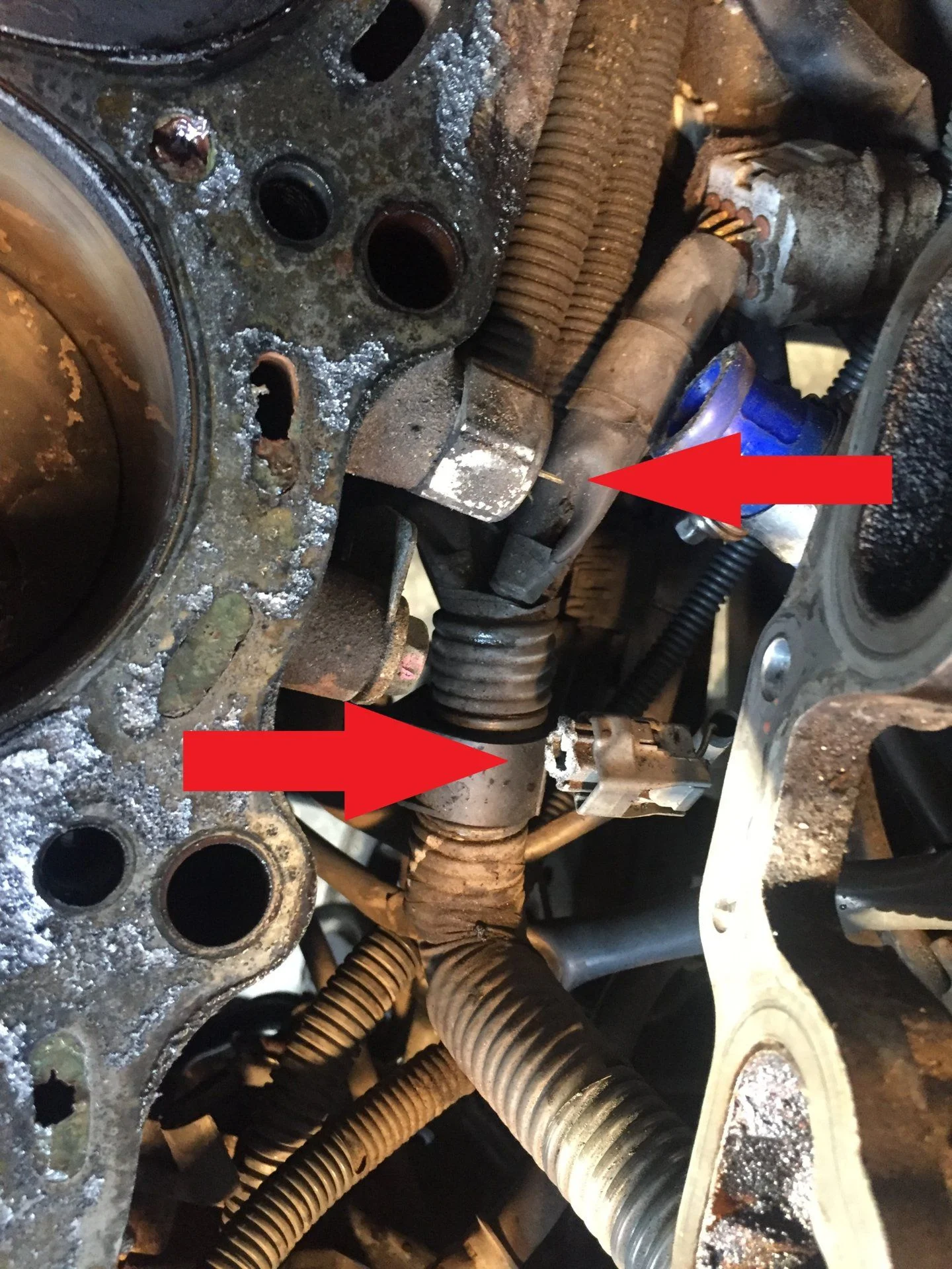

@beno I'm happy to report that there appear to be no bent rods. All measurements of piston height at TDC appear to be identical. Any additional input you have after reviewing the pics would be much appreciated. Also, it looks like I may have broke the knock sensor between cylinder 5/6 during the disassembly. Is this easy to get a hold of? Thanks!
:lol: That's always a humbling moment. It's real easy to take it apart :lol:

I'm glad you brought that up, I was wondering about that. I checked it first with the head still on by confirming that a mark on my ratchet extension reached the same peak-height in each cylinder as the engine was rotated. I checked it again at the very end with the head off, by rotating the crankshaft and comparing the peak piston height to the cylinder lip. As a precaution I did count the rotations and rotate it backwards when finished so that the #1 & #6 pistons were at their peak again and I confirmed this by making sure that the timing mark on the crankshaft had returned to the "0" position.

I don't know how to verify that the timing chain is still in place on the crank without taking out the timing cover. Did you hold upward tension on the chain while rotating the engine with the head off?
Yup, we sure did. As I turned it, a friend was pulling up on it and allowing it to rotate / slip through his hands as the crank was turned. I also marked the top of the timing chain and I verified that it appeared to be back to the same spot after we turned it the opposite direction and realigned the timing mark with the "0".

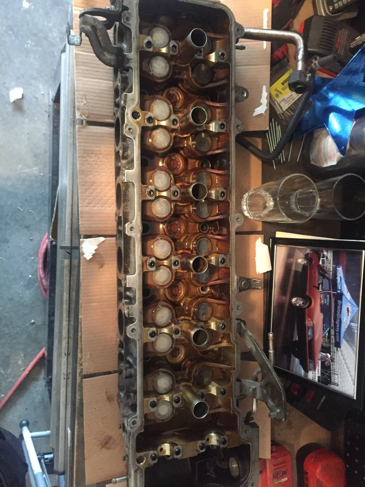

Haven't used that machine shop before, but consider having them do the following:
- heated pressure test
- valve seals
- valve seat inspection/regrind
- valve guide inspection/re-sleeve
- valve regrind/replace
- head resurface
Now's the time to pony up and do all of the valve work if you want it to be running like a champ for a long time to come.
