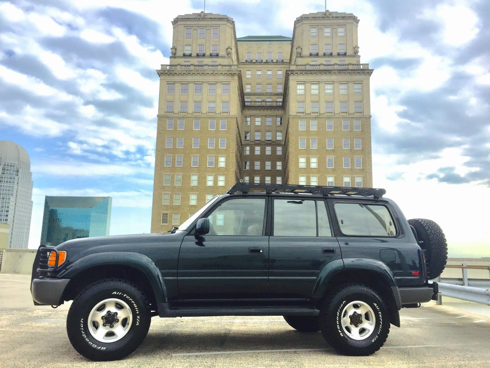

Well the old girl is getting her OME 2.5 lift today with heavies all around and new casters.
I explained to the wife how the current suspension "was pretty much shot" and "really needed to be replaced" and since that "had to be done anyway", I might as well put a small lift on it.
Los resultados!
Height improvement:
FR (driver side) = before 36 1/8" --- after 38"
FL (passenger side) = before 36 1/2" --- after 38 1/2"
RR (driver side) = before 35 1/8" --- after 38 3/4"
RL (passenger side) = before 35 7/8" --- after 39"
Time for some glamour shots:

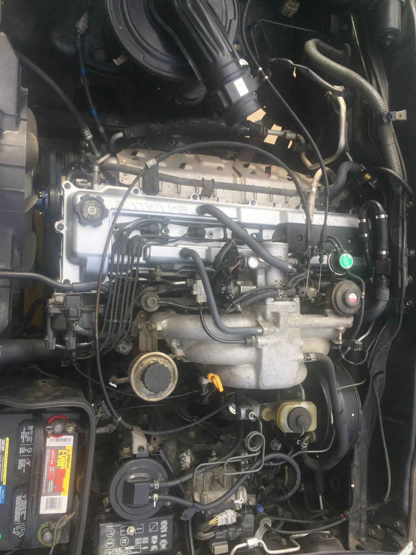

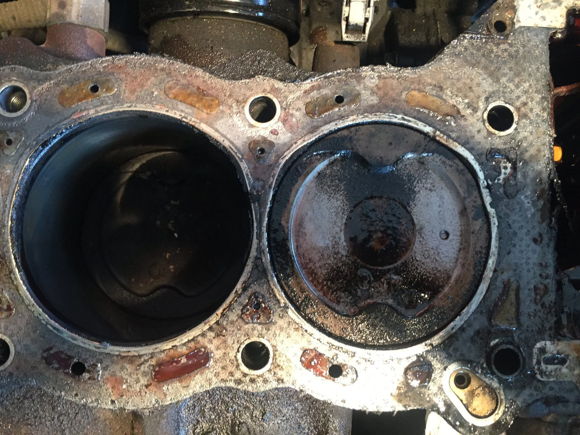

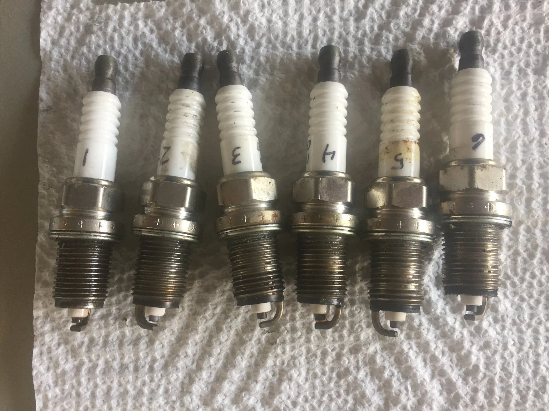

And so it begins

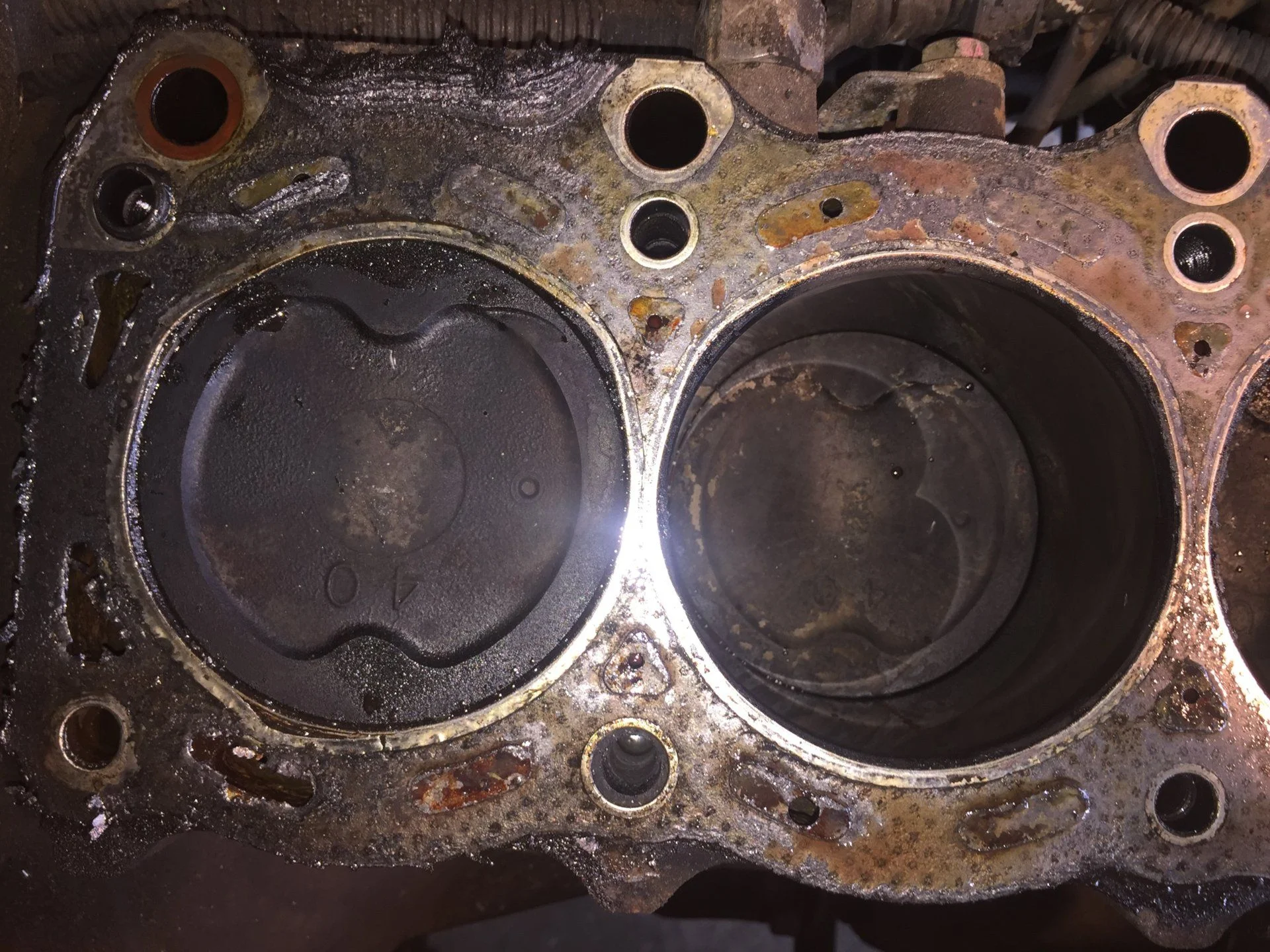

#1 & #4 are wet with coolant

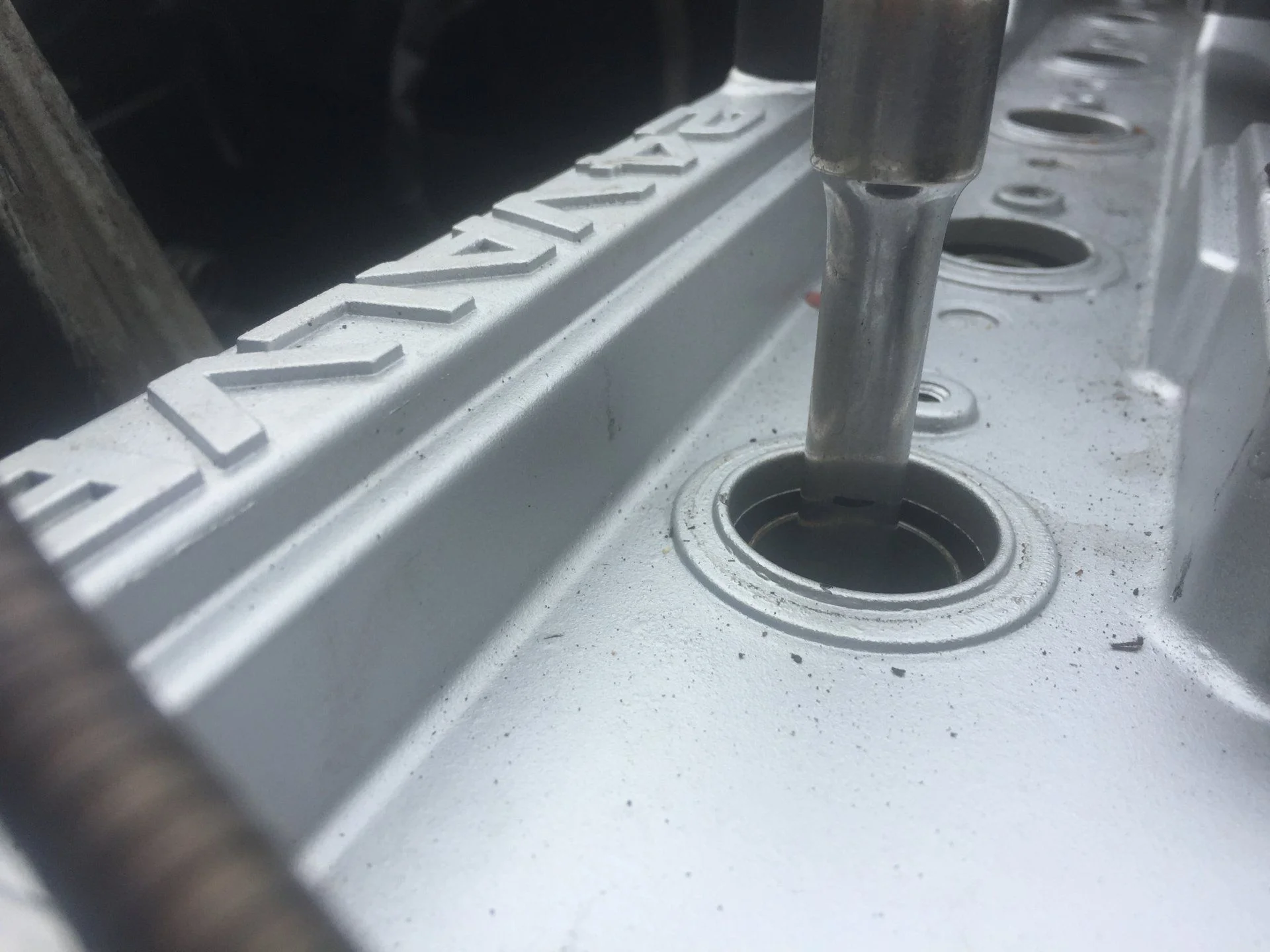

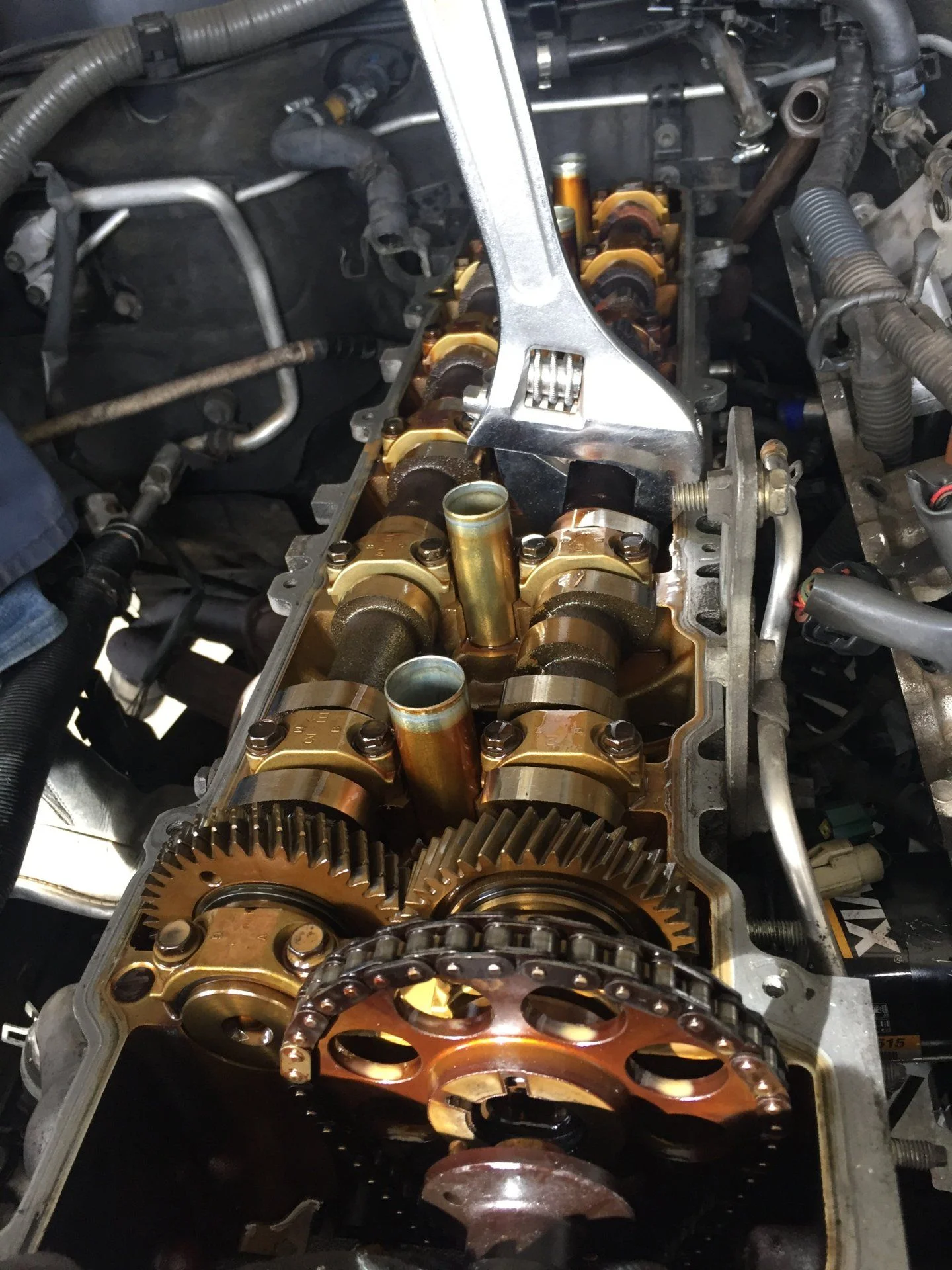

Preliminary TDC measurements look good
Hat’s off to my friend James helping me out.

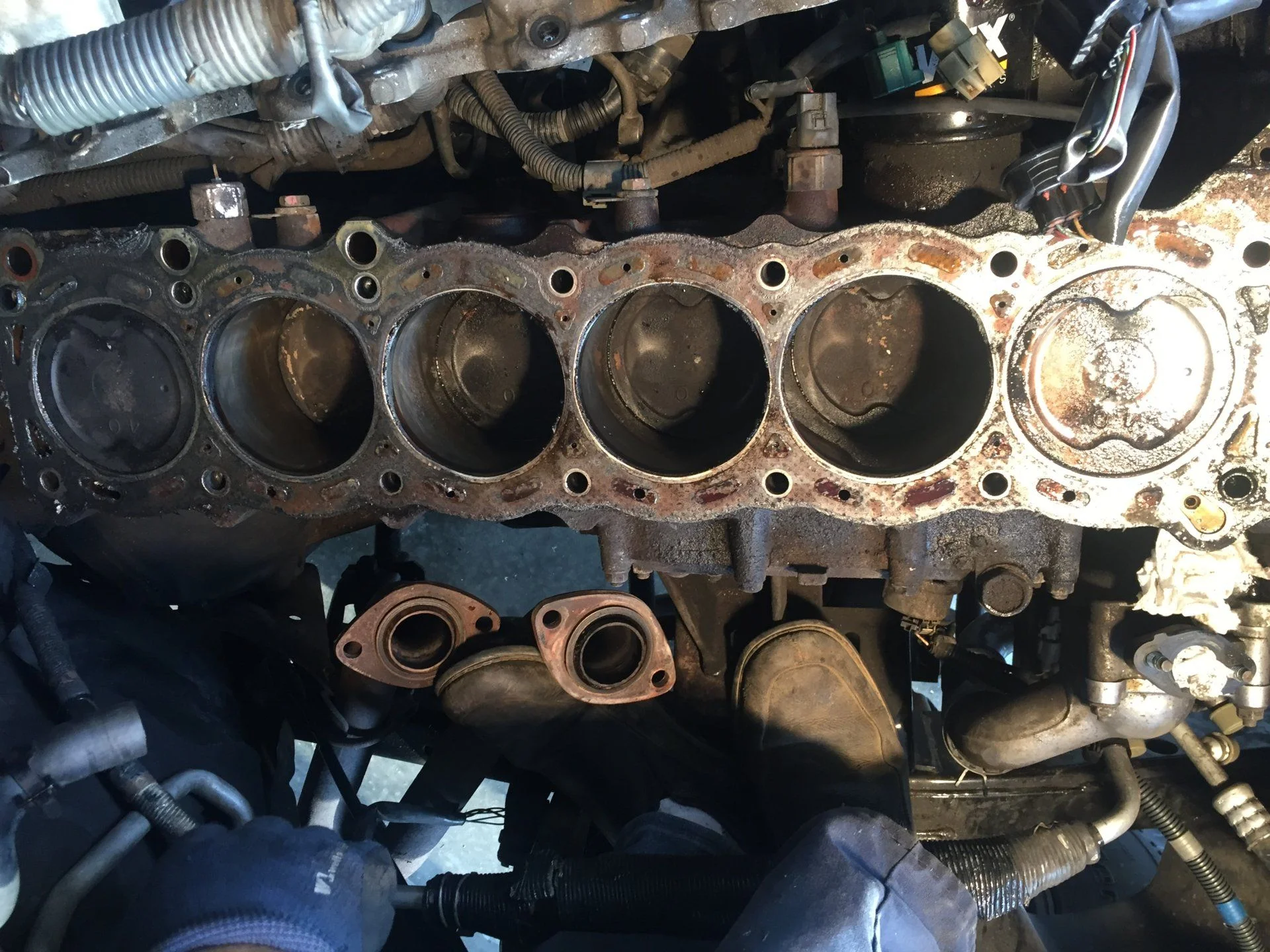

Cylinder 1 & 2

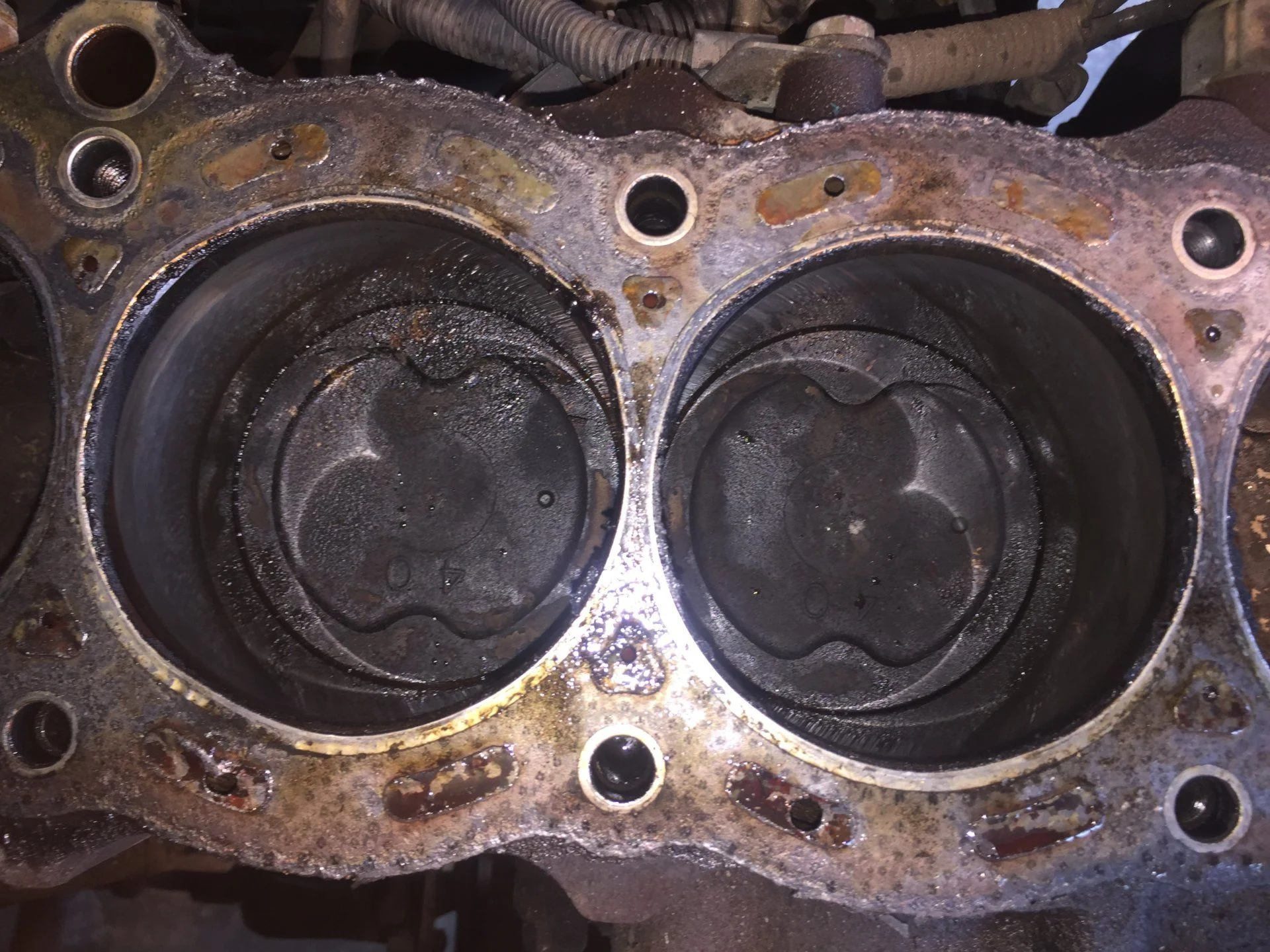

Cylinder 3 & 4
Cylinder 5 & 6
