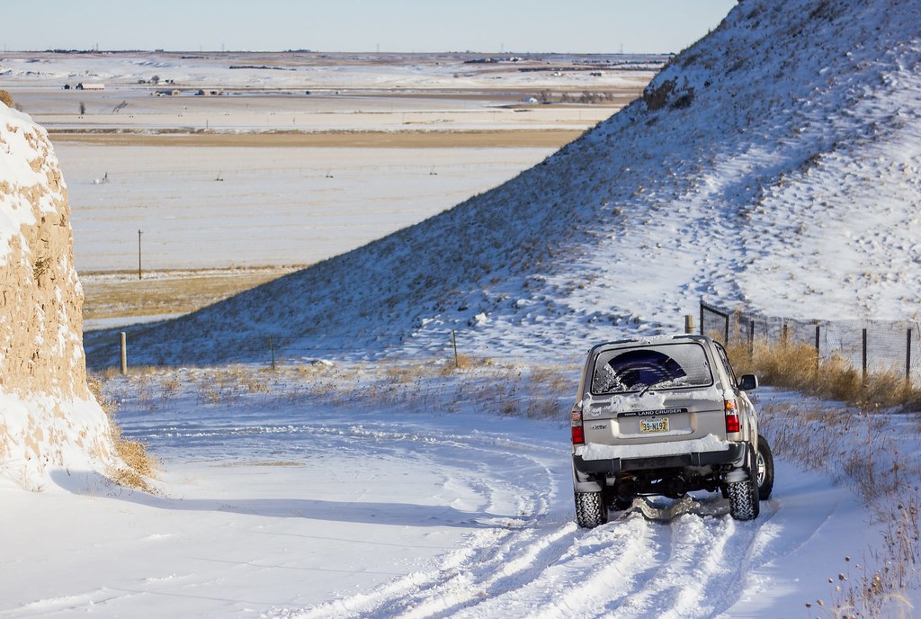

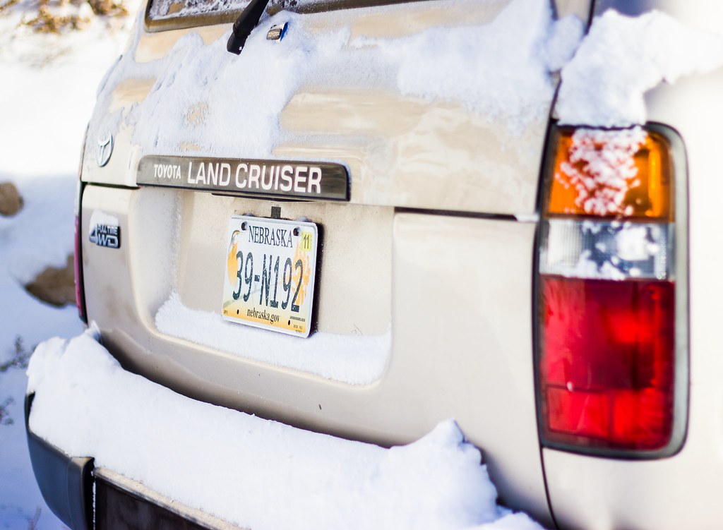

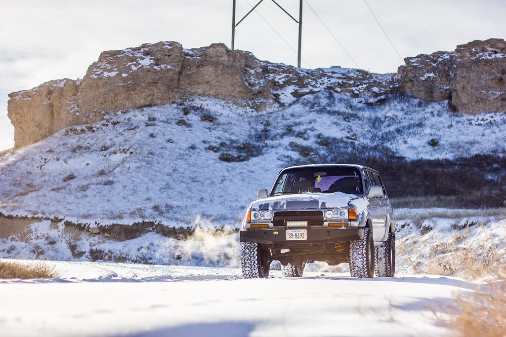

Also, we got a couple inches of snow last night so I went out to take some snow photos with a real camera and screw around on some dirt roads and exercise low range and the CDL... I'll get the real photos posted after they're processed... It was friggin' cold!
