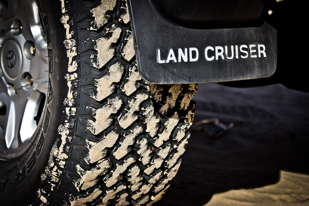

I meant diameter, but measure side-to-side rather than pavement-to-top so truck weight doesn't factor in... if that makes sense. Please and thank you!
Measurements for 295/75-16 General Grabber AT2s mounted on 16x7 wheels:
Diameter: 33-3/8"
Tread Width: 9-1/2"
Overall Width: 11-3/4"

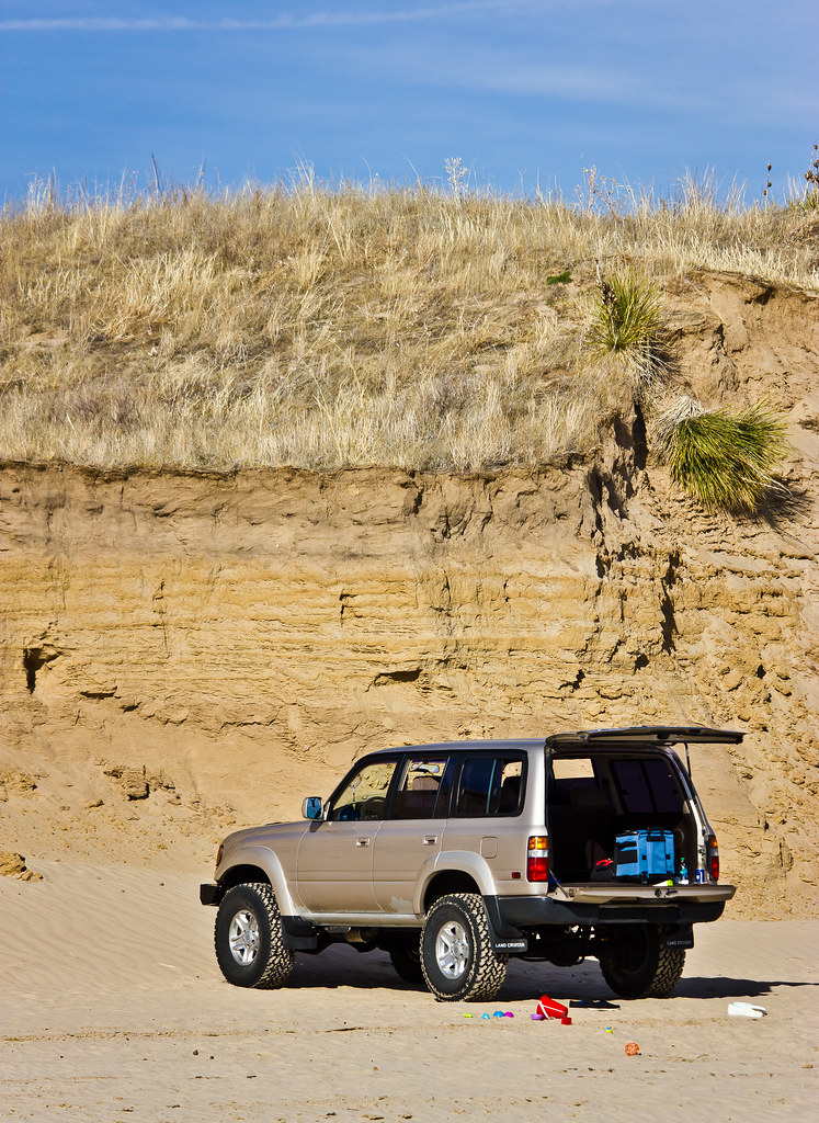

It looks like I missed the July group buy for the 4x4Labs bumper and my call to them to order a bumper was never returned, so I contacted Bump It Offroad (@MikeSmith) and just got in the queue for his high clearance rear bumper with tire swing out. It sounds like I'll have to wait a few weeks to get it but I'm excited as hell!
I had the infamous issue with the driver's door handle not working due to the tiny little spring in the latch mechanism breaking. About an hour and $0.80 later we were back in business... It sucked having to climb in and out through the passenger side!
I was able to roll the window down and reach down to the latch with a long metal rod to depress the latch mechanism and open the door. From there, it was just a matter of disassembling the door panel and innards until I could remove the latch mechanism.
No turning back now! High clearance bumper with tire carrier swingout from Bump It Offroad (BIOR).

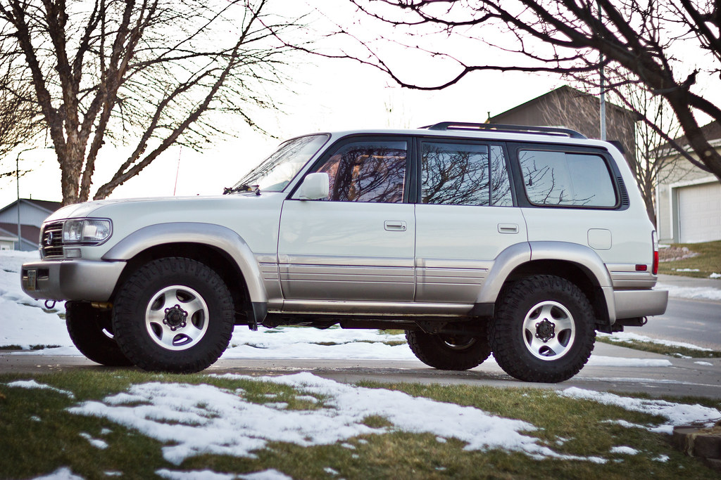

:flipoff2: I'm back in an 80 series! Quick summary... I bought an LX450 to use as a daily driver in 2011 that was rough around the edges. I put a lot of effort into maintenance/improvements but ended up selling it in 2013 to a Mud member because I wanted a newer pickup.
This was the last I saw of her as the shipper took her away... I believe the LX450 has now made it's way up into Canada somewhere...
A couple other shots of her...
Man was your LX perfection! I love it, going to have to clone it! Seriously! lol

I contemplated the 4x4Labs, too. Seems like it would be hard to go wrong with them. Actually, I called them once or twice and left voicemails but never heard back. One of those times I called 4x4Labs I had my CC in my hand ready to place an order!
I also had left Mike Smith (BIOR Owner) a message and he got back to me right away. Once Mike and I started communicating I was sold. Mike’s lead time was about 11 weeks... That was a bummer but not the end of the world. He was out of town this last weekend when I was available to pick it up so he made arrangements for someone else to meet me at his shop. Very accommodating.
My first impression of everything is that it appears to be very high quality and a very complete kit with all the accessories, latches, hardware, etc. Hopefully that first impression lasts through installation!
I am planning on painting with the John Deere Blitz Black paint as I’m not a huge fan of powder coating.
Progress! All cutting and grinding is done! I tested fitment and it was perfect...And I surprisingly didn’t lose a toe. It was a little sketchy maneuvering this thing around by myself.
I have primer laid down and tomorrow morning I’ll get 3 coats of JD Blitz Black on it.
