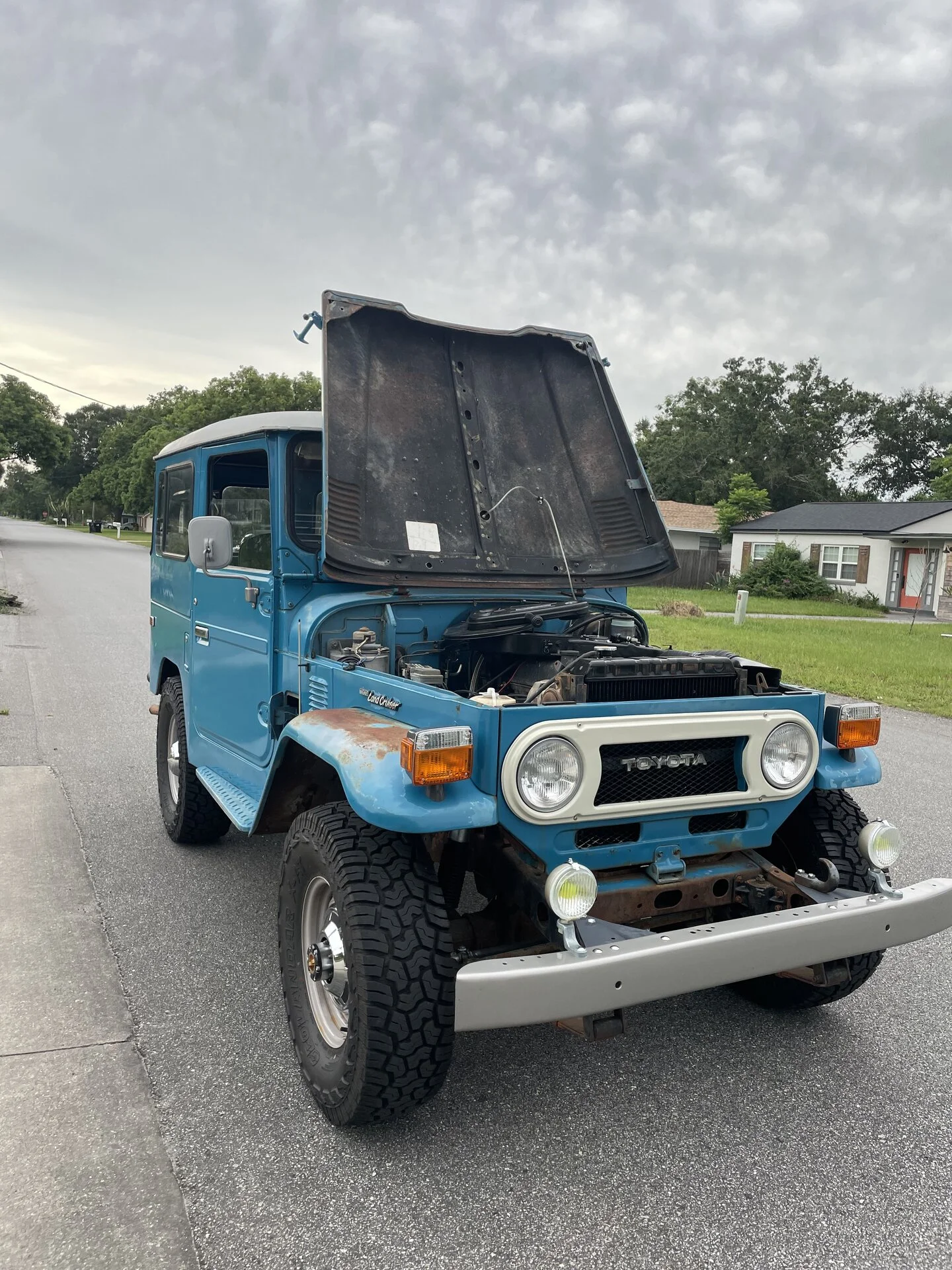

Fuel pumps on 1974 fj40??
Apr 18, 2010
16
422
Currently Silver City New Mexico
I seem to get about 2 years out of these pricey mech pumps.
I think they can be rebuilt?? Anyone have kit info?
I am currently stuck in Springer NM and the pump went out on me.
I may have to rural engineer am elec pump inline?????
I searched the FAQs but couldn't find much. I know a lot of people switch to elect pump...
I KNOW i need to clean and recon the tank, i get rust dust in the carb bowl. I keep fresh fuel filter pretty often.
Will tank crud get past the filter and ruin my pump?
Was running great, parked it for about 5 weeks and now, no fuel past the mech pump, but gas in tank and line and filter.
I've got to get back on the road quickly , Burt AM in no where.
There is atoy dealer in Trinidad. 90 mins
Any word of wisdom?😊

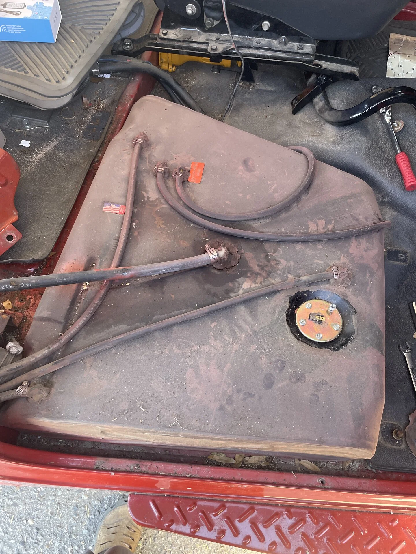

Turns out i have an aftermarket poly tank, no straps. Gonna drain and clean and re install.
Fill neck is Rusty on the inside, looking for a kit on cruiserteq.
My guage has never been accurate so sending Unit may be in order.
Shows 3/4 when full and E when more than 1/4 tank. Could float be bad?
New OEM tanks are $650+ and it seems that the partial return line and desmog leftovers mean the poly tank doesn't "suck" and collapse??!!
Dude, throw that trash away and put a OEM tank in. They are a lot less then $650, It would maybe be around there if you bought one from me and shipped it :lol:
